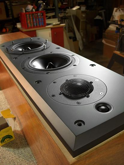

    Chuck (Impala454) made a suggestion to build a thread based on peoples' finishes. So, one could look at pics and make some educated judgment on possible finishes. Lets post some pics, and try to keep the discussion down as none of us want to hunt through 6 pages of chit chat for that one awesome pic :D Here's mine: Statement

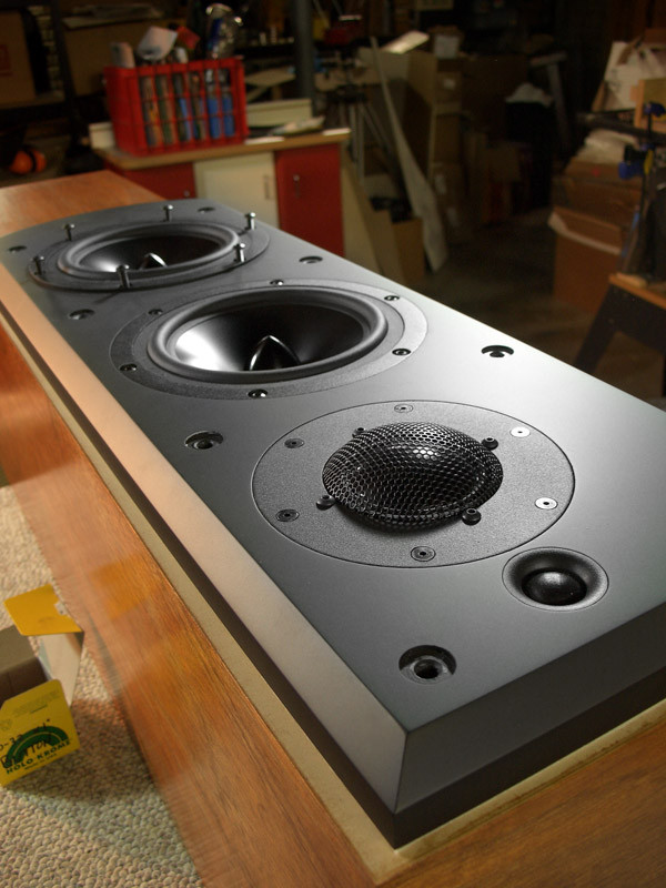

      I did those smaller speakers using rattle cans of Krylon semi-flat spray paint, no overcoat. For best results, I wouldn't try to use a rattle can on a large baffle or cabinet. However for about $150 you can have a small compressor and detail spray gun which works fine for speaker-sized projects.

      Since I painted this baffle, I've moved on to a larger compressor, but I still use the small $40 gravity-fed gun from Lowe's.
