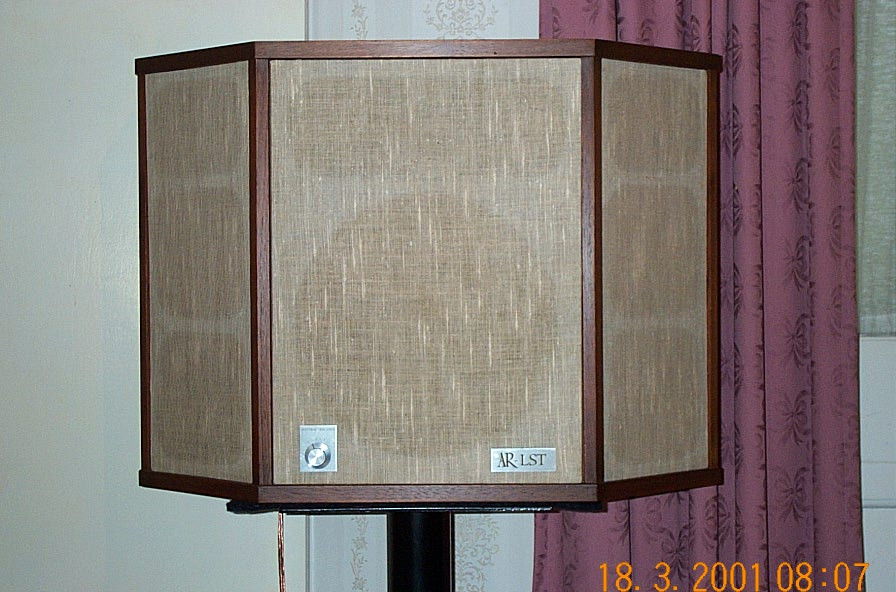

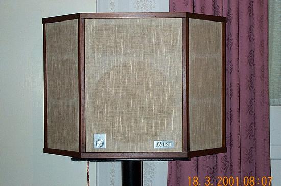

      First, let me say that I am not in my own eyes any kind of expert or trained person in woodworking- I'm an EE by profession, and I'd say I'm a lot handier with a PCB CAD program or a soldering iron than in the wood shop. However, I have worked in a small production shop for speakers, only wood finished (vinyl? Ughh!) back in the early 70's, and I've built a lot of things since then, including somewhat more complicated projects like AR LST clones. That kind of dates me, that I even know what an AR LST is! In the likelihood that you don't, here's a pic.
      Vacuum presses are most often used for veneering just boards or other small piece, PRIOR to assembly of the finished item. The maximum pressure a vacuum press can exert at sea level is about 14 lB/in2. Avalon uses various pnuematic presses, see pic, custom to the requirements of whether they're doing a top, side, or whatever.
      While I've used contact cement quite successfully for laminate veneering, I don't use it for wood; I've mostly used alphiatic resin glues, sometimes with heat, though I've experimented on occasion with some of the 3M spray on adhesives. For the more exotic woods like rosewood, teak, etc, I think Unibond is the way to go. Personally, I prefer the results from solid wood veneers over paper backed, but they do take more care to work with.
      There are other issues- one being the interface between the cabinet and the veneer. So called "Paper backed" veneer takes care of this problem inherently, but with solid wood veneers and hard glues, even near microsopic "movement" in the cabinet joints, such as would occur in the interface between the side walls and front panel will cause problems (cracks in the veneer and finish); the cabinet clones in an Avalon style produced in Taiwan seem to all suffer from this. You have to use an interface material such as commonly used in fine furniture veneering. I know what it is, but I can't tell.... but if you think about it a little, you'll come up with an obvious solution.
      In my experience, the key to getting a good looking result with solid wood veneers is having very high surface smoothness prior to veneering (ready for a high grade paint job, for example), and if needed pre-flattening the veneer, using a combination of glycerin and water to wet it down, then drying in a press using white craft paper. (Did I ever mention in any thread that building Avalong clone cabinets is EXTREMELY labor intensive and time consuming? :LOL: )
      My own concept for a veneer press is mechanical, using neoprene rubber on an composite MDF board reinforced with sheet aluminum and angle stock. We'll see how it works.

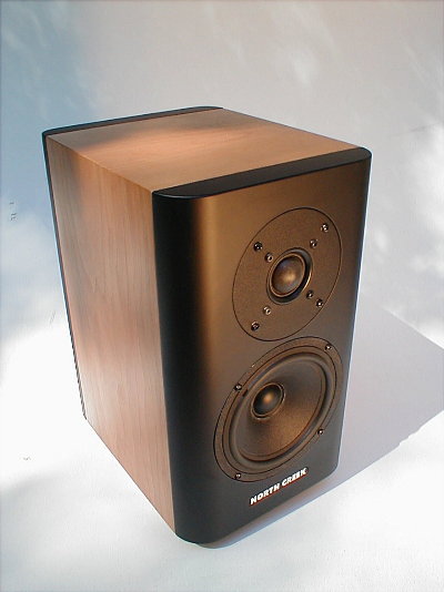

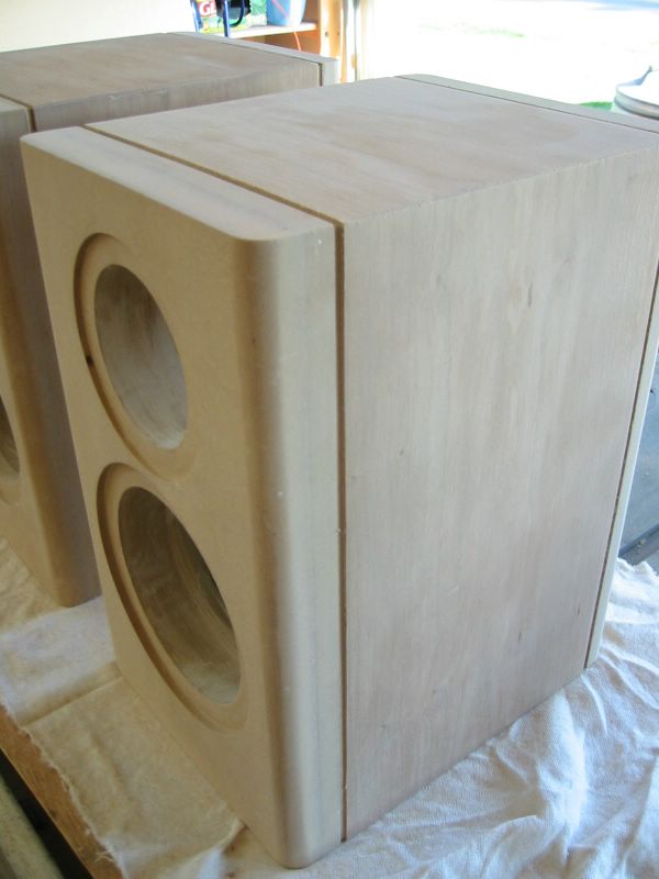

                I am building a pair of North Creek Okara II's.
                I have copied the box design as see in the thumb nail below with a 1 1/4 inch front baffle and 3/4 inch rear. The box is made of MDF. Like in the picture, I want to paint the baffle and back black using the truck bed liner paint recently posted. I did a test and this stuff looks great! I also want to veneer the middle section of the speaker and I have purchased some (fairly thick - not paper backed) cherry veneer. I plan on using contact cement, as I don't understand the PVA glue and an iron method.
                The baffle and the back are now attached to the speaker box and I have everything sanded smooth. When I apply the veneer should I pre cut the veneer to the width I want (front to back) so I don't have to trim it latter or should I make the veneer about 1/4 inch wider than needed and then trim about 1/8 inch off the front and the back after application?
                I am leaning towards cutting the veneer slightly over sized and then trim to the correct width using a straight edge and very sharp veneer knife with a new blade. Is this the correct procedure? Once the veneer is cut is it easy to remove the waste side and clean up the contact cement using Xyleen? Or is there another technique I should consider?
                After the veneer is applied I then plan to mask off the baffle and back and finish the veneer. Then after sufficient drying time mask off the veneer and spray primer and truck bed liner paint on the baffle and back.

                    What I like about the PVA glue process is the time one can take to align the veneer properly. My understanding is that one applies a thin layer of PVA to the cabinet and the veneer. Once it is dry, do you simply iron the veneer on????
                    If I cut the veneer oversize and then trim it with a sharp knife, how difficult is it to remove the PVA on the waste side of the cut. As you can see from the picture, the veneer cut will be next to the baffle (which I want to paint black). I suspect that I need to remove the PVA residue (and waste veneer) that is bound to be there.
                    For the ends of the cabinet I intend to use a flush trim bit.

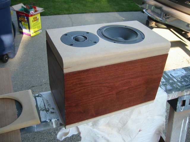

                                                    Results of Veneering.
                                                    Based on the info here I completed my first attempt at veneering my speaker boxes this weekend. I would give myself a grade of 7 out of 10.
                                                    I am building the North Creek Okara II with the upgraded cross over. The boxes are a copy of what George posts on his web site.
                                                    I used Lepages Bondfast glue. I added about 10% water and used a scraper to spread a thin coat on the MDF and veneer. Using the iron on method I ran into problems with bubbles. I now understand why the iron method is recommended. I managed to reheat the veneer and then smooth out the bubbles.
                                                    The biggest problem I had was getting a smooth cut on the ends of the veneer.
                                                    Here are my questions.
                                                    - How much glue should one apply? Very thin so that when it is dry the glue is almost imperceptible? or a thin layer so that the MDF is effectively white when the glue is wet? Can hide glue be used with the iron on process?
                                                    - How dry should the glue be before ironing on the veneer? Dry to the touch or slightly tacky?
                                                    - I used a new scalpel blade in my knife when I trimmed the end of the veneer. I scored the veneer from the back and then snapped it off. The edges were slightly ragged. I didn't try the flush trim bit in a router. How do you get the cut smooth with no tear out?
                                                    - I applied masking tape to cover the front and back baffle. After the veneer dried I used a 1/8 router bit to route in a shadow line. This worked very well. The veneer (cut slightly oversized) that overlapped the tape (that defined the margin between the baffle and the veneered body of the speaker) came off very easy when I removed the tape and there was no tear out on the veneer.
                                                    - I used a Mohawk (nane of the company) Xylene based wipe on stain. I have used this before and there is no blotching on Cherry. It dries really fast (in about 15 min at 70 degrees F)
                                                    Here is a picture of the two cabinets

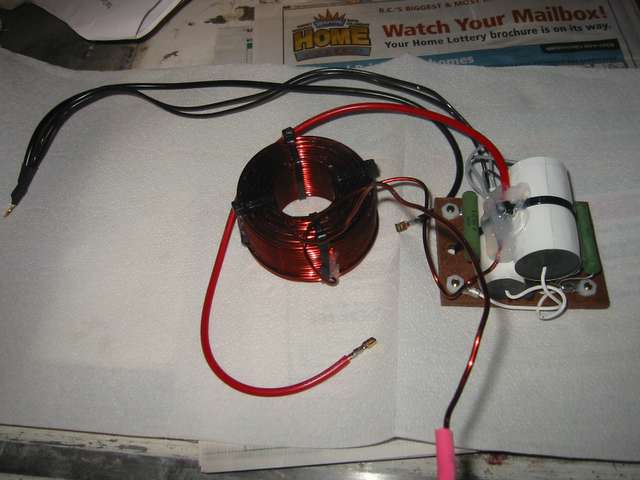

                                                    Here is a picture of the North Creek woofer cross over.
                                                    Here is a picture of the speakers with stain and spray lacquer (from a can).
                                                    The baffles (front and back) will be painted black with truck bed liner.
                                                    Regards,
                                                    Doug
                                                    Last edited by theSven; 14 August 2023, 12:38 Monday. Reason: Update image location
