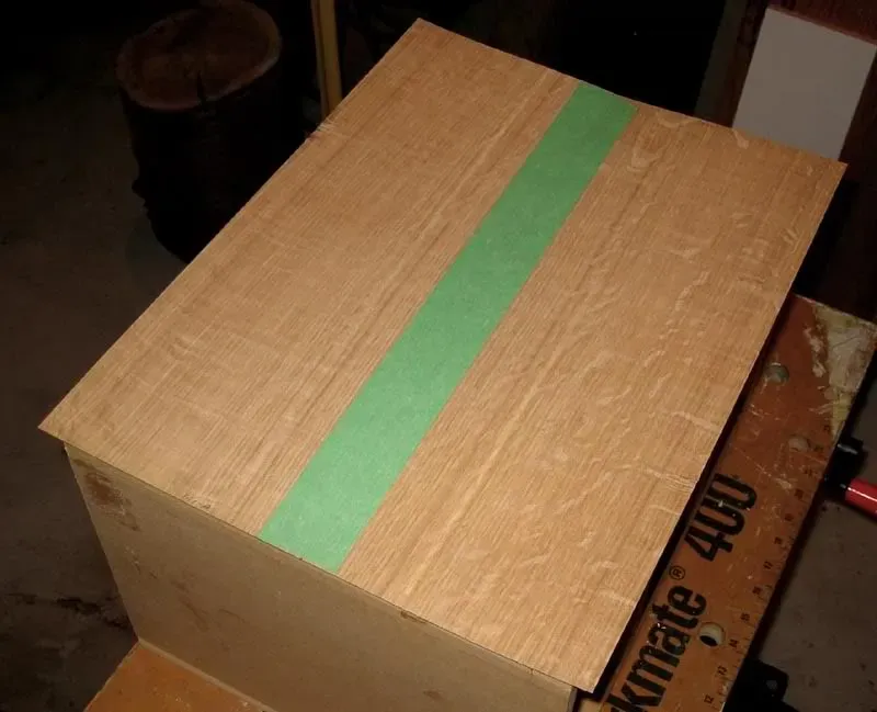

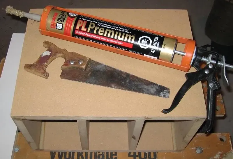

                                      Glueing Raw Veneer

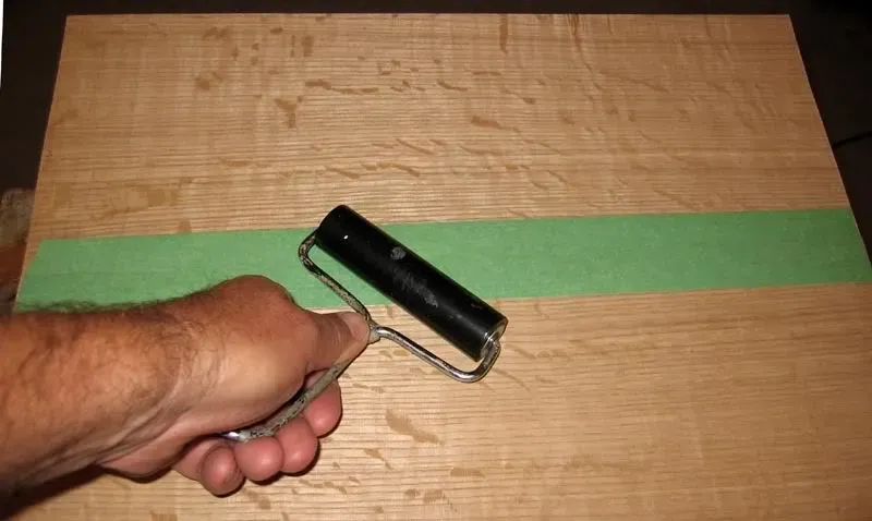

                                      This veneering method is a little different, but it works for me and I'm very happy with the results.
                                      I tried Iron-on and CC, but with raw, heavily-flaked white oak veneer, the results with these methods were "bubblicious" and unsuccessful.
                                      I read about this somewhere on a woodworking forum.
                                      First, the raw veneer has to be "softened", using a glycerine/water spray, then dried/flattened by clamping between kraft paper for several days.

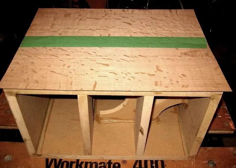

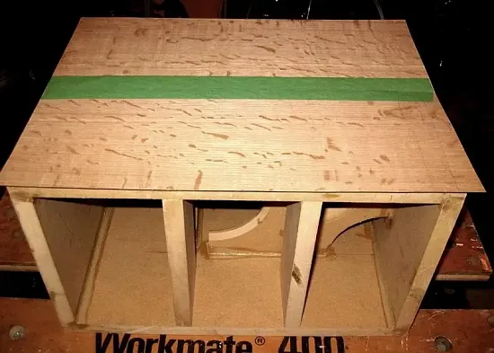

                                      Next, the veneer is edge-trimmed, jointed (held together with masking tape) and fitted to the panel to be veneered - in this case the side of a Modula MT. Press-fit, temporary bracing is installed inside the speaker for support during the "pressing".

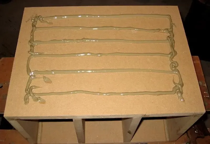

                                      Tools used are a big tube of Poly glue and and old saw with 15tpi.

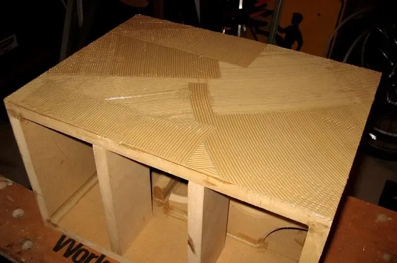

                                      Polyurethane glue is then applied to the substrate only. ,

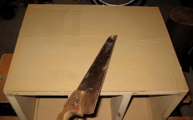

                                      The glue is spread evenly with the back of the saw...
                                      ...and screeded with the saw-teeth.
                                      The veneer is placed on the screeded glue.
                                      Air is extruded using a j-roller...

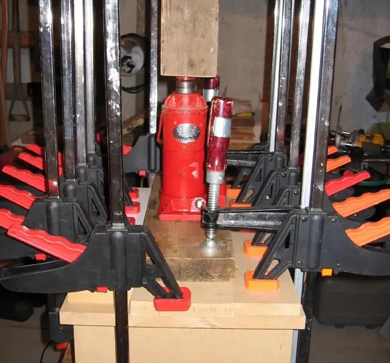

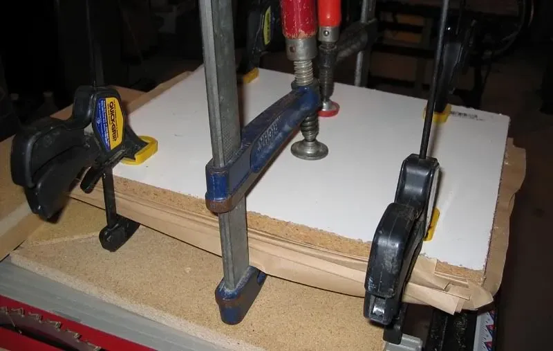

                                      ... and platens are stacked on top of the veneer.
                                      The whole thing is seriously clamped all around (first from the center using an 8ton hydraulic jack that extends to my garage ceiling - with the workmate table braced from below to prevent collapse :W ) . Several clamps maintain the position of the veneer, centered on the substrate (with this amount of pressure, the veneer wants to "skate" a bit). 8O

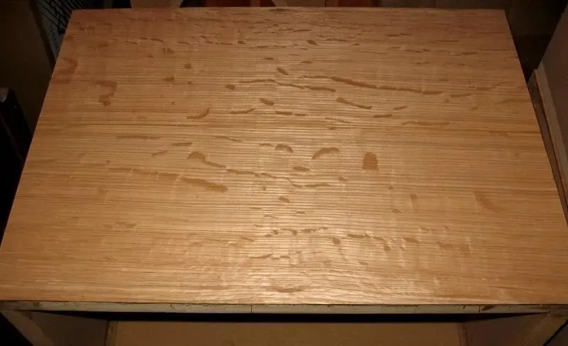

                                      After a couple of hours, the veneered surface is ready for flush-trimming.
                                      The result is here:
                                      Unfortunately this procedure doesn't work for rounded-over compound corners. To do that, I agree that your best bet is to install solid wood fillets which are then flush-trimmed and rounded-over.

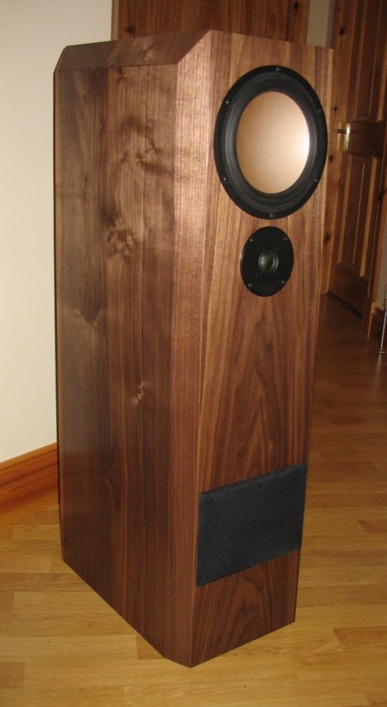

                                                        Speakers are finally finished. Thanks to every one for your help and advice. They're not perfect but I'm fairly happy with them.
                                                        Although the iron on PVA method was simple I found it did have it's problems. I had to ensure the raw veneer was as dry as possible before starting because shrinkage was causing cracks to open up. Thankfully this was only on the first panel and It is now filled with filler wax and is almost indistinguishable.
                                                        I also found a lot of pressure had to be applied to the iron to ensure a bond. I worked a small area at a time and went over it with a veneer hammer while still hot. I have just noticed one small area (about the size of a thumb nail) which has not bonded. Not sure what I'm going to do with it now. I fear the iron will damage the oil finish?
                                                        Here Is a photo, unfortunately it doesn't really do the beauty of the grain justice but you get an idea.
                                                        Thanks again for your help, Kenny
                                                        • PMazz
                                                          • May 2001
                                                          • 861
                                                          Congrats! Looks very nice. It seems Walnut is making a big comeback and that speaker looks great!

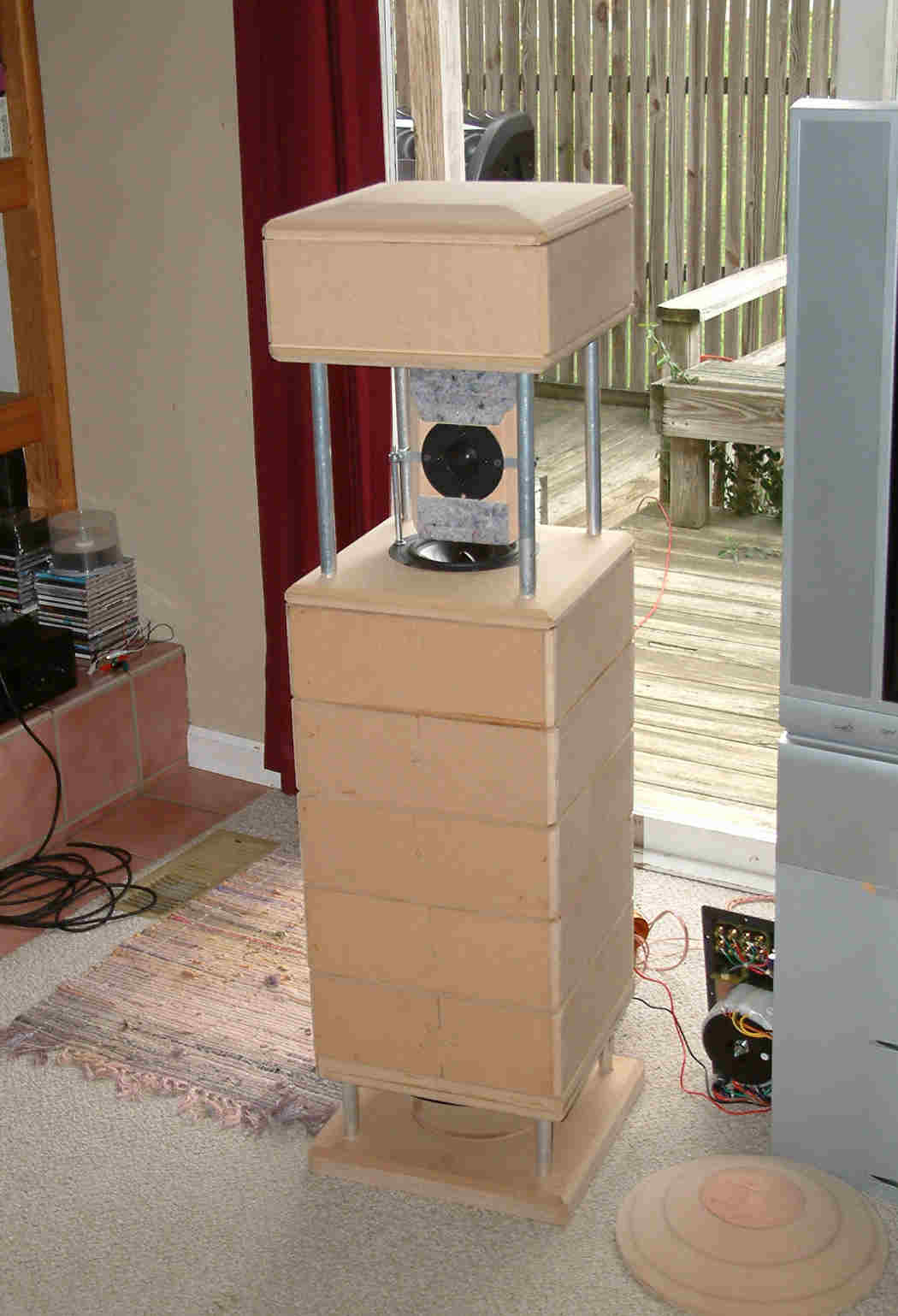

                                                              Hey Pete,
                                                              What are your thoughts in regards to water based contact cement?
                                                              Also, do you ever seal mdf prior to applying contact cement and/or paint? If so, with what? Can you apply contact cement and veneer over primer on mdf?
                                                              Maybe I should explain the project. Below is a photo of the original and a also digital mock up of the finished project I'm going to be doing soon. The black areas and joints between the veneer will probably be truck bed liner. The veneer is Italian Rosewood 22.1mil paper backed. The veneer application will simply be a bunch of 4.5"x12.25" pieces placed individually between the joints. I'm looking for recommendations for the best process, since I'm applying both veneer and paint (truck bed liner). For example, might I prime the whole box with a coat or two of flat black to help seal the veneer, apply the contact cement and veneer, finish the veneer, tape off the veneer and spray on the truck bed liner as a last step?
                                                              On the veneer finish I would like to use and oil (ideally boiled linseed oil in a 1:1 with naptha or mieral spirits) for a couple coats and then a spitcoat finish using a wipe on poly in a 1:1 with naptha or MS.
                                                              What process would you use?
                                                              Thanks.
                                                              Dan N.
                                                                  I've used a few different kinds and had mixed results. Drying time is too long w/o adding heat so they never saw long term duty in the shop. The ambient temperature also seems critical for a good bond. Below 65-70 deg and they wouldn't bond at all. Application with a roller was a snap, as long as you didn't roll it out too thin. 2 coats seemed to always do the trick.
                                                                  No reason to seal it as long as you apply enough CC to build up on surface. 2 coats may be required on edges. You can use CC over existing finishes as long as you scuff the surface, the bond is in good shape to the substrate, and you test a small area for any reactions to the CC.
                                                                  I've never worked with truck bed liner but if it's easy to control I think I'd do the veneer first. Actually, looking at the details of the speaker, the iron on method may be the easiest way to go. CC is tougher to control with those recesses and clean up would be a bitch. Go easy with the oil finish as it may react with the adhesive under the veneer. You don't need a lot of oil on veneer anyway. Poly over oil may be questionable unless the oil has a hardener. Why not just use urethane oil?
                                                                  Pete
                                                                  Birth of a Media Center
                                                                    • 1456
                                                                    Pete
                                                                    Thanks for the advice, Pete.
                                                                    This box is made up of a bunch of 4.5" tall individual modular boxes that come apart, so I can finish all the boxes separately, if need be, and then re-assemble them. I was thinking I would probably end up having to do a lot of masking. I'll experiment with the both the iron on method and CC. Given the time of year and temperature here, I might just do it inside and try the water based CC. I could probably mask off recesses around each flat section before gluing on the veneer, which would allow me to use either glue type without any cleanup. I'll have to test the sequence. For example, I don't know how the truck bed liner would react to oil or poly if it was applied over it, or just slopped over on to it a bit or if I need to completly finish the veneer before doing the trim paint/truck bed liner (probably the latter).
                                                                    I've never used Urethane oil and don't know anything about it. I assume it has a built in hardener or finish? Is it carried by the big box stores or local hardwares, or do I need to get it online? When you apply it do you cut it with naptha or mineral spirits? I would prefer to do a wipe on finish with multiple thin coats to avoid runs, etc.
                                                                    Dan N.
