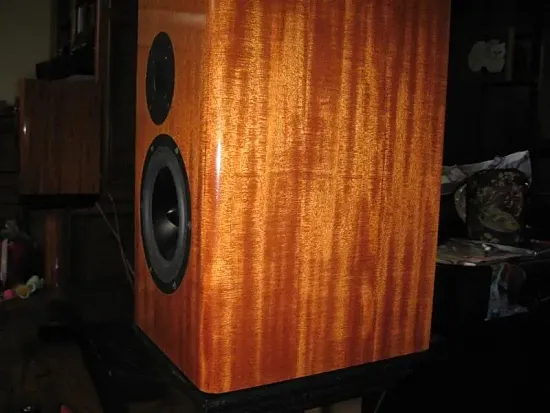

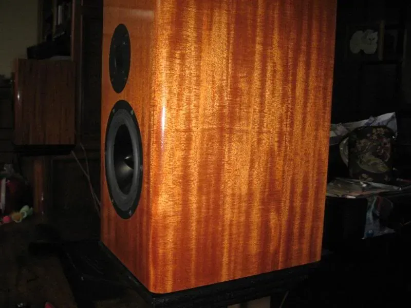

                          Kind of weird to see a subject title, go to offer some possible advice.. and find it's your own thread from a while ago!
                          And, embarrassing in that it's been that long, and they've only been finished a month or two.. ops:
                          So... I did use the Titebond II, seemed slightly better, but hard to say how much. Not a big difference, as Brian and Bob said... It went very well, the veneer was very flexible, no problems doing a full wrap side-front-side around the 3/4" roundovers.
                          Another thing that seems to help, and I think this is a Jon Marsh trick, is to follow the iron with a block of MDF (big jobs, he uses another cool iron!) to press down on the just heated area, as you move along. It holds pressure while it's cooling, and helps to cool it a bit faster.
                          Yep, when the glue is cool, its hard... It's a good thing to let it sit for a while, I'd guess there's a bit of re-absorbtion of moisture from the air, and very minor expansion of the veneer. Time should be spent right after, checking for bubbles and loose spots by rubbing your fingertips over the box and gently pulling at edges. You'll hear the hollow sound of a lifted area, or see it come loose with the pulling, and then you want to go over the areas again with the iron till they're solid. I ended up with just a few spots that needed going over again.
                          Ah, how I trimmed... After getting splits and tearouts even with a sharp Xacto on the Bubinga... I ended up using my flush trim bit and the router! Not as scary as it sounds.. I did a layer of easy release tape to protect from the bearing, and that did provide a few thou of overhang... then sand to flush. Only problem, be CAREFUL in removing the tape! I actually pulled up some grain, even with the blue easy release painter's tape! ARRRGH! Always pull it off ACROSS the grain, not with... Your wood may vary... but it's less likely to come up that way.
                          Somehow, I never got to staining the veneer. I started with a coat or two of Zinnser's Seal Coat.. it's a moderate amber Shellac... and it darkened it a fair amount. I just started putting on coats, and after many umpteen layers, it turned out very nice! Takes forever to build, and I probably should have done it with poly... but oh well...
                          Soon they go to my Sis and Bro in Law... still not late enough to be the 1st anniversary present!! :roll:
                          Bunch of pics in my Photo-bucket... still have a few more to put up in the near future... Also one shot of the veneered 3" PVC support in the stand... that turned out very nice too...
                          And here's one, for those who read this far... :W

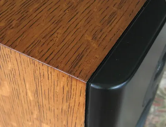

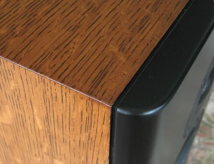

                                Ah, how I trimmed... I ended up using my flush trim bit and the router! Not as scary as it sounds.. I did a layer of easy release tape to protect from the bearing, and that did provide a few thou of overhang... then sand to flush. Only problem, be CAREFUL in removing the tape! I actually pulled up some grain, even with the blue easy release painter's tape! ARRRGH! Always pull it off ACROSS the grain, not with... Your wood may vary... but it's less likely to come up that way.
                                :agree:
                                That's exactly the method I used on my MT's and it worked very well. :T
                                Highly recommended!
                                The veneer I used was raw, heavy-flaked white oak. I first tried the PVA glue/iron-on route and after a losing battle with curling and shrinkage, I ended up using polyurethane glue and a press.
                                Here's how I did it:
                                Hello, I am about to start my first speaker project and have been researching veneering methods. Unfortunately I have not been able to come to any conclusions on the best method. My concerns are not just ease of use but I also want to ensure it will stand the test of time. I will be using raw 0.6mm American black walnut.
                                And the finished look.
