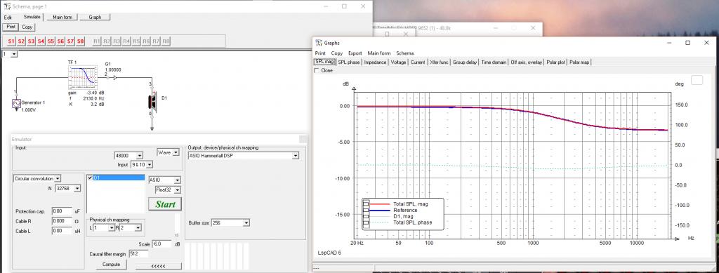

          As Jon mentions I've listened to this mod with LspCad simulation
          Spotify or JRiver --> RME soundcard --> digital loopback --> LspCAD --> RME SPDIF --> NAD C390DD digital power amp --> Minerva EE version.
          Blue is Jon's curve of his analog filter simulatio and red is what LspCAD gets with "1st order bass boost" block.
          What I wrote to Jon as my impressions
          "What I hear as a difference is much more than I expected. One would of course expect a bit of a change in sound balance, but what I experience is something more. Somehow the in a soundfield something 'clicks' to place. Without the mod especially with complex music the imaging tended to smear and the depth layering was not quite good. With this voicing curve both of these aspects change. I experience better imaging and depth even with double bass etc. I tried this cautiously multiple times and with different time intervals spent on either setting. I am in end confident enough to say that, yes - I do hear and like this setting a lot.
          A good sign is also that it is all in all very hard to remove the setting and I end up listening long just for fun each time as it sounds so good.
          Anyhow. I share my thoughts first via e-mail. "

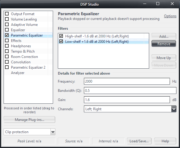

                                        Bob - Could you post a screen-shot of your JRiver setup/DSP? I use this also and would be a quick easy way to understand the details. Thanks
                                        • PMazz
                                          • May 2001
                                          • 861

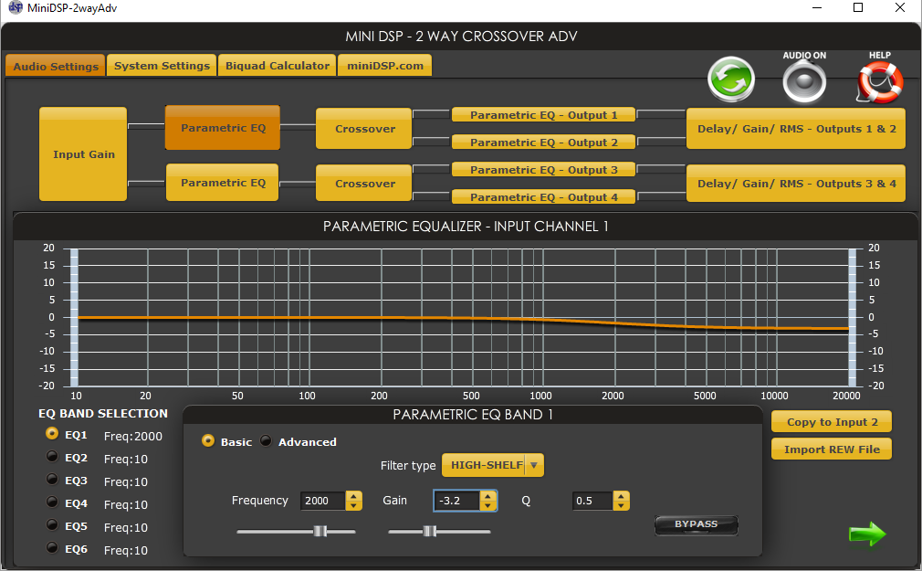

                                          If anyone has insight to what a minidsp filter would be I'd give it a whirl.
                                          Birth of a Media Center
                                            Here you go, MEB. There are two catches. Foremost you must be using the player to output music, not sending it to a DLNA renderer. Second is you have to have JRiver sending audio to a device other than the default playback device under windows. I assume you have an external DAC of some sort. Set Windows default playback device to the built in audio (you have to have something plugged into the jack, if just an unconnected plug) and click Player>Playback Options>Audio Device select the DAC or spdif device you use for music. This has the side benefit of keeping windows sounds out of your music playback if you do other things on the same box.
                                            To get to the EQ click Player>DSP Studio
Name:	DSP setup.png

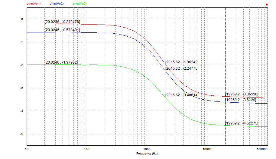

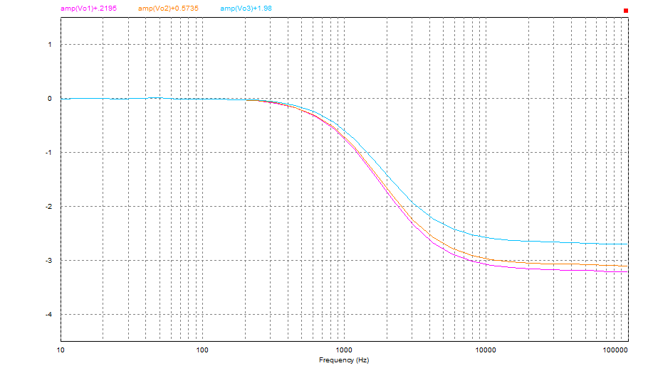

                                              I was curious of the effects of different amplifier input impedance so I ran three different values:
                                              1) amp(Vo1) 200kohm balanced or 100k single ended (same as Jon's first example)
                                              2) amp(Vo2) 75k balanced or 37.5k single ended
                                              3) amp(Vo3) 20k balanced or 10k single ended
                                              Markers on the graph show attenuation at approx. 20Hz, 2kHz and 20kHz. With decreasing amplifier impedance the insertion loss is larger and the delta between the shelves gets a little smaller. The transition region is similar.
                                              One thing of note is that during the Stereophile review of the NAD M22 they measured a balanced input impedance of 75kohm, not the 200k in the spec sheet.
                                              Response graph
                                              Normalized graph
                                                I didn't think the range of normal input impedances would matter that much. I guess we'll have to simulate our own amps before building a dongle. Given the 1.8K input impedance of my Pass A75 the circuit as specified wouldn't have the desired effect.
                                                  Pete,
                                                  I think this is pretty close - higher Q would be sharper corners, but I think .5 is right for this filter. Maybe a professional sparks and wires guy can verify. Duplicate for the other channel, of course.
Name:	MiniDSP Linkwitz.png
                                                    • 15284
                                                    That looks like its more or less in the ball park, though if you could control the scaling of the display that would help! Of course, there always is that old standby, set it up, measure, adjust measure again, then at that point you're likely good to go. Key points might be looking at the 1kHz, 2kHz, and 10kHz levels.
                                                    Over a range of 200K to 50K balanced this tracks fairly well, just more attenuation overall, but below 50K I'd say give me your amp parameters, and let's customize for it.
                                                    I'll post a target plot with detailed grids and markers.
