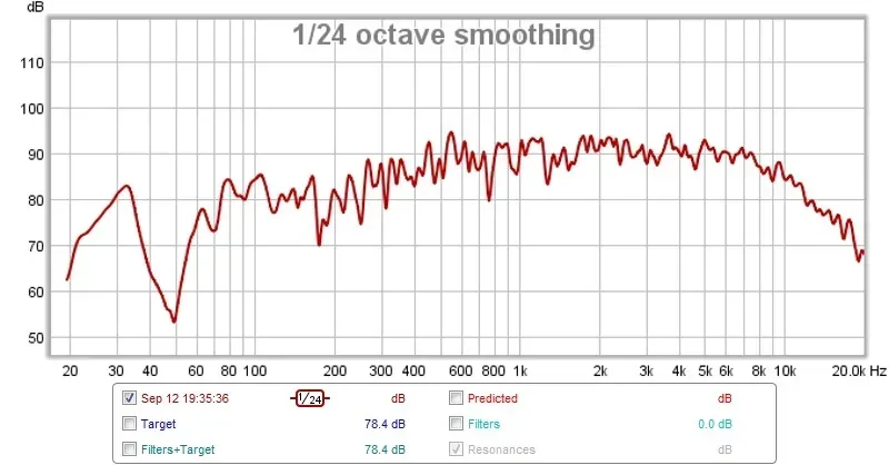

    basically I am using a 65 liter, bottom-ported version of Jon's Natalie Portman's with two HSU subs crossed at ~ 90 dB, placed next to each speaker running from discrete L/R outputs from my highly modified Carver C-19 pre.
    This first sweep was made with one of those nice pre-calibrated mic's (forget the name ops positioned were my nose is as I sit in my listening sweet-spot around 9 feet from the front baffles.
Name:	12 Sep 2015 4_zpsbrztnene.webp

          The biggest issue I see with the measurement is the declining response from about 600Hz and down. Did you build a version with no baffle step compensation or something?
                                  I used Jon's standard Natalie Portman xo.
                                  not sure yet why we see the roll-off.

                                    No need. Just post the public link here.
                                    Also, if both channels were run simultaneously for the measurement, we cannot know if the data is accurate above 1K-2K given the cancellation effect that takes place (which is why measuring each channel separately is important).
                                    The premature rolloff starting at about 8K in the graph you posted is probably due to this.
                                    So, do you want to analyze what you got anyway, or remeasure?
                                      probably makes more sense to re-measure each speaker individually, then.

                                        There is something wrong with the data. Not sure how to go about getting it right. Perhaps I could talk to Dan directly?
                                        The reason I say this is that the data says you got 71% distortion at 800hz, and over 2000% at 41hz. That couldnt be right, could it? Other details also point to this being bad data.
                                        I cant be sure whether the actual measurement is bad, or the data got corrupted somehow. There wasnt lots of room noise when the measurement was taken was there?
                                        In any case, new measurements are needed.

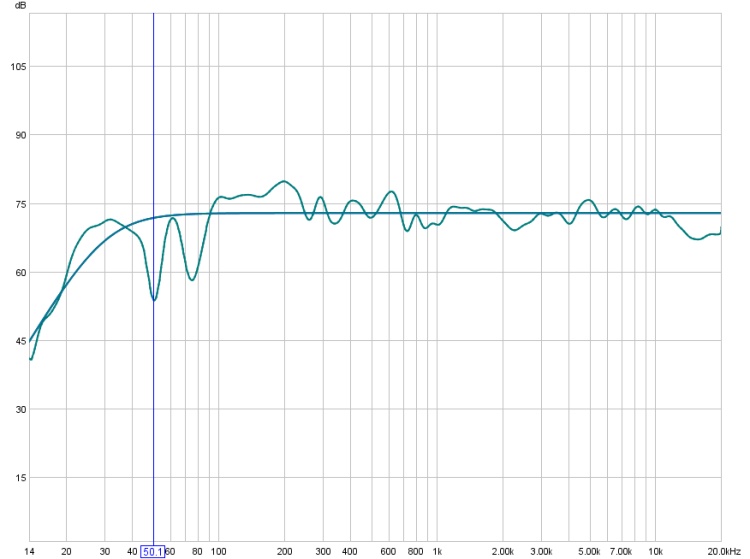

                                                  Just an example of what I'm seeing in my room...

                                                    Hey Dan,
                                                    To my eyes, there is a world of difference between your mdat and WK's. WK's was polluted with noise. This one at least looks believable.
                                                    Measuring each channel separately is the way to go. Cant trust the top end otherwise. Settings wise, it seems you had it right.
                                                    This is optional, but IMO, more accurate, and that is to put the mic tip pointing up and using the 90 degree cal file where the ear entrance would be for each ear, for each channel. After all, ones ears are not in the middle of our head
                                                    Middle of the head for each channel is OK though.

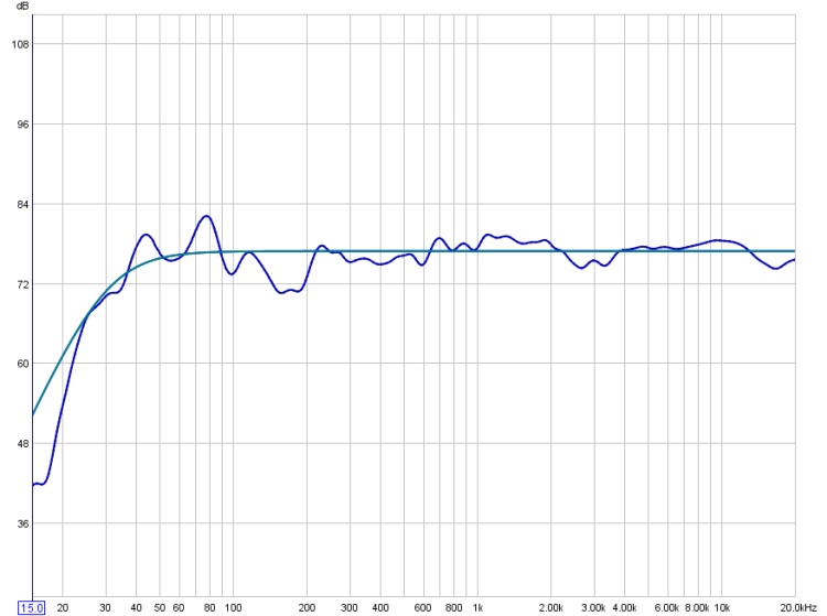

                                                          As someone who also has a pair of 65L, bottom-ported, NatP towers, and a measurement rig, I would suspect your data on other grounds... it doesn't look right, compared with mine.
                                                          Click image for larger version  Name:	natp on_axis listening position.jpg Views:	161 Size:	68.6 KB ID:	860347
                                                          Click image for larger version  Name:	natp on_axis close mic.jpg Views:	162 Size:	75.3 KB ID:	860348
                                                          That's not to say I'm well versed in audio measurement, but the data are consistent with the requirements for high quality audio, and a trip to MWAF showed that was the case. I bet your ears would notice if this were an accurate measurement!
