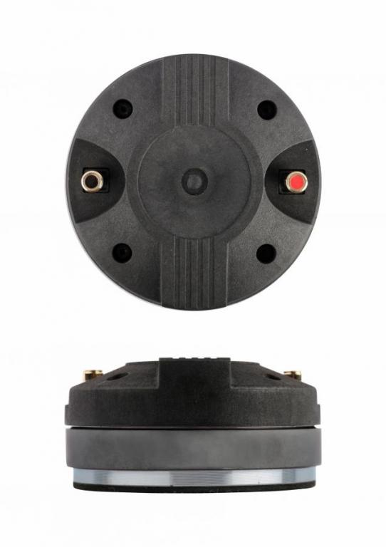

    After doing a metric ton of driver research, I may have found the 1" CD equivalent of the Peerless DA25TX, as regards value proposition. Now, I really, really like the NSD1095 performance, but the price would be off putting to many- I'm not necessarily proposing a budget project here, but I'm trying to be reasonable.
    So, for your consideration, I suggest this driver from SB Audience
    BIANCO-44CD-PK

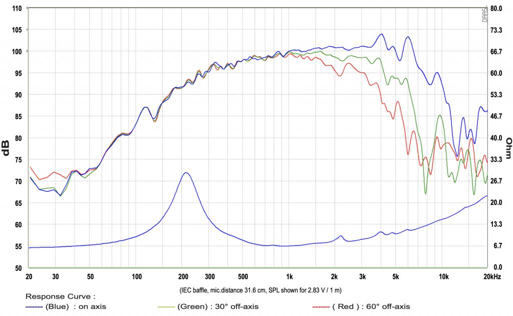

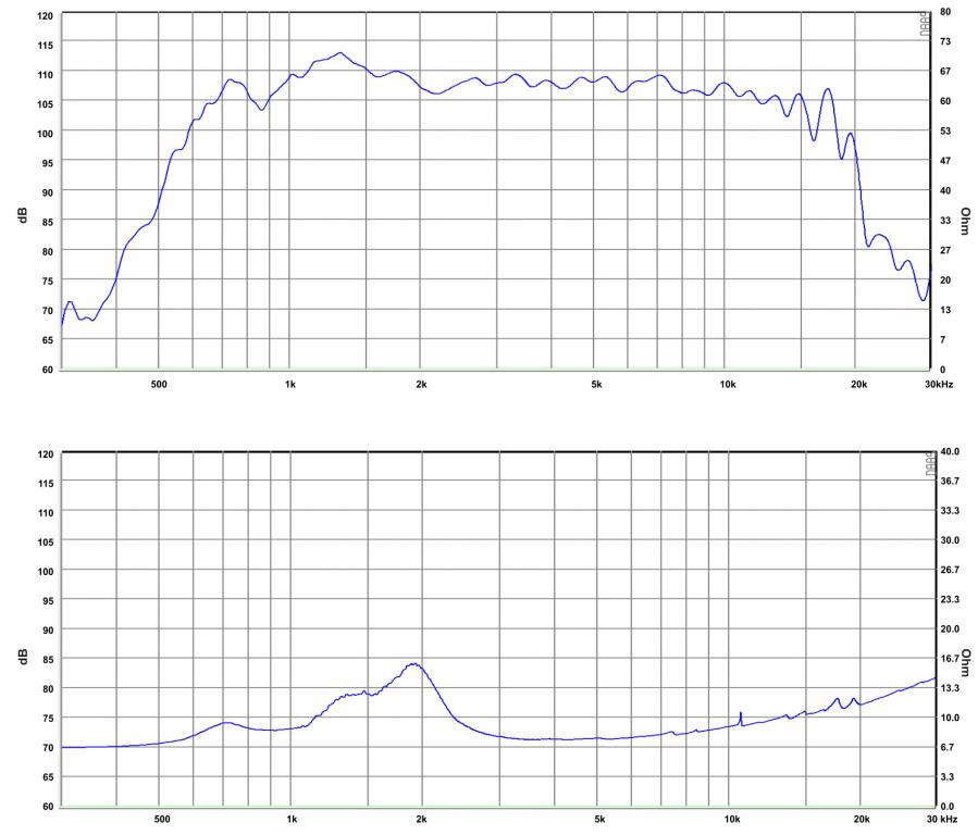

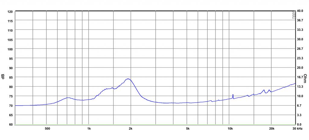

    This is remarkable extension and smoothness for a 1" driver. I expect to use something like a 1700Hz to 2000Hz crossover frequency nominally, but with the special characteristics required for a Harsch crossover. Note, the Harsch delivers near transient perfect impulse response and low phase shift and low group delay. There is no phase rotation.
Name:	44CD-PK Impedance.jpg
    This impedance curve smoothness is rarely matched in compression drivers, and makes it much easier to work with and lower cost for the crossover, assuming one does not want interaction between the impedance of the driver and crossover network, which would introduce irregularities in the response.
    There is a Neo version of this part, to lighten the moving load for live sound, but of course it costs more. This version is about $62.

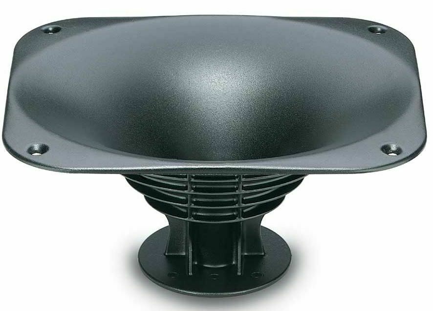

    Eighteen Sound XT1086
    For the constant directivity horn, I do have a favorite, after some testing, and reviewing tests by others (including Kimmo) and so we're going to go with the Eighteen Sound XT1086. A lot of BEM analysis went into this part to achieve the directivity consistency, as well as to make a very stiff and resonance free structure.

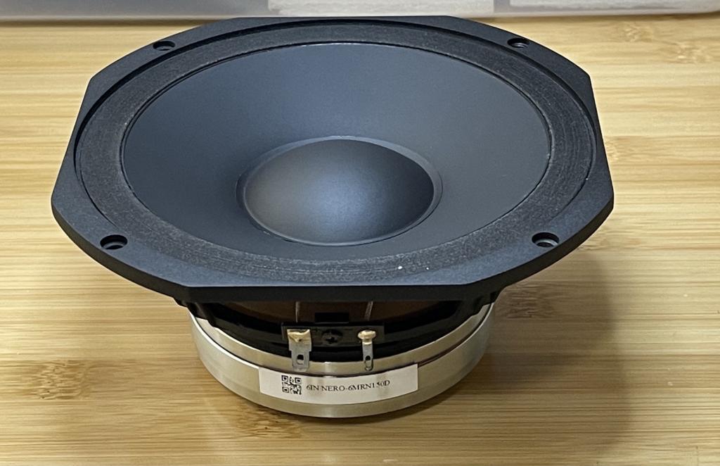

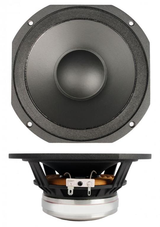

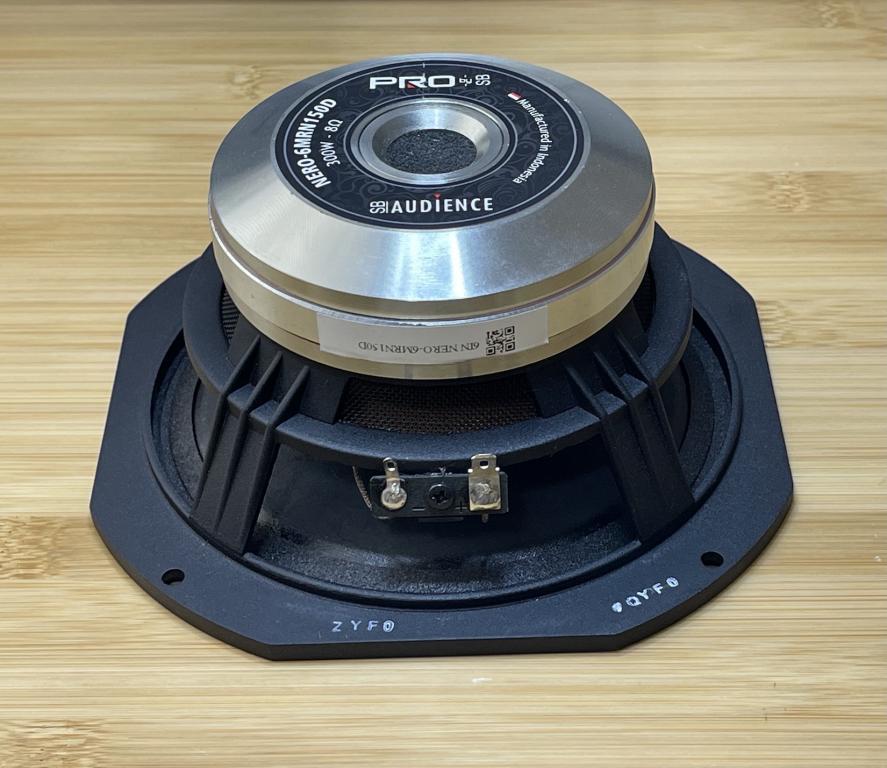

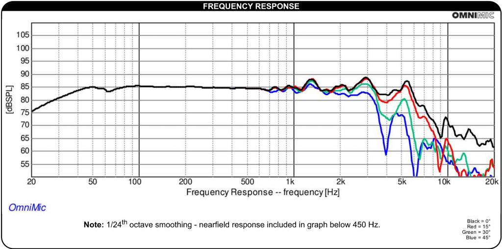

      Midrange proposal: SB Audience NERO 6RMN150D
      OK, now, about the midrange...
      I first looked at the Nero-6RMND150D as a midrange solution for a mini Isiris. It's another fairly new driver in the SB Audience pro line up. For me, it's a reminder of the Audax Pro 6.5" midranges I worked with in the 70's... due to the surround and cone design. But the motor seems to be far more sophisticated, of course.
      Yes, there are certain elements of "nostalgia" I am indulging in this design... at least, my nostalgia. Maybe not yours. This isn't the only one...
      NERO-6RMND150D
Name:	6MRN150D Mid Plot.jpg
      Plenty of sensitivity to pad down for response shaping as needed. Overall behavior in the range I want is quite smooth...

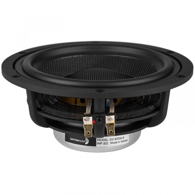

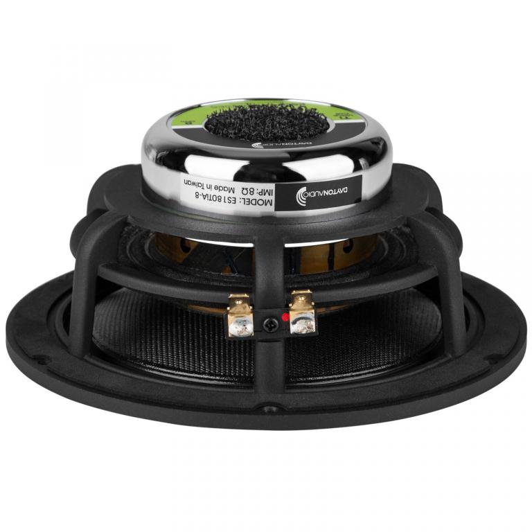

        Esoteric ES180TiA
        OK, let's finish up with the "FUNdamentals"... pun intended.
        This is another bit of "nostalgia" for me- 8 years ago when I first started looking at these Esoteric versions from Dayton, and their follow up with an improved cone. The main aspect of the nostalgia though is the fundamental design, based on a large diameter voice coil in a smallish diameter woofer, like the D6.8 HiVi used in the NeoD CC, and of course, both copying their British predecessors and Israeli imitator.
        The ES180TiA is an improved version of the ES180Ti, with a smoother better controlled top end, though in this case that's not really a concern. Sensitivity is moderate, as is Xmax. In a sealed box, the output limit for a pair is about 104dB at 50Hz, but this is much lower than normal HT CC range. The pair can squeak out 110 dB at 90Hz, which should be adequate for reasonable hearing damage. The chassis rear is quite open, as is the large pole piece vent.
        Le's hear it for nostalgia! I have the original version on hand, but need to order the improved "A" version. Unlike the E180HE-44, they are in stock.
        ES180TiA

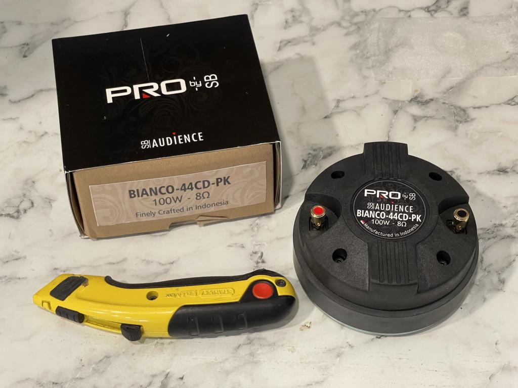

                Now, the new (to me) SB Audience compression drivers came in today, and I certainly understand why they have a Neo version of this part for touring rigs. Geez, if they gave out awards for pounds per dollar for compression drivers, I'm sure this baby would take it! Now the spec sheets say just 5 lb, and the Neo version is 3 lB, but I've been handling some other 1" throat drivers, too, and most of those are around 2-1/2 lb. Just 'sayin.
                I may go an order a couple more of these- I was going to be testing some Peerless CD's on the Eminence SST1 (seems appropriate; discontinued CD horn and discontinued compression driver) but I"m pondering changing my mind on that. I won't be able to do any testing for at least a couple of weeks, but lets just say, my spidey sense is tingling. Of course, I don't have a spidey sense, so maybe its just spring allergies!
                I left the cutting knife in the picture for scale... this is big puppy for a 1" throat driver.

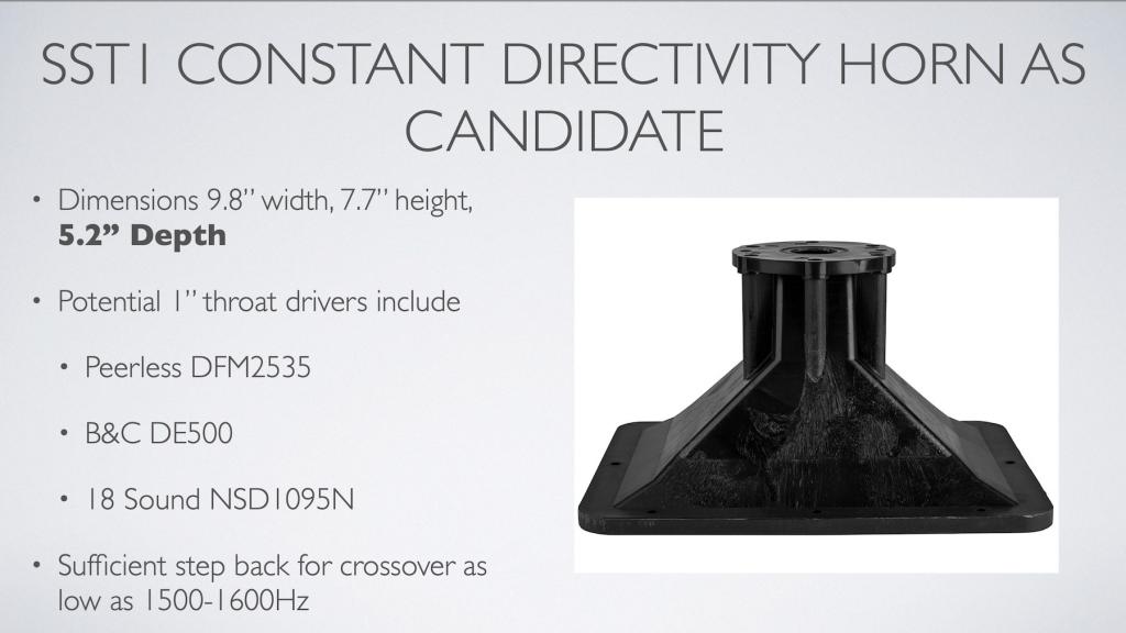

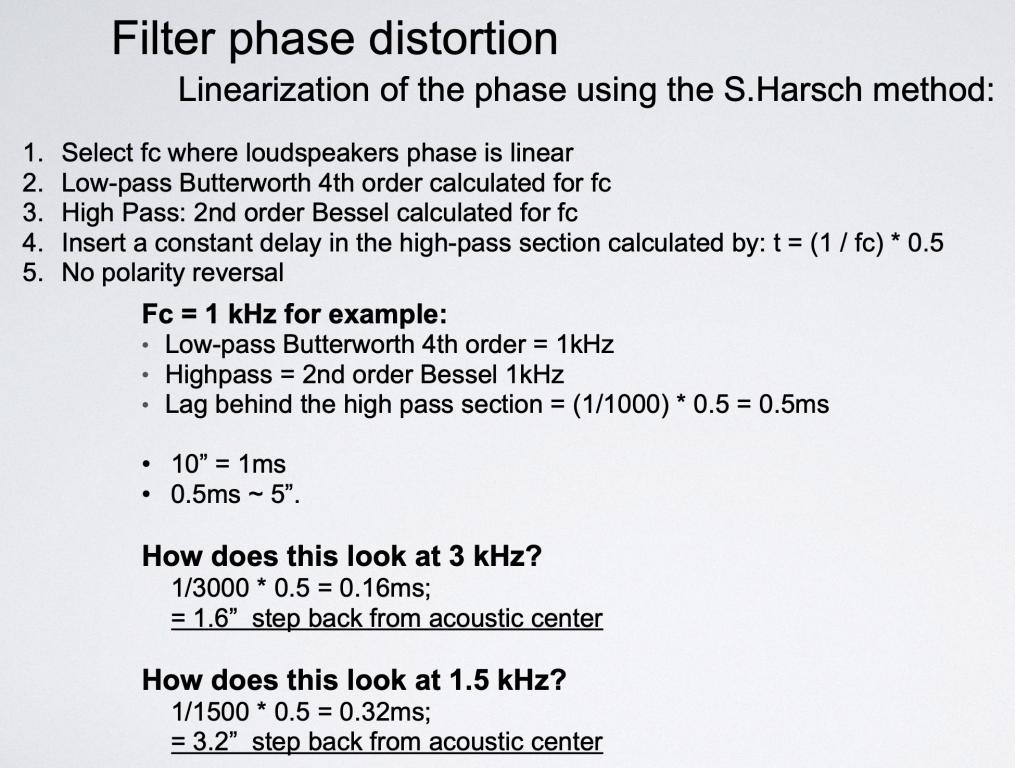

                    To explain briefly, I'm considering as part of this "Design Study" investigation a small parallel project using dual Esoteric 5.5" woofers (conveniently on hand) and the SST1, for which I'd already worked out some back of the napkin dimensional stuff for a Harsch crossover. This is literally just an initial "proof of concept" study for a first pass with the Harsch crossover approach.
                    For grins, we could call this a "Calliope CC Mini Supreme", just as a code name. However, I'm not convinced about how the lateral dispersion would work out with the two mid woofers flanking the CD, I'm more interested in testing the Harsch concept. But this is as close to a "sound bar" solution as we're likely to come with this approach!
Name:	SST1 Overview SS.jpg
Name:	Filter Phase and xover offset calcs.jpg

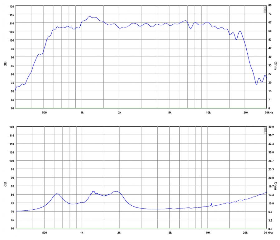

                        Another question I have is what is the difference between the BIANCO-44CD-PK considered here and the BIANCO-44CD-K versions for which measurements are available here: https://audioxpress.com/article/test...m-sb-acoustics
                        Both of their frequency responses look similar. However, the diaphragm material is PEEK in the 'PK' version and Kapton in the 'K' version. Does it make a big difference audibly even though pricewise very close? (Can one be substituted with the other in a use case like the project here, except for the sensitivity difference)
                        Vineeth
                          • 16138
                          First, thanks for sharing the measurement data with us. Much appreciated, I'm looking forward to having some time (in a week or so! a lot going on now) and going through it in detail.

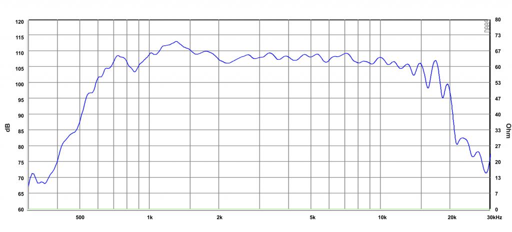

                          As to the two versions of the Bianco 44 compression driver, my perspective is that this reminds me of HiFi tweeter with dome materials of different compositions. Practically speaking, as compression drivers normally have replacement diaphragms offered, it would not be hard to convert a "K" model to a "PK model.
                          Looking at the manufacturer's data measured on their horn, there seem to be both difference in the mass of the diaphragm (impacting low frequency resonances) as well as possible subtle differences in the upper range behavior.
                          BIANCO 44CD-K
Name:	Bianco 44 K.jpg
                          BIANCO 44CD-PK
Name:	Bianco 44 PK.jpg
                          If one is doing a perfectionist crossover, and using resistive attenuation, then the LCR shunt networks down low will need to be different.
                          The top end behavior is pretty similar. I chose the PK because of the overall flatness between 2K and 10K. You have to start somewhere... and of course, how it will measure and need to be compensated on a different CD horn is another matter, too. Sometimes folks overlook that fact that drivers have different throat angles internally, but in general they work best with a CD horn that is designed around that throat angle or throat angle range. These BIANCO 44 CD's have a throat exit angle of 10.86 degrees, and 3rd party info seems to indicate that will be OK with the XT1086. Unfortunately, Eighteen Sound doesn't specify this in the data sheet

                                                              A few members have been curious about the concept of asymmetric crossovers and this one in particular... of course, requiring a specific Z axis offset is an intrinsic "feature" of the crossovers developed for systems such as the Natalie P. I have created a simple "POC demonstrator" of this concept, relevant to the specific requirements for this system design. As shown, it does not include the low frequency crossover, or the necessary equalization for the CD driver and horn, but it does demonstrate the basic concept acceptably. The nominal driver impedance and equalized sensitivity were used as starting points; this is 100dB for the CD horn with NSD1095 driver and about 7 ohms impedance after zobel networks, and 90 dB for the midrange, with a nominal impedance of 6 ohms, reflecting the actual RDS of the 6RS140 which is described as an 8 ohm driver.
                                                              Reminder- low pass is basically a 4th order Butterworth, high pass is a 2nd order Bessel. This makes the choice of drivers and their capabilities fairly important.
                                                              As with my own "special" LR3, certain tweaks are useful and desirable.
