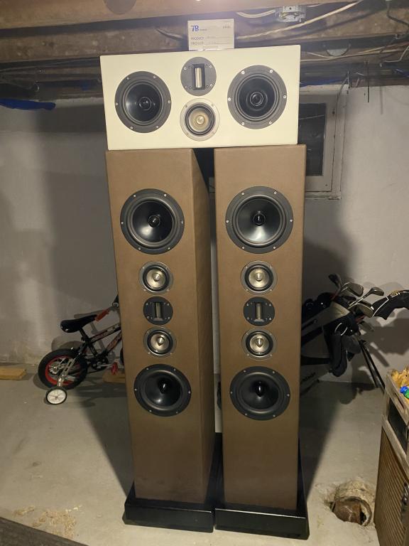

        One thing to consider is if the drivers will even work well in a in-wall situation. Do you by chance have a picture of the speakers?

          There will be all new boxes being built. I agree with keeping the originals, too. The previous owner/builder did a great job and I would feel horrible cutting them up.

          Here's a picture of the statements.

            Tall ceilings! It will be nice having that ceiling reflection so far away. How far are you going to be sitting away from your speakers? If you can set up sort of an equilateral triangle between your sitting position and the L&R frontspeakers that will help with imaging etc. Also, the L&R tweeters seem to be way too high.
            I say, haul these things to your listening area and let then woo for a few weeks, you know... temporarily.
