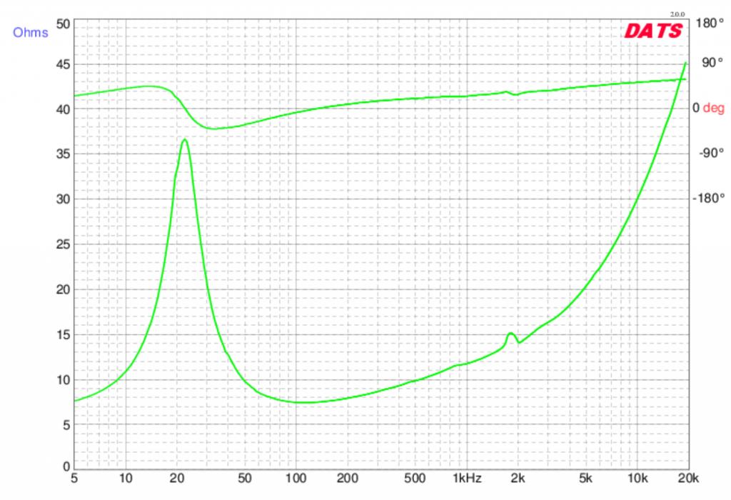

    • But that brings us to the option I had been pondering a long time, the conversion to using the Dayton Audio RSS315HFA-8 woofers, connected in parallel. This driver has T/S parameters not all that dissimilar to the NS12-513A, and wiring two 8 ohm drivers in parallel, instead of connecting two four ohm drivers in series, can give a pronounced sensitivity boost, 6-7 dB.
    • The RSS315HFA also can deliver 40% greater Xmax, not to be sneezed at.
    • Both drivers have their resonant breakup mode near 2kHz, and the big Dayton has pretty smooth response out to 1200Hz, making it quite suitable for a 300-400Hz crossover point, given the motor design and modest impedance rise.
    • Mechanically, the RSS315 is just slightly larger, but the gods of fate smile upon me, and it fits in the original cabinets OK. Well, an RSS315HF-4 does, and I don't think it's going to be any different in size than the four RSS315HFA-8 winging their way toward me since the middle of last week.
    • There was a Test Article 6 crossover developed but not yet built- all the parts are on hand, but obviously some components will need to change, especially the woofer crossover.

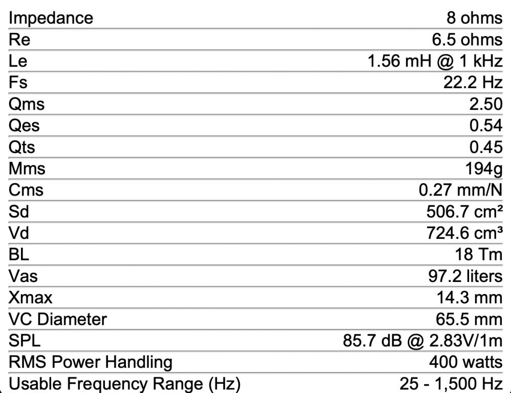

Name:	RSS315HFA-8 Impedance Factory.jpg

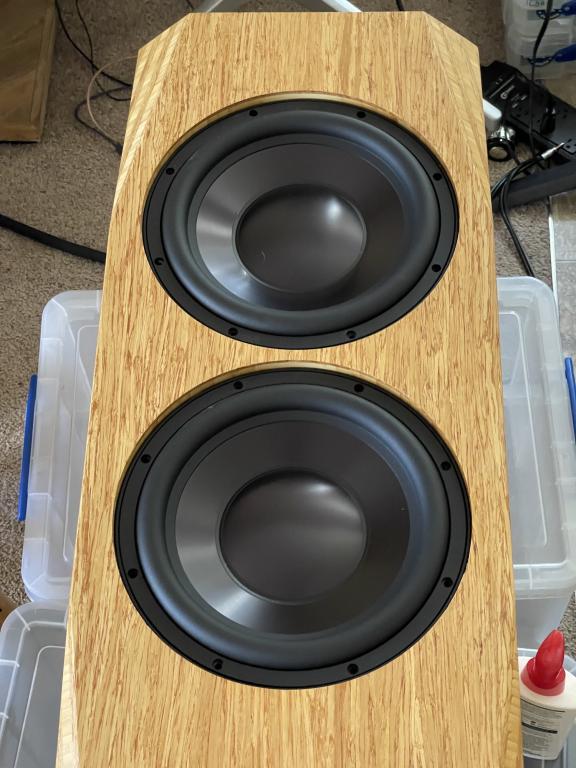

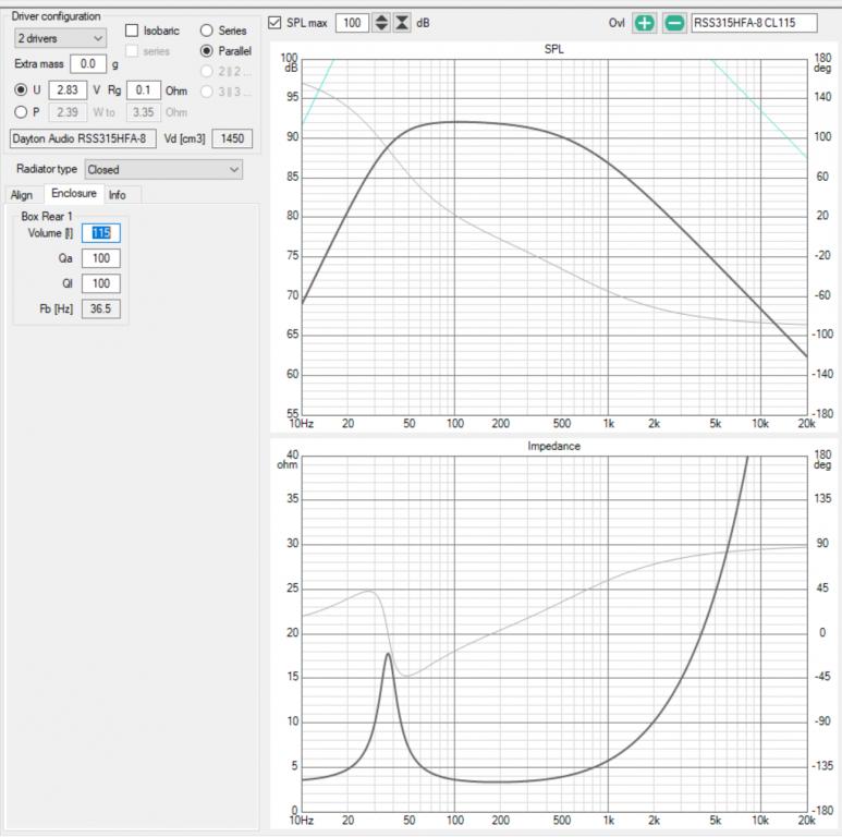

    Running the numbers looks pretty good in the same sealed enclosure- and of course could easily be improved with even just a modest 3dB Linkwitz Transform:
Name:	RSS315HFA-8 Sealed 2X 115LV2 CROP.jpg
    So, what are we waiting for, other than 4 drivers from PE?
    I'm going through the archives, and pulling out the stuff that could constitute a build guide, and updating the CAD drawings to add Metric values and clarify a few points...
    This one should move pretty fast... can you say, "Isiris summer camp"?

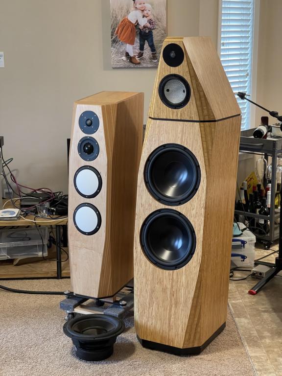

Name:	Isiris Living Room ready.jpg

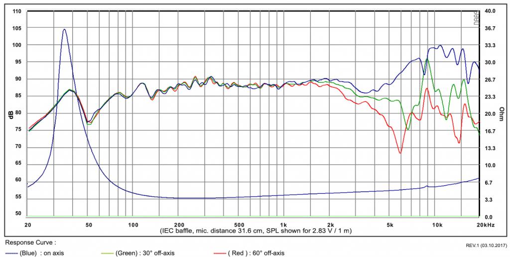

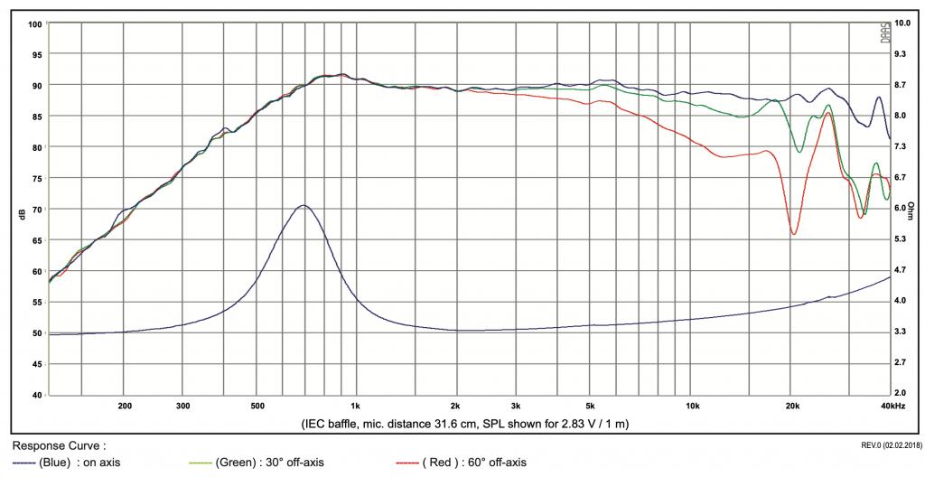

          The SB Ceramic 6" woofer
          Lest anyone forget what we're talking about with the SB ceramics, (and I know I have a pair or two on hand, but not sure which impedance)
          Because the frame diameter is 150mm, or 6x 25mm, I normally consider the SB15CAC30 a 6" driver, not a 5" driver. It's certainly too big to go places one would usually put a 5" driver.

                well, the wonders of modern FedEx tracking, those 4 ohm SB 6" ceramic-aluminum woofers from Madisound are now in Chicago today! I don't expect to actually be holding them in my hand until Sunday, when I get back from a working trip to CA. I have a reasonable test cabinet to pop them into in storage here, so checking them out won't be far down the road.
                Also, just to give you some idea of ways that a scaled down front baffle for the upper module might work out, here's comparison of the Osiris baffle next to an Isiris upper module. This will handle the DA25 tweeter, not problem, and obviously a wide range of more conventional ones, such as the SB26CDC-C0004, which is quite Scanspeak like in it's distortion behavior, and is planned for the CC type speaker for the TTC portfolio.
                The smaller the tweeter diameter, the smaller the top width of the cabinet can be made. I'm looking at something like this, but reducing the top width and increasing the bottom width from 12-1/2" to 14".

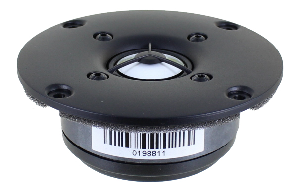

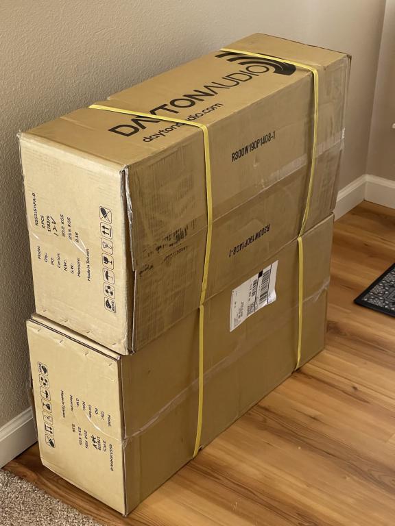

                        Vendors getting their pre-pandemic delivery Mo-Jo back!
                        And since progress is out most important product, good news to report!
                        But, since without pictures, it's not real, on the internet, and these days, half the time WITH pictures it's actually UNREAL, still for the record...
Name:	Daytons Delivered.jpg
                        And yes, those boxes are heavy! it would be an exaggeration to say that one of these RSS315HFA-8 drivers weighs as much as all four of the Neo NS12-513A, but ONLY a SLIGHT exaggeration!

                            With the Isiris built with the RSS315HFA-8, you have the sub built in- just use a small Linkwitz transform in the signal path, it could even be passive in the preamp path, just modify the voicing filter design.
                            With just a 3dB Linkwitz transform at 28 Hz, your F3 winds up being 28Hz, and your F6 22Hz, not factoring in boundary gain.

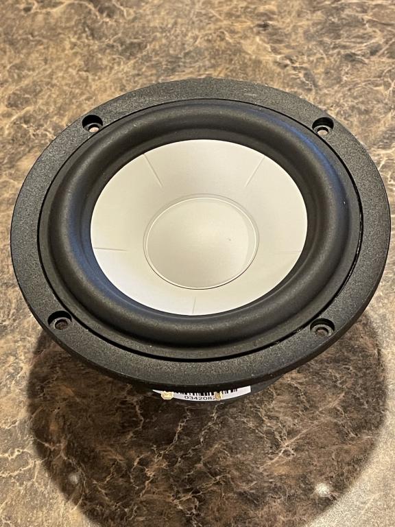

                              Unassuming looking in some regards, it may be the perfect maximum bang for the buck midrange.
                              Besides the smooth and extended SPL response, the other key to me is the very flat impedance curve, which is a fundamental signature about important motor characteristics.
Name:	SB15CAC30-4 Pic SS.jpg

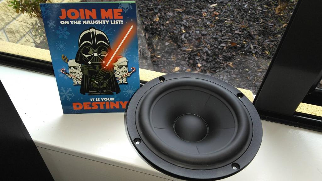

                                    Yeah, well, we're just keeping this one "out of sight, out of mind" with regards to ET for now. Since the original big guy Accuton midrange is obviously white, that seemed like a reasonable choice for a proposed baby version.
                                    Of course, the logical question ET would have, in all likelihood, is what is the destiny of that black aluminum cone version you have? Most likely the SB15NBAC30-4? The published data does look awful similar... a skeptic might be inclined to wonder if there actually is any acoustical benefit to the ceramic chemical etch process the CAC likely uses?

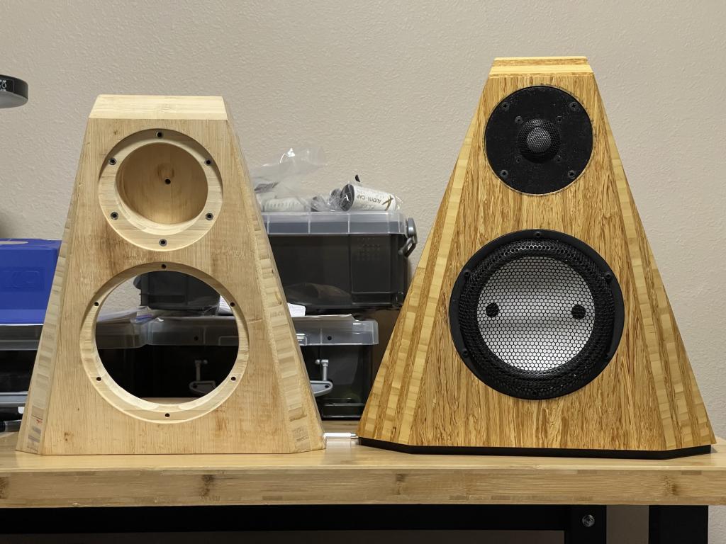

                                      You know, when you plan on upgrading something designed and built 8-9 years ago, you can't really count on things working out mechanically the way you hope...
                                      There's no planning ahead for a complete woofer upgrade in that time frame. And dimensions vary from driver to driver... as we all know...
Name:	RSS315HFA-8 CheckFit.jpg
                                      But some days we get lucky...
                                      And occasionally I'll be happy to settle for luck over skill and foresight!
                                      But are these cabinets ever going to be heavy with the new RSS315HFA woofers!

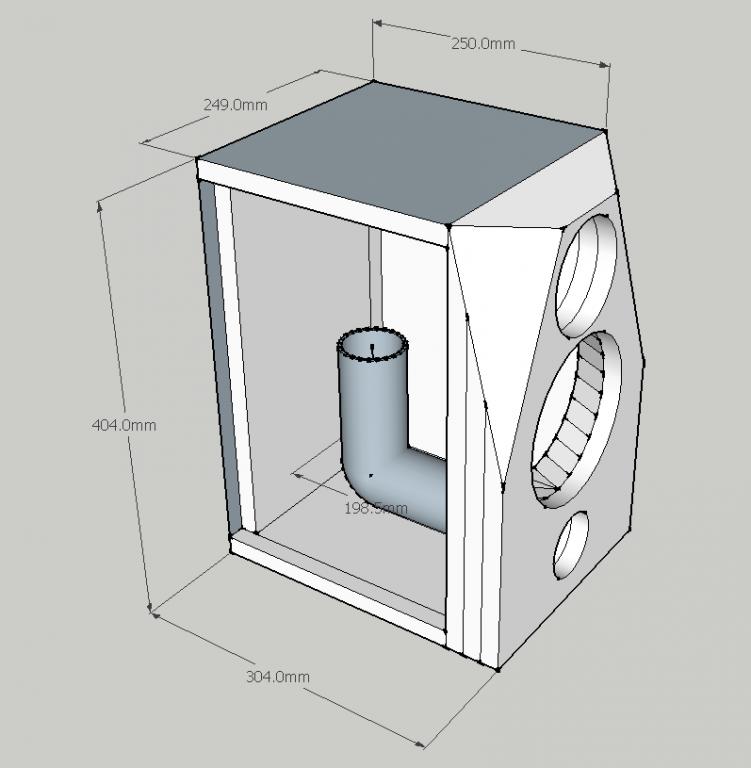

                                        Facet baffle
                                        2-channel active DSP via Raspberry Pi-3 piggy back Suptronics 7.1 DSP board using Linux and ecasound for the crossover
                                        Have a SBA Satori TW29D-B which I got on sale to pair with the SB17NBACs
                                        A small ported design will allow me to carry these to the local audio club I attend for some feedback.
Name:	Vented 2-way.jpg

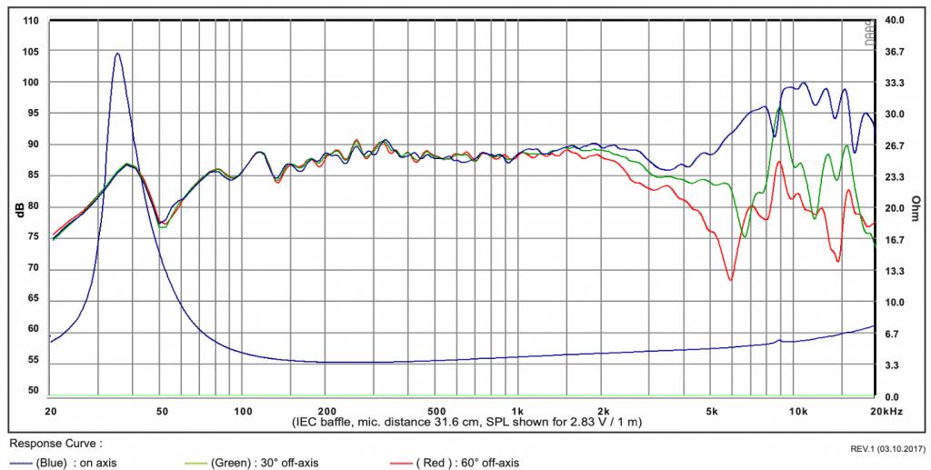

                                          Wow - if there ever ends up being a "budget" version of the Isris, I'm definitely interested.
                                          I've never built any of your designs, Johh, but I'm dying to try. Only the highest praise can be found on your designs.
                                          Is that the SB17CAC35-4? If so, you may find the following link helpful (if you are not aware of it already):
                                          Aparently its an excellent driver, with the only limitation being the low-end extenstion. Erin indicated he would be reluctant to use it below 80hz, and suggested its best use as a mid in a 3-way, as opposed to do dual-duty as mid&bass in a 2-way.

                                              Very close - your impedance senses are spot on. It is the SB17NBAC35-4. Not meaning to threadjack.... I am attempting a few simple concepts before I try an open baffle (likely a future disaster).
                                              Facet baffle
                                              [ATTACH=CONFIG]31195[/ATTACH]
                                              This looks like a lot of fun for a compact system- hope you can do some polar studies of the driver performance, including the TW29D-B. I did a lot of SB driver testing back in 2019, but didn't have the time available then to build anything! That situation is changing, but not as fast as I'd like- been a lot of work to do in retirement what with relocation to a different state, working on a home construction contract (mostly done, even the fine details now- but that all takes time!)
                                              Please keep us posted on how this little guy turns out!
