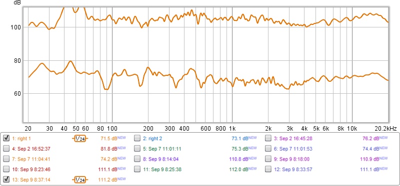

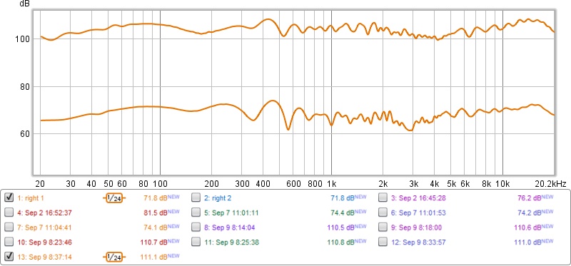

                      Active and passive Umik measure
                      I wanted to update this thread because I had questions about doing an active Statement 2 build and could find little online. Mostly due to my need to tinker, I switched my mid and tweeter networks back to active via a minidsp 2x4. I ran so sweeps with REW and a Umik before and after. I wanted to post the current results if anyone is curious.
                      The top is the current active measure and the bottom is the passive. 1/24th smoothing and gated to 10ms. The second graph is smoothed 1/24th but ungated. I will likely keep tinkering, but wanted to show some sweeps so far.
