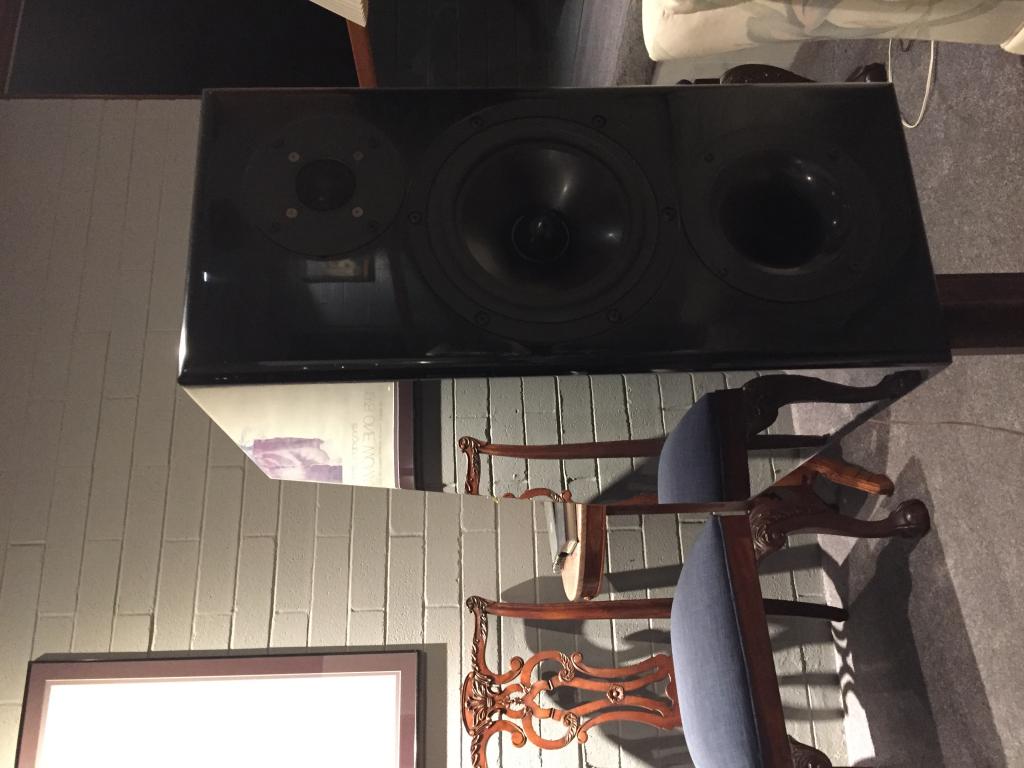

          How about this? Modula MTs I did in piano black for my son. Click image for larger version
          Just kidding. That was a lot of work. Maybe truck bedliner or something... I've never tried that...
