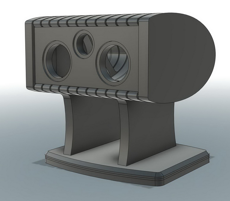

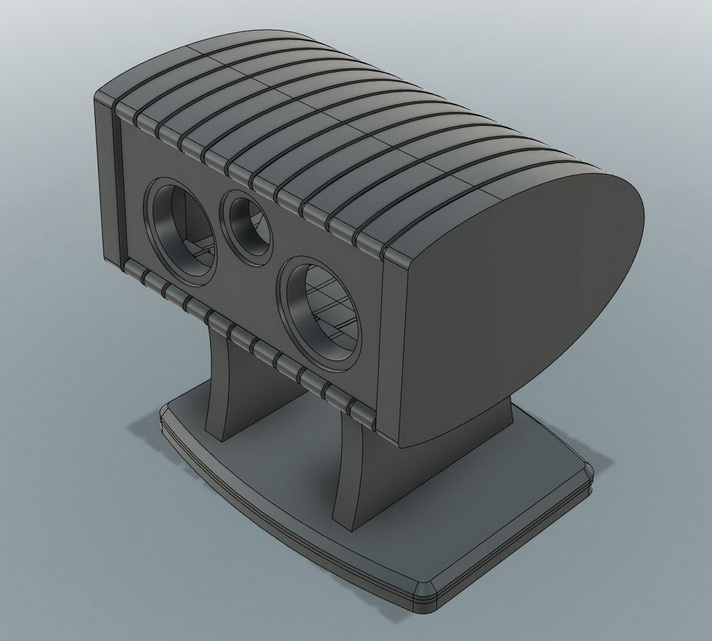

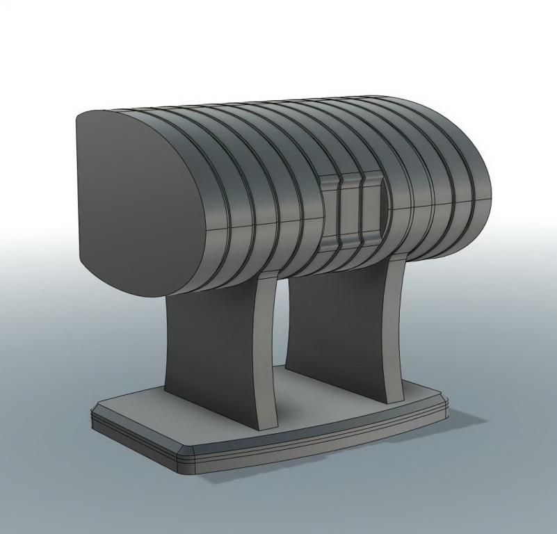

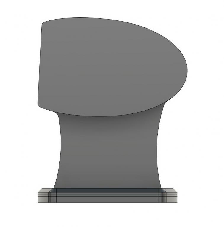

    Yes the pun is intended .... Since some folks have been asking for it,we are exploring some options for a new center channel. We are looking at both two and three way options. The renderings show the overall design profile. This cabinet is 1 cu ft and the top sits at ~24" high ..... those numbers can of course be modified. More details will be coming soon.

        OTOH, it might not hurt to reveal that my spies tell me many configurations and low frequency drivers are under consideration and development, including one very much based on these renderings, which is something of a more "budget" two way offering, while still using fairly high performance drivers, but also 3 way configurations having a passing relationship to the Ardent D, with several woofer possibilities, scaled to varying means and performance targets.

          Very exciting share Steve. I’m leaning towards a 3 way for the center channel. Will this use the Satori, Anarchy, or Accuton? Same tweeter as the Calliope I imagine?
          Painter in training
            • 1680
            Those are going to need a very low crossover point to keep the horizontal dispersion decent. Like way below normal tweeter range.
            The front looks like it's got plenty of room to fit in a small mid below the tweeter, even if it is just a Scan 10F. That'll easily go down to 500Hz and it has decent sensitivity too.
            I would not want to go to the rather extreme lengths of building a cabinet as elaborate as the one proposed just for a sideways mounted MTM and all the compromises they exhibit.
            Another option is to make the design a little wider, but less tall, and put a MR18/C18 coax between the bass drivers. Yeah this demands a three way but these speakers look like they aren't meant to be run of mill and that's what you'll get if you go sideways MTM.
              • 2135
              Hey Matt, at this point the renderings are conceptual and intended to fit in with the Calliope MT's and the SMJ Audio TTC cabinet concept in general. As with any of those cabinets, they can be made wider, narrower, what ever you need .... one of the intents behind the design in general. Since Jon will be doing his testing with more conventional "square" boxes that option would be open if folks wanted to go that way.
