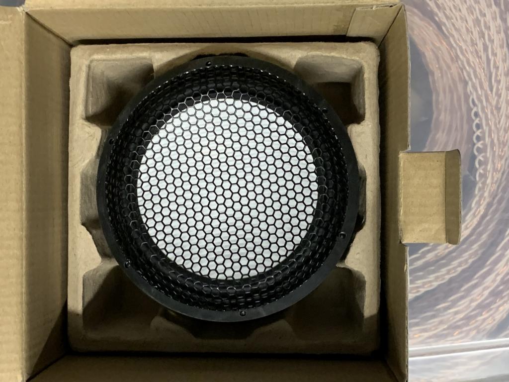

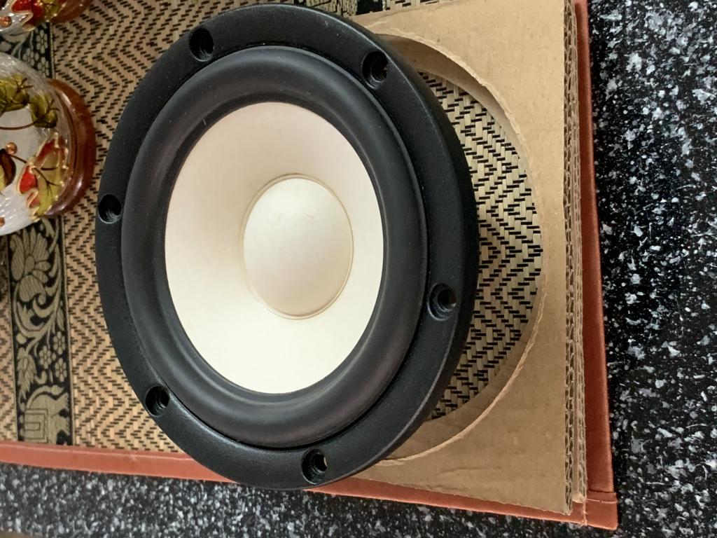

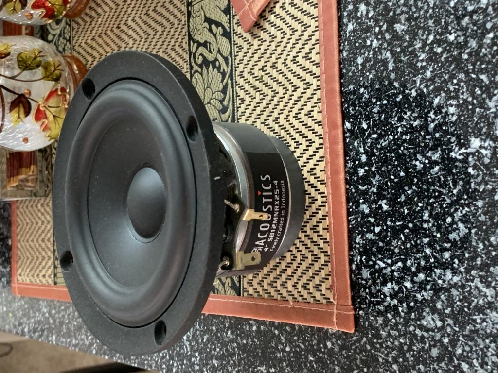

          In the meantime, for those that are curious, here are some clues....

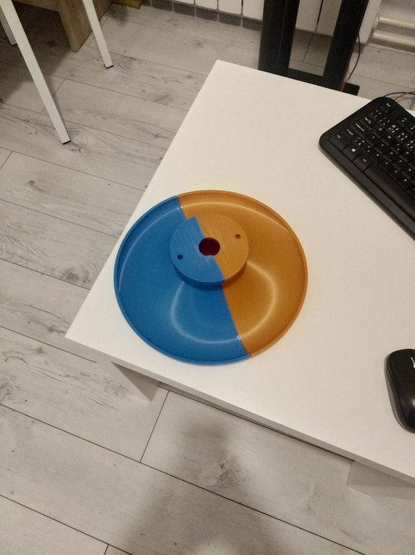

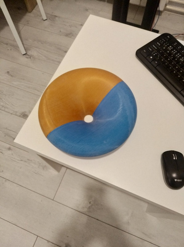

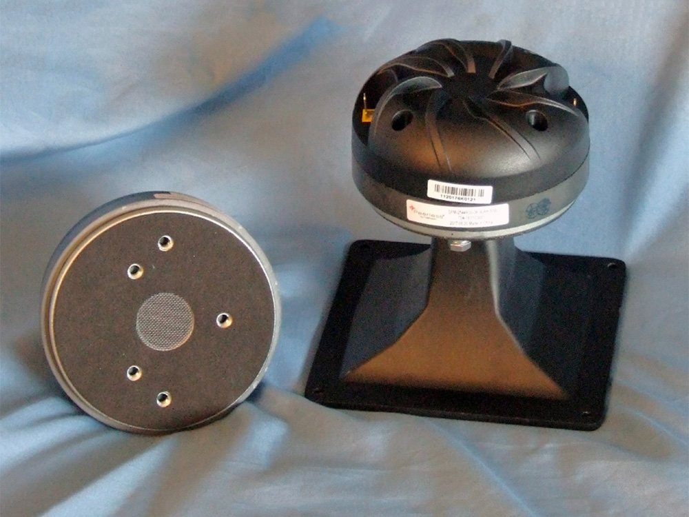

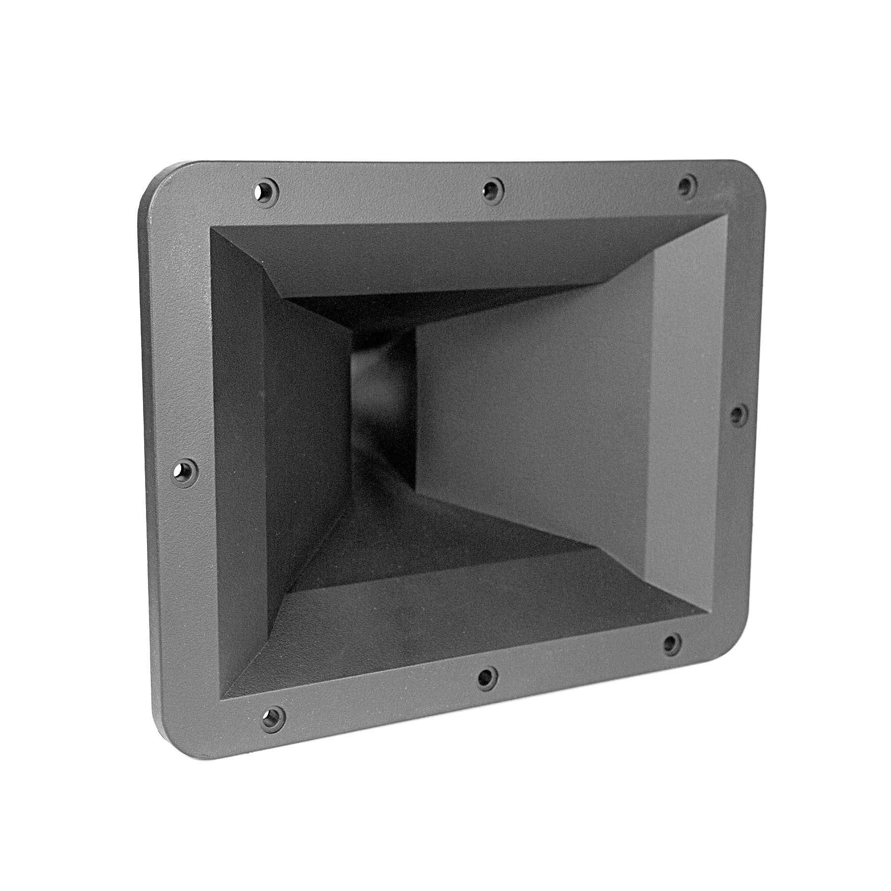

              THIS tweeters on THIS waveguide = very good combination. Usually i wouldn't recommend something from buyout but now with 3D printers it doesn't have to be available all the time. We just need one piece to replicate. Here are my measurements on axis and 45 degrees off axis 1m distance.
              Distortion, even bellow 1000Hz, is ridiculously low. I've opened it the second i received it. It has very nice titanium dome coated with some transparent stuff, with ventilated polyimide surround. Much nicer than the one in B&C DE250-8 i had before.

                  Originally posted by Zvu
                  THIS tweeters on THIS waveguide = very good combination. Usually i wouldn't recommend something from buyout but now with 3D printers id doesn't have to be available all the time. We just need one piece to replicate. Here are my measurements on axis and 45 degrees off axis 1m distance.
                  Were I a suspicious Sith Lord, I would suspect you have Rebel spies monitoring my shipments and emails with Steve... That tweeter was purchased earlier this year, but due to a change in Steve’s focus (he can convincingly channel Emperor Palpatine at times) the driver and associated waveguides were placed in carbonate storage in a secret location in the outer rim early last November.
                  This compression driver will receive close evaluations when time is available. When that will be is farther in the future than I prefer...
                  Now, wait a minute.... there is no such thing as a Sith Lord that is not suspicious...

                  • Zvu
                    • Oct 2013
                    • 436
                    Well, you may imagine how great disturbance in the Force was created by you acquiring those particular pieces of technology. There was a sudden shift of energy to the Dark side and only thing i could do is to get into possesion of the same technology to bring some balance to the Force. My Croatian friend was in your part of the Galaxy and asked me what can he do to help the resistance. He knew what i need before i said it - the Force is strong with him. And through the fire of Battle of Yavin and over asteroid fields his ship slided toward me. Lord Vader always had good taste for technology, but these pieces are exceptional.
                    @Ergo: My friend from Croatia bought one piece more just to hack and reverse engineer it. He wants to make it larger and with lipover. I wanted to do just lipover on these. I'll be playing with some paper and measuring gear to see what can be achieved regarding directivity and frequency response. Maybe i can talk him into sending you WG, when he finishes playing with it, if you are interested ?

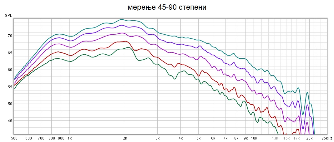

                      Zvu,
                      I believe I tried this combo before but wasn't about to get the smooth response you posted. I ended up returning the DFM-2535R00-08.
                      Mid you, I the waveguide was not mounted in any baffle - so I'm not sure if that was contributing to it.

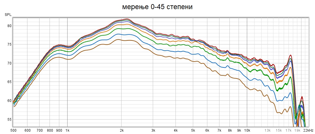

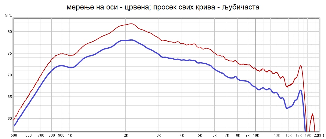

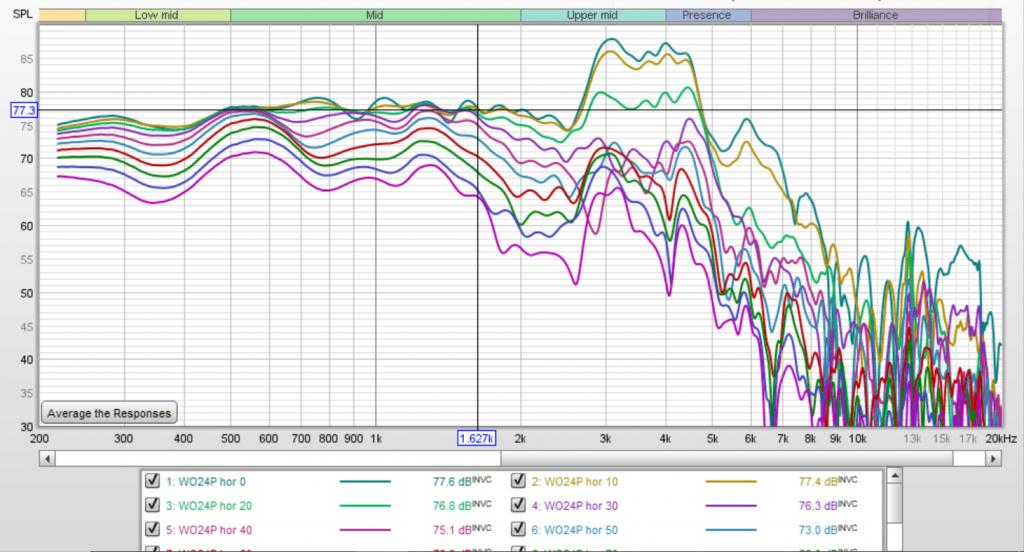

                        I see.
                        My measurements are also done without baffle, since i'll be using it that way. My best guess is that something could be wrong with your compression drivers or with mounting. Not too much, but some attention is needed when mounting the drivers to the waveguide to align the compression driver opening to waveguide throat.
                        Here's what my buddy measured, same combination of waveguide and compression driver:
                        Tesla; George Carlin;
                          ..on THIS waveguide..
                          copy of the QSC PL-000446-GP?
                          Brandon's (augerpro) measurements:
                          • Zvu
                            • Oct 2013
                            • 436
                            Yes. Obviously not an exact copy because it measures slightly different, better in my opinion. It could be because of the driver though.

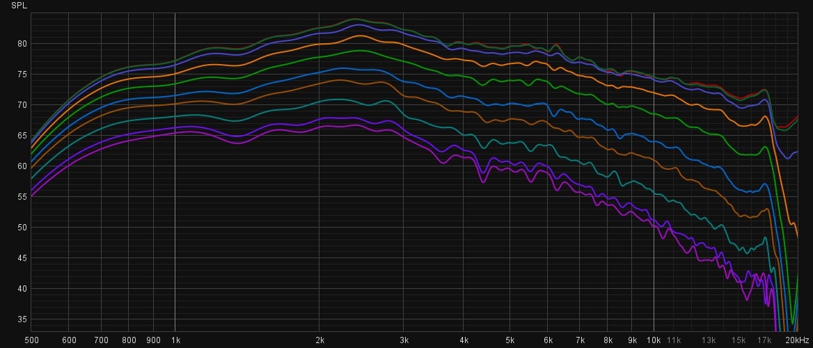

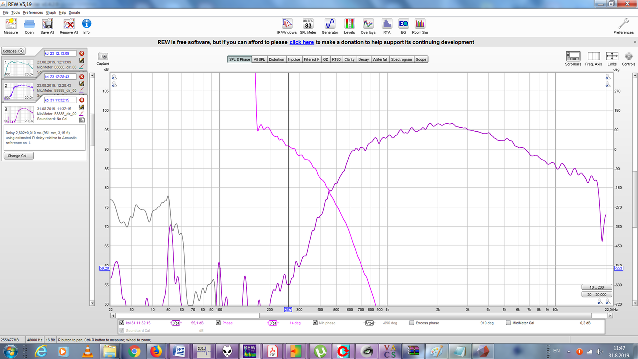

                                • Zvu
                                  • Oct 2013
                                  • 436

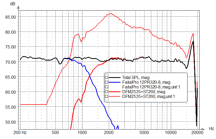

                                  I've played a bit with DFM2535/B52-WG and JBL 2202H. Sim for 2.5m listening distance. Slight loss of directivity is noticeable at low part of the tweeter response - a product of waveguide i guess since it is not visible in Vance Dickason's measurements. Not too shabby for an hour of play time with just on axis and 40 deg off axis responses. These really must be measured as Kimmo suggests in VituixCad manual to be able to avoid power response dip at 1600Hz. Everything beyond that is a guesstimation.
                                  Measured mounted in a 100cm x 55cm cabinet with JBL 2241H bass mounted bellow (biamped and active crossover for bass).

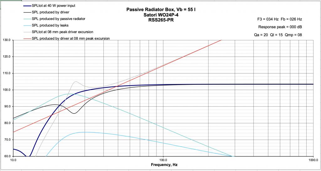

                                    Extensive modeling has been conducted with a number of passive radiator configurations and enclosure volumes (40L & 55L)-
                                    One of my favorites is this one-
Name:	WO24 55L Fb 26Hz.jpg
                                    Of course, while the 8 ohm version would lend itself to an MTM construction, it is most questionable whether droid coffins are desirable or tolerated in these challenging times.

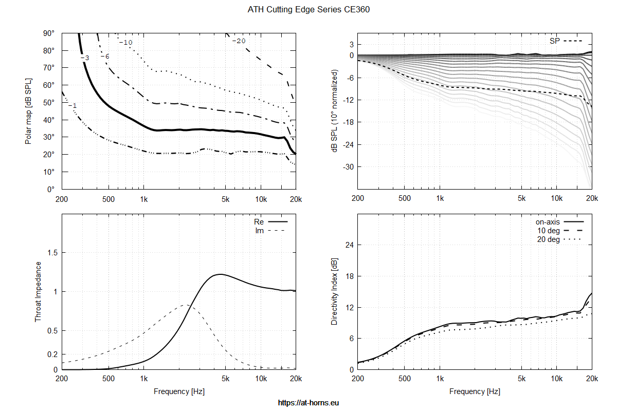

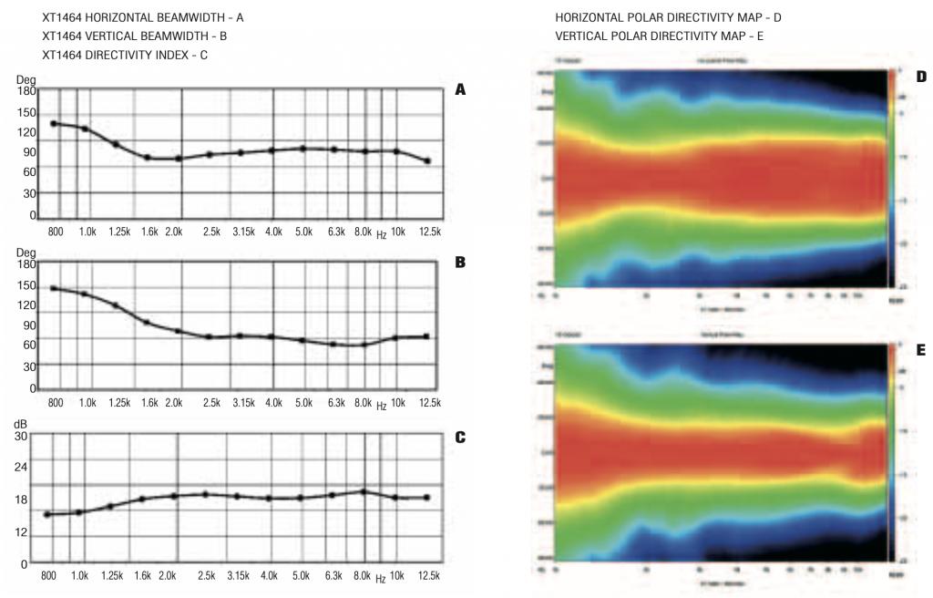

                                    After conducting a new review of some options with horns and waveguides, I still find myself drawn to the parameters of the Eighteen Sound parts-
Name:	Directivity XT1086.jpg
                                    My intuition is that the very consistent beam width and directivity with regards to frequency over a wide range will be a most agreeable characteristic...
                                    This is a quality I find sadly lacking in most competing products, even ones that superficially appear similar, such as the Faital LTH142.
                                    For the XT1086, one possibility I envision is pairing it with the SB MWP19, who's general performance has been verified in the Calliope design. Perhaps an MTM should even be considered... but along those lines, the PTT65X08NAA08 should merit serious consideration also.

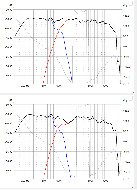

                                                AS190 test cabinet measurements, NO crossover- yes, baffle step is basically build in to the transfer function.
                                                Modeled low frequency transfer function for one LF group- consisting of AS190 and 2x PR223BD02, all in separate chambers from the others.
                                                Developmental crossover concept, Duelund transfer function, with early test data; subject to additional review after capturing data measured in the built cabinets instead of test enclosures.
                                                Note the carefully photoshopped room reflections apparent in the front panel of the cabinet- the finish process was redone three times before results were satisfactory. But this improved my skills in photoshop considerably, considering I normally never use it.

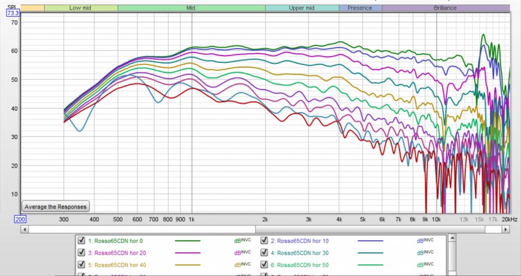

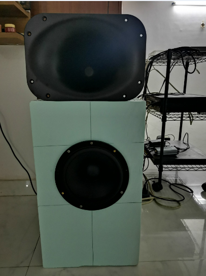

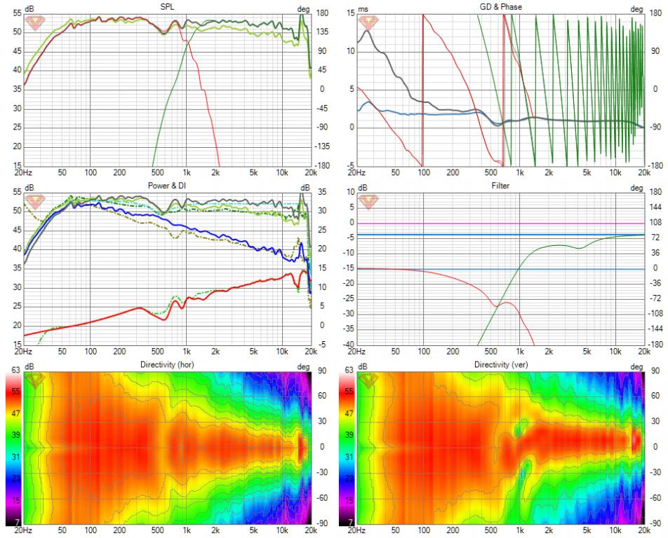

                                                          I personally am really excited about this project.. Eagerly looking forward to more developments
                                                          I don't have much experience building speakers but I had recently built a mock up/prototype using 1inch thick XPS foam for a 50ish liter box for the Satori WO24P-8 drivers and used an SB audience Rosso 65 CDN-T 1.4inch compression driver on a Faital pro LTH 142 horn.
                                                          Here are some pics of the prototype, the horizontal polar responses of the Satori, the CD on horn, and the DSP crossover I did quickly and heard

                                                          Even with this level of immature crososver design I did, it sounded very nice to my ears..

                                                          Vineeth
                                                            As you might guess, my first suggestion to you would be to swap the LTH142 (which I have tested- see above) for an Eighteen Sound XT1464.
                                                            These are available at LousdpeakersPlus for about $85 plus shipping.
                                                            Compare your directivity maps with their specification, which is born out in other 3rd party measurements.
                                                            • vineethkumar01
                                                              • Aug 2020
                                                              • 11
                                                              Thank you.
                                                              I just experimented with this faital of the horn since it was readily available and XT1464 was not available with any dealers in my country.
                                                              I will try and get the 18 sound ones later.
                                                              Will eagerly follow this project to study how the concept develops.

                                                                A new batch of WO24P-4 have just arrived from my Estonian vendor...
Name:	WO24P-4 arrived.jpg

                                                                  Test results can be seen here:
                                                                  In this Test Bench, Vance Dickason examines the Peerless by Tymphany DFM-2544R00-08 compression driver, which is part of the brand’s new three model compression driver series. The compression driver features a 1” throat exit diameter, but with a 1.75” titanium diaphragm and the same type of polyimide surround. The DFM-2544R00-08 is driven by a 44.4 mm diameter voice coil wound with aluminum wire on a TIL film non-conducting former. This article was originally published in Voice Coil, March 2018.
                                                                  As tested by Audio Express/VoiceCoil, it looks like this, using a B&C ME20, which is not the optimal performance choice, IMO, but is inexpensive:
                                                                  It should be interesting to see how it pairs with the ME90 or with the Eighteen Sound constant directivity horn. The response to 30 degrees with that horn is fairly good, but measuring beyond the directivity rating of a horn is kind of pointless.

                                                                    Note: a rather excellent horn was used for the Audio Express test of that driver, and it is NOT what was reported in that driver/horn's test report.
                                                                    This Test Bench examines the first compression driver in the company’s new three model line from Peerless by Tymphany, the DFM-2535R00-08.
                                                                    This is the actual horn (and a bit of a bargain for its bandwidth vs. size w/ reasonably good *off-axis performance):

                                                                      I'll be free to post some of my findings regarding Peerless and freestanding ST260 waveguide. Copy/paste from other forum:
                                                                      This evening my friend and i measured Peerless DFM2535R00-08 on Mabat's ST260 waveguide.
                                                                      Measurements are done from 1m distance with calibrated Behringer ECM8000, Steinberg UR12 and gate frequency of 4.4ms so enough to capture trends of this waveguide. What is shown here are measurements 0-90 degrees with ≈7.5 deg increments in between. Since i did not calibrate REW and my mic for loudness, SPL levels shown aren't representative of actual SPL level. Off axis measurements 60 degrees and up are smoothed 1/48 to avoid "hair" at higher frequencies.
                                                                      0-90 degrees
                                                                      0-45 degress
                                                                      45-90 degrees
                                                                      75dB vs 85dB loudness
                                                                      measurement on axis (red) and averaged 0-90 degrees (purple)
                                                                      printed waveguide
                                                                      I must say that i've never seen better and more extended frequency response from a smaller waveguide (26 centimeters in diameter, 8.5 centimeters deep) and a cheaper compression driver.
                                                                      Later on my friend and i measured st260 and Peerless, this time with 13ms gate mounted on top of a cabinet to see if it influences frequency response in any meaningful way. Mic height is the same as waveguide center, right at 3 meters from the floor.
                                                                      This is a passive crossover sim on axis with FaitalPRO 12pr320-8 and DFM2535 in ST260. Red response represents raw tweeter with 13ms gate time.
                                                                      Printing a waveguide costed about 50 euros and was done with 0.2mm nozzle and 20% infill by a small local company. Files for printing can be obtained on the link bellow.

                                                                      Something similar happened to TC9FD18-08 a while ago - it was almost discontinued. So, fingers crossed

                                                                          Highlight for me is Marcel Batik's waveguide designed with his freeware ATH4.
                                                                          https://at-horns.eu/
                                                                          https://www.diyaudio.com/community/t...y-ath4.338806/
                                                                          You can design a waveguide as you see fit. Custom dispersion, custom cutoff, axisymmetric or with different H+V dispersions.
                                                                          Marcel (aka Mabat) designed ST260 waveguide and with such a small waveguide you easily get controlled and constant directivity down to waveguide cavity resonance at 850Hz. I was in awe when i measured it.
                                                                          Download a file, print it anywhere in the world, attach a 40 euro compression driver and you get level of performance i measured. About the driver, a guy from Bavaria contacted Tymphany and, surprisingly, got an answer. There is some chain of supply problem and until it is sorted out, it will be unavailable.

                                                                                      Simulation for CE360 waveguide
                                                                                      [img]https://i.postimg.cc/TpBZM6qP/CE360.png[/img]
                                                                                      https://i.postimg.cc/2S5mWj1n/CE360.png
                                                                                      Measurements 0-90 of DEF2535R00-08 in CE360
