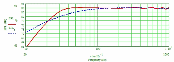

        Originally posted by joecarrow
        Very interesting, Dan! I have to say, I'm a bit concerned about the transmission line. In my experience with modeling them in Martin King's worksheets, you don't often get a size advantage from going TL. 20:1 also seems like a fairly extreme taper. Do you have everything you need to run a simulation? Just running that box size and geometry could work fine sealed, so I don't think you'll run into ill effects... just not sure if there will be much TL action to make it worth any extra effort.
        I'll be sure to chime in on the new thread.
        Hi Joe,
        Looking forward to it!
        I had Paul Kittinger model the Tline. He's done a lot of them and knows what he is doing, so I'm pretty confindent in it. I'll post his graphs when I start the new thread. F3 of 29-30hz and F10 under 20 in a 1.1 ft3 enclosre sounds pretty inviting to me. Actually, here is the modeled TL FR graph, attached.
        As I recall, the sealed F3 was in the mid 40's. For a qtc of .7, with a heavily filled box, the size was a little under 16L, in Unobox, IIRC.
