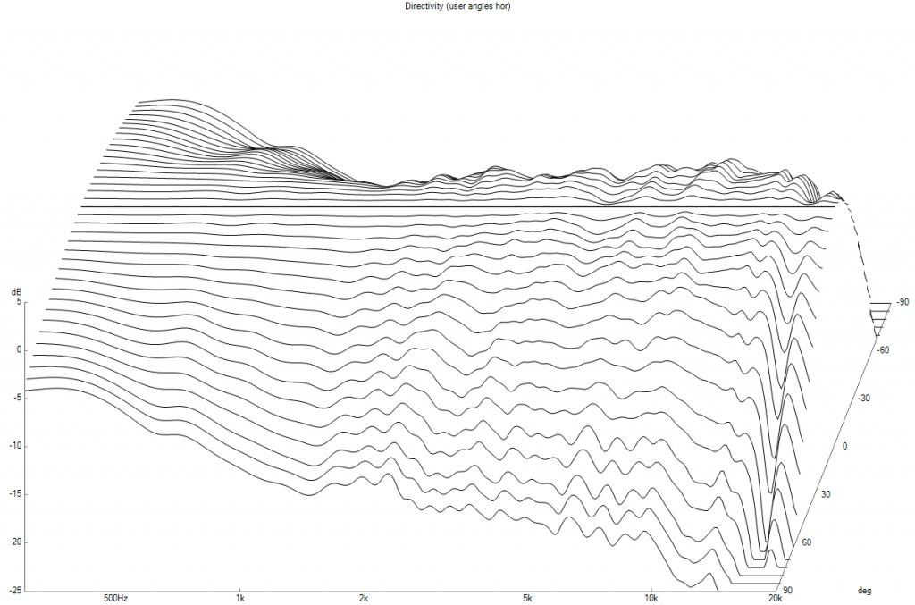

                Possible to imitate MLSSA waterfalls. Line ending to angle axis and pointer done too.
                • sheeple
                  • May 2021
                  • 6
                  #143
                  Kind of foreseable, I am very much in fond of this sort of representation, thanks for this evaluative implementation. This is a great addition to polar maps/sonograms and the spinorama display, which both are very helpful in their repective ways. Do I understand it correctly: Line ending to angle axis is already possible (as in MLSSA, slices reach down to scale base, ?)? Having a printable marker as in the MLSSA screens or as an option/checkbox in REW could make things even a bit easier: The possibility do directly point at some issue with precise data points in a discussion has use value. As this marker is a live option in the Power & DI window already, maybe setting a temporary marker which shows up on exported image is also possible. If that is too complicated, finer steps in frequency could help, too.

                                                                                      • kimmosto
                                                                                        • 723
                                                                                        #178
                                                                                        Originally posted by sheeple
                                                                                        would you find it worthwhile to add a separate "Adjust rotation" dialogue to the waterfall plot?
                                                                                        Whole idea of adding waterfall was to maintain correct/original tilt of frequency responses. Surface chart is for free 3D rotation (without axes).
                                                                                        also the shading style.
                                                                                        Polar map has coloring by magnitude. Waterfall has correct/original tilt of frequency responses so color can be associated for angle to be compatible with other directivity chart(s) with frequency response traces. For example Line chart has legend in copy/export which needs color by angle.
                                                                                        • kimmosto
