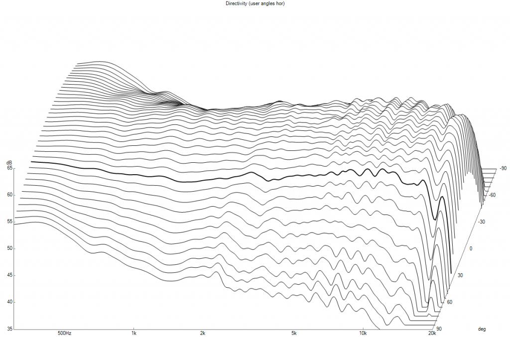

                  Kind of foreseable, I am very much in fond of this sort of representation, thanks for this evaluative implementation. This is a great addition to polar maps/sonograms and the spinorama display, which both are very helpful in their repective ways. Do I understand it correctly: Line ending to angle axis is already possible (as in MLSSA, slices reach down to scale base, ?)? Having a printable marker as in the MLSSA screens or as an option/checkbox in REW could make things even a bit easier: The possibility do directly point at some issue with precise data points in a discussion has use value. As this marker is a live option in the Power & DI window already, maybe setting a temporary marker which shows up on exported image is also possible. If that is too complicated, finer steps in frequency could help, too.

                        I agree that free rotation is a neat feature to hone in on a problem area. But the perspective in MLSSA charts also seems to be chosen very well and should not be omitted. Above normalized axis, off-axis trends which can be expected to reach listening position without reflection are emphasized in visual contour, below in the foreground, higher off-axis angles streched out. The difference of whom can easily be understood. I also agree it could be helpful to see dB levels, i.e. to find out where -6 dB is reached.

                            Normalizing to 0-axis can be limiting, as one would generally like to design for average listening window and accept a deviation on-axis. Nomalizing to 0-axis could give the impression of issues which were actually an accepted trade-off in listening window angles. There is still the option to not normalize, the easily available directivity information this sort of graph offers is still there:

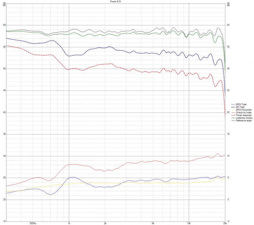

                            At least for me, I find it easier to understand i. e. the performance weakness of the waveguide used (in the case of this graphs the differences begin at ~40 degrees off-axis), as compared to in a sonogram alone. In sonogram, I need to chase areas with the marker or set different levels to see the problem unfold into it's depth-axis. Also, a full spinorama is much more powerfull than this sort of graph, sure. It is good to start with spinorama. They relate to another as in general performance vs. detailed area of interest. What I see from spinorama sort of graph is the difference between early reflextions and listening window, but I do not see as precise the directivity issues and why I hit limits.
Name:	speaker68 Power+DI.jpg

                                                                                    Originally posted by ph73
                                                                                    Would it be a bad idea to add optimization of the DI curve as an option?
                                                                                    DI alone is not possible to optimize. Either axial (on-axis or LW) or sound power response is also needed to get some sense and quality to result. So in practice weighted combination of axial and power is the same as weighted combination of DI and axial or power.

                                                                                        would you find it worthwhile to add a separate "Adjust rotation" dialogue to the waterfall plot?
                                                                                        Whole idea of adding waterfall was to maintain correct/original tilt of frequency responses. Surface chart is for free 3D rotation (without axes).
                                                                                        Originally posted by sheeple
                                                                                        also the shading style.
                                                                                        Polar map has coloring by magnitude. Waterfall has correct/original tilt of frequency responses so color can be associated for angle to be compatible with other directivity chart(s) with frequency response traces. For example Line chart has legend in copy/export which needs color by angle.
