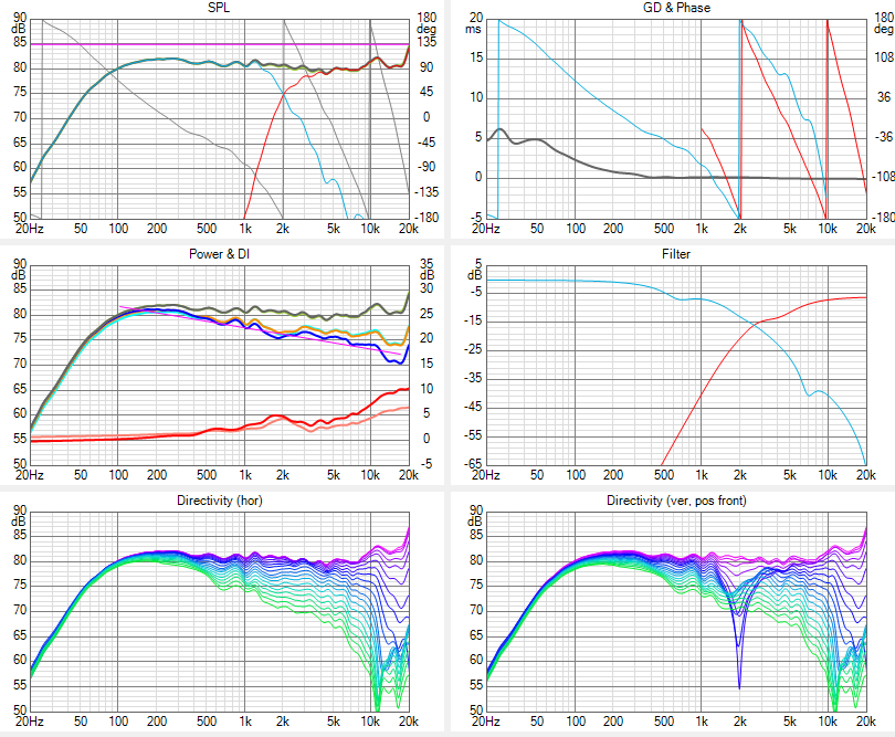

          ^I would prefer two front woofers and two side woofers over W371 concept to get wider cardioid frequence range. Just like lower half of Kii BXT's woofer section, but e.g. with 4x12" drivers for each speaker. Internal walls between front and side woofers could leak through damping material to enable smaller volumes.
          Active filter looks like this. Delay for side woofers is produced simply with extra 2nd order low-pass filter which also reduces mid-range noise to back (to be more compatible with front wave). Directivity of cones attenuate HF noise to back. Low-pass for delay can also be 2nd order passive L+C.

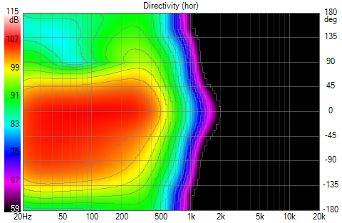

              maybe this will work for the image
              (edited by administrator... I attached the image to your post, as dropbox doesn't work with hot linked images)

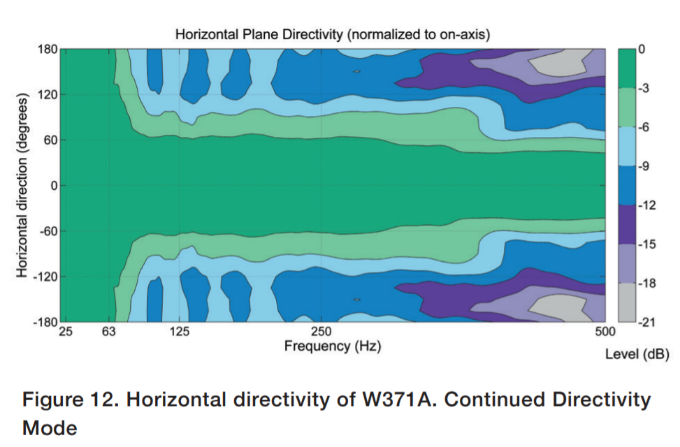

                I have the Faital 15" driver to cross over to a horn above from 500 to 800Hz depending on prototype measurements. The directivity of the W371 intrigued me as it looks pretty well controlled up towards the horn crossover range but transitions back to monopole below 80Hz. This seemed like it could still be efficient at the lowest frequencies but improve room response interaction in the 200 to 500 Hz range.
Name:	Continued Directivity.png
                What do you think is the advantage or disadvantage between this and the side woofer scheme?
                Using the 4 x 12 arrangement below the 15" woofer would be nice but it is a lot of extra drivers to purchase, food for thought.

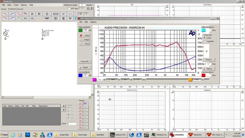

                                          Hey Kimmosto I have a question. I have your software on two of my computers, a laptop running win 8.2 and my desktop running win 7. On my laptop all is good but I much prefer my desktop but there is a problem in the way the GUI is displayed. Some of the program is displayed truncated with parts of it inaccessible because it's outside of the viewable window and you can't make it any larger. This is especially prevalent with the SPL tracer tool where some of the data entry boxes aren't visible. Is this common or is there an easy fix?
                                          Thanks for any help you can give.Click image for larger version
                                              I've seen that. I think it's display zooming which must be 100% on Win 7 and probably also Win 8. Win 10 is the first one where display zooming >100% actually works i.e. different Microsoft products support each other .NET Framework and operating system in this case.

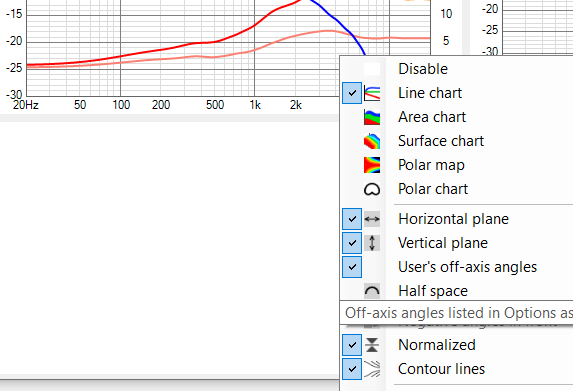

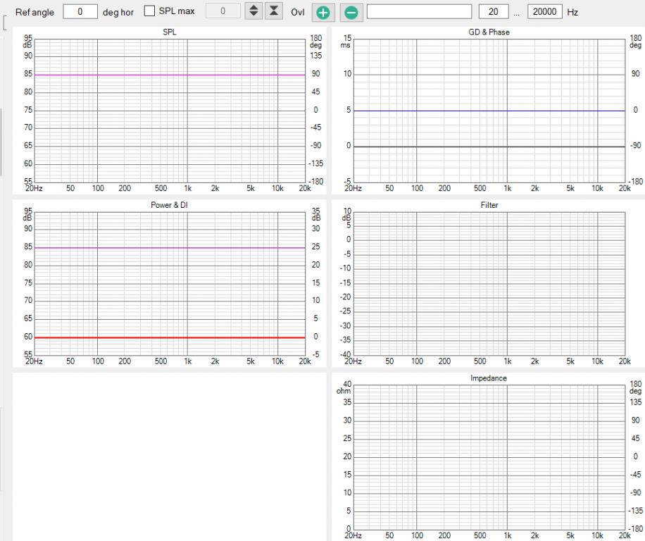

                                                                            I don't know if something is wrong or if I am missing something but the directivity graph seems to have disappeared for me in the latest version. It is blank and when I right click on it to select polar chart or any other option it doesn't change. It is the same whether I have a driver loaded or not. I'm using Windows 10.
Name:	Polar Plot missing.jpg
                                                                            • kimmosto
                                                                              • 712
                                                                              #128
                                                                              ^Two possible reasons:
                                                                              1) 'Disabled' selected in context menu of directivity chart.
                                                                              2) Angle step = 0 deg in Options and no frequency responses loaded to Drivers tab.
                                                                              Angle step = 0 deg stands for "measured directions only" so empty response list is kinda logical problem, though initial flat response exists also without loaded data.

                                                                                Line Chart is selected by default but I cannot select anything other than that or disabled. The power and DI works as expected when off axis angles are loaded
                                                                                The Angle is set to 10 in the options

                                                                                  #130
                                                                                  2.0.72.0 (2021-05-26)
                                                                                  Main
                                                                                  * Impedance chart can be replaced with second directivity chart e.g. to show both planes at the same time. Visible chart is selected with context menu.
                                                                                  * Polar chart overlays not deleted if chart type does not change.
                                                                                  * Added dashed line support to polar chart.
                                                                                  * Added legend to polar chart export as svg file.
                                                                                  * Aspect ratio set in Options window forced to Power&DI and Directivity exports as svg file.
                                                                                  * Added Hor/Ver plane to trace description of polar chart.
                                                                                  * Frequency scrollbar relocated to serve both polar charts as zoomed.
                                                                                  Convert IR to FR
                                                                                  * Added Bartlett, Blackman, Blackman-Harris, Blackman-Nuttall, Cosine, Hamming and Nuttall window functions.
                                                                                  This change was huge, but major bugs should not exist. Second directivity chart is full featured expect that settings are not saved to user config or project file. It starts as (disabled) Line chart with plane opposite to primary directivity chart. Other settings are program defaults.
                                                                                    That sounds something I can't control. Win updates and reboots could help. Have you checked that file naming is okay i.e. angle parsing works?
                                                                                    • kimmosto
                                                                                      • 712
                                                                                      #132
                                                                                      Found! User's angles are checked. Uncheck that if you have not listed custom angles to Options.
                                                                                      • fluid
                                                                                        • May 2021
                                                                                        • 15
                                                                                        #133
                                                                                        Thanks, that did the trick
                                                                                        • kimmosto
                                                                                          • 712
                                                                                          #134
                                                                                          Just uploaded new build of 2.0.72 which prevents that situation.
                                                                                          - Not possible to check 'User's off-axis angles' if both angle lists in Options are empty.
                                                                                          - Status of 'User's off-axis angles' is saved to and read from project file if angle lists contain something. This is for those who measure and simulate just custom angles, but nothing else.
