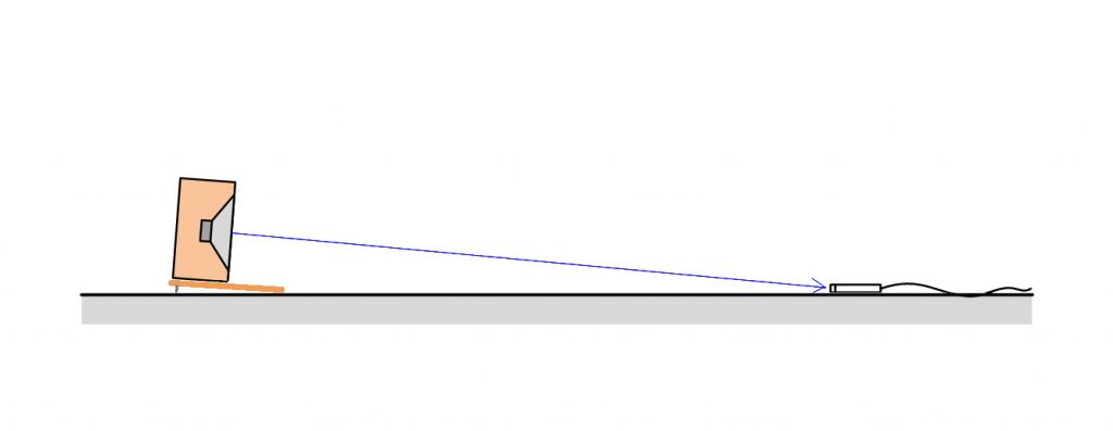

                    Seems I have missed you by a few hours for my first question on DIYaudio
                    Is it valid to correct ground plane measurements by the difference of the diffraction simulations with normal baffle height and twice the baffle height? And if so, am I to apply that correction to the off-axis measurements as well? (https://i.ibb.co/ydgFD3y/diffraktion.png)
                    I got lucky and have epoxy screed floor in my garage, so a twice as long window for quasi anechoic measurements with the speaker on the floor compared to the speaker at half the room height.
                    And thanks for everything you've done for the DIY audio community. VituixCAD was a game changer for me!
                    • kimmosto
                      • 723
                      Ground plane measurements are far field measurements => goal is to measure so that mathematical corrections to response shape are not needed i.e. responses are directly valid for HF response list of Merger tool with level scaling by -6 dB only. One error source with ground plane is that (small) speaker on the floor is not exactly the same as speaker on final stand due to differences in baffle loss and diffraction. One workaround is to make small stand to cause diffraction and baffle loss also below bottom panel, and tilt speaker down so that DUT points to microphone while measuring 0 deg response. Rotation center should stay in the center point of DUT on baffle surface, and manual rotating table should be thin or extended to mic or some other invention to avoid diffraction from ground plane. This kind of tricks are easier with small speakers. Tall constructions need supports, turning upside down etc.

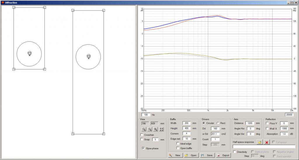

                        Diffraction simulation is needed for conversion from near field LF measurement to far field LF response to full space. Sometimes for generating directivity for single axial LF response of boxed driver. Diffraction simulation with double height could be useful to imitate change in baffle loss caused by vicinity of the floor if position of the woofer is very close to floor e.g. 20 cm. Diffraction tool cannot seal gap between bottom panel and floor so double height is cheap trick to reduce error.

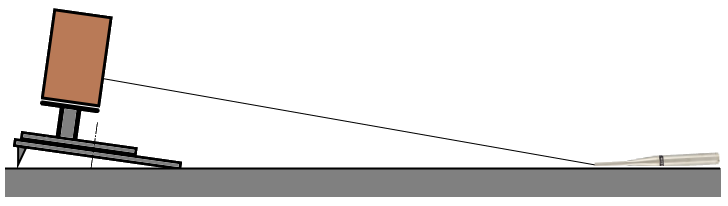

                          Originally posted by kimmosto
                          ...tilt speaker down so that DUT points to microphone while measuring 0 deg response. Rotation center should stay in the center point of DUT on baffle surface
                          Problem with this is that hor 180 deg measurement is not 0 deg in vertical plane if rotating table is horizontal on the floor. So rotating device should be short axis which is tilted front - towards mic

                            I'm planning on getting a square board and add some height-adjustable feet on the back, so I can angle the speaker at the microphone and rotate the speaker on the board manually while staying in that plane and distance. I can't imagine an easy way to make this with a stand :/ With a second, thinner board on the first one and a nail I might even create a turntable, if turning it manually gets too annoying.
                            So there will be changes in frequency response and while they are minor as the simulation shows (at max 1dB), they are broadband. It's easy to correct the FR for this deviation, so why not? After all - cheap trick or not - it should be closer to the actual response of the speaker when used 'normally', right?

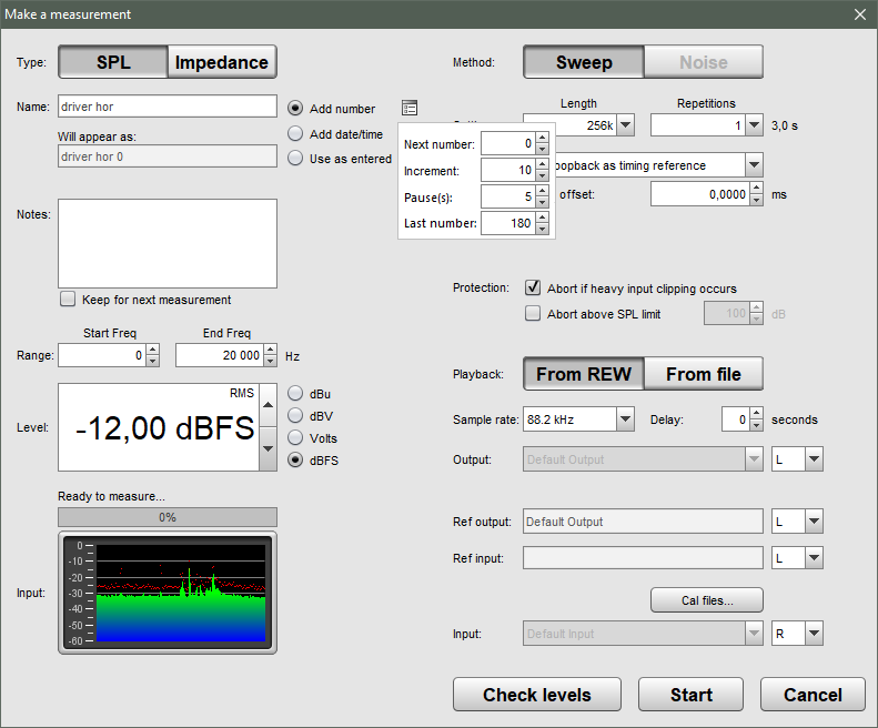

                                              I am using ARTA for measurements but have recently tried REW, and all works fine.
                                              However, as far as I can tell, there is no auto signal generating sequence (which ARTA has) so it makes for many jumps from the measuring stand for the (manual) next rotation and back to the PC desk for hitting the start button.
                                              Or there is such an option with REW that I am not aware of?
                                              • kimmosto
                                                • 723
                                                There is no auto continue with pause, but someone could ask it from JohnPM. Needs Pause and Last number parameters to auto numbering window. Would be close to ARTA and ARTA Recorder. Hitting start is required if pause = 0 s (or separate Auto/Manual radio buttons or listbox). Something like this
