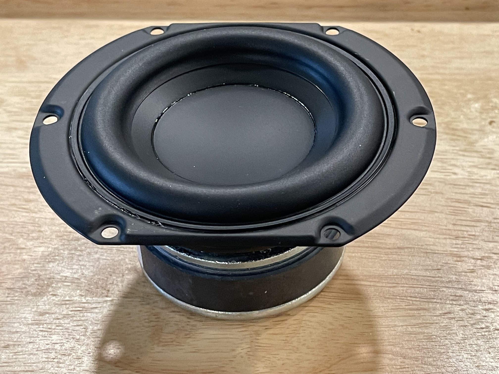

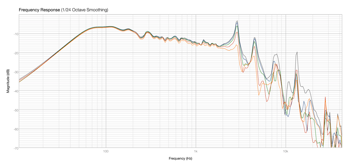

      So, on hand? Hmmm, how about some SDS-100F25CP09 Peerless ODM woofer parts that I was shipped by mistake from my French Connection? Nice truncated frame, nice controlled response profile with a sort of built in baffle step compensation for a small enclosure, and smooth out to beyond 2kHz.

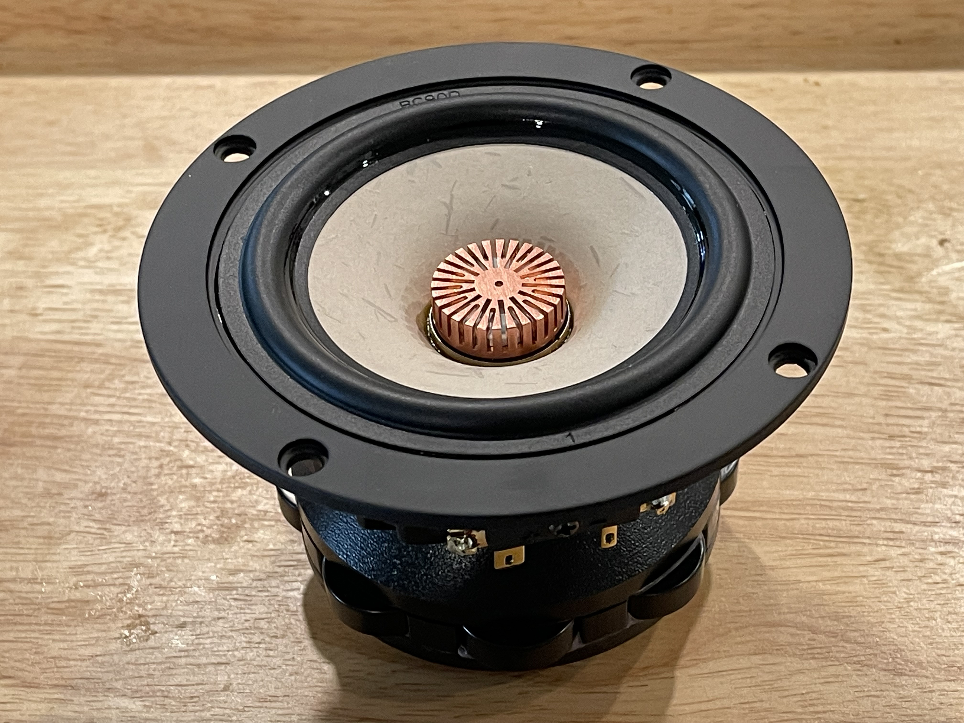

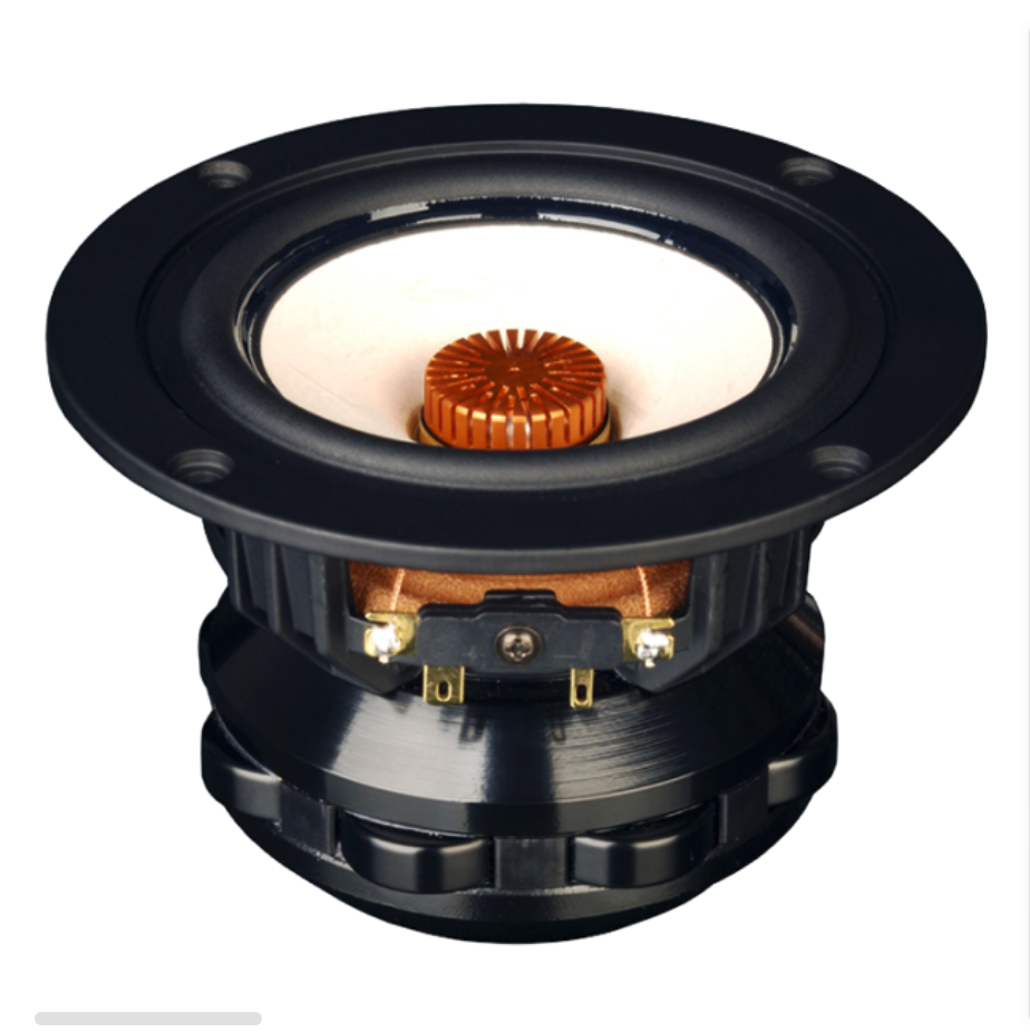

      Now, for the mids and highs, simplify! Not a coax, but a full range.... Mmm, maybe something like one of those weird Tangband parts with an underhung motory and really linear Bl, for lower distortion, with one of their bamboo cones (Steve and I are fans of bamboo, so many things you can do with it!) and throw in an unusual phase diffuser design to aid the off axis HF performance...

      Let's say, if we want to punch a bit more SPL, we use two of the Peerless on each side. The truncated frame may aid the spacing a bit... have to investigate that.

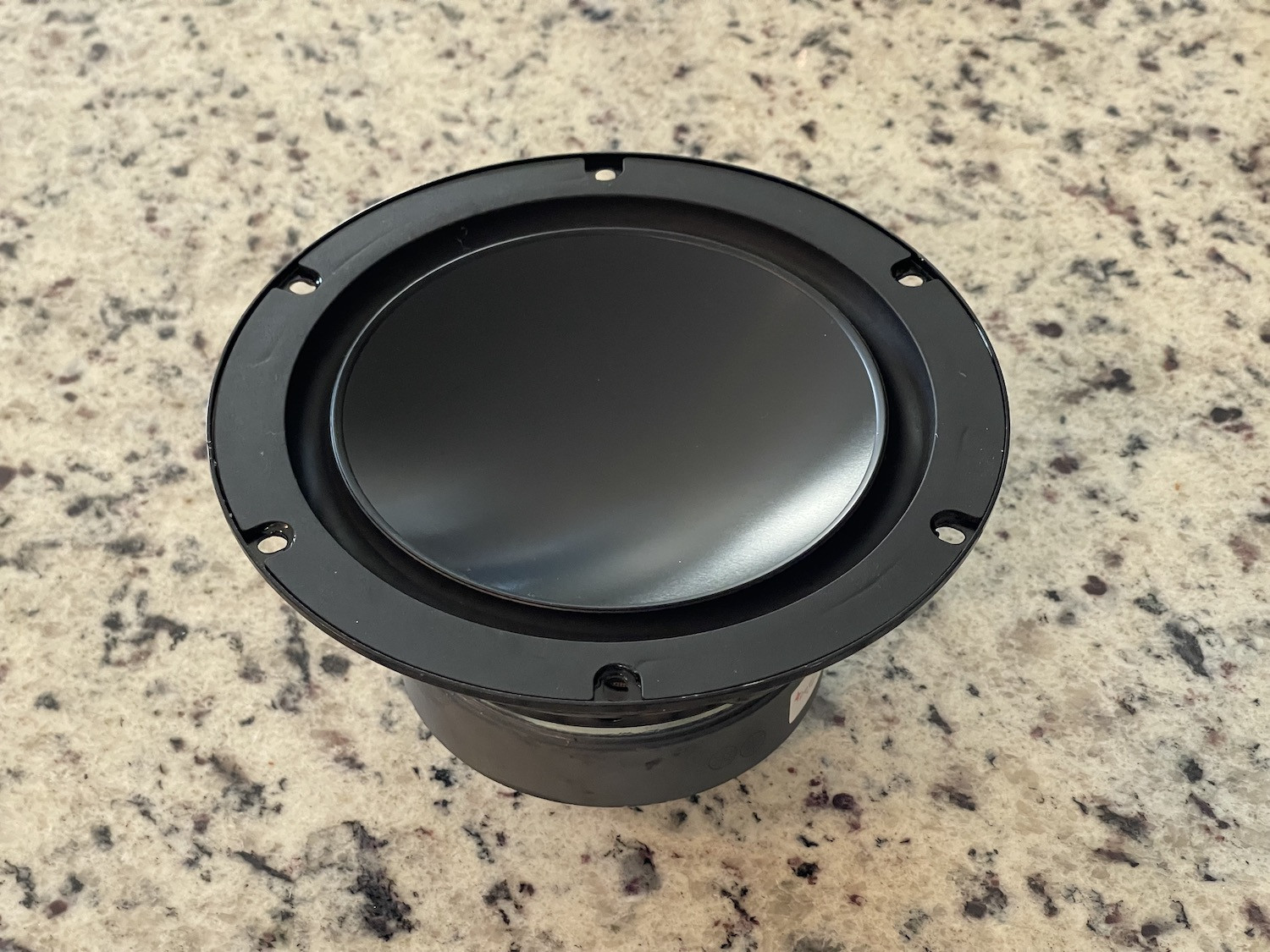

              And besides, the original concept above was for the 6" Peerless woofer that they have over 120 of- the SBS-160F35AL01.
Name:	SBS Woofer.jpg
              Now, ya gotta admit this part is pretty darn cute...

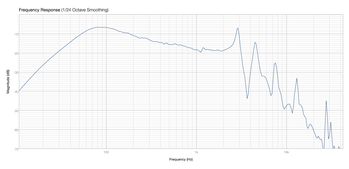

              But it's kind of like having baffle step built in, when you measure it in a moderate size enclosure even...
Name:	SBS-160 Polar 2M.png
              In the CC size baffle, this might work out even better... And I've got 4 extra ones, too...
              The nominal 100Hz sensitivity for 4 should be 90 dB before baffle step. Oh, and this does have an Xmax of 10.5mm.
