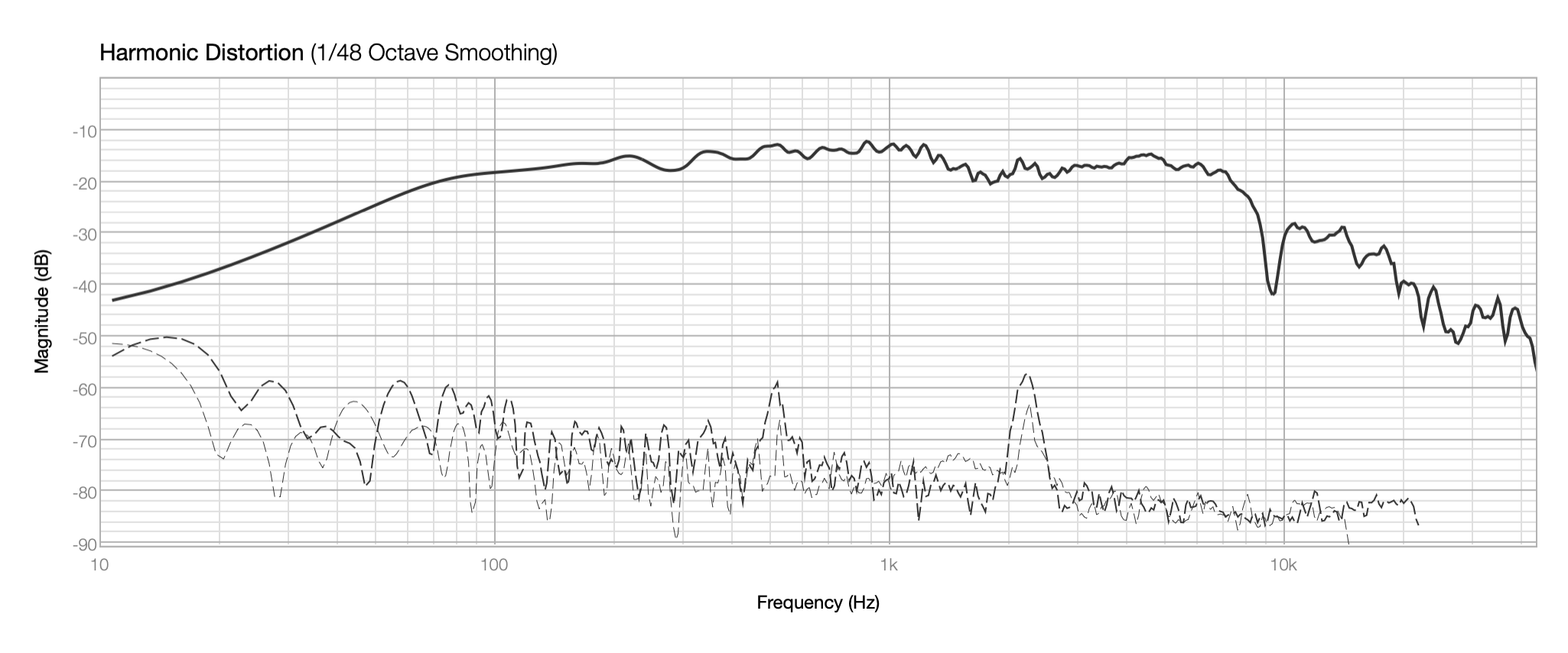

        Now, if you want to try the high priced spread, there is the T25B-6, which I have a couple of and which Solen stocks. It seems to have a near optimum alloy and dome shape, and like the Scanspeak 6640 used in the Wavecor Ardent, it hardly has a significant breakup mode resonance as regards the SPL plot or the impedance plot.
        This roughly doubles the price of the tweeter, but there's no arguing with the results. OTOH, it's a lot more money than a notch filter. It's a bit flatter overall too.

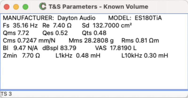

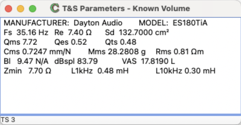

                                        OK, time for some data now.
                                        I prefer the known volume method for T&S data extraction, it removes uncertainty about the added mass, and I don't keep clay like that around anyway, nor a scale to measure it.
                                        Free air impedance:
Name:	ES180TiA Free Air.jpg
                                        Closed box impedance, driver inverted, 15L (driver volume does not subtract from enclosure volume)
Name:	ES180TiA Impedance 15L.jpg
                                        Calculated parameters:
                                        MANUFACTURER: Dayton Audio MODEL: ES180TiA
                                        Fs. 35.16 Hz
                                        Re 7.40 Ω
                                        Sd 132.7000 cm²
                                        Qms 7.72
                                        Qes 0.52
                                        Qts 0.48
                                        Cms 0.7247 mm/N
                                        Mms 28.2808 g
                                        Rms 0.81 Ωm
                                        Bl 9.47
                                        VAS 17.8190 L
                                        Zmin 7.70 Ω
                                        L1kHz 0.48 mH
                                        L10kHz 0.30 mH

                                                      Well, Paul K received the ES140Ti DS and forwarded it to me... for, me, it just raises more questions, on two grounds- the T/S parameter list, and the spec'd SPL response. Mind you, in regards to the latter, I've measured several samples of this part, and participated as a judge for a Design contest using this driver and a specific tweeter at a DIY Audio California meet. My measurements of the ES140Ti and those of the supplied design files for that contest way back when agree quite well, and they don't look anything like the PDF Paul just received from PE.
                                                      So, here for reference is the ES140Ti DS Parameter chart, with the ones that didn't match what I'd entered and calculated in Unibox back when these first came out:
Name:	ES140Ti Paramters Markup.png
                                                      And a comparison of the data sheet SPL
Name:	ES140Ti SPL DS.png
                                                      With typical data I measured and very similar to what another person measured for the design contest:
Name:	ES140Ti SPL 8-2020.png

                                                        Jon, I don't know what to say about the discrepancies you've observed for the ES140. I did notice in your Post Spaced Out at least one oddity regarding the T/S values shown for the two ES160 variations; Sd is shown for both drivers with a value of 98.5 cm2, when it ought to be about 130 cm2.
                                                        Paul

                                                          This is the parameter set I used for the ES180TiA; entered values on left, calculated values on right.
Name:	ES180 Parameters in Unibox.png
