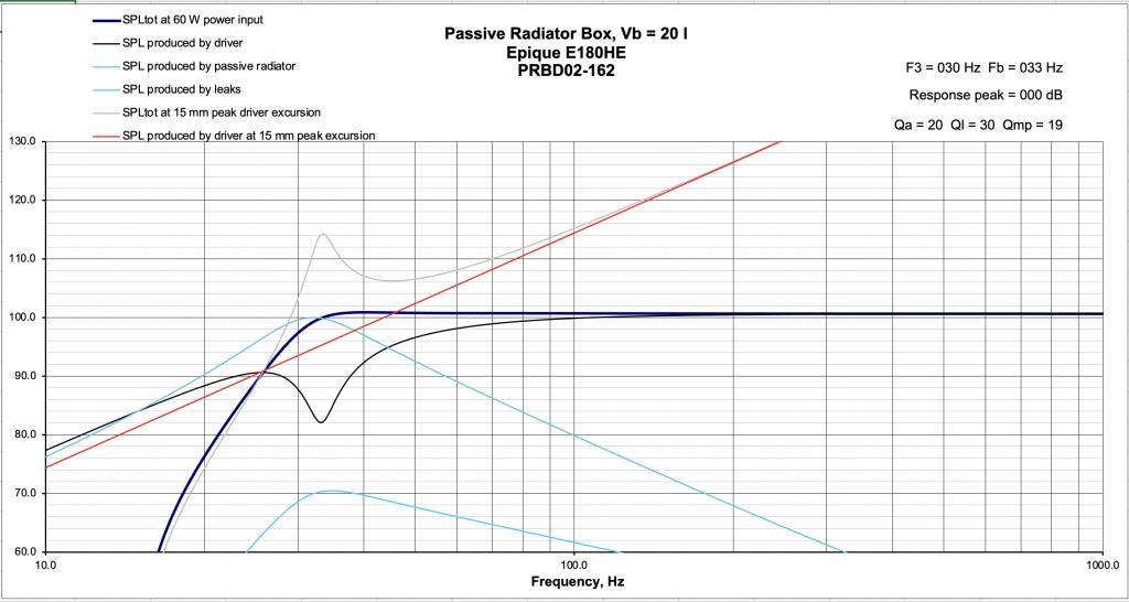

    Relatively maximally flat, in a 20L enclosure...
Name:	Screen Shot 2022-03-29 at 2.52.07 PM.jpg

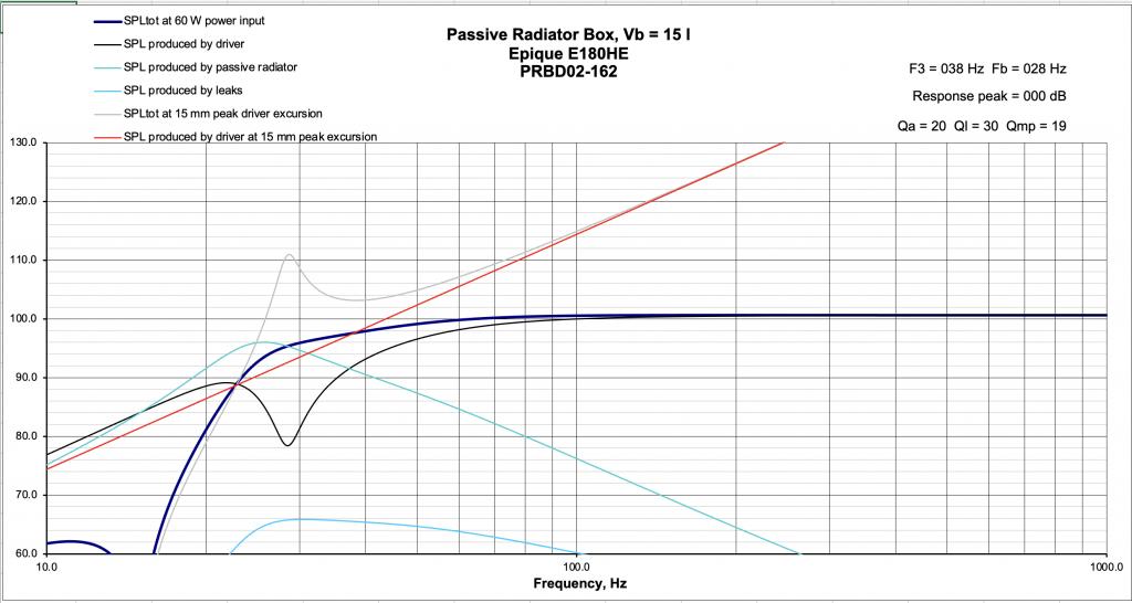

    A tapered extended response alignment, in a smaller 15L net enclosure...
Name:	Screen Shot 2022-03-29 at 2.48.10 PM.jpg

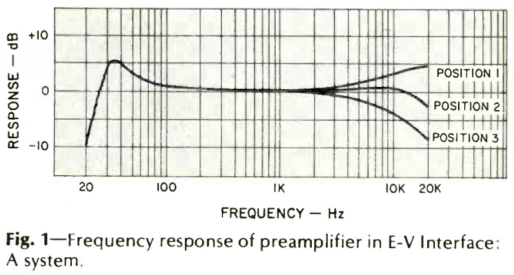

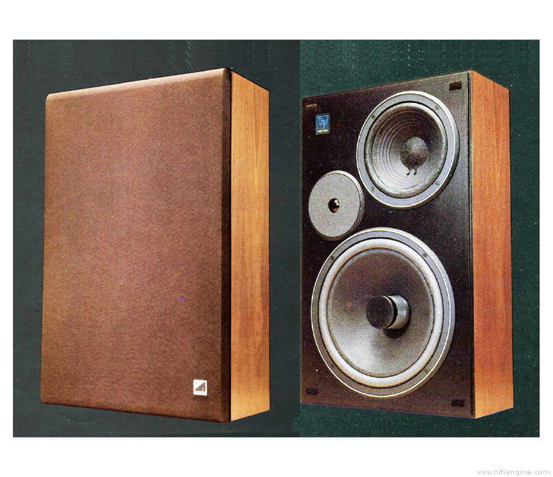

      In my own case, exposure to an early commercial passive radiator system created a very negative impression. This system was the Electrovoice Interface, the original version. This system was a two way with passive radiator and an inline EQ box with HF contour control and a fixed boost and filter for the PR, based on some recently popularized approaches in the AES journal publications regarding tradeoffs in passive radiator systems involving EQ to compensate for acoustic parameters (I.E., small enclosure).
Name:	Screen Shot 2022-03-31 at 6.36.04 AM.jpg
      At that time I had an early interest in Jazz-Fusion recordings by artists like Mahavishnu Orchestra and Stanley Clarke's solo efforts. The original version of "Eternity's Breath" on "Visions of the Emerald Beyond" had a soft double bass drum roll in the opening bars of music... the transient definition of the EV Interface speaker was such that it converted the percussive double bass drum roll into what sounded more like low organ note. Other music was affected in similar, though not as obvious, ways.
      Stanley Clarke's "School Days" lost part of it's percussive snap in the lower registers- this was all well before CD's, and sadly, the CD version of the "School Days" album was compressed in dynamic and frequency range- only the version on the Stanley Clarke "Bass-ic Collection" comes close to the original vinyl.

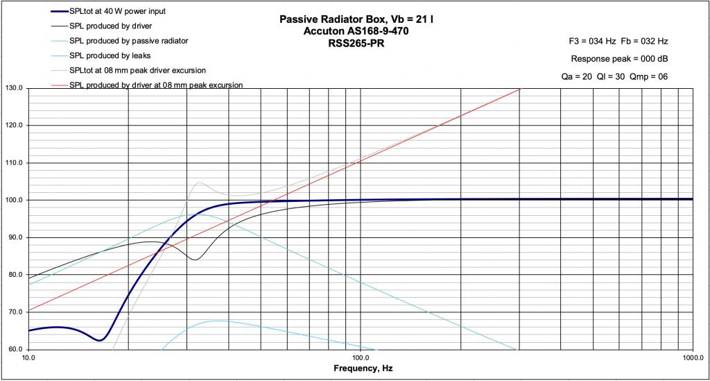

      This was the initial low frequency alignment target:
      Measurements established that the actual Fb was lower, at about 28Hz, as one additional disk was added to the PR configuration. In room measurements showed an F3 of approximately 30Hz.

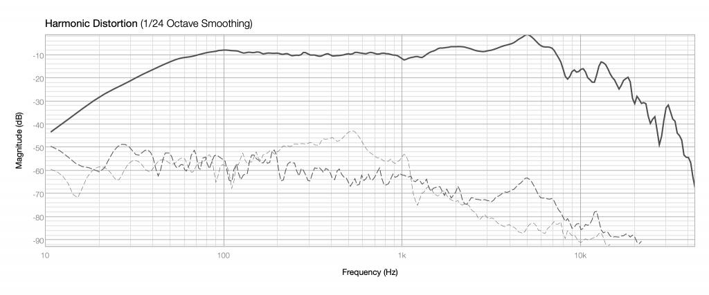

          In the first post, in harmonic distortion- the light dashed line is H3, is that correct? If that's the case it's disappointing that the midrange has more H3 than H2 (200Hz to 1Khz).
          In that case, I too, would preclude the use of it in a 2way, despite the amplitude response being very managable.
            Exactly. And this is in spite of the motor and suspension linearity- there is a factor I believe with inductivity modulation to be considered. And you can tell from the shape of the curve that there seems to be some resonance amplification at work, though it doesn't make sense on the surface that it should mimic the amplitude response but at 1/10th of the frequency.
            This does merit further investigation- which is why this post is called a Design Study. I do have a target system concept and drivers, but have little time to spare in the immediate future pending the logistical work in progress.

              I went back and looked the PE datasheet and it does look like the trends are there as well. It's hard to detect at a glance because the scale is stretched horizontally and compressed vertically (SPL range of 120dB).
              The datasheet doesn't have a legend, but it's clear now that red is H2 and purple is H3, blue is THD which is obviously dominated by H2 and H3. Between ~150Hz and ~800Hz H3 is higher than H2.

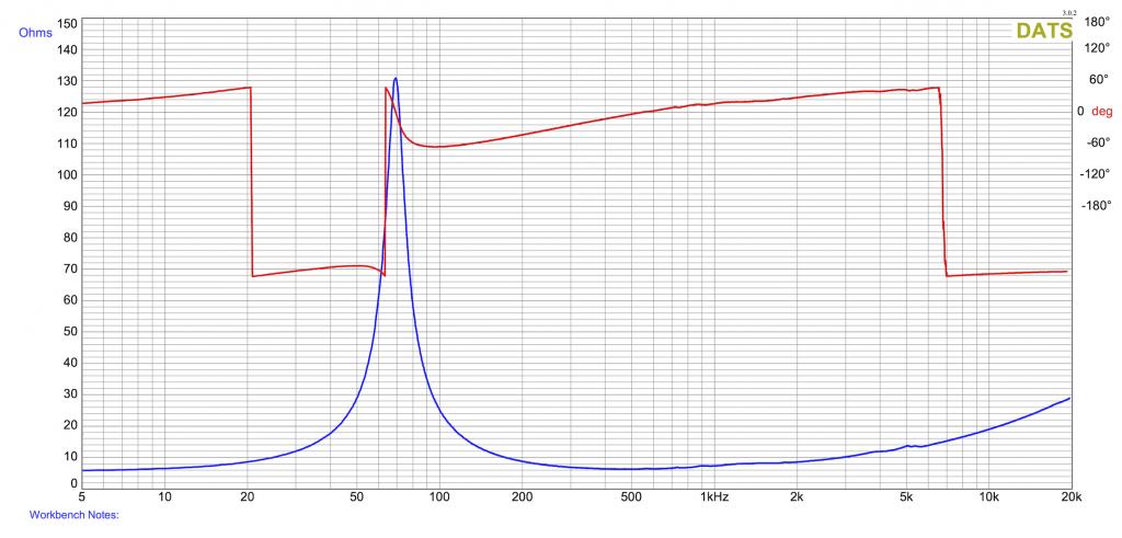

                            On the other hand, another pair of 6ND430s for the test build have arrived and been processed through initial QA.
                            Impedance curves look very clean and flat, as expected with this Neo motor.
Name:	6ND430 Impedance Graph.jpg

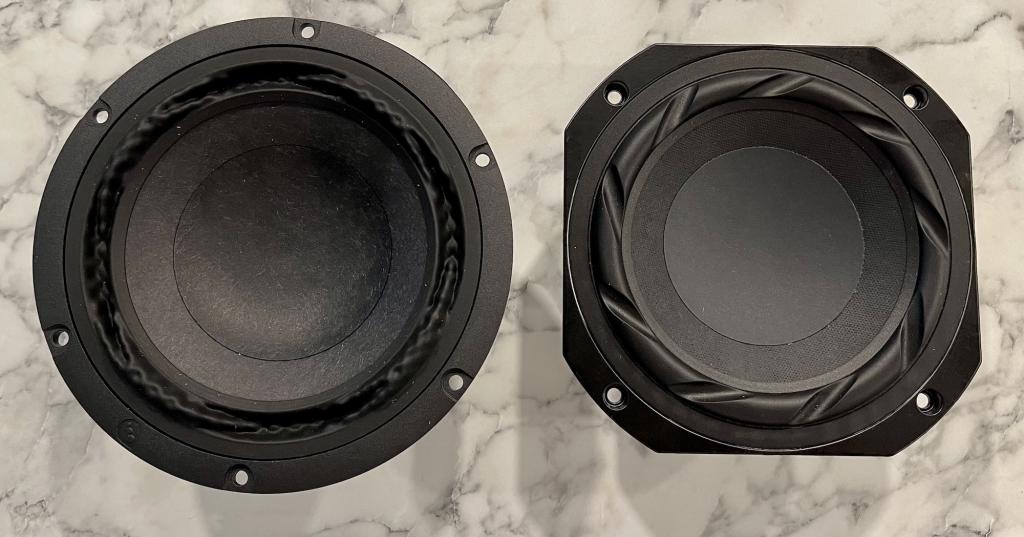

                            As an interesting aside, and comment on the selection of this pro class driver as a midrange candidate, consider how similar the cone construction is between the 6ND430 and the PuriFi midrange...
                            I leave it to the reader to recall the upper range behavior of both drivers approaching the breakup point...
                            There is some reasonable logic to suggesting that the Eighteen Sound 6ND430 is in some senses a budget competitor to the very excellent PuriFi part. But I did not say that...

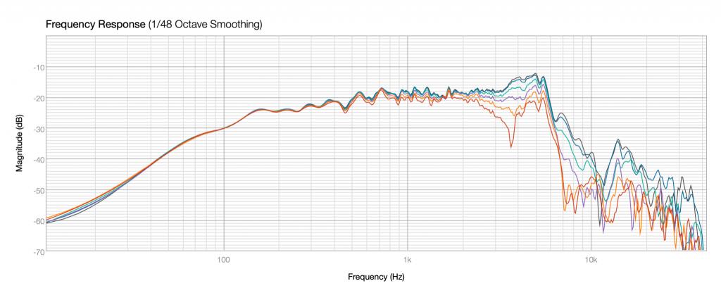

                              Ever since Zach measured it a decade ago, as well the B&W midrange; it occurred to me that the suspension/soft parts design is critically important. The limited availability in Australia… we’ll, It’s sitting in my German online cart.
                              I suspect there’s some mild resonances between 700-1Khz, but dispersion probably usable to about 1.6Khz. (I aim for no more than +/- 2dB @ 45 degrees)
                                Depending on your expectations and intended crossover slope, 1600Hz may be more conservative than necessary...
                                And as always, data is more useful than speculation. 10 degree increments, out to 50 degrees.
Name:	4-8 6ND430 Polar Check.jpg
