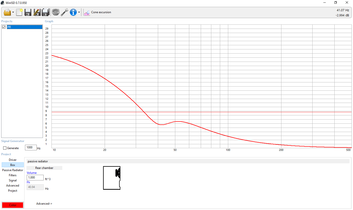

    Theoretical Frequency Response with no added mass in a 1 cubic foot cabinet.

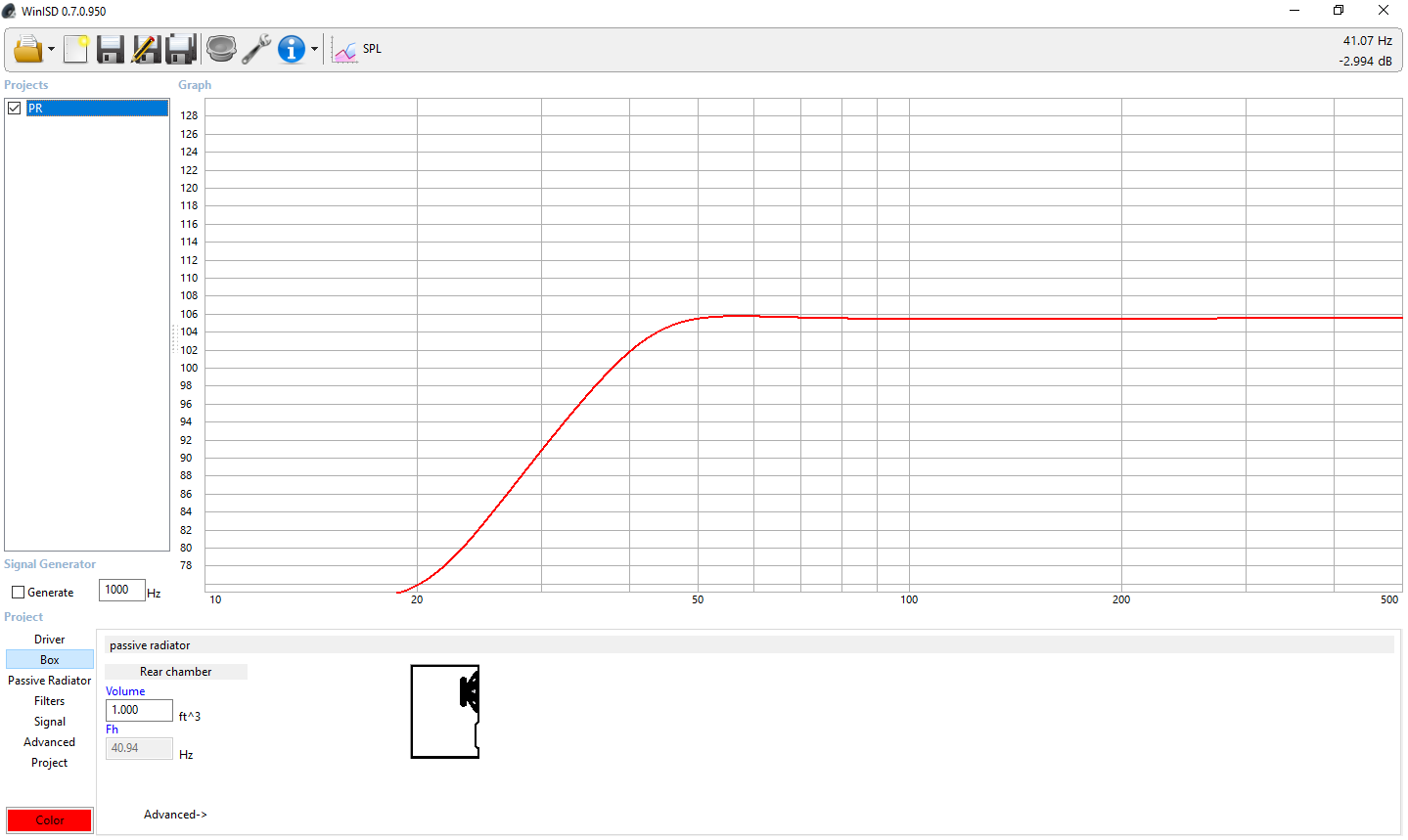

    Theoretical SPL using 100 watt amplifier (106DB)

    Cone Excursion without a High Pass

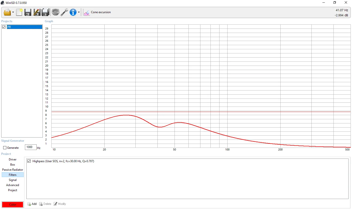

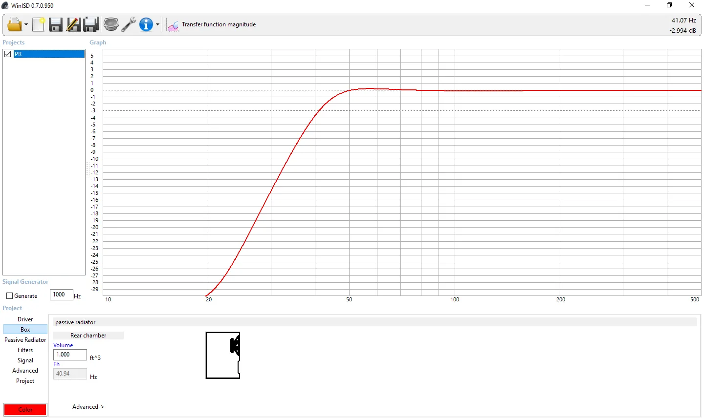

    Cone Excursion with 30hz High Pass

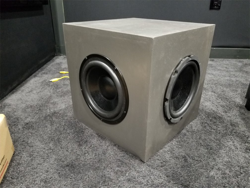

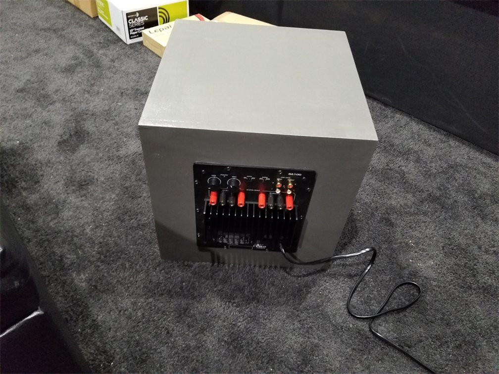

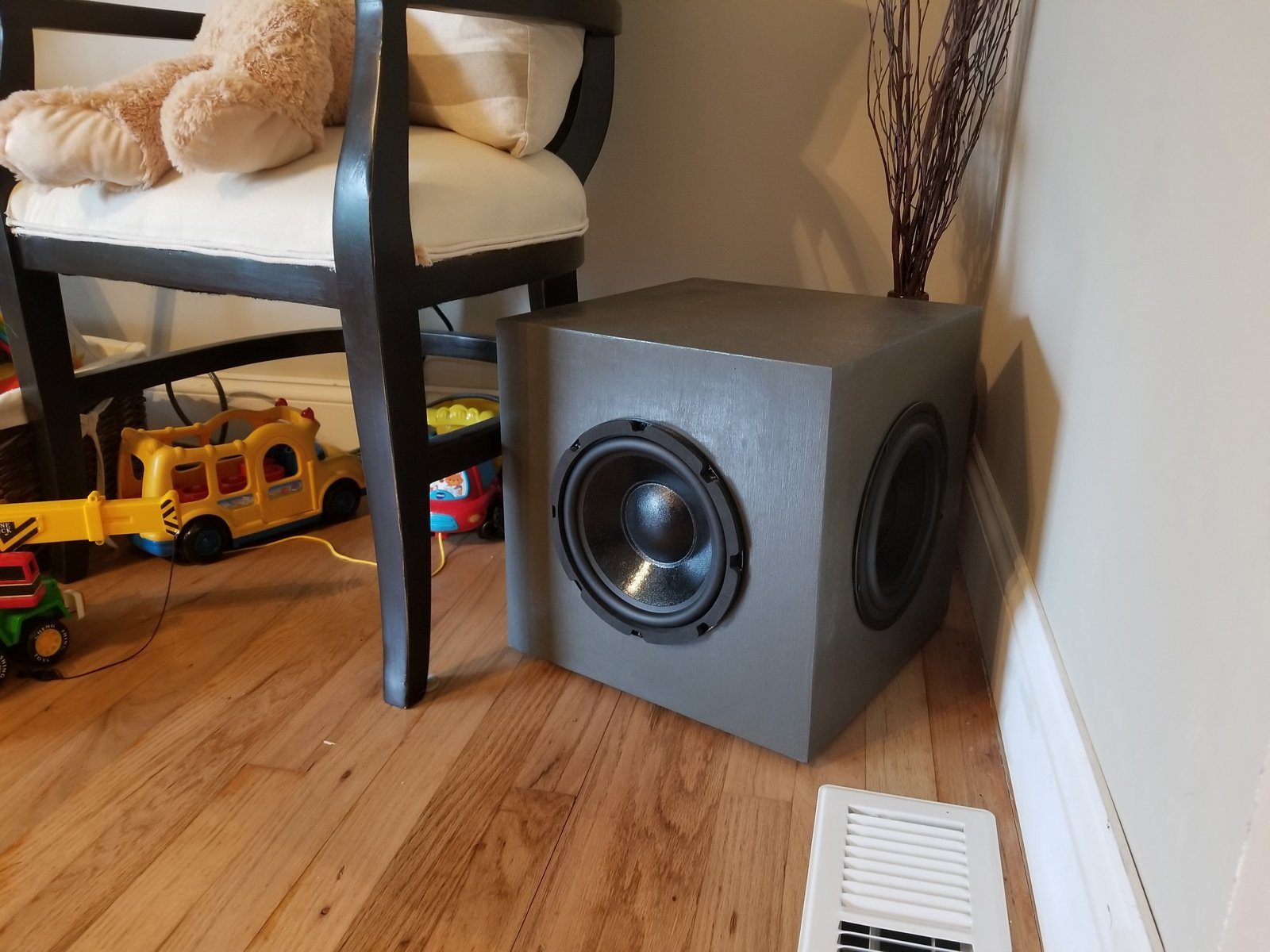

      Finished Pictures: I may repaint it. My wife likes it so much, she wants it in the living room. That means, it'll need to be white. Oh well..

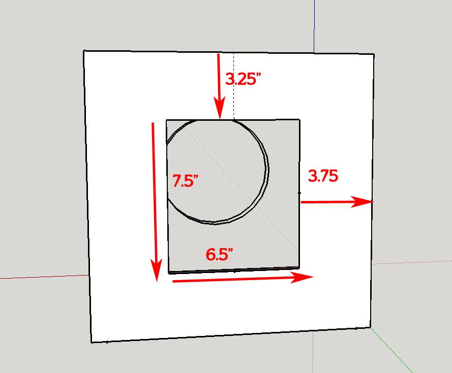

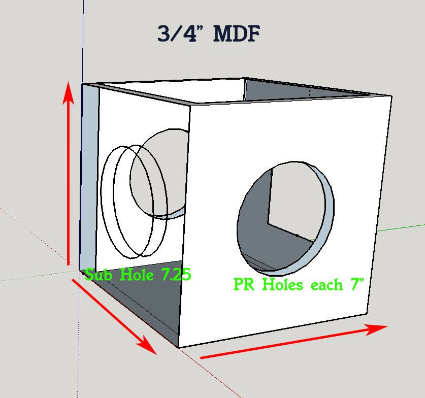

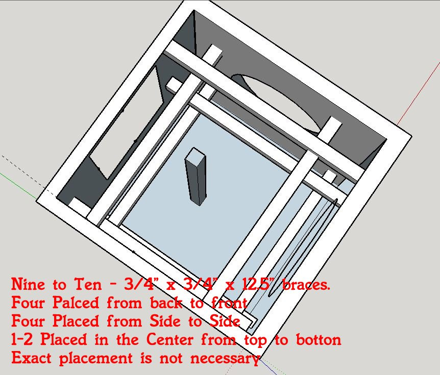

      Size and Cutouts:

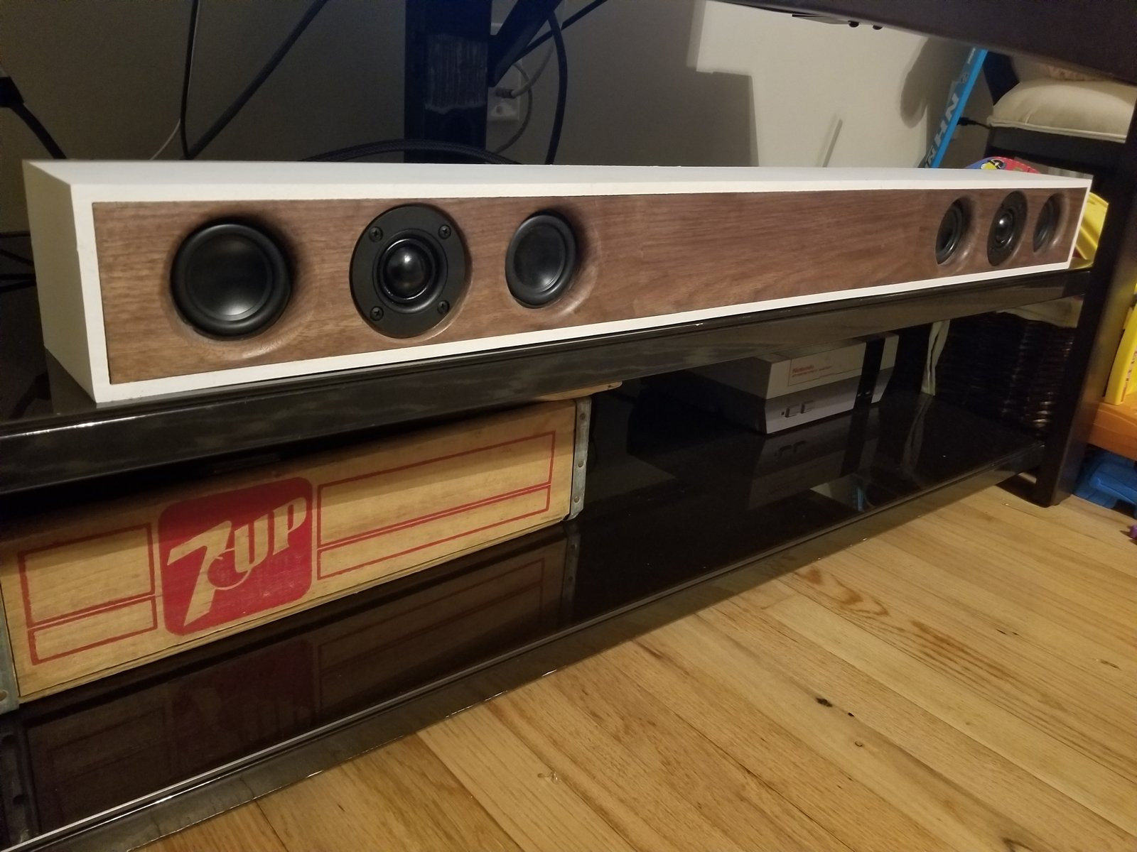

          I did design this sub to be a small subwoofer for a living room/office for a limited budget. I wanted a small footprint that could easily be placed, not take up any room and be pretty fool proof for anyone that wanted to get into speaker building. This is one of the reasons I chose a passive radiator build. It is a lot more forgiving versus a vented system. Secondly, I was asked by many to create a passive radiator system. It seems a lot of people are trying to design subwoofers around them, but do not understand the complexities of what it takes to design it. Although, you could get this sub to tune at a lower frequency, you then run into max SPL problems even while only pushing it with 100watts. Plus, you would then have to make the box 3 times larger with a 4 inch port that is approximately 16 1/3 inches long. That didn't seem to fit what I was trying to go for.
          As far as the tuning at 40hz, that is the sweet spot for this subwoofer. And honestly, I can't think of many 8" subwoofers that really tune much lower than that (Ultimax 8). My main focus on this build was to keep it under $200 in parts (amp and all) to make it a budget friendly subwoofer. Most subwoofers in this range, that are bought from a store have the typical port noise problems or are just bad in general. So i wanted to give someone who was interested in DIY an inexpensive option, they could easily build themselves. And I really think this would be a great budget option for most people. Heck I use it in my Living room connected to a custom soundbar I designed and it is a fantastic experience.

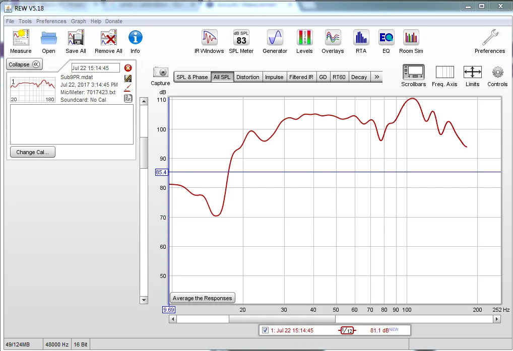

            I hven't messed with sub crawl. This is a real basic test. I had a suck out at 80hz and I am guessing that is due to the room.
