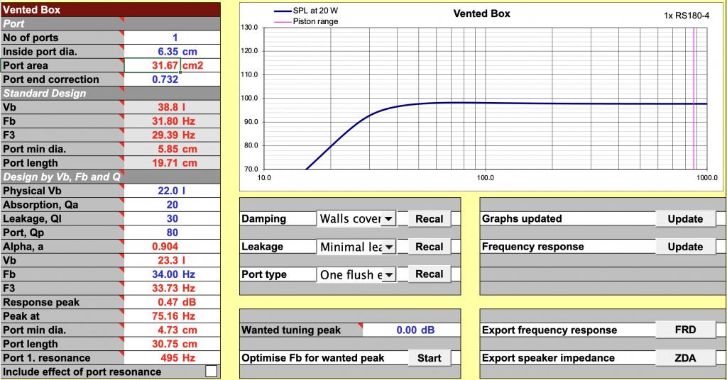

            Modula MT enclosure calculations for original PE 22L enclosure
            For you and the benefit of anyone else revisiting this design, here are the enclosure parameter calculations for the vented design of the Modula MT using the RS180-4. The RS180 can provide even more extended and flatter response in a larger enclosure, but the 22L nominal original chosen is a good tradeoff between size and bass capabilities.
            First, we'll show the more optimal but more difficult to build 3" port version, then the more commonly used 2" port version, and show the tradeoffs.

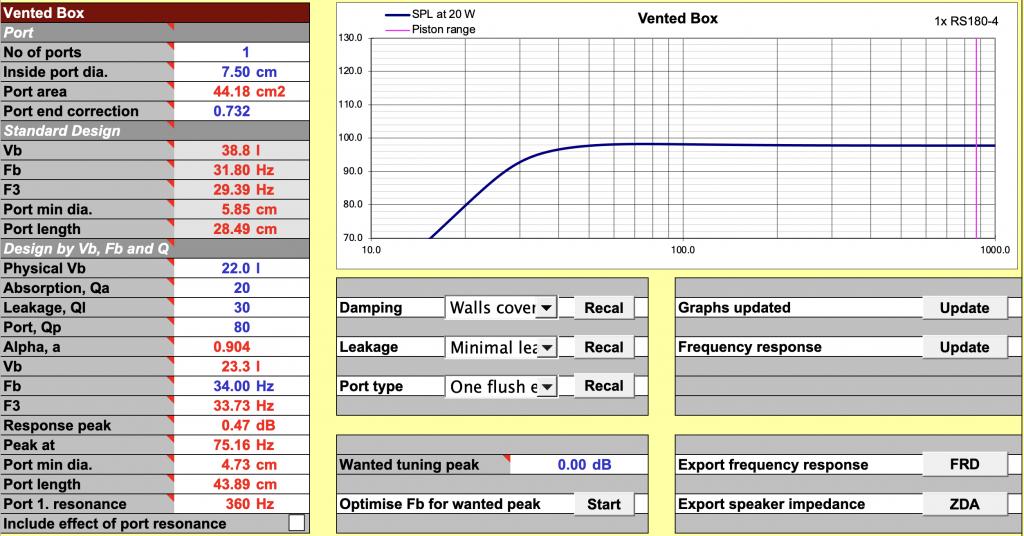

Name:	3 inch design details.jpg
            Note the port inner diameter is 7.5 cm.

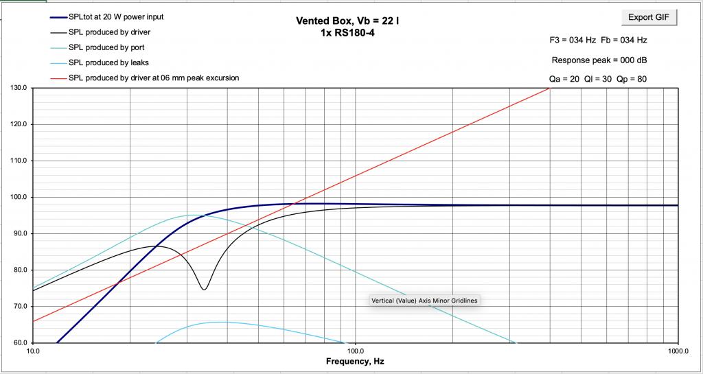

Name:	3 inch design 22L SPL.jpg
            The box Fb tuning and the -3dB point are at 34 Hz, and response is fairly flat down to 40Hz, though obviously not at room shaking SPL. This is with an input of 20 watts, which is about the low frequency limit.

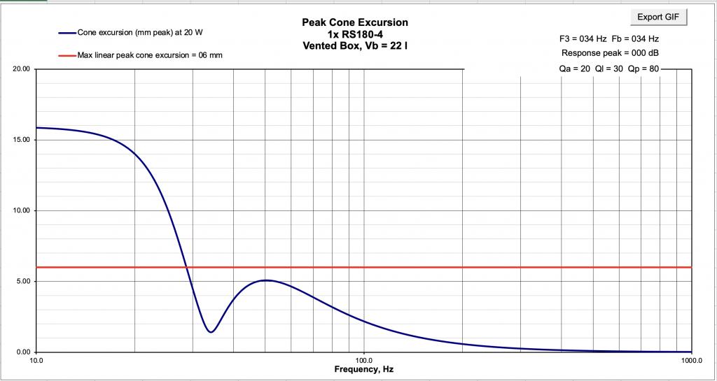

Name:	3 inch design Excursion.jpg
            Excursion is within the driver capabilities

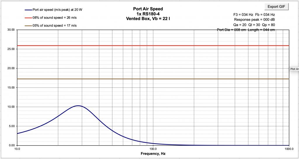

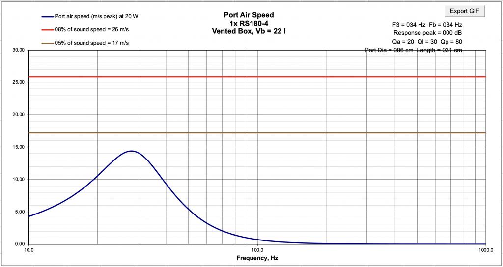

Name:	3 inch design port air speed.jpg
            Port air speed is comfortably below the preferred limits; from this, its likely that a 2-1/2" version would work OK, too, without port compression or chuffing.
            But note that the port length is about 17-1/4", not including a port flare, so depending on the enclosure configuration and depth, this could pose a problem for a front or rear venting port; the port opening should be about 3" minimum from any enclosure wall. Possibly a bottom mount if the enclosure is tall enough, or a rear mount if a deep form factor like the Q Acoustics 3030i uses, or the one planned for the Obi-Wan.

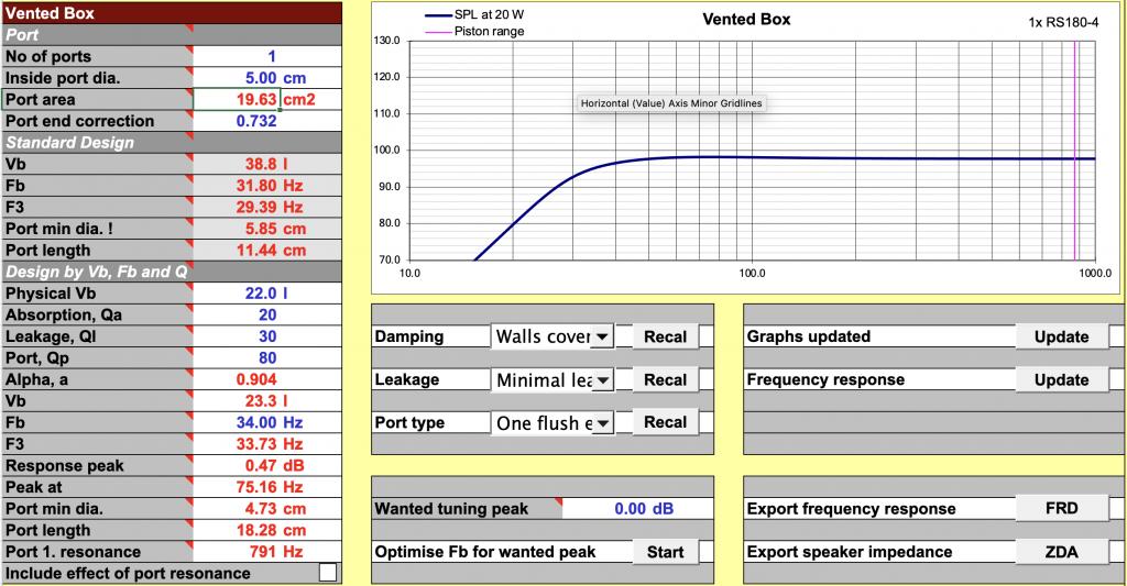

              Now, a 2" ID port version is examined.
Name:	2%22 Design Dayton 22L.jpg
              This results in a much shorter port, about 7" not including flare.

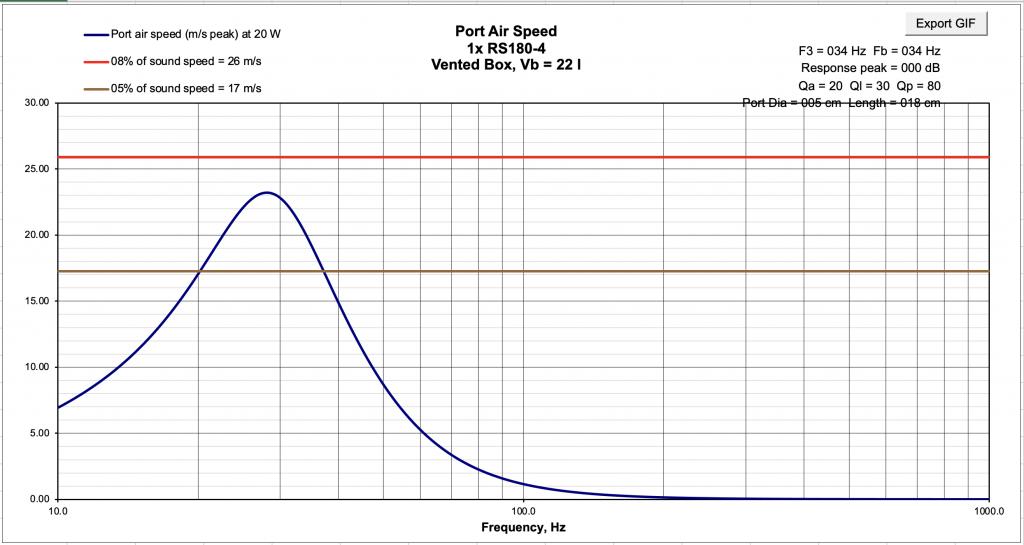

              The tradeoff is port air speed and compression at higher sound levels:
Name:	Port Air Speed 2 inch.jpg

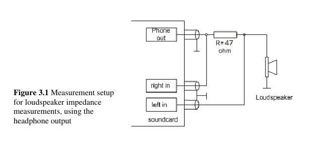

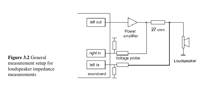

                You've got everything you need in the Wallin jig, but maybe its time to try some more modern software..ARTA or REW will both do the trick. I personally prefer ARTA, the GUI is a lot less cumbersome I find.
                All that is required for impedance & T/S measurement is any functioning sound card and a few resistors. As few as 1 resistor if you want to cheap out and make a low level un-amplified jig, similar to the old DATS/WT.

                I prefer to include the amplifier for greater reliability and versatility, it just needs an additional voltage divider at the soundcard input to step down the speaker level signal to line level:
                Of course, if you study the guts of the old Wallin jig you will find something rather similar already included. Above images are from the ARTA/LIMP manual, a good reference to get started:
