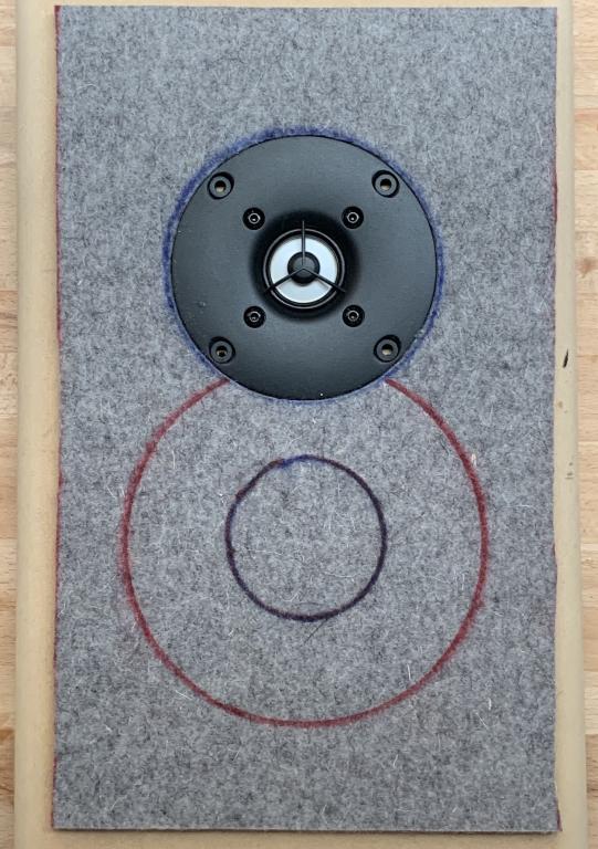

Name:	Tweeter-Mid Felt Rebate SS.jpg
      The tweeter will be rebated by the felt pad, which will have an opening for the midrange, and the midrange will be rebated into the cabinet so that the flange of the tweeter can sit over the midrange flange.

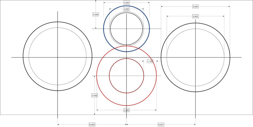

      Here's a nice drawing for how that could all work out on a 10" high baffle...
Name:	NeoD CC 2020 Driver Cluster SS.jpg

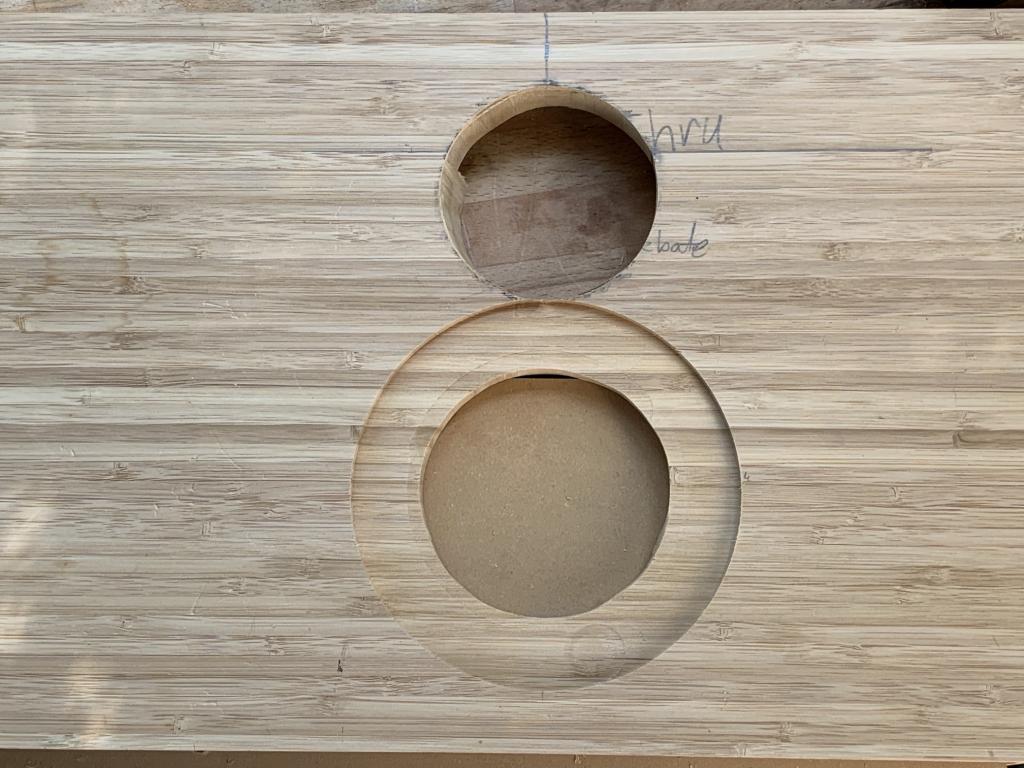

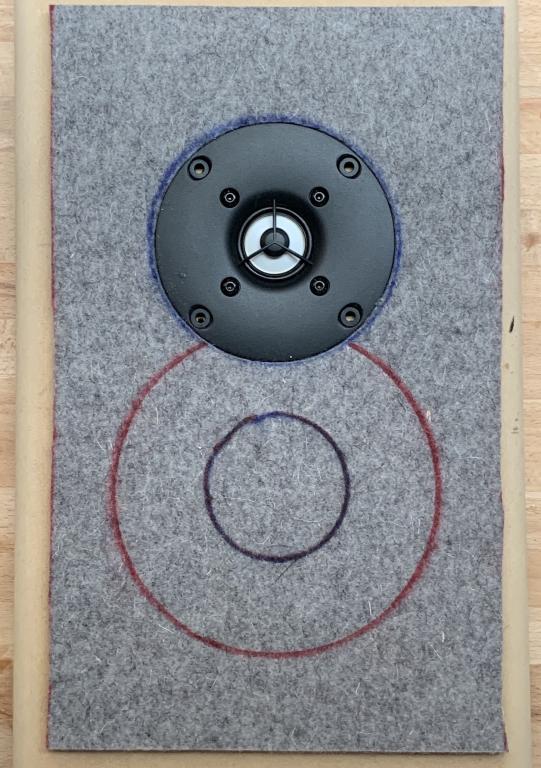

      So, the midrange and tweeter holes wind up looking like this after being cut:
Name:	Mid-Tweeter detail SS.jpg

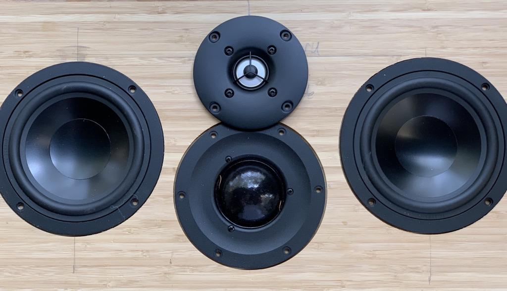

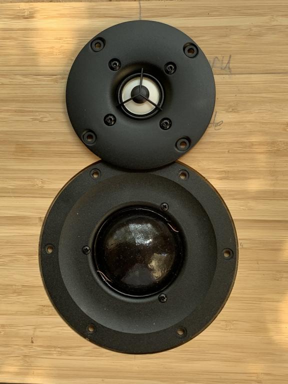

      And a quick check shows how they mount together.
Name:	Mid-Tweeter FitmentCheck SS.jpg

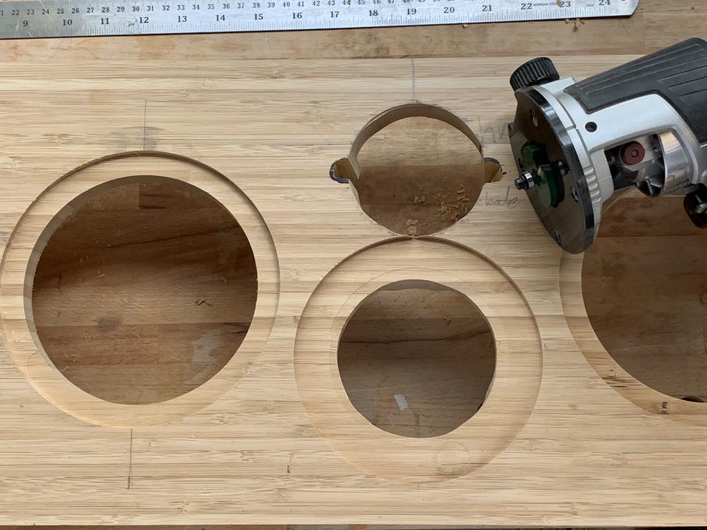

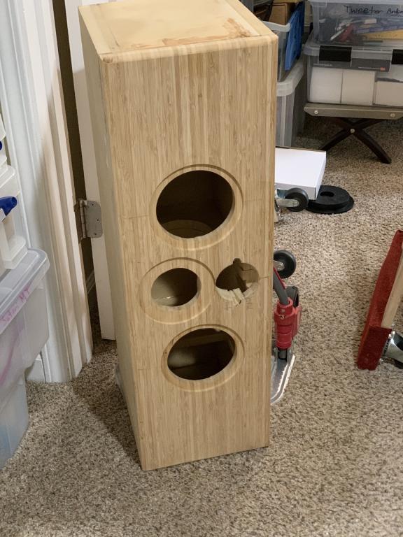

        OK, not a lot left to do to wrap up the basics for the front panel... just the woofer holes... the usual rebate and counterbore.
        Of course, if you're measurement impaired, or have trouble selecting JUST the RIGHT hole on the router base fixture, you can wind up with small "issues" like a woofer rebate that doesn't quite fit the driver...
        No worries, that's why they make all those fancy adjustable variable size milling bit...
Name:	Ajusting Woofer Rebate SS.jpg
        Then it's time to do another dimensional mounting check...
Name:	Driver Set Fitment SS.jpg
        Keep in mind there will be a vertically oriented felt pad around the tweeter with a cut out for the midrange at the dispersion ring flange...

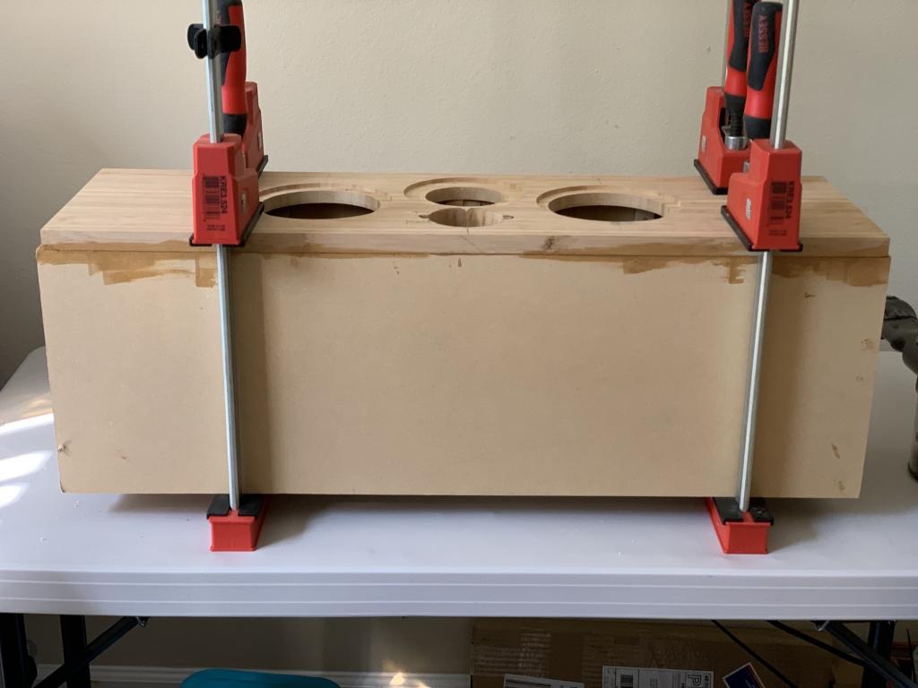

            Next step is gluing the front panel to the test box made from two of the Denovo enclosures plus overlapping top and bottom panels. That box was assembled, though not completed trimming, earlier this summer. So, the "connecting" boards top and bottom still need end trimming with a router. It doesn't affect what we're doing here for the time being...
Name:	FP Assembly 1 SS.jpg
            From a top view, one can see the bracing pieces of the Denovo cabinet. This basic box is pretty stout and as a result rather heavy... it's half a cubic foot for each woofer, 28L total for both. Crossovers could be installed inside, but binding post plates will be installed so that test crossovers can be external. All pretty routine stuff...
Name:	FP Assembly Top CC.jpg

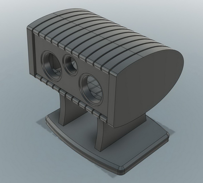

                First go around will be very similar to this concept which is in the 22" - 24" range.

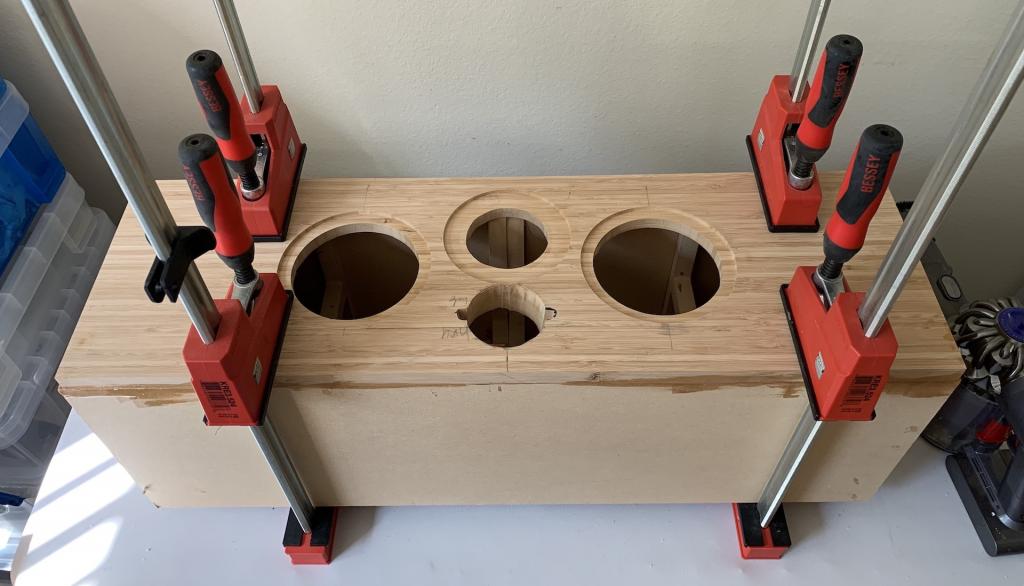

                    • 16199
                    not for a basic CC. But it's a question of what I could cobble together quickly, and that meant mating two of the Denovo's up with a custom front panel.
                    Also, I intend to expand the concept to a 3.5 way using the Anarchy 554, two each in series for the 0.5 way and the main LF path. So imagine another pair of woofers flanking the center two, just acting as 0.5 way.
                    Needs must... I haven't had a weekend free for working on this in weeks, and will only have Sunday free this coming weekend - another logistics trip Friday/Saturday.
                    The cabinet has had the joining boards trimmed and the front panel round overs done.
