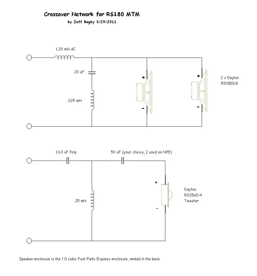

                    I am not familiar with bypass capacitors and from reading it sounds almost as controversial as speaker wires. I don't think this crossover has one. It is the Bagby crossover for the rs180mtm. It seemed like the most simple approach for the drivers compared to the others. If there were compromises in the design to keep parts list minimal, I am unaware.
                    Last edited by theSven; 08 July 2023, 12:01 Saturday. Reason: Update image location
                    • Bill Schneider
                      • 158
                      Judging from the date of the crossover plans, be aware that the contemporary RS28A may be different than the one used in the design. There was a change in Dayton RS28A tweeters around 2017. They are different enough that Jeff used a Morel tweeter as a replacement in the Continuum II because the new RS28 was not a drop-in replacement.
                      You can read about it here... https://meniscusaudio.com/product/continuum-ii-loudspeaker-kit
                      The crossover shown above may require a little tweaking.

                        Thanks for keeping a lookout for the newbie! I actually have the rs28as-4 tweeters which should be pre 2017. I will take some measurements to see how they fair and mockup everything as much as I can in software to see if I am missing something. Not to mention the learning opportunity.
                            OK, it's a 3rd order high-pass (electrical).
                            Bypass cap's are just parallel connected small value cap's to your higher value cap(s). Most of the time it's for an increase in perceived clarity (ex. Vishay). Sometimes you'll get some added spaciousness with better cap's like the Miflex copper-foil.
                            For the 10 uf I'd probably do an Obligatto Gold plus the Miflex as bypass. The 50 uF with just the Carli 20 uf and 2x 15 uf + another Miflex bypass (not the Vishay).
