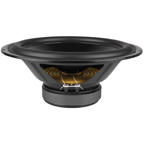

              Yes, they are locally available woofers here, and I already have 4 of them.
              The Dayton Audio SD270A-88 10" DVC Subwoofer would make a great low-cost choice with Fs of 26hz and Qts 0.43. But shipping cost is prohibitive to Australia!
              Click image for larger version  Name:	295-486_HR_0.default.jpg?resizeid=104&resizeh=600&resizew=600.jpg Views:	0 Size:	36.5 KB ID:	935967

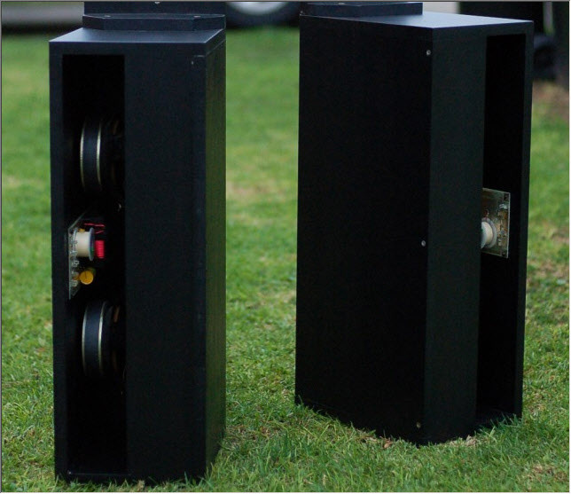

                                                        Some progress, .... the first dipole sub was completed today.
                                                        After much pondering, I decided to discard the push-pull idea because:
                                                        - Cavity is small enough as it is and additional barrier takes up space
                                                        - Operationally I want to be able to remove the woofers one day
                                                        - It is simpler to build, less time freezing in the cold :P
                                                        This dipole sub is 22cm wide. It's actually 2cm narrower than those desktop OBs at the back!
                                                        Measuring nearfiled, the quarterwave resonance is at 330hz, which is great as I had planned to cross at 280hz LR4.
                                                        The blue graph shows raw nearfield response. The Black graph shows equalised response with LT target set at 20hz, Q=0.5 along with 300hz notch filter and 280hz LR4 lowpass XO.

                                                          How does this affect force cancellation?
                                                          Do they rock?
                                                          Steve's OB Journey
                                                            There is no force cancellation as both drivers move in unison. It would be beneficial to add in extra partitions/holes, so that with both drivers mounted in the same way, the rear output of the top driver is routed backwards, while the front output of the bottom driver is routed backward also. To keep the phase of the two coherent one driver would need to be wired in antiphase, this would give you both force cancellation plus the additional benefits of even order harmonic cancellation, but as gainphile mentioned it makes the box harder to construct and also makes it somewhat harder to install/remove the drivers.
                                                            At lower spls though I don't think it would give you that many benefits, so is a fair trade off for the narrow profile of a system that probably isn't being designed to reach very high SPLs anyway. My XLS containing H baffles, similar to the old orions used to rock quite considerably at high SPLs, which is probably why Linkwitz swapped to the current implementation.
                                                            I am highly intrigued by this approach mind you, it would make perfect use out of some of the Audax HT240G0s I picked up cheaply from ebay a few years ago, although this isn't going to happen any time soon!
                                                              I'll probably whip up a test W baffle somewhere in the next few months. For the frequencies I'm hoping to reach, opposed-mounted and firing is a must; I'll probably be directly coupling the drivers too (dowels from bolt to bolt between them or similar.) Definitely an interesting solution.
                                                              Two drivers that fired opposite ways but aren't directly facing each-other would still have torsional issues - that may even be more likely to cause a speaker to walk. No idea.
                                                              Can't wait to see how this turns out - so far looks like things are working to plan. Very cool.
                                                              • gainphile
                                                                • Apr 2009
                                                                • 107
                                                                5th is correct there. The subs do not have the force on par to Peerless XXLS nor L26RO4Y so they are less of a problem. Also the vibration is lateral to the sides.
                                                                I did briefly try to drive it with 20-30hz signal to xmax, and even on my desk the vibration is not noticable.
                                                                Woofer maintenance is very easy with this approach. That right panel can be removed entirely (see unfinished screws there) and provide full access to the woofers.
                                                                Can't wait for the weekend to finish them ....

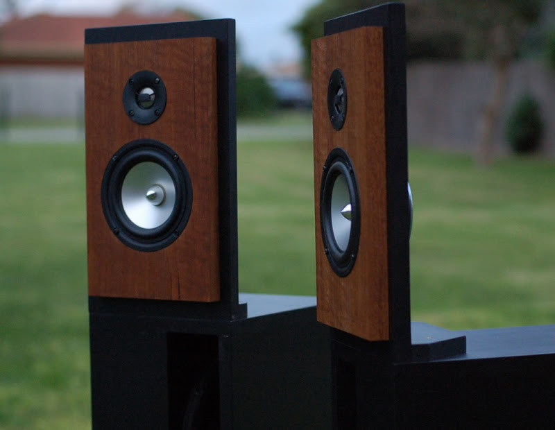

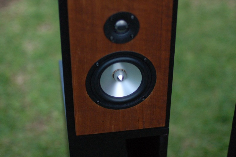

                                                                      Finally the woodworking is completed. So now I can move on to the fun part
                                                                      I could add the dress panel and grill, but the looks of these things are just so "not loudspeakers" I really like them as it is.
                                                                      The final build is actually 2cm narrower and shorter than planned. It's now 21.5cm x 95cm x 30cm (yes the depth had increased by 3 cm). Here I make a comparison with linkwitz pluto clone.
                                                                      Quite petite dipoles!
                                                                      The Zaph woofer is really stunning in real life with that oak baffle. They have just the right amount of shine!
                                                                      Last edited by theSven; 03 May 2023, 20:46 Wednesday. Reason: Update image location

                                                                          Well I've fired them up tonight!
                                                                          It will take some more time and lucky weather for the final xo to be posted, but the guestimate indoor measurement sounds good. Usually I miss by 100-150hz compared to the outdoor one.
                                                                          For the moment, the zaph kit is equalised using one 650hz notch and a shelving lowpass filter to compensate the dipole effects. The subs are eq'd as before at 20hz. I actually had to reduce the level to -2db.
                                                                          I really like how they dissapear very convincingly. I had tried this in the past and the narrower the baffle, the better it is.
                                                                          gainphile.blogspot.com

                                                                              Some more picx detailing the speakers.
                                                                              ZA Driver
                                                                              Passive ZA5.2 crossover tucked in nicely. I had to put foam below them to stop them from vibrating.
