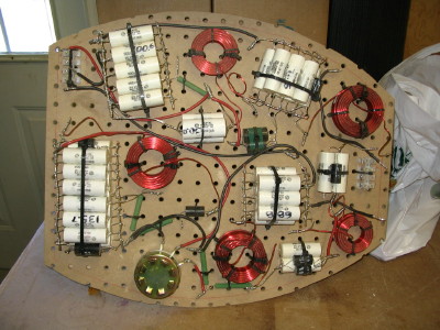

                                        #109

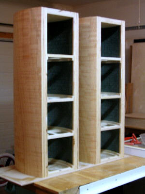

                                        Photos of work in progress
                                        I thought I'd try to post a photo of one of the speakers and the crossover with a 'bazillion' caps.
                                        It's a pretty slow process. Like most of you out there I have a few little things cutting into my speaker building time - work, family, home

                                        • Al Garay
                                          • Jan 2004
                                          • 125
                                          #110
                                          Nice work Paul. No need to feel guilty. Work and family and outdoor time in Spring time are important.
                                          I am amazed by the number of components on the crossover. I can see how the cost of the crossover can exceed the drivers.

                                              I have a question...why would a person use a bazillion capacitors when you can buy two 68s to make up the 136?(in the tweeter xo)
                                              Did I miss something, as the cost of two is way less than multi small ones...
                                              Dean
                                                #113
                                                Madisound has 10uf GE caps that are $0.90US when purchased in lots of 100+ pieces
                                                So possibly only for US builders, the out of pocket cost for building the large value caps from clusters of Madisound's GE 10uf caps, is approx 1/2 the cost of buying the larger value caps from Solen.
                                                Other than lower cost, another benefit is that those cluster caps have EXTREMELY low ESR..........
                                                Downside is the time and labor involved in their construction, combined with the HUGE physical size of the completed caps.

                                                  The Madisound caps for the speakers I'm doing (2 main and a centre) worked out to $150Can cheaper total than Solen et al.
                                                  Also, the assembly looks more onerous than it actually is - good thing!

                                                      Paul's obviously done the math, given that he built his months ago. I imagine he has the exact costs available.
                                                      Regarding building the clusters, it's just a matter of hot gluing the caps together ,then soldering the ends of each side to a piece of tinned wire.
                                                      It is TON of work, and the clusters are HUGE. But they create an outstanding caps.

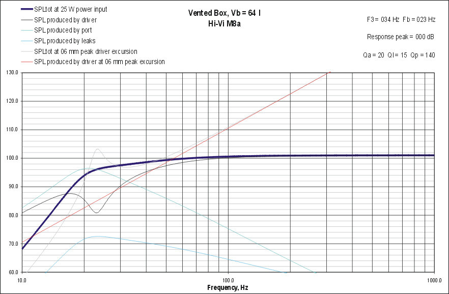

                                                                        Is your Unibox model using lined or stuffed cabinet? I recommend having stuffing behind the drivers, but not stuffing the whole enclosure.
                                                                        With a low tuning, like the M8ta, the response is matched to the roll off in the room gain kicking in with proper placement, the net room response is pretty flat (hopefully!). In practice this usually works quite well.
                                                                        I never tune for flat response from the enclosure anechoic, becuase this will produce a "heavy" in room response unless it's an usually large room that's unusually absorbtive.
                                                                        Generally I've found the Unibox models to agree quite closely with the measured response; if you have any way to measure the impedance curve, you can check for the impedance minima corresponding to the tuning null.
                                                                        Regards,

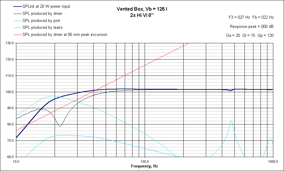

                                                                          The back and side walls will be lined with 3/8" foam, and after I've got everything assembled and running I'll experiment with some stuffing behind the drivers only.
                                                                          My unibox curve looks like the attached at 22 Hz:
                                                                          Below 23 Hz the precision port instructions for port length calculations do not match unibox port lengths - should I use unibox lengths plus 1" to allow for the flare, or should I make an adjustment at all for flare?
Name:	VB Response Hi Vi 8.gif

                                                                            An extra in or two is easy to trim. If you're using the calc setup for flared ports as in Unibox, I've just cut them to the exact length, end of flare to end of flare. This seems to always get right on the money; it did with all the versions of the original M8.
                                                                            If you have some additional box damping, your curve will probalby look more like mine, which works well in room; helps keep it from being a skosh heavy in the 50 Hz area. Of course, if you LIKE it a skosh "rubenesque" in the 40-50 Hz area (as some other people who's moniker inlcudes a T and a W do ), then don't worry. But my experience is that the mids are not clean and focussed enough without having the stuffing.

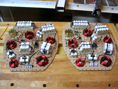

                                                                              Thanks again Jon.
                                                                              I've finished both crossovers. The cabinets are done except the 2 front layers, which are bevelled and cut to size but will only get installed after I get the M8N's (I want the drivers in my hands before I do the cutouts), likely later this week. The end is in sight!
                                                                              For anyone considering building speakers this size (125L or 4.5 cubic feet interior net volume) with 1 1/2" thick walls, be warned that these are Heavy - moving and tilting them becomes a real chore in the last stages of assembly.
                                                                              Paul

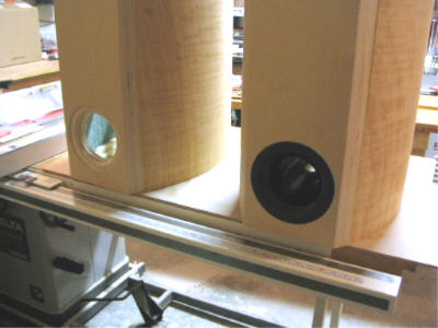

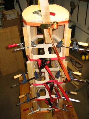

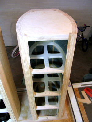

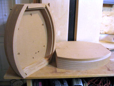

                                                                                        • Paul H
                                                                                          • 904
                                                                                          #134
                                                                                          BTW, where's the pics? :W
                                                                                          ~Jon
                                                                                          Some pics here.
                                                                                          I did some baffle step modelling and came up with horizontal offsets of 3/4" to 7/8" from centreline for the woofers and about 2 5/8" the other way for the tweeter. This is very close to Thomas' suggestions way back in this thread, and will be likely adjusted very slightly to suit physical layout on the baffle. Also as Thomas suggested way earlier in this thread, I'm planning to use 11 1/2" vertical center-center distance for the woofers, with the tweet centred vertically in between.
                                                                                          I still need the woofers to cut the holes in the baffle - not here yet - but somewhere in North America there's a box with 6 M8N's on the inside and my name on the outside.
                                                                                          Paul

                                                                                            #135
                                                                                            Very nice work, Paul!
                                                                                            I can't hardly wait to see them finished! It looks like you may even top Tibor's construction and finishing job, and that's saying a lot!
