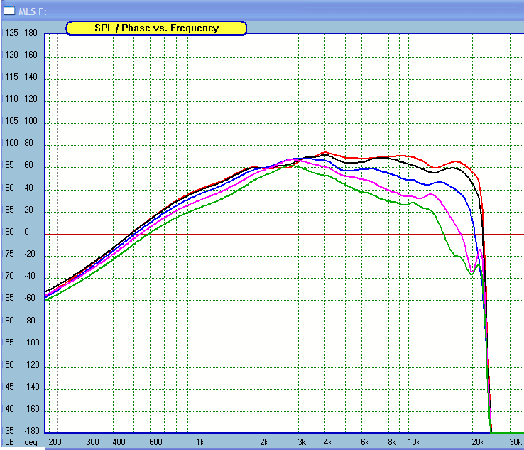

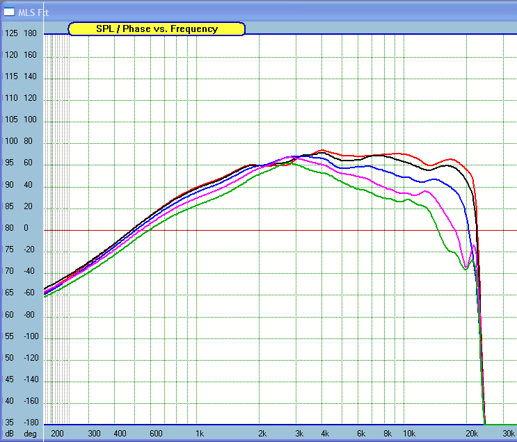

                For those interested, here are some new and more accurate measurements of the Peerless HDS tweeter in a 1/2" waveguide mount (1/2" deep. 1/2" roundover) and a 3/4" waveguide (3/4" deep, 3/4" roundover) both show spl measurements on axis, 15, 30, and 45 degrees off axis (horizontally). These were taken at 1m, with a 5ms gated window, tweeter at about 80" above the floor (vaulted ceilings).
                First 1/2" deep waveguide:

                Next 3/4" deep waveguide:

                Dan N.

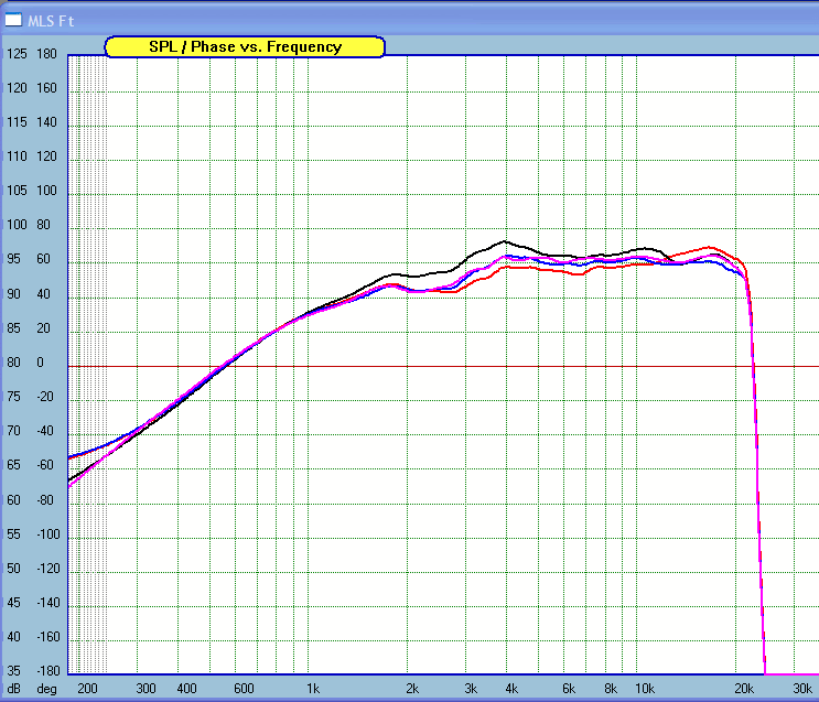

                  This is predominantly for Augerpro, since he seems the most interested. I want to test further versions of simple waveguide mounts. My plan is to test a 5/8" deep and 1/2" deep waveguides, but with a 3/4" roundover. I will do this by starting with a 3/4" roundover on a 1-1/4" dia hole in 3/4" stock and then route out the back to 5/8" depth, test, and then route out another 1/8" to a 1/2" depth and test that. This will change the throat angle from 90º to the tweeter face at a full 3/4" depth to about 100º at 5/8" and about 110º at 1/2".
                  Hopefully I will find a combination that offers the low end boost I want to flatten the FR of the HDS, with some directivity control, but with a little smoother FR, especially off axis. Below is a drawing of what I will be testing.
                  So far, my preference is for the 1/2" deep WG with a 1/2" roundover, as posted above. We'll see if these other two offer any improvements.

                                                                    Here are the flush mount (red), 1/2" deep/1/2" roundover(pink), 1/2" deep/3/4" roundover (blue) and 3/4" deep/3/4" roundover (black), all on axis.
                                                                    My conclusion is: it depends on what you are looking for. The deeper wavegides have more boost, but all peak at about 4kHz on axis. The 1/2" deep waveguide, with 1/2" roundover has the flattest FR on axis from 4kHz and up on axis. The 1/2" deep/3/4" roundover WG and the 3/4" deep/3/4" roundover WG have the best off axis response when you get out to 30º and beyond and the most directivity. I'm now leaning toward either the 1/2" deep/3/4" roundover of the 1/2" deep/1/2" roundover WG's from a raw response point of view. I will see how they look in the crossover design.
                                                                    I hope these results will encourage some of you to experiment with this concept. I think it has a lot of merit and is not at all hard to do with just a router and standard bits. It helps if you have a drill press and a router table as well.

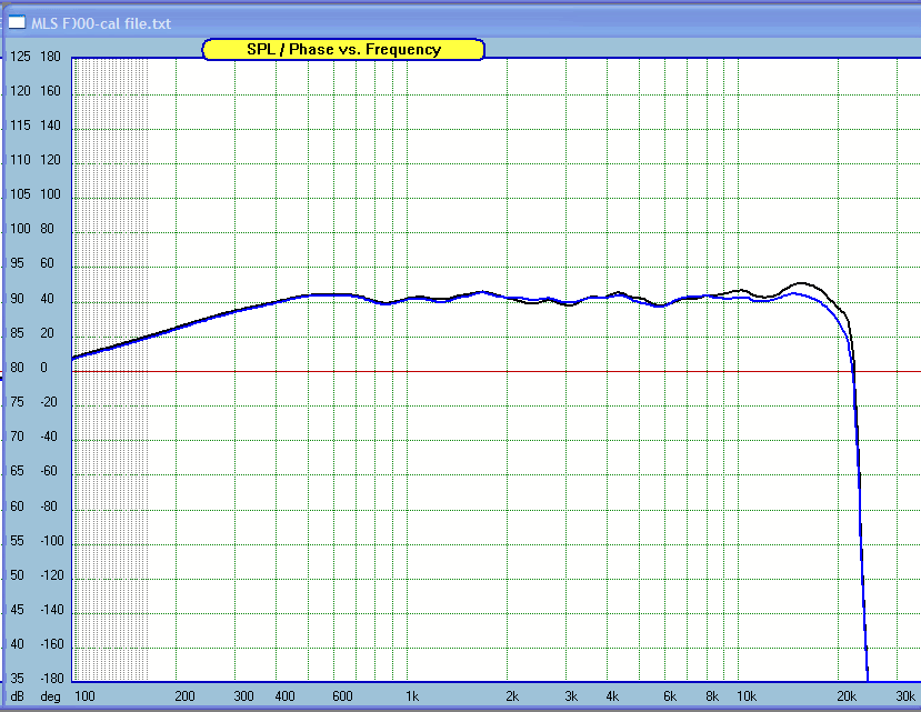

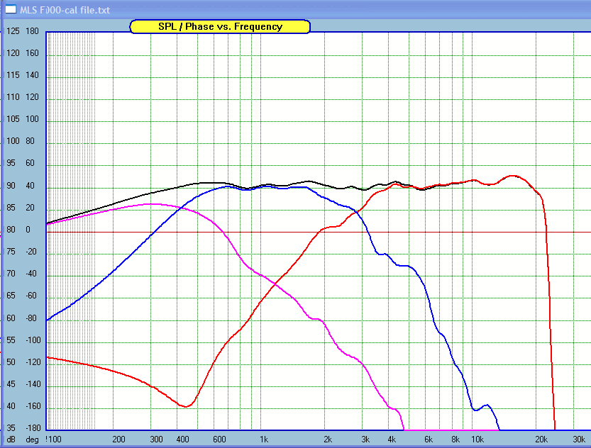

                                                                        Here are some preliminary crossover results:
                                                                        These are measured results, taken at 6' with the speaker up on stands so the tweeter and mic is about 80" high. A 6ms gated window was used, so the woofer output looks low, which is due only to the window length. You should pretty much ignore the data below about 500-600hz. I'd have to combine a longer gated farfield measurement on the woofer, with a nearfield woofer and port measurment to give an accurate picture of the low end.
                                                                        The actual crossover points for the woofer and mid are about 450hz, the mid to tweeter, about 2.8kHz. I used the 1/2" deep waveguide with 3/4" roundover for these measurments. The 1/2" deep/1/2" roundover would give a flatter response in the 4-10k area, but is not as good off axis in terms of directivity. I will measure with it as well, so I can make a comparison. I will also listen to both to compare them.
                                                                        At this point the crossover indcludes a notch filter to suppress the 6md38's peak at 5kHz, but it is mildly implemented at this time. When it comes to listening and voicing, I will try it with more suppression of the peak and with the notch filter out completely, to see what my ears prefer. I like to start with a pretty flat FR and then adjust by ear. I did keep the tweeter a little hot to start out with so that at 15º off axis it is about flat (see graph 2). Impedance looks like a nominal 8ohm, with a low of about 6 ohms. I've chopped off the graphs in order to keep them as small as possible while still easily readable.
                                                                        Next up is lots of listening, which includes trying at least two different slot port lengths to determine what sounds best at the low end as well.
                                                                        SPL with individual drivers shown (woofer not accurate below 600hz or so)

                                                                        SPL on axis (black) and 15º off axis (blue)
