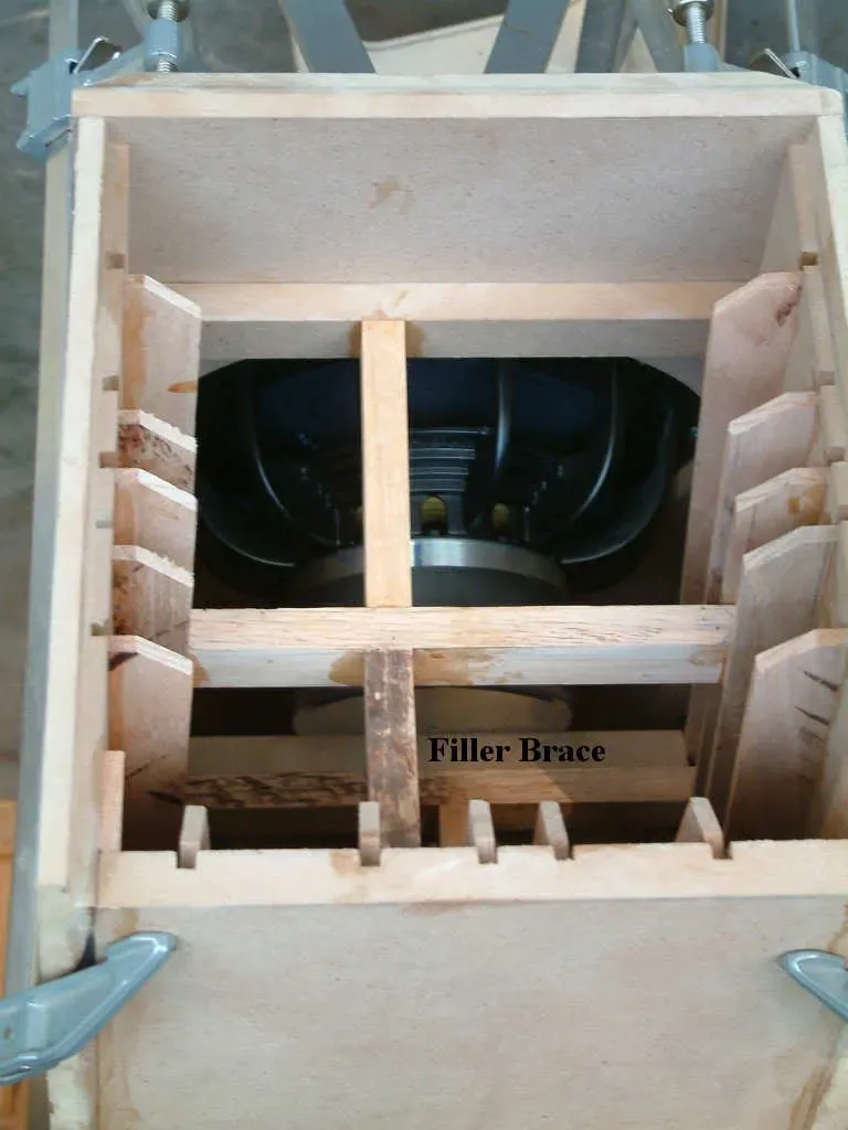

Yes, that's the concept. Reduce panel resonance, while using up less volume for the bracing as compared to standard window bracing. I actually compared the volume of my original window bracing plan to the ribbed construction plan and the ribbed had about 17% less volume for bracing.
There was a thread on that over at the PE forume here:
Ribbed box constructionDan N.- Bottom

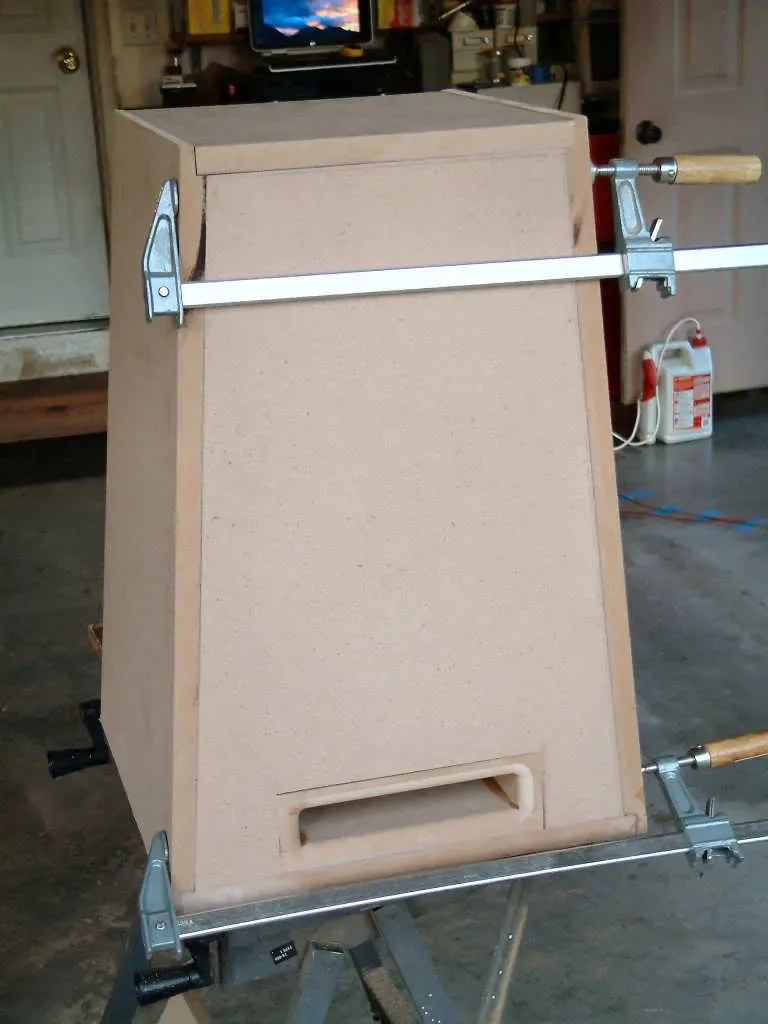

Here are some more construction pics. FYI, the baffles are test baffles. The finished ones will be laminated hardwood and Lexan as planned. The box has been glued up (except the top). The slot port will remain removable for two reasons. First, so it can be adjusted if need be, based on testing and listening impressions. Also, it will either be painted (the box will be veneered with Bubinga) or it may be replaced with a hardwood slot port. The woofer baffle will be removable. Here you can see the cross bracing implemented, including a "filler brace". This brace will be glued to front of the cross brace and have speaker gasket material on its face. It will physically connect to the back of the woofer. This will essentially connect the woofer to all four sides, to distribute vibrations and reduce motor movement. I have to add the small dowel, top to bottom, through the port, add front face cross braces that will be used for mounting threaded inserts for the baffle removal and pack the space between the ribs with insulation.
When the top and baffle are clamped on, the box does indeed sound quite dead, from a knuckle rap perspective. I have no other way to test it. Of course it will be even better when the top is glued on, the filler brace fully implemented and the final version of the port glued in.
You can see the woofer mounted from the back, 1/2" inset, with 1/2" roundover. I want to cut a steeper chamfer on the top of the woofer baffle, probably 30º or less.
Dan N.- Bottom

I really like the dadoed slat idea. I think I'll do the same for my Trilliums. It appears that you ended up going with oak, correct? I'll use oak as well, since it isn't undersized like plywood. I don't have a dado blade, so I'll have to use my router and router table.
Thanks for the idea!- Bottom
Yes, they are red oak. First I ripped several pieces and decided it would be simpler to buy 1/4" stock, which my local Menards carries. I bought 1/4"x8" stock and ripped them to 1-1/2" wide slats, then set in 1/4"wide by 1/4" deep dadoes.
I described how I located the slats in the posts below, though I ended up with the 1/4" red oak in the end, all the same depth.
One other interesting thing is that the ribs give a lot of extra surface to glue cross-bracing to, instead of just the end of he brace, if you get what I mean. Only glue was used, no screws.Dan N.- Bottom

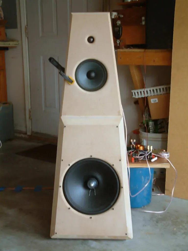

I’ve got a prototype of my BaSSlines together, for testing purposes, though I don’t yet have my midrange drivers yet, since they are on backorder until October 10th. Instead I popped in some used Audax Pro mids into the open baffle.
I started with Jeff’s original crossover for his Salk speaker and just made some adjustments by ear and also knowing that the tweeter would have a boost at the low end due to the 1/2" deep waveguide mount. Based on my raw listening impressions, I'll say is I think these could be very, very good. The TD12H is one clean woofer. I think the Peerless HDS tweeter in the ½” waveguide is going to work out very well also, based on this test.
Here are a couple of photos of what I’m listening to as I build the second box and wait for the mids to get into stock. I should be starting on some measurements soon on the TD12H and the HDS. I have the Lexan for the open baffle section, but see no reason to mess with it until the design is nearly finalized.

Looks solid Dan. What mid did you decide to go with again?- Bottom
Brandon, I have two B&C md38's on backorder at PE.
Saurav, when I get the other box done, probably some time next week, I'll start on measurements and will include the temporary mid (yes those are the PR170MO). I want to find out what, if any, negative impact, shows up in the measurements due to the recessed mounting. I'm going to have to make a test baffle for a standard flush mount for comparison purposes. I do like the way the rear mount looks. The aesthetics are very simple and clean. It reduces the impact of the driver sizes and makes no grills more acceptable. I think it has a little higher WAF as well :W .Dan N.- Bottom
