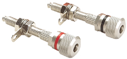

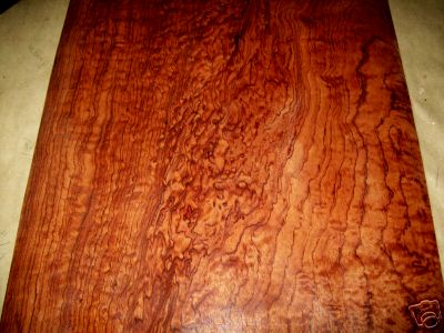

                                                                  There is not a lot of activity going on with this project since I'm applying finish to two other projects first, but the plans are coming together (see attached pdf). I received the Lambda TD12H drivers. They are georgeous to look and and very heavy! :T :T I'll take some photo's and post them soon. I have yet to order the mid drivers.
                                                                  The veneer choice has changed. My wife likes the look of Bubinga better, so below is what I have on the way. I'm still thinking of using a contrasting (light) hardwood on the front baffle and the Bubinga on the box. Since the Bubinga is so rich in color and texture, it may be something simple like Maple or Ash. I've found some speaker spikes, binding posts and brackets to hold up the open baffle that I have also ordered, shown below. They all match pretty well with the semi-polished silver phase plugs on the Lambda's.
Name:	Bubinga Veneer.jpg
Name:	Satin Nicket Binding Posts.jpg
                                                                  Last edited by theSven; 20 June 2023, 13:19 Tuesday. Reason: Update image location
                                                                  Dan N.
