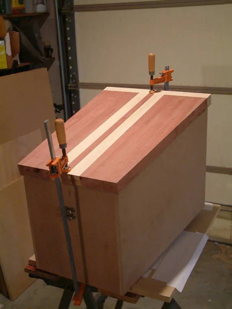

                              I wanted to post a step by step process to show how I did the baffles for this project, both the bass bin and open baffle mid baffles. This post will cover the bass bin baffles. Sorry it is so long!

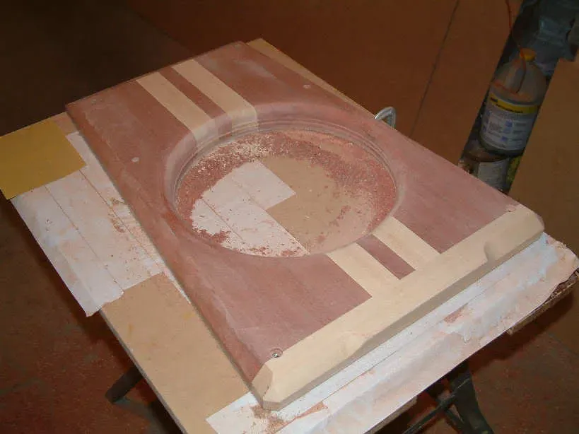

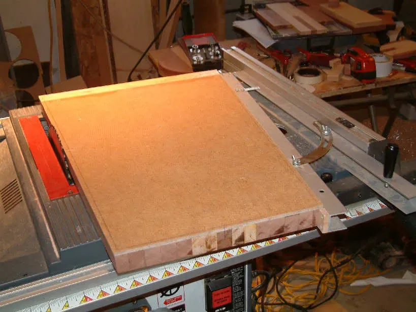

                              Bass Bin baffles:
                              After glue up of the baffles, I cut the baffles down so that they were within about ½” of the final width, making sure the center stripe stayed centered in the baffle. I used a portable circular saw with clamped guide piece. The bottom of the baffle was cut at an 8º angle on the table saw so that it would match the angle of the bottom of the box.
                              After clamping the baffle to the box, making sure the center stripe was vertical and centered; the edges of the box were marked from the back side of the baffle. I used these marks as guidelines for cutting the baffles, which was cut about 1/16” wider all around to make up for the veneer depth. I cut the baffle on the table saw, using an angle guide along the rip fence. This could also be done by hand with a circular saw and clamped guide piece. I might have used a flush trim bit in my router, but I had none that were deep enough to trim the 1-1/2” depth.

                              After the baffle had been cut to fit the box, I marked, counterbored and drilled the locations for the cap head screws that would go through the baffle to hold it to the box and also marked and drilled the location of the center of the woofer. I used a forstner bit for the counterbores and a drill bit larger than the cap head screw shaft so there is room for wood movement and a less than perfect match with the threaded inserts.
                              The location for the center bottom protrusion on the baffle was marked and using a 45º chamfer bit, I routered a ¾” chamfer up to those points. This was done using a router table, but could be done by hand. I recommend doing it in stages to build up to the ¾” depth, rather than ¾” all at once. I then routered sides in the same manner. I also cut (on the table saw) a small chamfer on the bottom of the protruding section so it was not a sharp corner. I also cut the chamfer on the top of the baffle (shown below). This cut was at 30º and was done in on the table saw, against the rip fence. A vertical support piece was placed along the rip fence to provide a larger vertical surface for the baffle to run along. The support piece was temporarily held to the rip fence using double sided tape and removed after the cut as made. This cut need to also be ¾” deep to match the chamfer on the sides and is used to locate the front of the OB section when positioning it. This was very difficult to hold steady with such a large piece and perhaps a little dangerous. It did not turn out as well as I would have liked. If I had to do it over, I would make a sled jig of sorts that I could clamp the baffle to and slide the whole thing along the rip fence in one piece. This is what I would recommend for anyone trying to make a cut steeper than 45º. It would be much more effective and safer. You could also just do a 45º cut here also with the table saw or chamfer bit.
                              Next I clamped the baffle to the box and using the holes I had already drilled as a guide, drilled pilot holes for the threaded insets into the box braces. Removing the baffle, I now was able to drill the appropriate sized holes for the threaded inserts and install them.

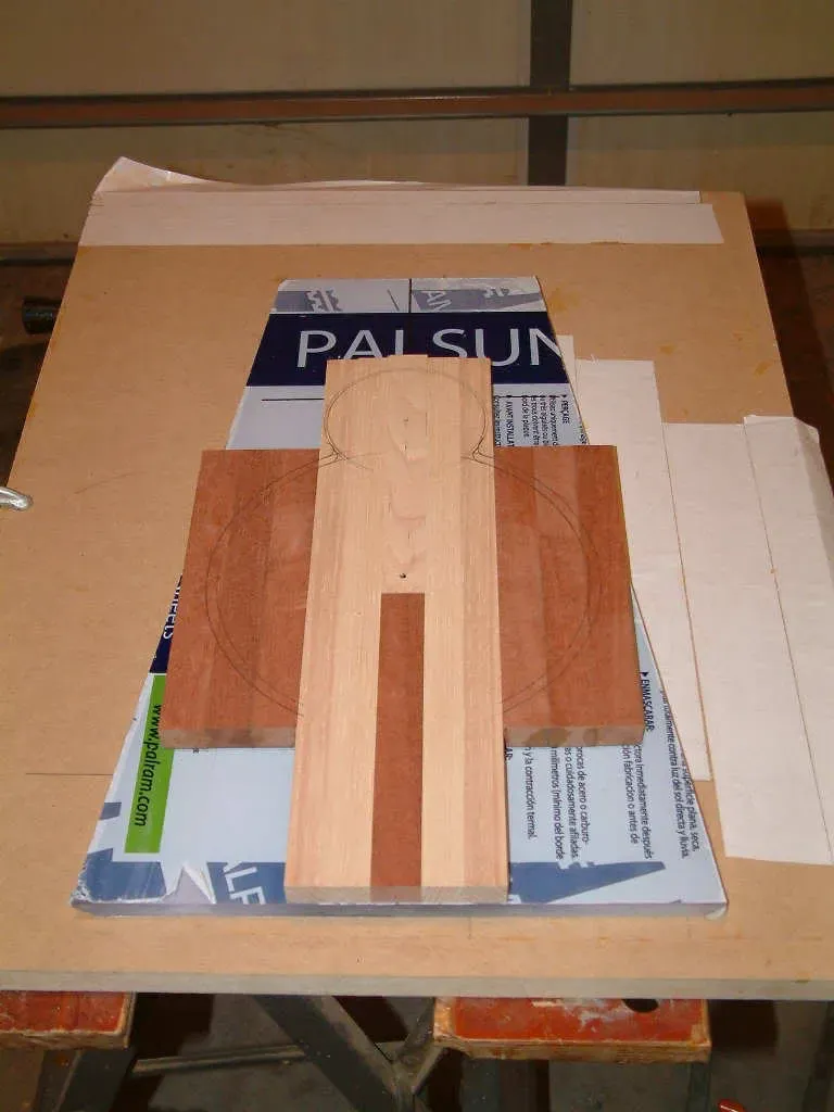

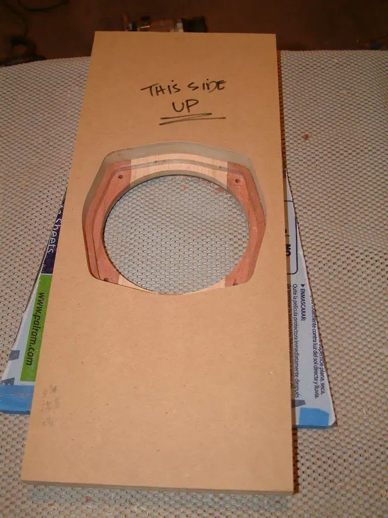

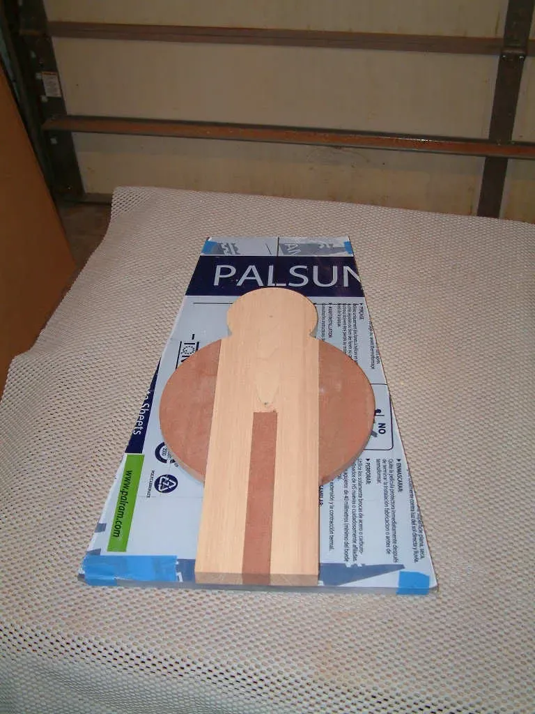

                                Open Baffle Section:
                                The open baffle section has a lot of small steps and if not done in the correct sequence can cause difficulties. Of note is the fact that you have a sandwiched baffle made up of Lexan with hardwood sandwiched between the Lexan and the drivers. Since the roundovers for the rear mounted midrange and tweeter have to those sandwiched materials match exactly, it is critical that they be created with the sandwich together in one process. I used double sided tape to accomplish holding them together during almost the entire process.
                                Starting with the raw laminated baffle, I marked the center points for the drivers for use with a circle jig later in the process. I used these center marks to draw the baffle shape on the wood so I could tell where to stop the routering at the circular intersections. I created a little extra interest by adding a little shadow box-like detail to the hardwood baffle that added one extra complication. This was simply an extra ¼”wide x 1/8” depth shelf around the mid section at the edges of the baffle that faces the back of the Lexan. You can see this in the lines drawn on the wood. Here it is laid on the back of the Lexan baffle.

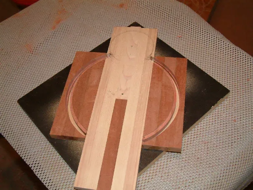

                                The routered circular shapes are all done first since they require a center hole for the circle jig. Here is a series of photos where I have used double side tape to hold the hardwood section of the baffle against an mdf backer piece for the edge routering.

                                As with the woofer baffle, both of these drivers will be mounted from the rear, so a rebate needs to be created from the rear. This must be done after the driver through holes are made, However, since the full depth of the two sandwiched materials is needed for the roundover bits bearing to ride on when the roundovers are completed from the front side. Here is a series of photos that show the steps of creating the start of the rebate for the tweeter, the mid and tweeter through holes and then the roundover. The roundovers were done in numerous small increments in the Lexan, to ensure it would not grab. Also included is a shot of locating and creating the tweeter bolt holes before the roundover is done. This is done by using the tweeter faceplate and the registration lines I drew on the front of the baffle while visually lining up the through hole in the baffle with the center hole in the faceplate. The faceplate was again held in place using double sided tape, as shown. I did small pilot through holes for the tweeter mount and did the counterbores for the round headed hex head screws before the roundover was done.

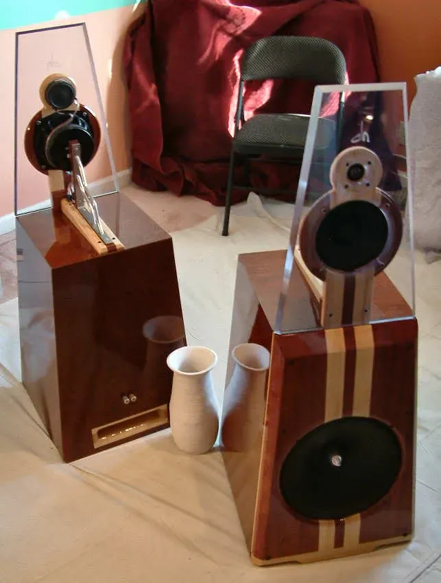

                                      Here is a little update. I got the veneer complete on one speaker and the hardwood slot port installed. I sanded it all down and put two quick coats of zinsers sealcoat on it. The crossover is still out of the box, with wires through the slot port. Here are a couple shots. Unfortunately, they are taken this evening after dark, so I had to use a flash. Really looking like a speaker now. I have not done any polishing on the roundovers on this baffle yet. I have yet to decide whether to do a high gloss or satin finish on the wood parts. What do you all think?

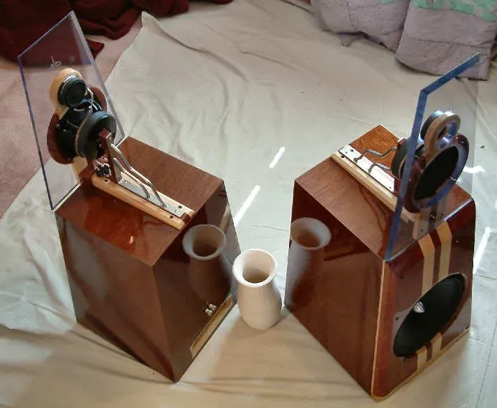

                                                  A daytime pic with more natural looking colors:

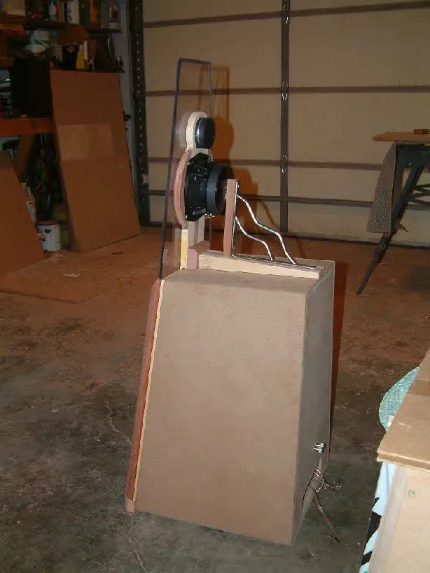

                                                                            I took a break to work on a crossover design for another project, but I'm back trying to wrap up the BaSSlines finish. I have decided to go high gloss throughout. Here is a little taste of what they will look like when completed. I hope to have the finish wrapped up in the next week or two and then will make any final crossover tweaks (if any) and publish the completed design. I used a small spare room we have upstairs to do the finishing in, since it is easier than doing out in the garage this time of year. I etched the logo on the Lexan with by hand with a dremel using vinyl stencils (that John over at AE speakers did for me, thanks John!) as a guideline.

                                                                                      • 1456
                                                                                      #447
                                                                                      Here are a couple more:

                                                                                      • titch--
                                                                                        • 22
                                                                                        #448
                                                                                        Very nice Dan!
                                                                                        • JoshK
                                                                                          • 748
                                                                                          #449
                                                                                          These turned out wonderfully. They look fantastic as all your projects do!
                                                                                          I'm jealous.
                                                                                          When are you going to start on mine?
                                                                                            • 1913
                                                                                            #450
                                                                                            Beautiful looking speakers you've built there Dan! You definitely have an artists touch. Can't wait to get you're sonic impressions on these.
