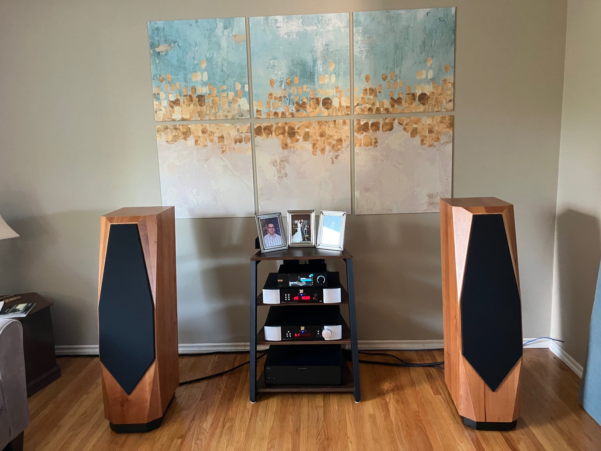

                                Just saw this interesting read and I wonder if there is some more work to do on the power supply side for class D.
                                I had no issue with switch mode power supplies on the pro-audio side of amps for subwoofers but starting with Ncore and a nameless power supply used for these and the new Purify amps seams to not last very long under light conditions. In my very little circle of 3 people we have had 3 flaky power supplies. After my NC500 build flaked I wanted to try Purify so I went with an affordable NAD C298 with Purify and NAD's power supply and liked the sound upgrade from Ncore but worried the long term reliability of the power supply might not be there. Now I think class A/B manufacturers have had to adjust pricing from the introduction of these new wonderful affordable Class D's to the market but do they have issues with longevity of the power supplies? The power supply is complicated, is this the issue?
                                I started thinking just go with the newer Bryston 3B3 or 4B3, 20 Year warranty and sounds wonderful! This amp is close to $8,000 cad. but is on the lower end of really good A/b's or get the Masters NAD M23 with a little different design and hope my light use will last me.
                                New M23

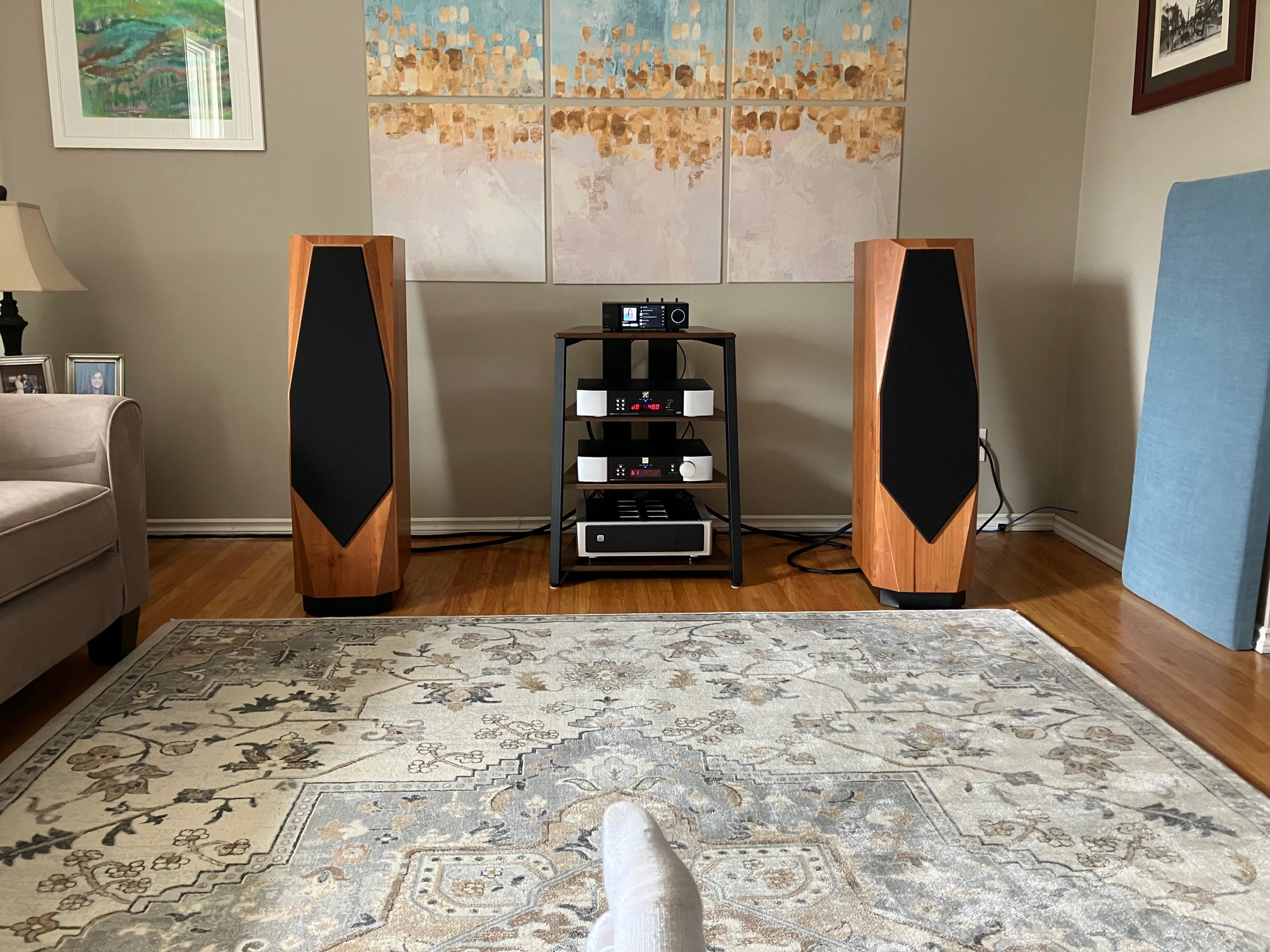

                                On another note maybe I am just a worry wort but I also change the power supply in my Eversolo DMP-6 streamer to a leaner one and maybe I here a difference LOL.
                                  With the new M23
