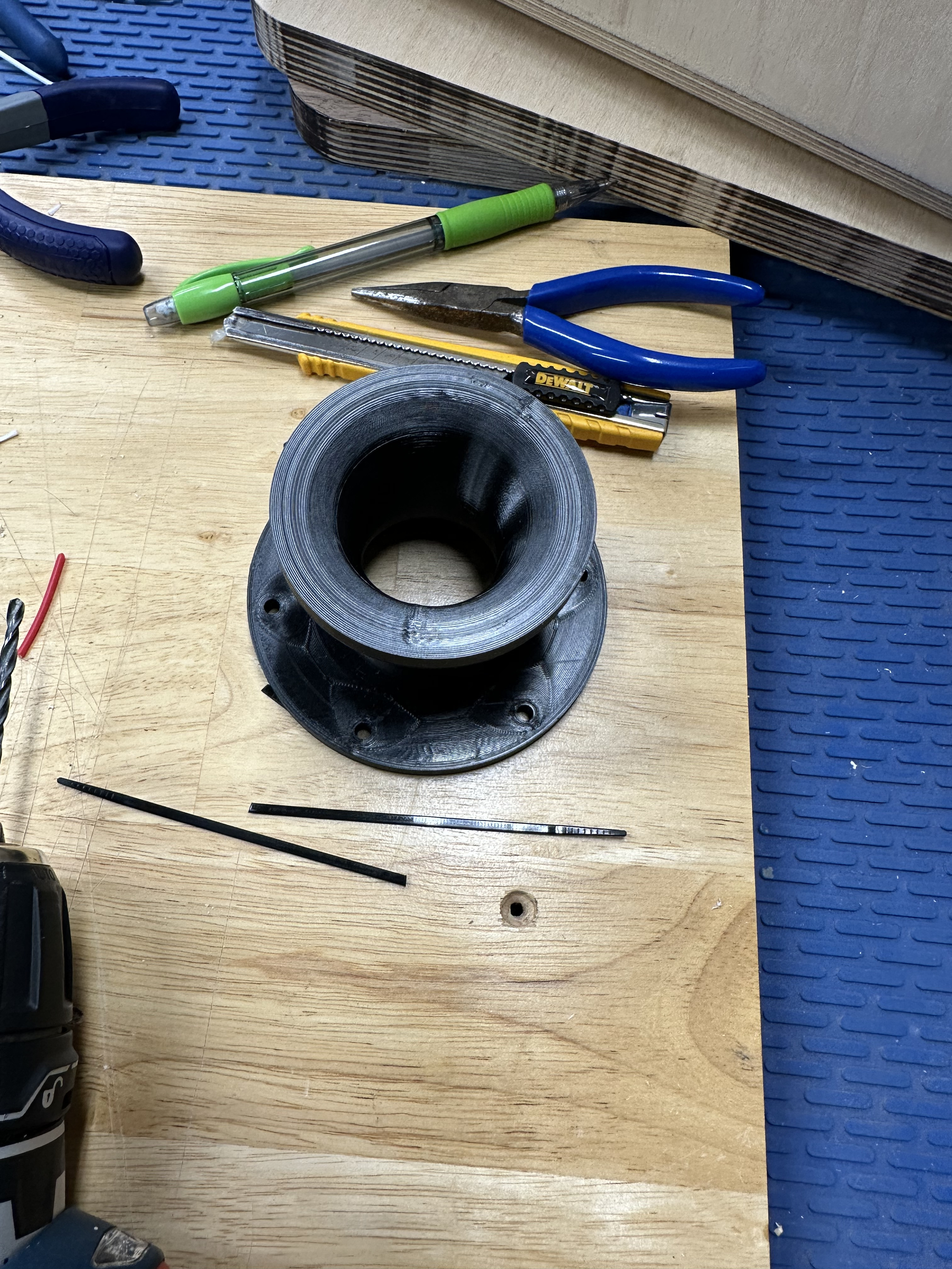

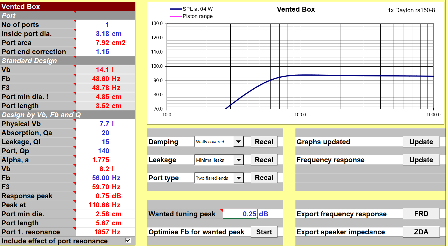

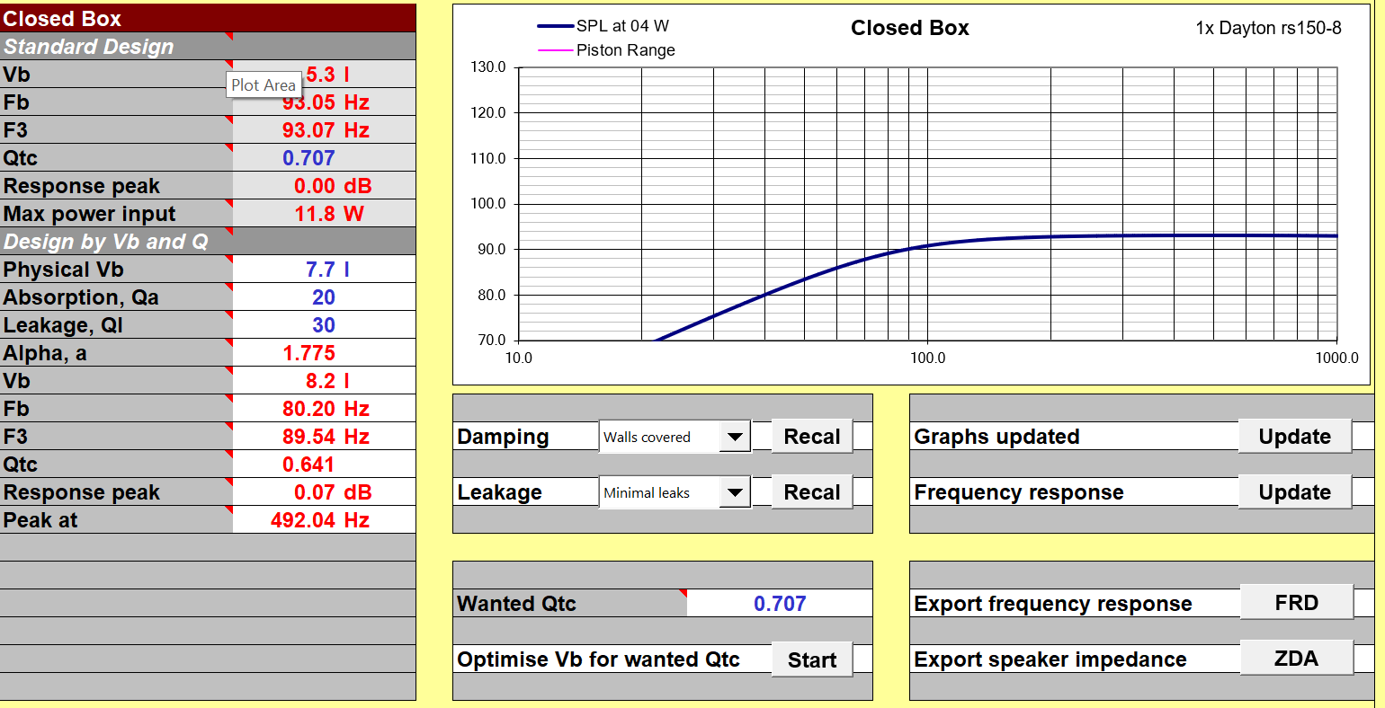

        Like most projects, this had a detour along the way. I had originally thought these would be my main system's final rear surrounds. The reality set in and I figured
        I should design these to be moved elsewhere if I desire. So, the volume size was mainly dictated by the location that they would be used. Sealed represented the smallest size option and it was modeled a bit large after reviewing them in person. I trimmed of a bit of the front edge to the current size. The back is removable and I may experiment to see what I like best. Attached are the unibox results of the modeling for the current size.
        Since they started at a specific size, I had to tinker with the port dimensions. Luckily, I have a 3d printer and the design file from Auger for the Harman port.

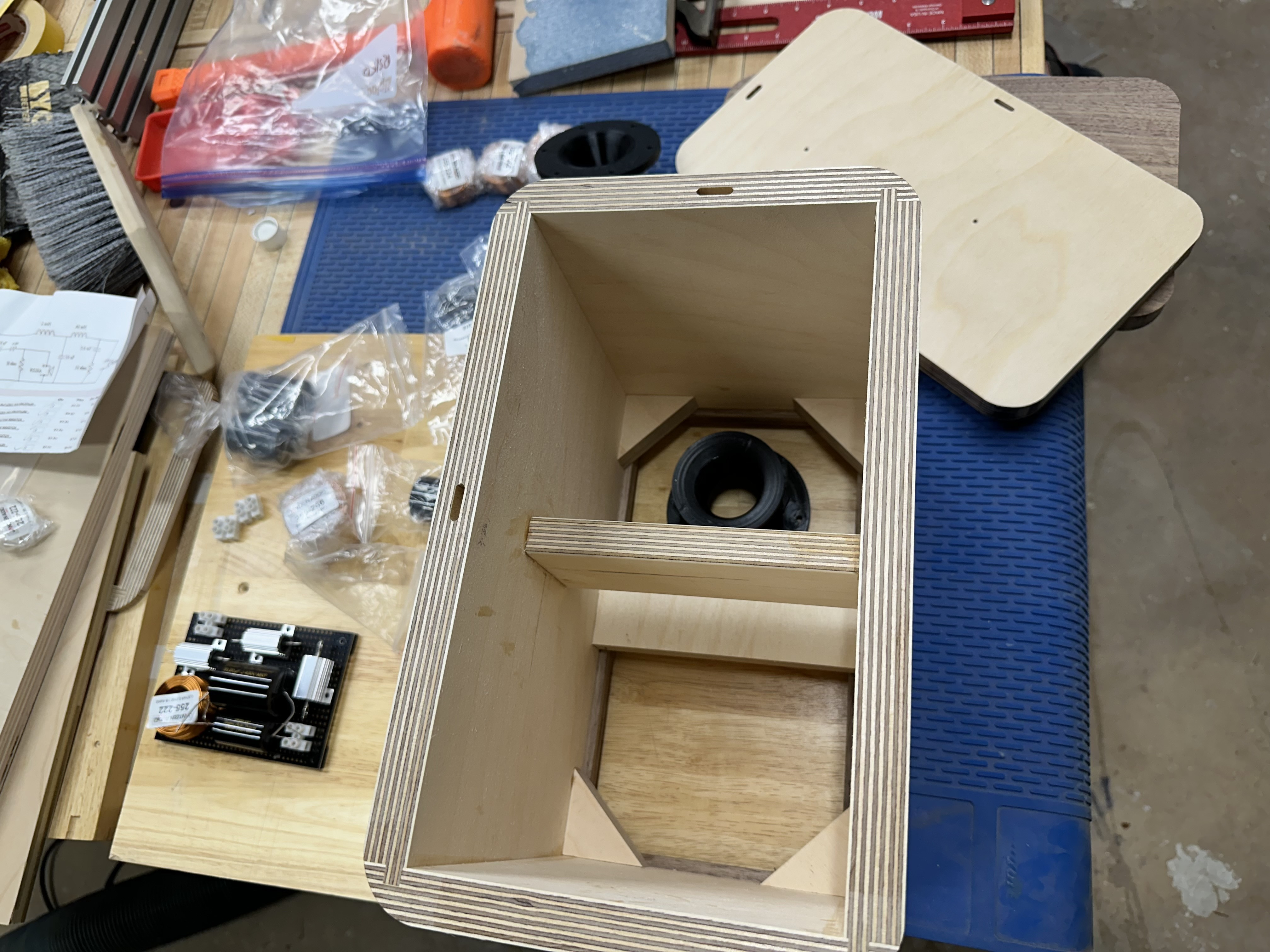

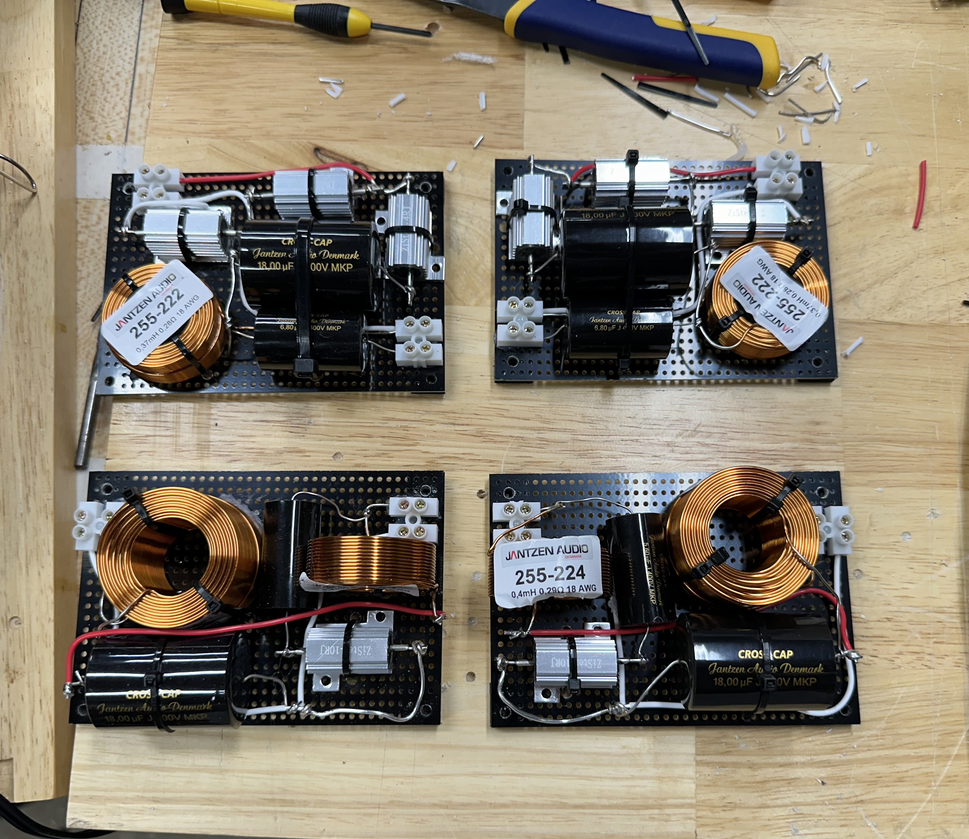

          A couple more pictures of the progress. I finished up the crossover boards over the last few weeks. Front baffles have been veneered prior to the holes being cut. The depth isn’t quite enough for the shallow flush trim bit. This also shows where the port will go on the back.

            Alright, some great progress there! very nice looking built work, and crossovers, too! Great dado work on the rounded cabinet corners!

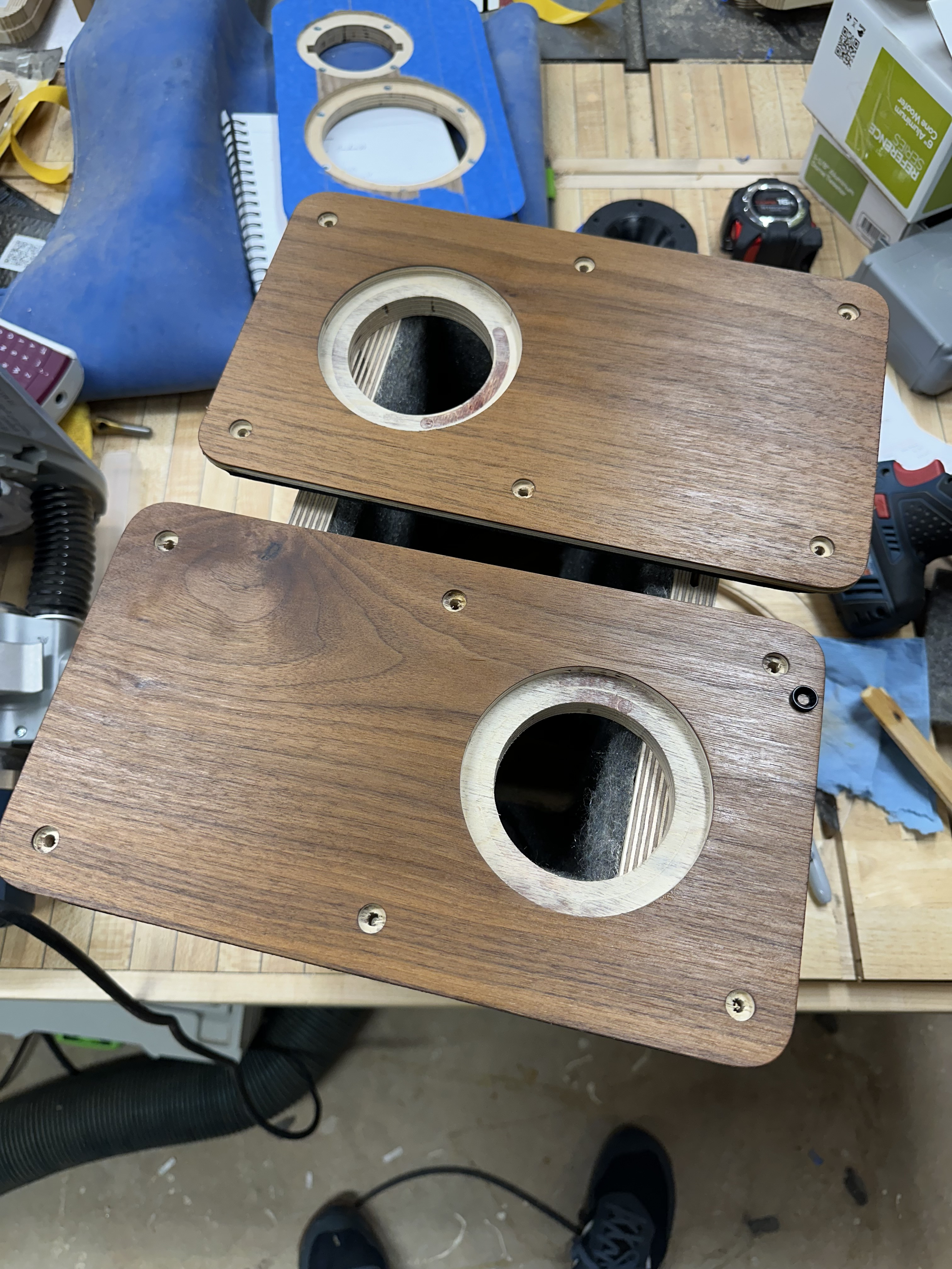

                  I finally got more time to work on these today. The intent was to stop working early on Friday to get some project time but there was too much to be done.
                  I made a couple practice cuts on scrap to make sure the divers fit and were flush. Painters tape was used to protect the walnut veneer I added to the front baffles over the imbedded magnets. I prefer to veneer after but the diver flanges where under 1/8” which is the shallow end of the flush cutting bits.
                  Tomorrow I will add threaded inserts that I just got in from Rampa and cover the walls with auto jute padding. It has all the characteristics of the shredded jeans but should be easier to work with.

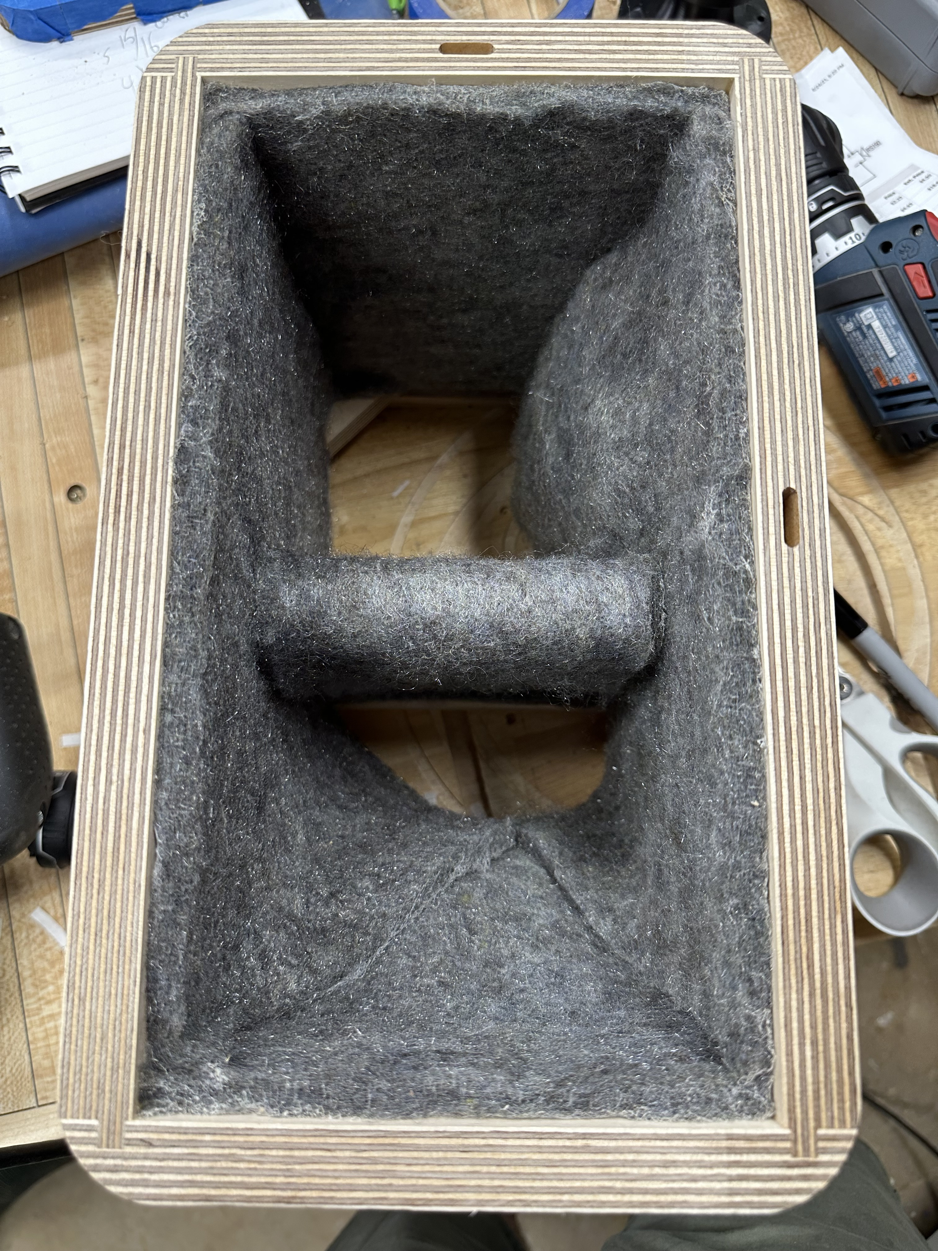

                        I started focusing on the smaller things I can do during the week. Sounded deadening has been cut for one speaker minus the back. Fiskars powercut scissors are a huge win for this and cutting veneer.

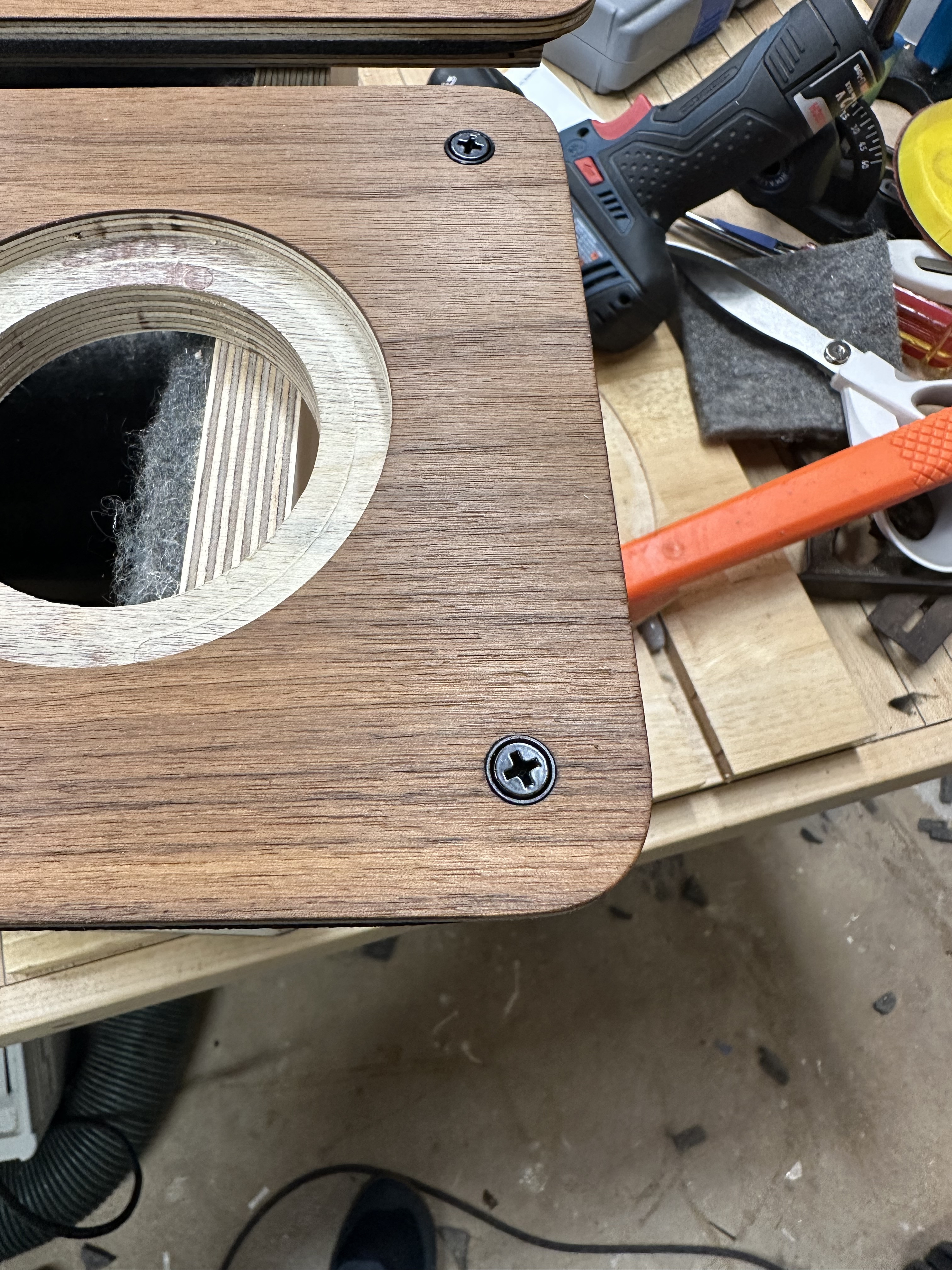

                              Making some more progress today. The crossovers are mounted using stainless screws, padding is glued in place via super 77 and I applied the Rubio to the back panels. I wanted to finish them before dropping in the ports, speaker terminals and countersunk washers.
                              The countersunk washers are something I discovered during the guitar speaker box build. They typically have these washers that self align and give it a professional finish. Similarly, they make some in a shape that looks to be perfect for making them flush with a face. See the picture to give you an idea. M4 of this brand works for 8-32 screws as well.

                                This shows the rough finished result of the countersunk screws. Once tightened they should be very flush with the surface.
                                  • 16175
                                  I remember those washers from the speaker cabinets I used to build for the band equipment, mostly PA, but also a set of faux Marshall style 4 x 12"!

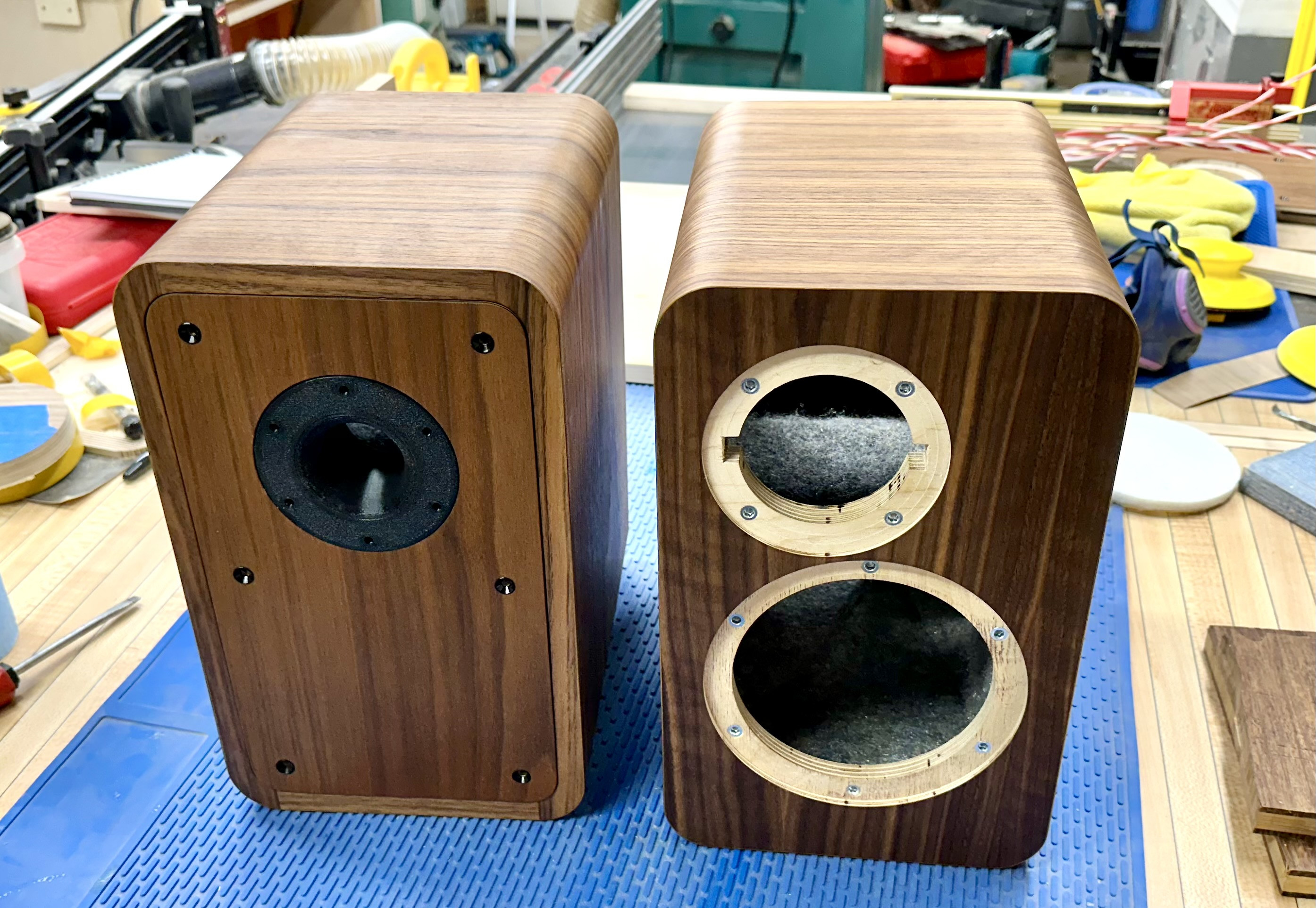

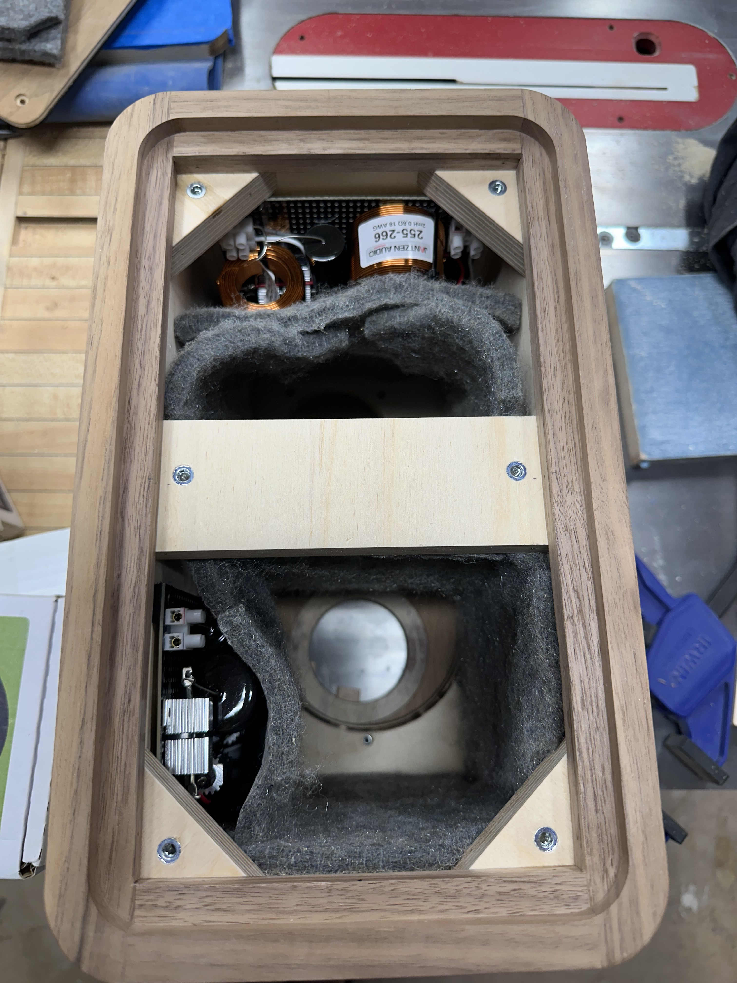

                                      The hard part is over! The fronts are glued and dominoed in place and the cabinets are veneered. Paper backed walnut veneer glued in place using titebond 2 with the iron on method. This will match the sub once complete. Grills are magnetic and I have a template ready to go for perfect alignment.
                                      How do I make the best out of grills impacting the sound? Do I need to put felt around the inside edges?
                                        • 16175
                                        Well, if you have the capability, I'd say measure, don't guess. But felt around the inside edges is likely to be a good idea...

                                          Sounds good, I will try before and after and take a stab at a proper measurement.

                                        Finished them with Rubio monocoat pure 2c today and these are about ready to assemble. Last bit before firing them up is to drill for the binding posts and wire them up. Measurement and grills will be next. I am hoping these will be a temporary improvement over some older Paradigm Titans.
                                        I am very much looking forward to kicking off the next project.

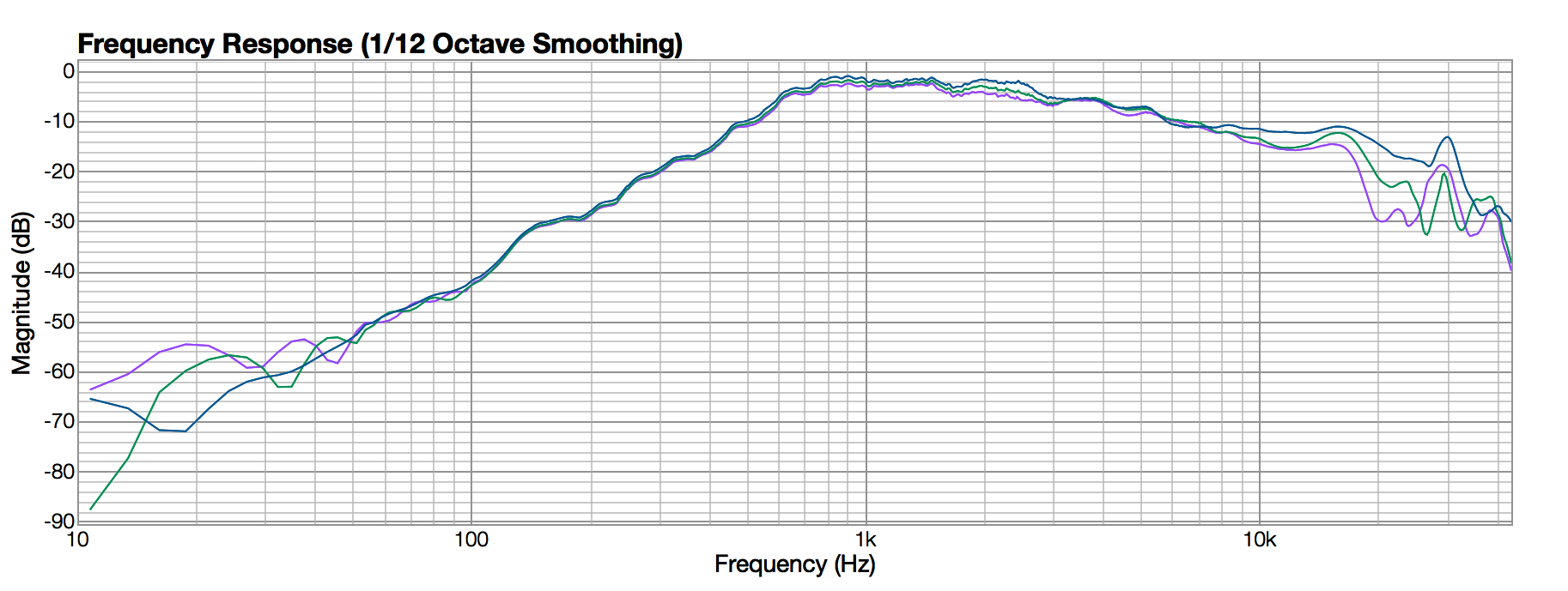

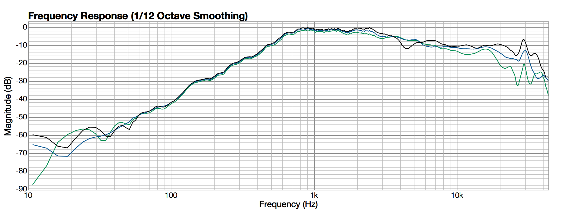

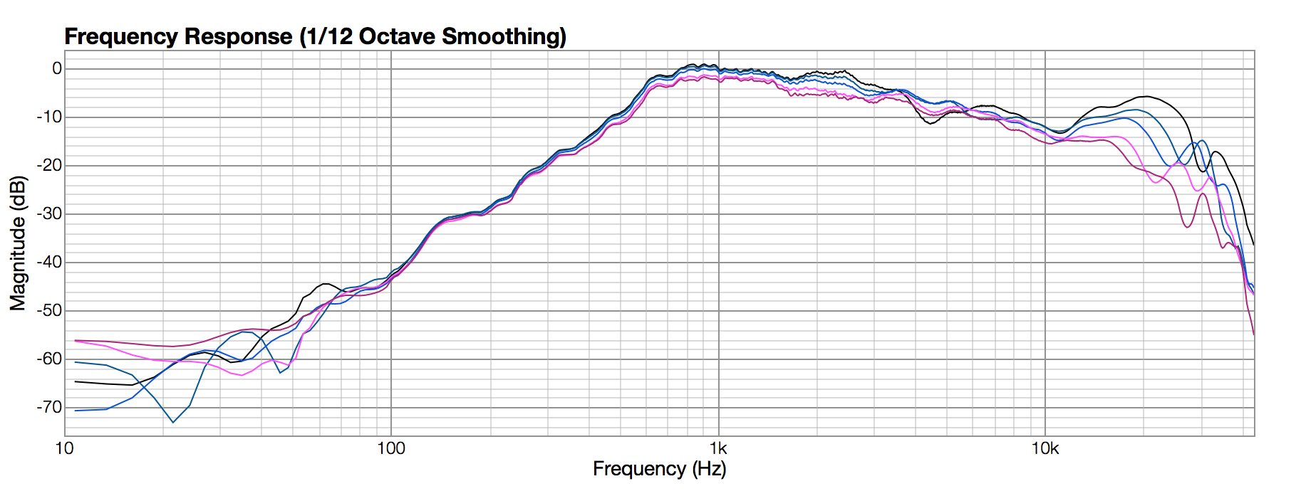

                                                Hooked them up today and have been working through the receiver to get them dialed in. They need better placement and I need to measure them as well to make sure nothing was missed along the way.
                                                The rs28a tweeters seem great for the price. It is a shame that they no longer make them.
                                                  • 16175
                                                  That is so, so true- but then, they were actually made by Usher for PE, not by the normal Dayton operations in Taiwan or China. And it's not the "made by", it's the "designed by", IMO.
                                                  For example, in the category of "things that could have been", Steve and I developed a stacked MDF waveguide for the RS28a which he milled to my spec, which gave very promising results.
                                                  Here's the 0-15-30 plot...
                                                  Click image for larger version  Name:	RS28a 0-15-30.png Views:	0 Size:	120.2 KB ID:	955338
                                                  But in some senses, for actual use, the 15-30-45 plot was even more interesting...
                                                  Click image for larger version  Name:	RS28a 15-30-45.png Views:	0 Size:	116.0 KB ID:	955339
                                                  The replacements, either the soft dome or the RST28a, just don't work as well, and seem to have issues with the throat interface as well- for the same test waveguide. Of course, they don't work as well for just a direct tweeter, either.
                                                  This is the results in the exact same waveguide used for the RS28a tests, for the RS28F. The RST28a was worse.
                                                  Click image for larger version  Name:	RS28F Polar Set.png Views:	0 Size:	151.3 KB ID:	955341​
                                                  The aluminum dome version has bigger issues with its relatively low intrinsic breakup mode and interface to the waveguide throat.
                                                  Too bad... a promising possibility cut off.

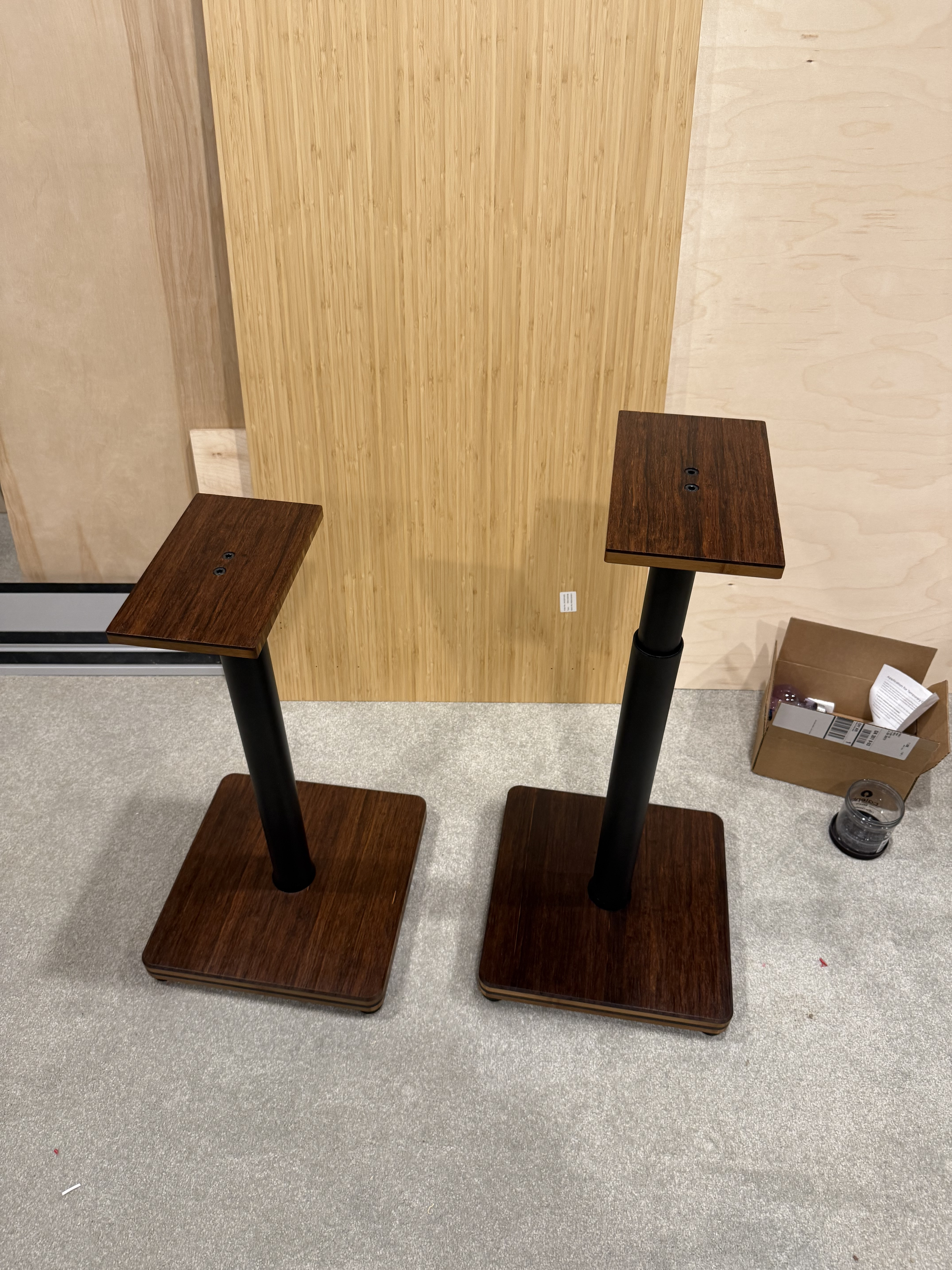

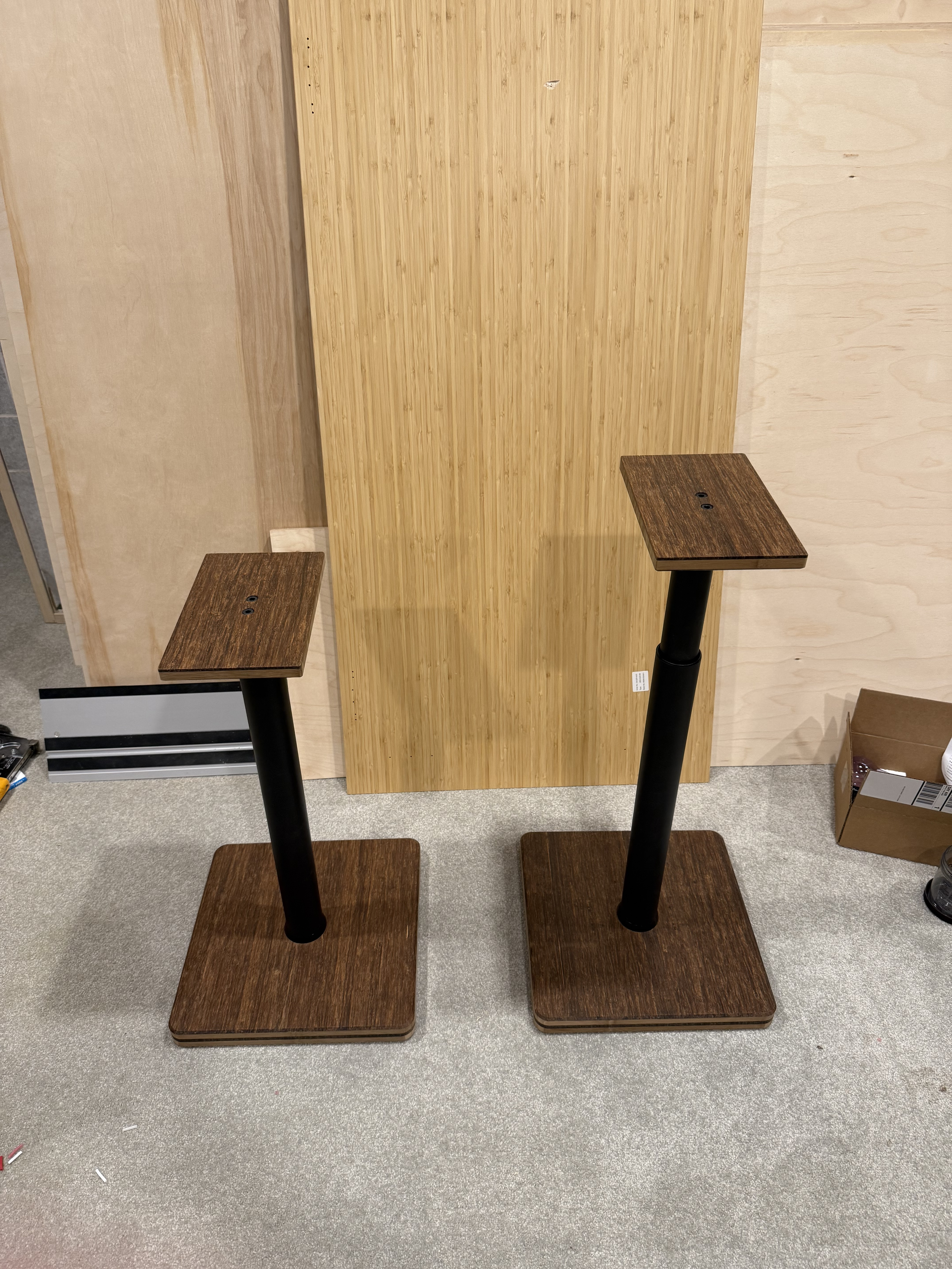

                                                    While I made bookshelf speakers the long term intend was not to suffocate them in an actual bookcase! Working on some basic speaker stands out of carbonized bamboo plywood. A sneak peak attached.
                                                    The other issue is with most stands they don’t have the ability to adjust in height. I looked long for something suitable from poles used in RV tables but ended up on an ikea special in my storage. A manually adjustable height desk using a set screw. The legs are very solid steel and the range in height is perfect.

                                                      Looks like an idea with potential...
                                                        • 1577

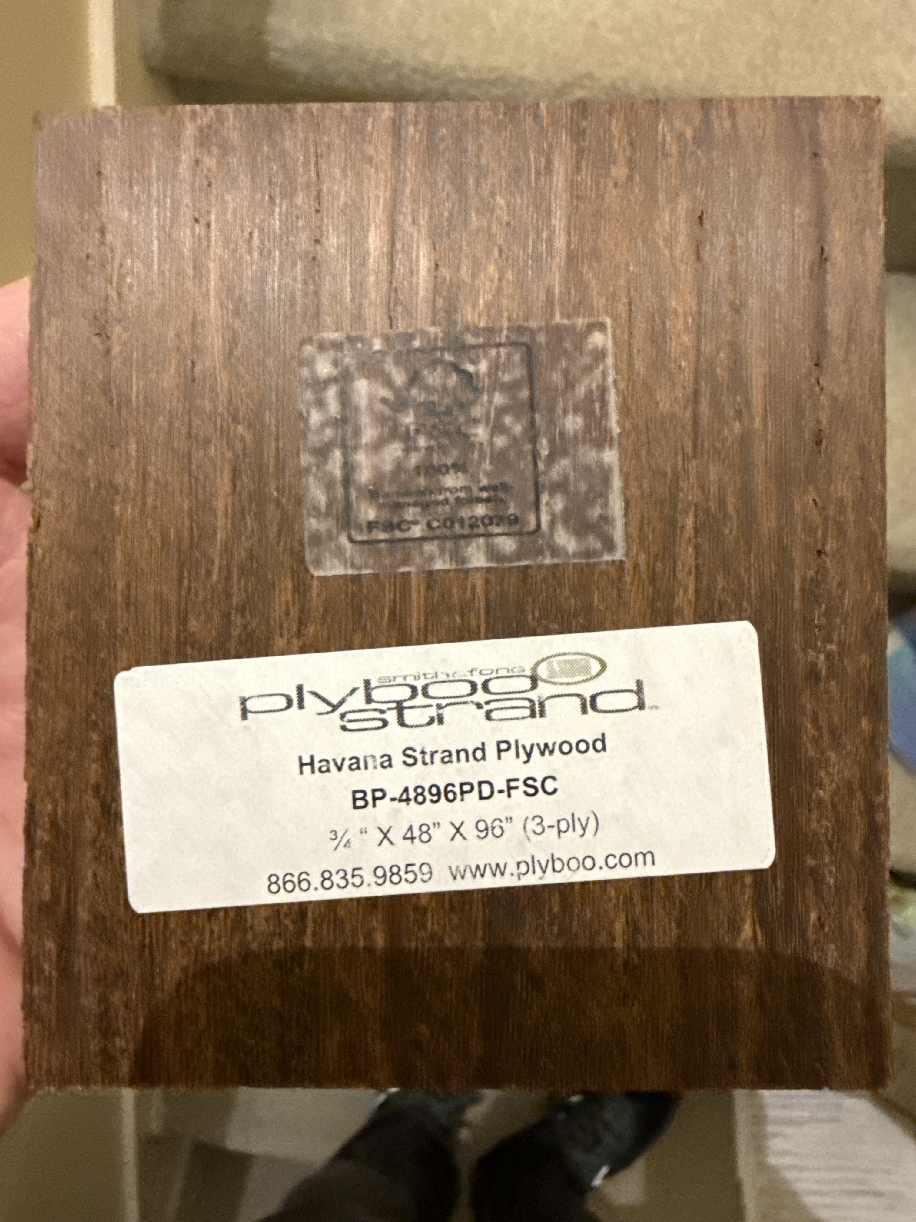

                                                        Where did you source the carbonized ply? I keep thinking I'd like to use some for a project.
                                                        • Scareurpasenger
                                                          • Jan 2017
                                                          • 166
                                                          I lucked out and found some on facebook marketplace. The brand is plyboo.

                                                            • 1577
                                                            Plyboo is great, I forgot I had a sample of this stuff lying about. I always wanted to try their dimensional lumber too but have been afraid to ask about the cost.

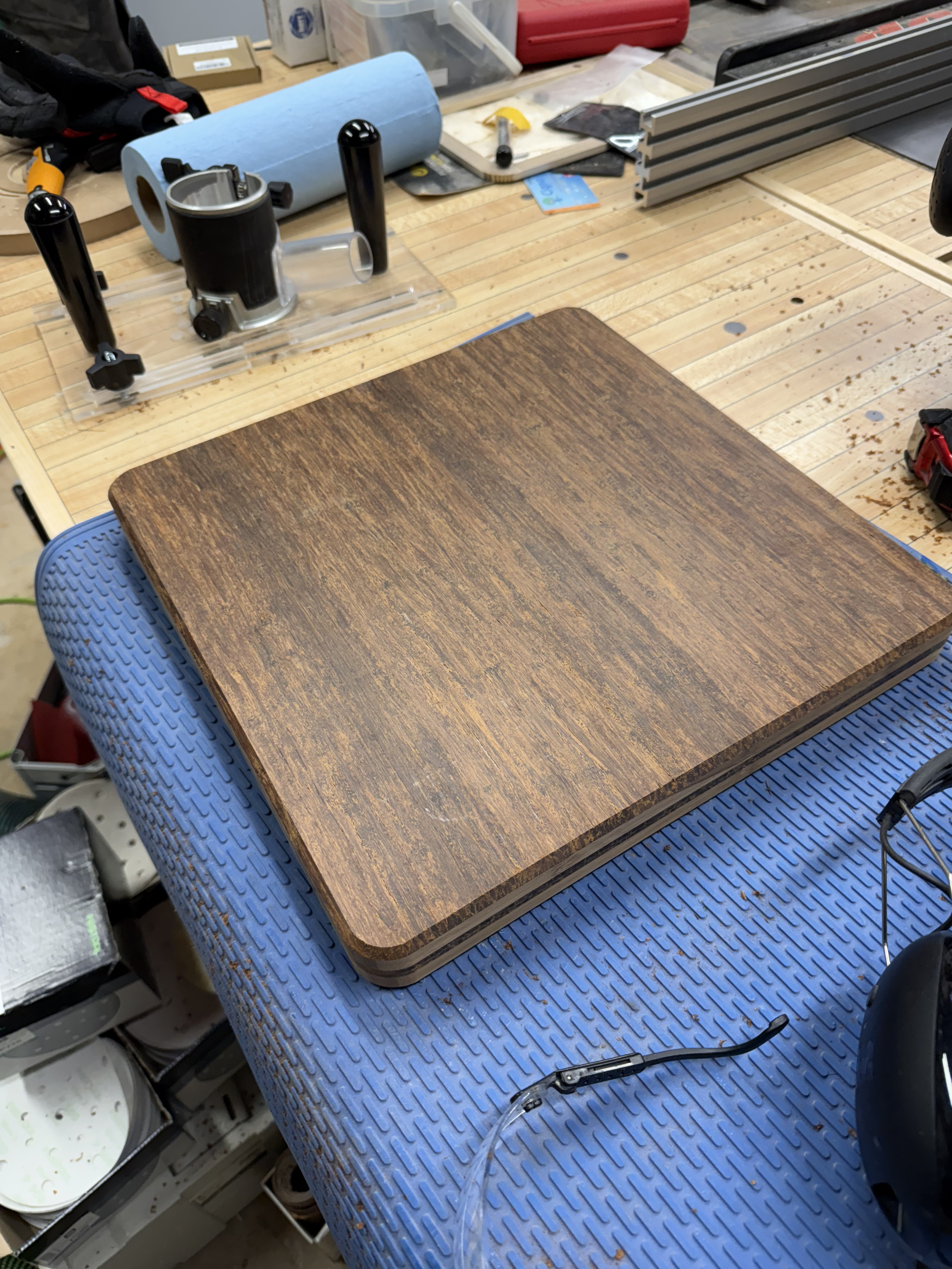

                                                              Well, I took the last couple days to wrap up the shaping and drilling for the posts and feet. The last step is finish but this is how they turned out.

                                                                I'm really digging that color of the bamboo. That's pretty handy to have an adjustable height option too!

                                                                  This is after applying the hardwax finish.
