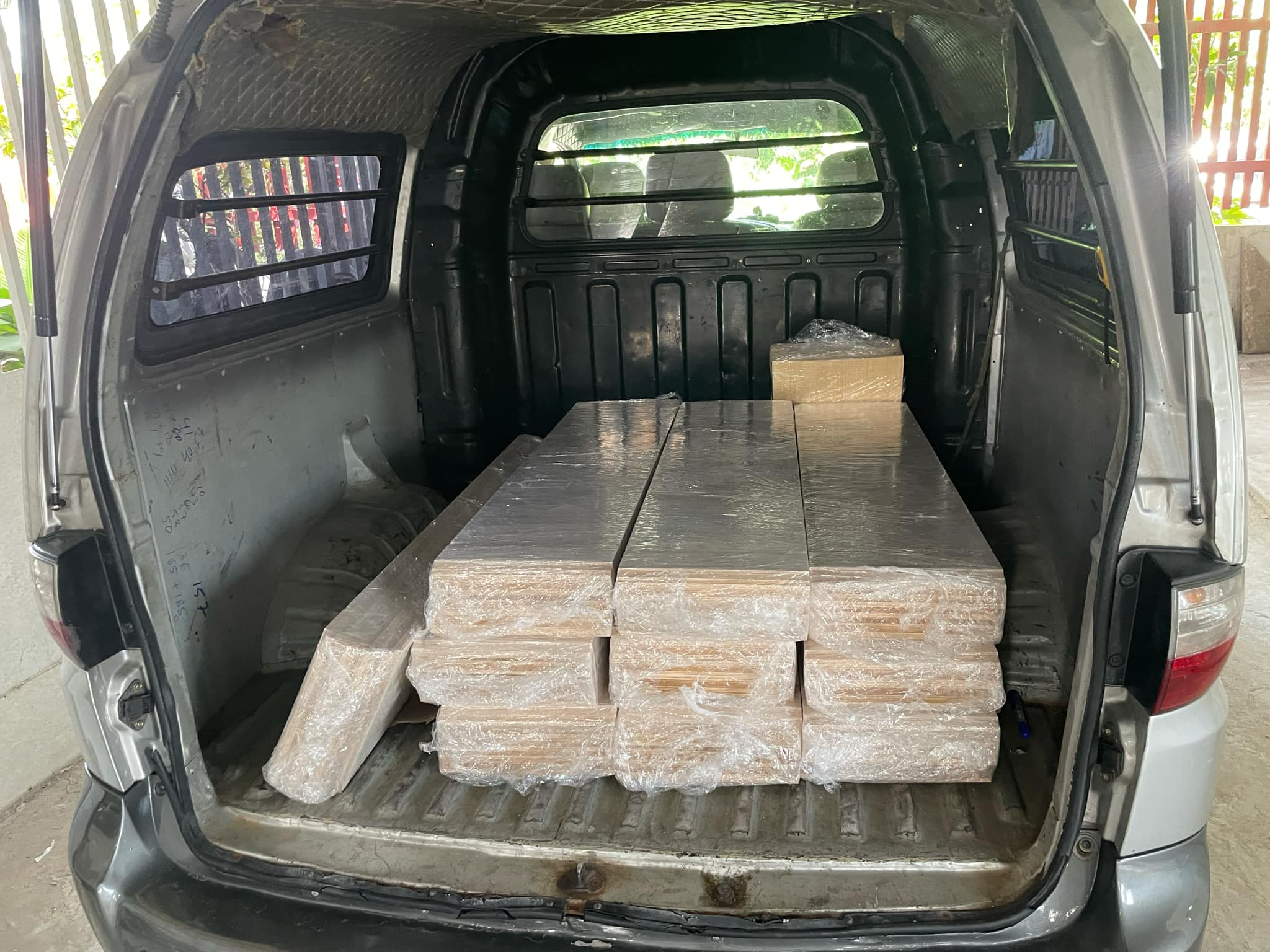

they are so beautiful, i wish i was in America. I live in Vietnam and I can only buy 15mm thick Baltic plywood. I will bring it to the CNC wood service provider near my house this Saturday. The above wood panels will be used for Top panel, Back panel, Inner front panel . Can anyone share their experience for CLD construction?- Bottom
