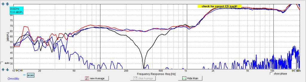

    My WTMW speaker is sick, it has a dip around 360hz, almost 10db deep. Its the speaker pictured in that build thread here. The dip is between 150hz and 800hz……XO points 400hz and 1.8khz
    I measured using my omnimic which im slowly relearning my way around the program.
    Any thoughts ? Questions ?
    I’ll try to post a graph

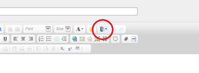

            If you're having issues attaching an image I understand completely, it isn't as intuitive here as it is at some other forums. When you 'go advanced' when posting this is the button you should use. It'll bring up a popup window where you can upload images and insert them in your post. Of course be sure your browser isn't blocking the popup window - a lot do that by default anymore.

              Thanx Dan! I will load up the images later. Since you looked at the graphs already, the two cabinets that measure fine at the LP are all the same, the center cabinet every single driver has a wonky :0) response or at least different from the other two that measure ok.

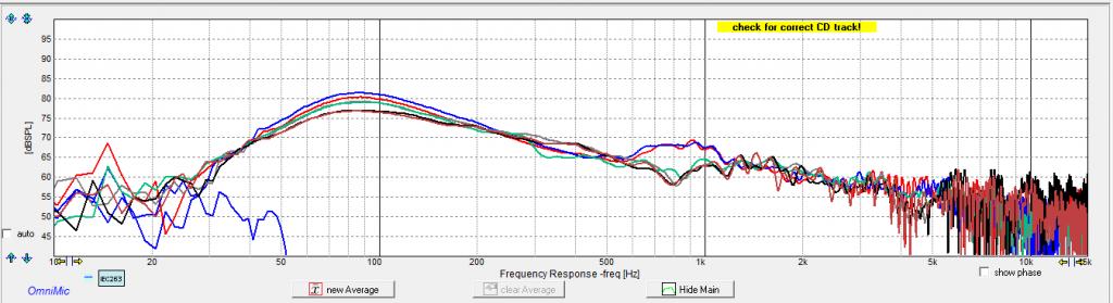

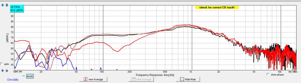

Name:	Complete sweep of all 6 woofers.jpg
ID:	866714Click image for larger version
Name:	Complete sweep of all 3 mids.jpg
ID:	866715Click image for larger version
Name:	Complete sweep of all 3 tweeters.jpg
                here are the close mic sweeps, again, im just looking to see if theyre all the same and clearly the one cabinet is different from the other two. these speakers are the ones in my avatar

                  If you look at the tweeter response, and the mid response of all three of each cabinets, the tweeter and mid that dont line up are in the cabinet in question

                    Looking at the six woofers, the two graphs that dont match are in the same cabinet, the other four are close enogh

                        Update: i swapped woofers from one cab to the other and the woofers are fine, the XO has issues, i gotta pull it out….
