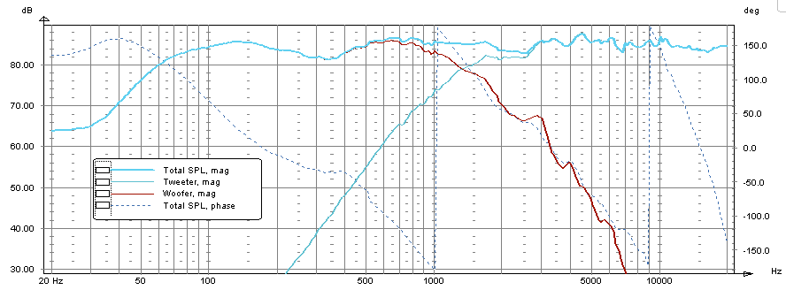

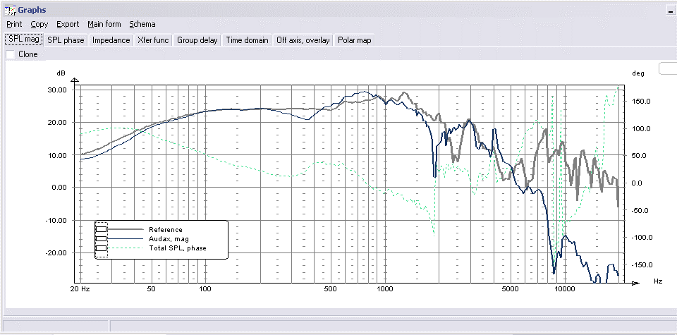

    I have this very strange problem. I don't believe I've ever seen it...
    There's this dip in the midbass, centered at around 340 Hz. I don't see what could be causing it.
    I'm using a vented box, 20L, tuned at around 35 Hz, with an Audax AP210ZO woofer. I padded it with 1" foam all around.
    The dip is very obvious when using a wide measurement window, and when doing a nearfield measurement on the woofer.
    I can't understand what's going on. I don't think it's a diffraction-related issue.
    Can it be that the box is not properly damped?
    EDIT: I just noticed my carpenter didn't use the right measurements for the box. Two dimensions are identical - 28 cms wide x 28 cms. deep x 39 cms. tall, using 3/4" MDF. Could this be part of the problem?

    How long is your gate when doing the nearfield measurement?
    I was first thinking it could be a floor bounce cancelation, but since it is there in the nearfield, it might rule that out.
    My suggestion is to run an impedance sweep and see if there may be some energy storage issues, or surround to cone mismatch. It's not unusual for "floppy" cones to exhibit a dip like you have pictured.
    • jbateman
      • 37
      The width and depth are approx 1/4 wavelength of the frequency of your cancellation.
      To see if this is the cause, remove the driver and make a nearfield measurement.

        Hi Jed!
        I believe I used a 60 ms gate. I also thought it was floor bounce cancellation, but when I saw this issue in the nearfield, I knew I had an issue. The impedance sweep is identical to the Parts Express one, and there aren't any issues I can see.
        Jbateman:
        My next step will be to do as you say - make a NF measurement of the driver only.
        I just noticed one thing, though:

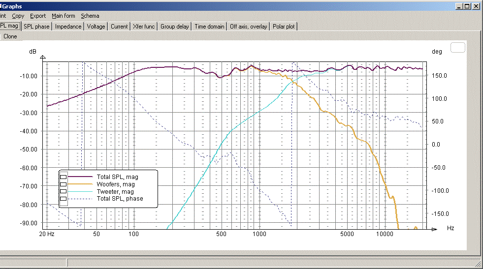

        This is not the first time something like this has happened to me. This is the graph of an RS125 / RS28a MTM I built. It also has that weird dip, although higher up in frequency.
        Now I'm really wondering what I'm doing wrong, so as not to do it again!

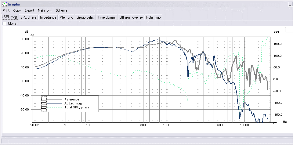

          Is that a spliced FR of the woofer with nearfield and farfield data? If so you need to add delay to the phase and baffle step to the nearfield portion of the response. Looks like you are not aligning them properly. I can tell because of the knee in the phase where you would likely splice the 2 responses.
          • fjhuerta
            • 1140
            Hi Jed!
            Yes, I didn't align the phase on the spliced FR. Reason being, I first tried to understand where the dip was coming from.

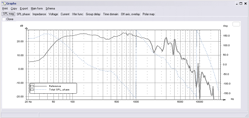

            Here's the nearfield measurement, with the dip clearly visible.
            At this point I'm suspicious of the box dimensions. What I'd love to understand is - why? In order to avoid it next time!

              We'll know better when you do a nearfield of the woofer free air. Then, do another of a woofer you know does not have the dip in the response.

                    I'm betting that is just the normal response of the Audax. Those aerogels have a dip just before the cone breakup-which is very low. After using an inductor for BSC that's exactly how I would expect the response to look.

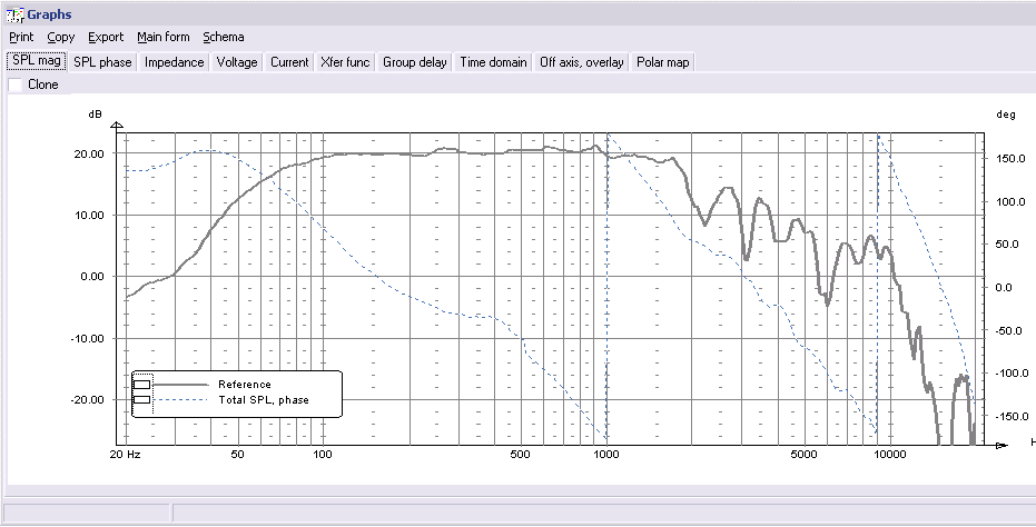

                      I don't think it's my measurement system. I had my mic calibrated, and this is a NF plot of a Seas P21 I took in-box a couple of months ago.
                      Nice. I love SEAS! :T
                      Brandon, it's possible you are right. I know the Audax aren't the most precise of all drivers. But I'll know for sure tonight.
                      They sure do nice, though. I'll post pictures of the cabinets tomorrow.

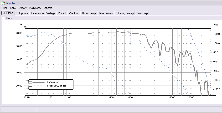

                              I took the driver out of the box, and...
                              There's that dip. The original one is a bit higher up in frequency, and it's a bit more noticeable.
                              The grey line is a damaged Dayton RS180 (slight dent on the cone), which performs flawlessly.
                              What do you think? IMHO, the problem is not the box... it's the driver!
