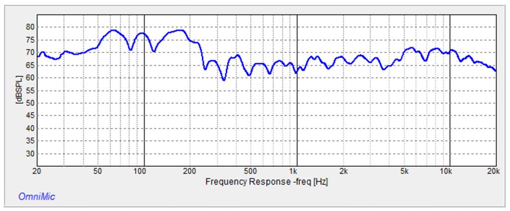

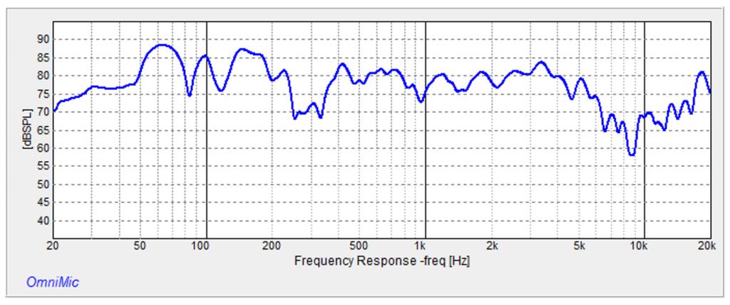

    I do not believe so, though perhaps I'll crack them open this weekend to check. I suspect that since the Singularities are placed slightly in front of the Ardents we may be getting a few negative interactions. I need to move them anyway, so maybe I'll do that today and see how that changes things.
    Edit:
    Alright, I moved them and took some new sweeps. Output was a little lower this time as I believe the Singularities were complaining about the low end at the previous level. I also played with the mic a bit and found moving it back a couple inches removed the 'suck out' around 3kHz.
    Ardents:

    Singularities:
