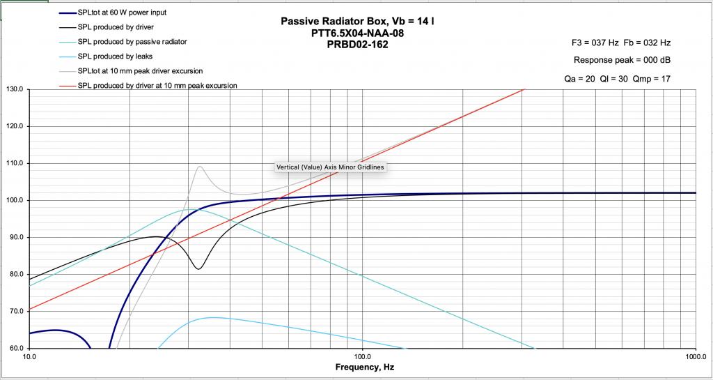

                    But, today I sent him some LF modeling data on a couple of possible Modula configurations- one called the PWB, and the other would be the PWXT. "P" stands for PuriFi, as in 6.5" long throw woofer (we've got about 8 on hand, but so much stuff going on...); W stands for "Wavecor", as in Wavecor PR223BD02 passive radiator, "B" stands for BlieSMa, as in TB25A-6 tweeter, and XT stands for XT1086 wave-guide with NSD1095 driver.
                    Picks your poisons... obviously, the TB25A is a simpler more budget friendly approach. Would be interesting to do that with a SMJ style waveguide, but it might be a while before we could get around to that. We have some very good results with RS28a tweeter, and a step up in development tools, but dammit, captain, there's still only 24 hours in a day!
                    :rofl:
                    But, to part the curtain on the thinking for the cabinet and woofer and PR, this is the POC modeling in Unibox, 14L net. One PR. (yes, I have stock...)
                    BTW, this PR is the part used in the yet to be completed and mothballed in storage Kurosawa Dai Katanna...

                    Yes, this is the PR derived from the woofers used in the Wavecor Ardent.
                    I think this could be pretty fun, reasonably priced system. Should be clean and gutsy. Of course, reasonably priced is relative. Those wanting bragging rights can update to the T25B-6 tweeter!

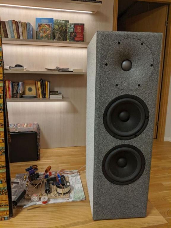

                            A new build thread with
                            Drivers:
                            2x SB acoustics MW16P-8
                            Bliesma T34B-4 tweeter.
                            Concept:
                            Midwoofers in closed box.
                            2.5way design (lower woofer helps compensate baffle step, but is rolled off before upper woofer)
                            Bliesma tweeter mated with a waveguide to optimize the off axis / power response integration with midwoofer.
                            Other design goals:
                            It is a known that these speakers will be augmented with subwoofer for frequencies below 80Hz
                            The speakers must be able to play well also at low listening levels as the "client" - ie my friend likes to listen to music tracks at lower level than an average audiophile I suppose.
                            The speakers must also handle Home Cinema scenario as that will be an equally important use case and the speakers will be used for music/movies almost equally.
                            Current progress:
                            As the furniture and placement in room is known the front panel size is also known to be 700x220mm
                            I've been printing several waveguide for the Bliesma tweeter and measuring them on this intended front panel
                            SB midwoofers are also bought and measured. One is currently also on the baffle with a 15.7L plastic pot as a "closed box"
                            The latter has allowed gathering on axis and upto 180deg off axis measurements for both drivers including the relative phase between them for estimating which WG depth and shape gives the best hope for a good xover integration
                            A teaser of a current proto stage
                            [ATTACH=CONFIG]28916[/ATTACH]..
