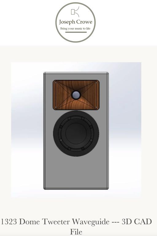

    Click image for larger version  Name:	Joseph Crowe Page.jpg Views:	1 Size:	25.1 KB ID:	872627
    An example for a completed baffle is shown, with suggested edge border round overs.

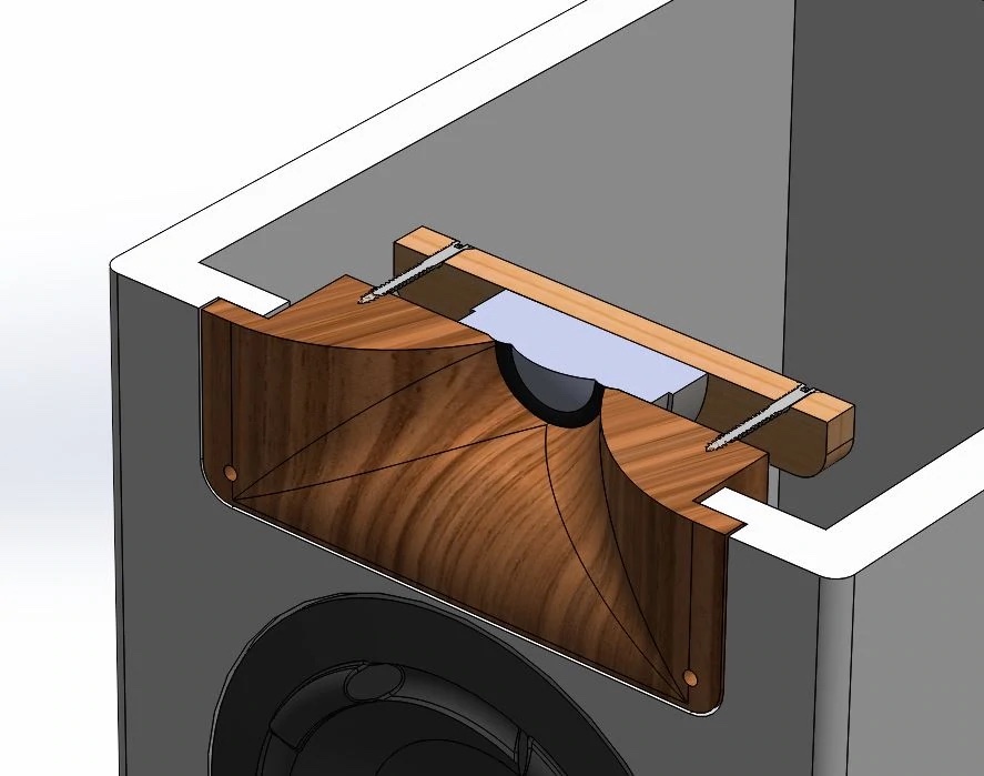

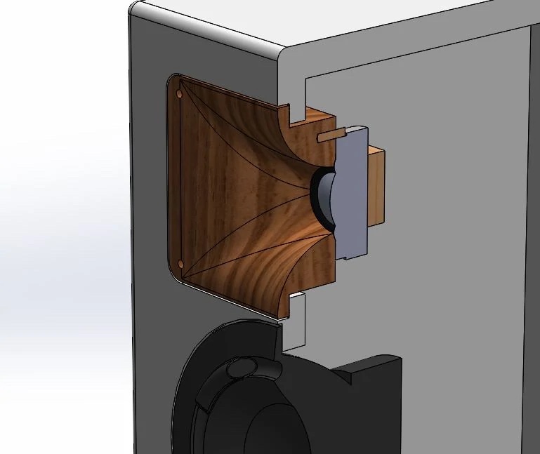

    This cutaway in the vertical shows the vertical profile...
    Click image for larger version  Name:	1323-005_51c91500-01a3-4359-9d2f-fe2e63f2125b_1296x.jpg Views:	1 Size:	56.8 KB ID:	872629

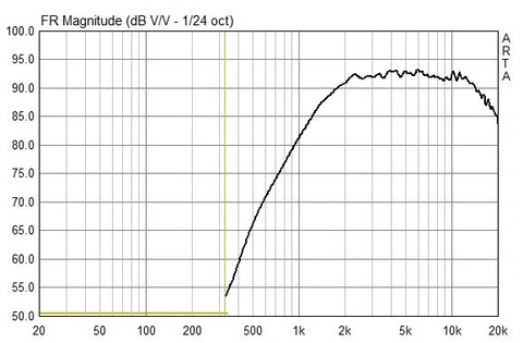

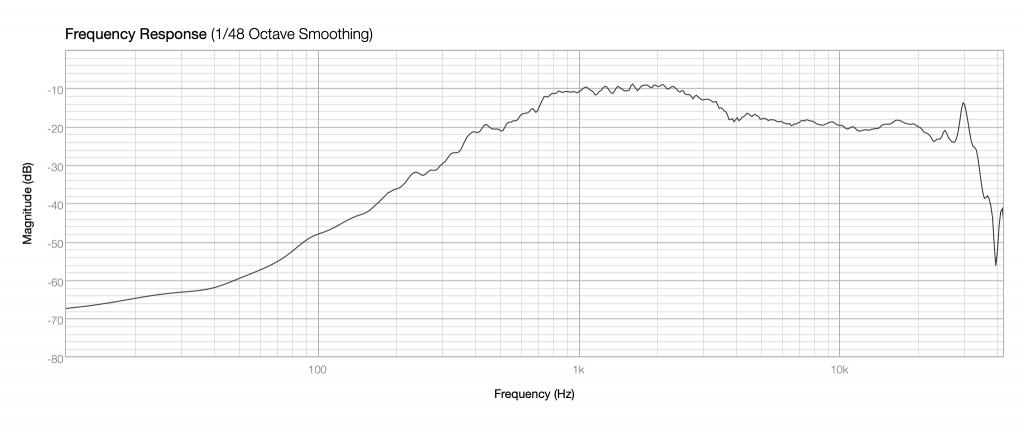

    An on axis graph of the tweeter + waveguide combination is provided:
    One thing I noticed that was curious was the relatively pronounced roll off on axis between 10kHz and 20kHz. I was curious if that was consistent in the off axis plots- Dhar's measurements indicate that it is, and gets more pronounced.
    The suggested crossover is a 4.7uF cap in series, plus an Load. This compensates for the waveguide rise in output, and then relies on the waveguide roll off and the tweeter fall off, with just 6 dB per octave attenuation of the electrical input. But this attention starts fairly high up for this nominal 4 ohm tweeter, which is actually closer to 3 ohms in working impedance.

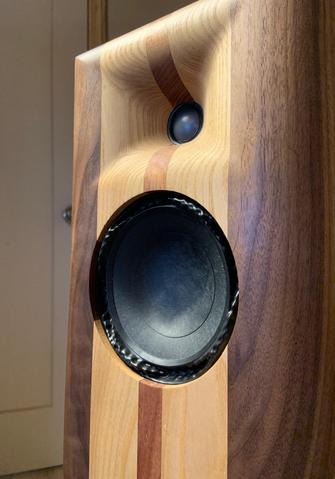

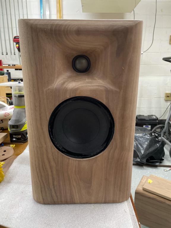

      Here's a shot of the front panel that Dhar's friend had made up, on the cabinets which Dhar built for him.
Name:	Baffle up close.jpg
      Dhar chose a 2kHz crossover point, and given that the Z axis origins were nearly identical for the wooer and the tweeter with waveguide, he selected a 4th order LR target, as this would also provide more electrical power protection for the tweeter and increase the SPL capability compared with the "crossover" suggested by Joseph Crowe.

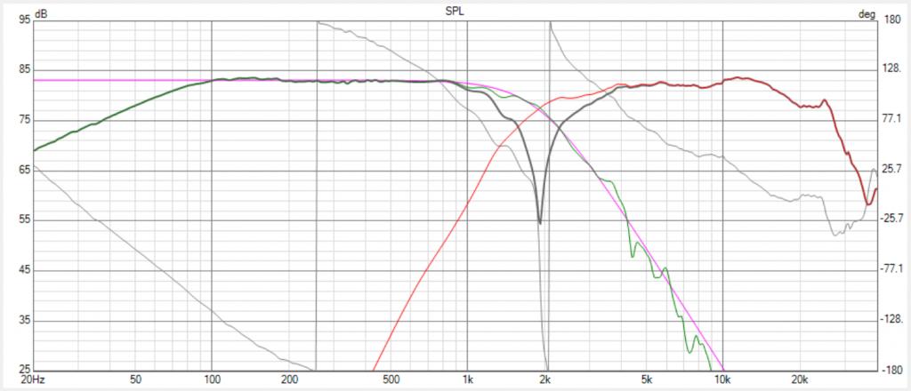

      Dhar measured data for the PuriFi woofer and the SB Be tweeter out to 60 degrees, and modeled this in VituixCAD V2.
      This is the resulting calculated on axis SPL response...
Name:	SPL Parts on Hand.jpg

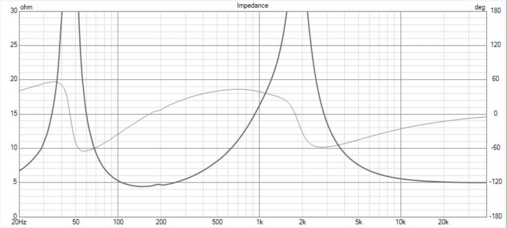

      Which looks like a fairly good first pass, and which exhibited a deep reverse null.
      As is common for this crossover design approach (think Zaph waveguide two way; think Modula MT XE), without a LCR input impedance Zobel network, the impedance swings and current phase swings are substantial.
Name:	Impedance parts on hand.jpg

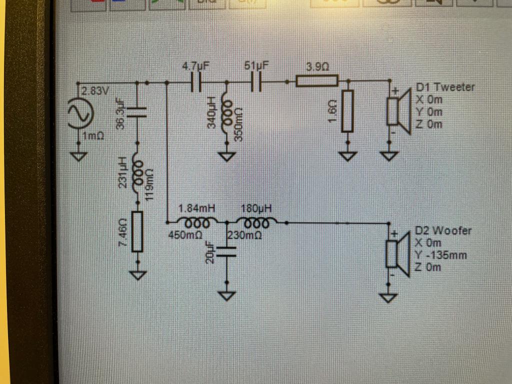

        Dhar updated his crossover with an input impedance LCR network, and this improved matters substantially.
Name:	Dhar Crossover with LCR.jpg

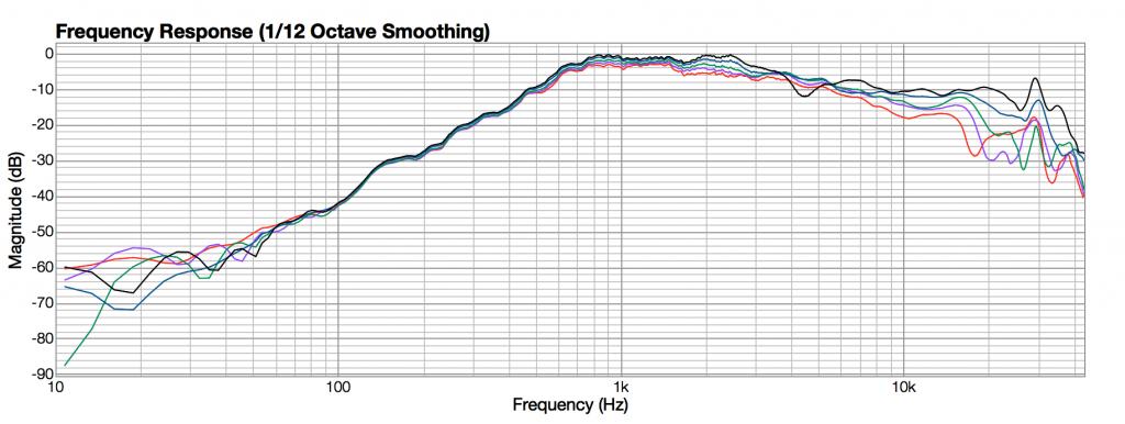

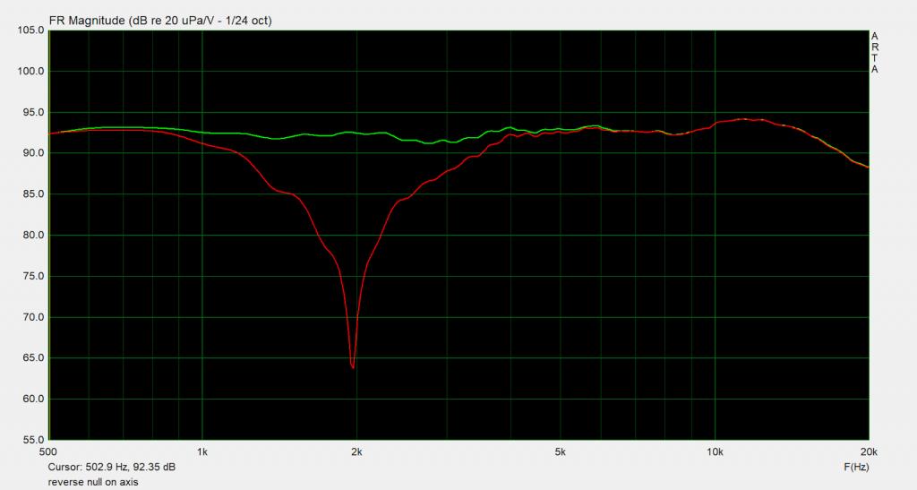

        Also from Dhar's initial measurements, the SPL with normal and inverted connection:

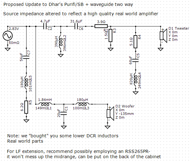

          Given some similarities between this project and one I have been working on when possible during the last two year's tumult, the "Darth Modula", it could well be that I have some useful suggestions to offer on Dhar's behalf. Do not doubt that I understand the meaning of a "perfectionist" crossover approach, even for a smaller project like this one...
          So, in consideration of these issues, I offer this crossover proposal for consideration...
Name:	Crossover 2 - Tweeter LCRMod3 XO-schema-1.png
          A few comments are in order...
          • Given the mandate to produce a high accuracy "perfectionist" design, is it most desirable that the modeling be conducted as accurately as possible within the capabilities of VituixCAD; for this reason, the source output impedance has been adjusted from the default 1mOHm to a value representative of high performance solid state amplifiers such as the Cambridge Audio Edge W, or the NAD M33. Note that many so called cosmetic pretenders to that role may have much higher output impedance- it is not uncommon to see values such as 0.2 or 0.5 ohms output impedance for some products.
          • Given the substantial impedance rise due to Fs of the tweeter, and the potential impact on roll off behaivor, it is suggested to employ an LCR zobel network to neutralize the impedance bump. Many might consider this unecessary, but this is the perfectionist approach...
          • The "on hand" inductors for the trial woofer crossover are possessed of unacceptably high DCR, in consideration of the woofer load being a 4 ohm driver of low sensitivity. The inductor models have been updated to reflect high performance parts available from typical vendors such as Parts Express.
          • As this is targeted as an acoustic LR4 crossover, it should be remembered that one weakness of that alignment is the narrow vertical lobe and the reduced room power response that results in the crossover region. Even the LR4's creators often recommend a slight bump in the crossover region in order to strike a balanced between direct sound and the room power response... this is implemented through the network adjustments.
          • The tweeter crossover has been slightly rebalanced, as part of achieving the desired acoustic transfer function, and it was proven feasible to reduce the value of C6. Be thankful that there is at least one cost saving result in this perfectionist proposal...
          • The input impedance LCR zobel is reworked, to bring it closer to true perfectionist performance levels.

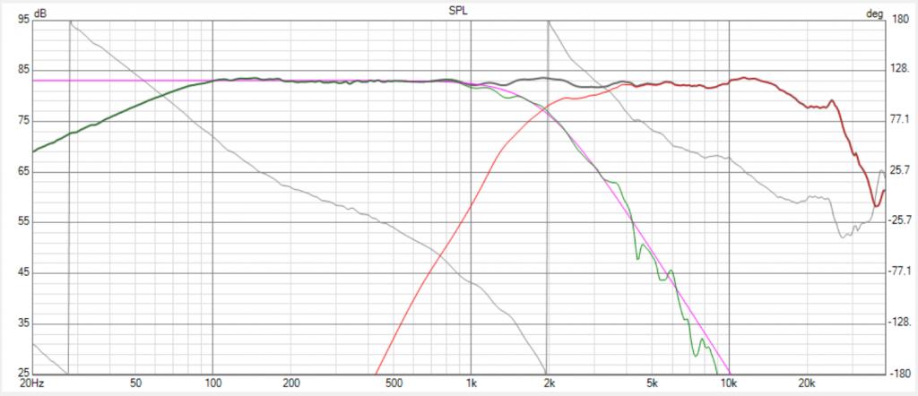

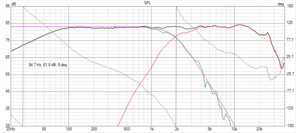

          Let us now examine the basic results of these proposed updates...
Name:	CaptureDhar Proposal SPL.jpg
          I believe you may find this result most satisfactory, considering the limitations of the tweeter and waveguide interface.
Name:	CaptureDhar Proposal-ReversePhase SPL.jpg
          Examination of reverse phase connection confirms the expected deep phase null with consistent crossover phase tracking.

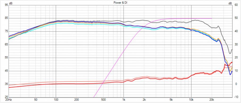

            First, the room Power and Directivity index:
Name:	CaptureDhar Proposal Power-DI.jpg

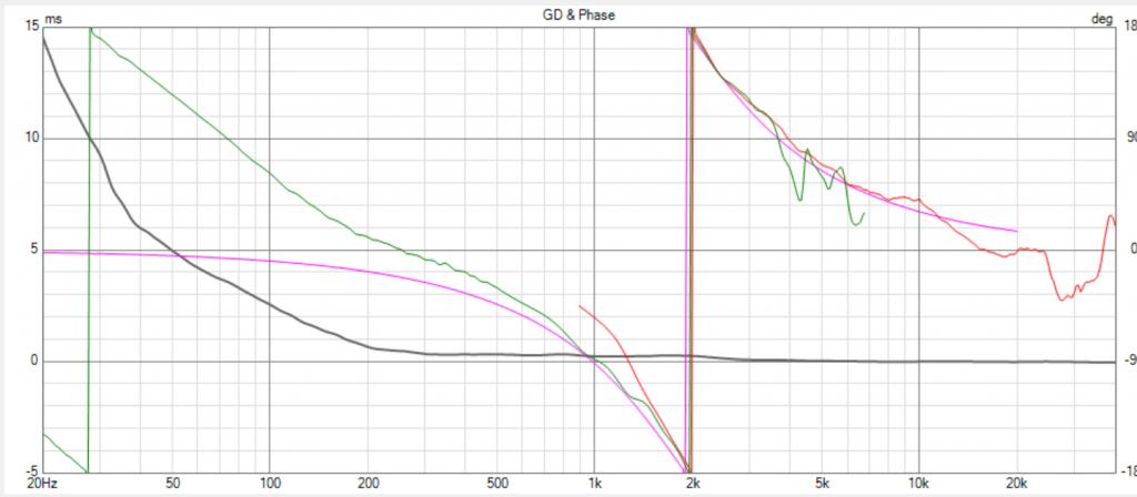

            Next, review the group delay and phase response:
Name:	CaptureDhar Proposal GD & Phase.jpg

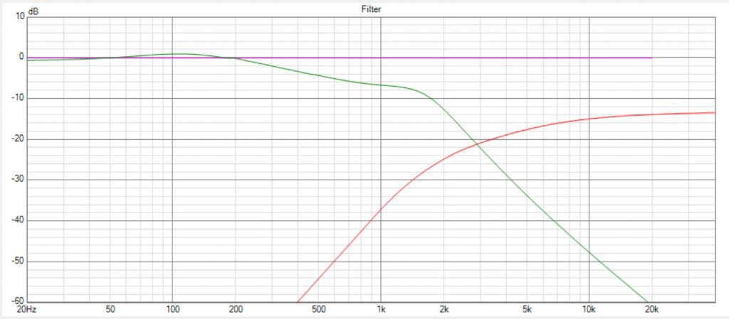

            The actual filter functions as implemented:
Name:	CaptureDhar Proposal Filter.jpg

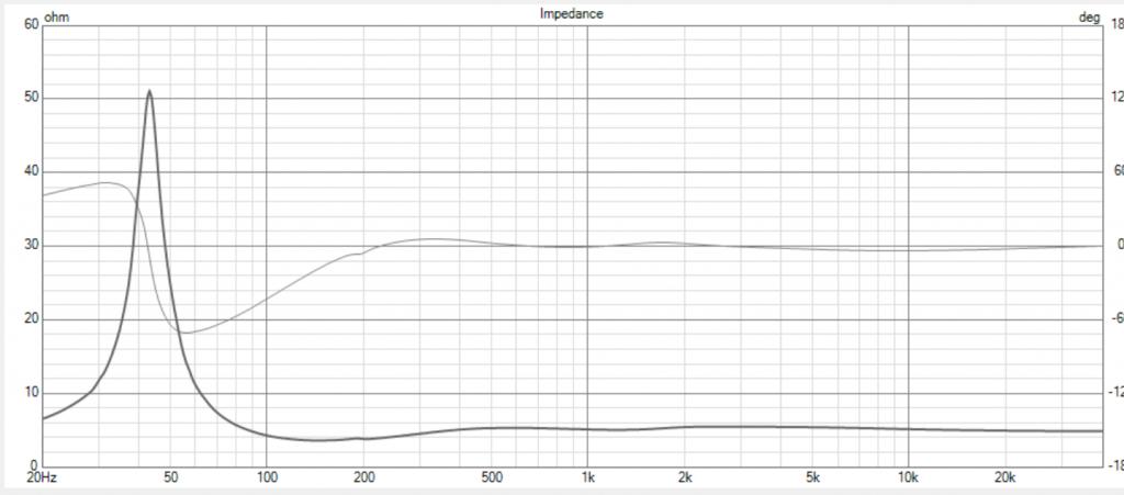

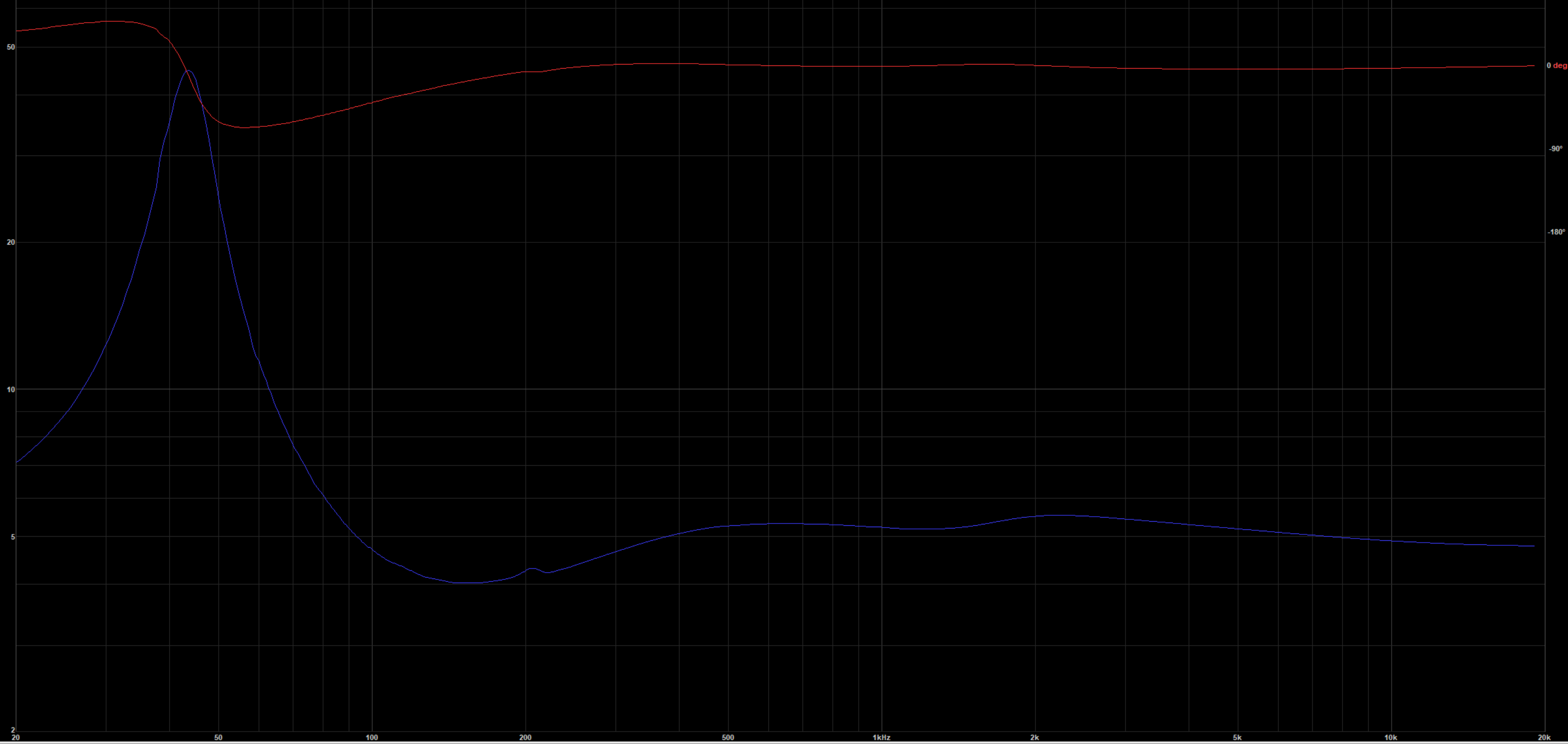

            And the calculated input impedance:
Name:	CaptureDhar Proposal Impedance.jpg
            I believe we can all agree that at the least, the flatness of impedance magnitude and current phase constitutes perfectionist levels of performance. This must await verification through construction of a test crossover, of course.

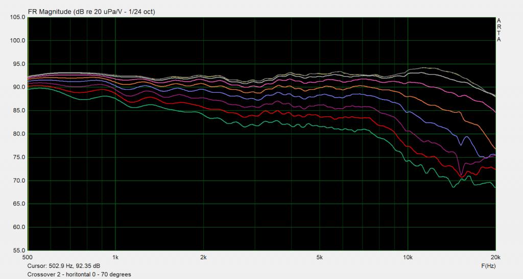

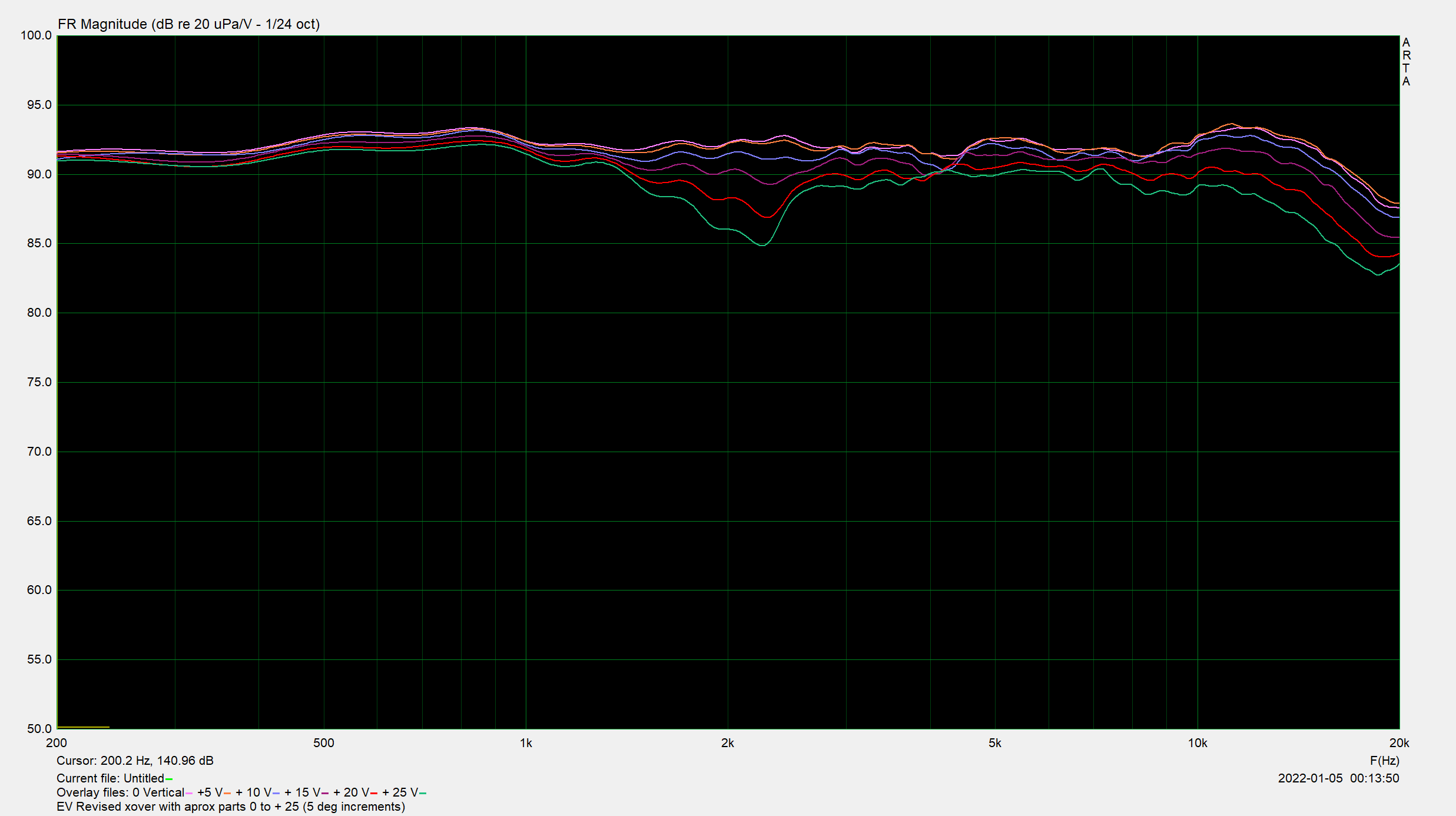

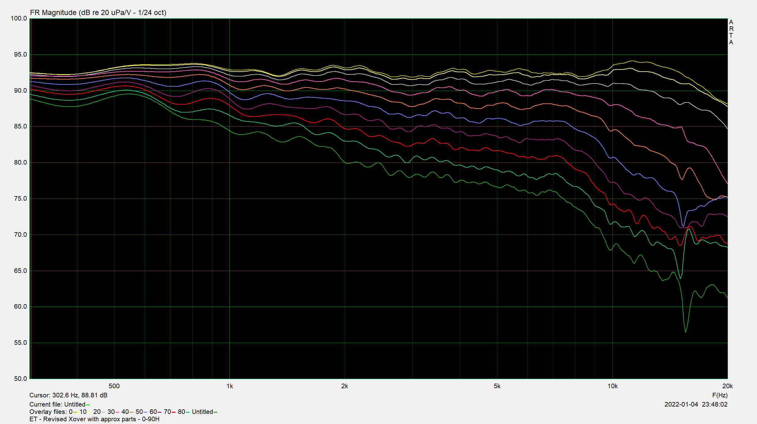

                  Here are the horizontal polar measurements (0 - 90) with the revised xover. I didn't have exact parts, but these are very close (still high DCRs on woofer inductors).
                  These measurements were taken at low volume (late night)- about 1M distance. Gate time of 3.5ms. (click to enlarge)

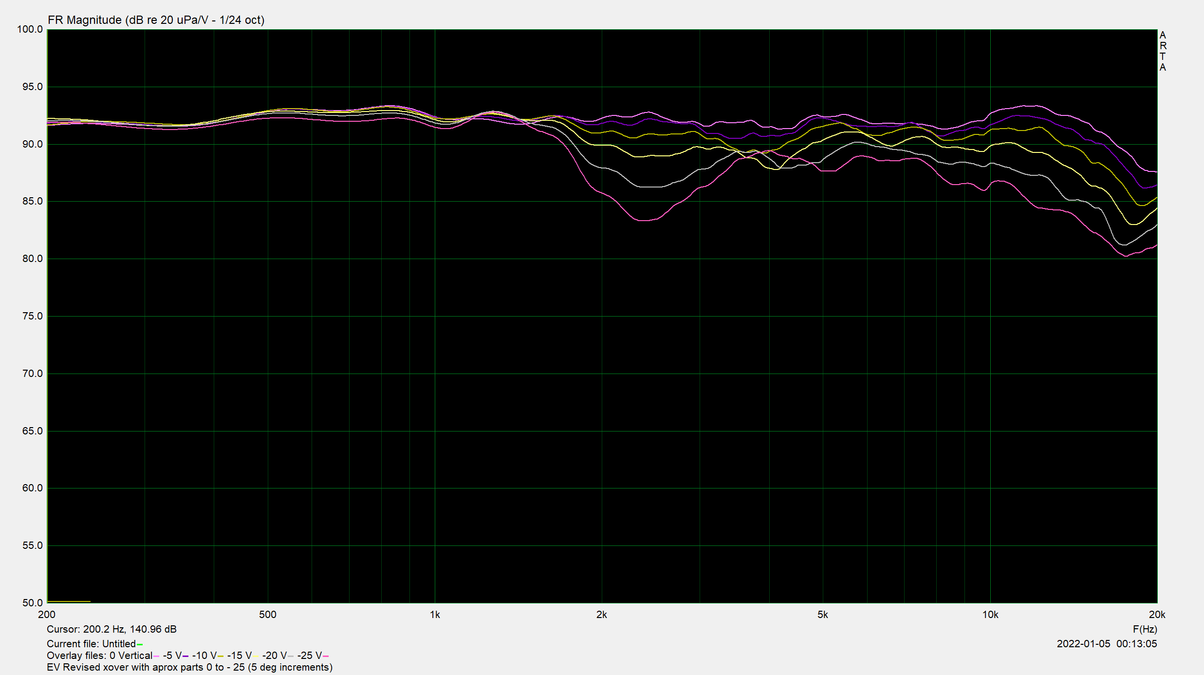

                  Also - some vertical polars +/-25 degrees (increments of 5 degrees). There might be some be artifacts included as a result of my turntable (with the tweeter now closer to rotational surface)

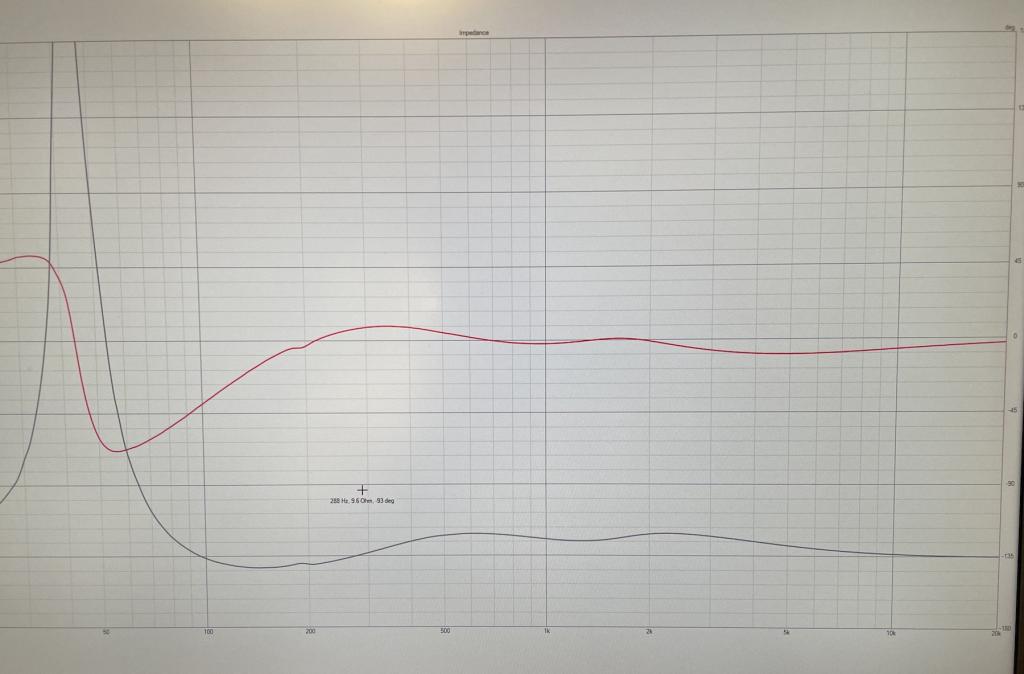

                    It would be interesting to see an impedance plot, if that is possible.
                    • Efalegalo
                      • Jan 2007
                      • 162
                      Sure - but again - I didn't have exact values (only close). Impedance is mostly 5.2/5.3 ohms (lowest is 4ohm at 150hz, -18 phase angle). I think the bump in the impedance at 200hz is likely due to a lack of sufficient stuffing, or possibly an air leak. These speakers aren't currently all the way put together (e.g., woofer is held down currently with only two screws, real removable panel is currently secured with only 4 screws, etc.)

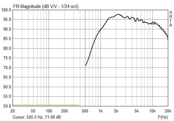

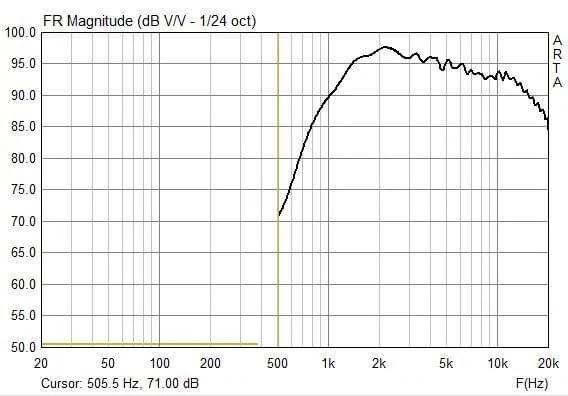

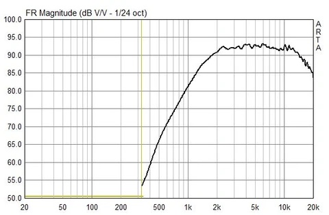

                          Mmmm, I'm not sure I understand exactly what you mean, but that steep fall off between 10kHz and 20kHz is NOT a result of the more effective dome tweeter waveguide builds I've worked with.
                          One example, the Module MT XE with the SS Discovery tweeter:
                          Another example, a waveguide (CNC milled from layered MDF) that Steve Manning and I developed, with the Dayton RSe28a tweeter on axis:
                          Click image for larger version  Name:	RS28a Original.jpg Views:	2 Size:	56.0 KB ID:	866479
                          And a polar set:
                          Click image for larger version  Name:	RS28a Polar Combo.jpg Views:	2 Size:	74.7 KB ID:	866480
                          I'm not saying that this is the be all and end all of dome tweeter waveguides, but the difference between that and the Joseph Crowe part is substantial.
