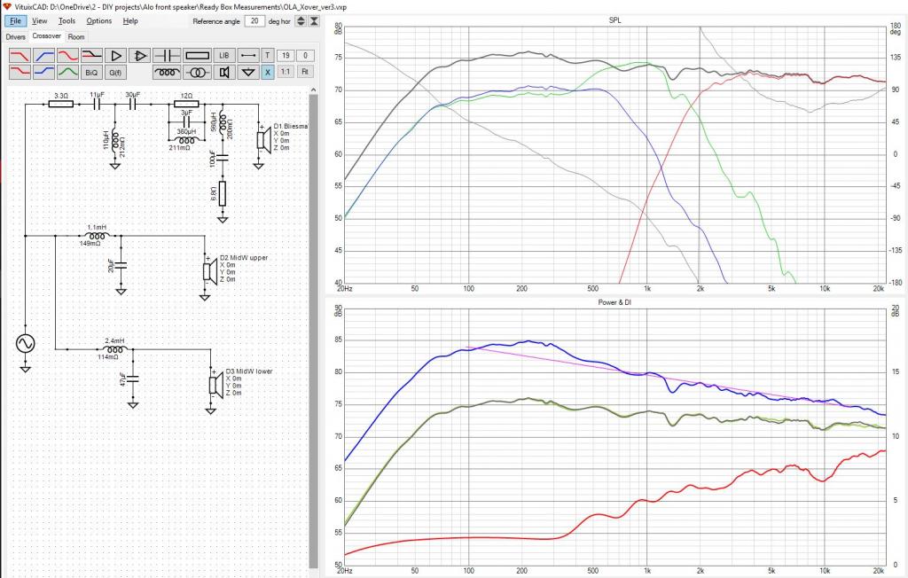

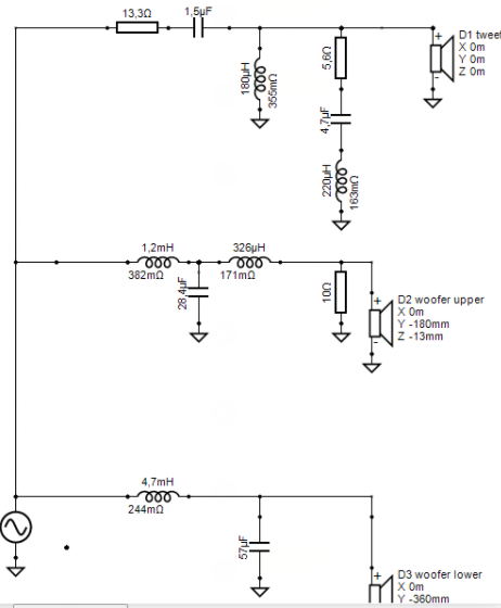

    I'll generally do the xover desing of 2way or 2.5way in this case so that the microphone stays at 1m on tweeter axis for all measurements. So the distance/phase difference of the mid is already accounted for and I do not need to change the coordinates.
    I did not have time today, but I might try to create calculated minimum phase copies of the measurements and then try with adding the coordinates too. I always do also a measurement with drivers in parallel, so I would have a reference to adjust to for the Z coordinate.

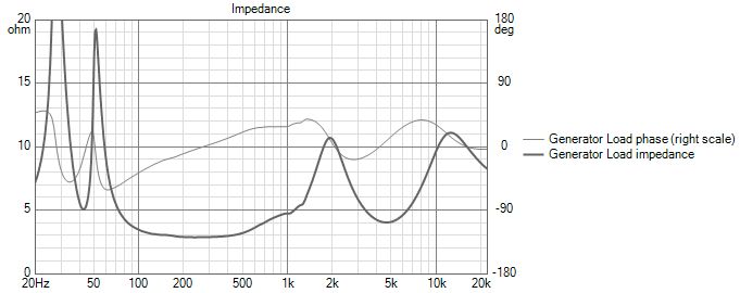

    Impedance is a bit more challenging than I'd like touching the 3ohm in lower mids . Maybe tunable still... My friend is leaning towards going to class-D amps as well (Hypes or ICEpower) from NAKSA. Hes been listening to mine and likes both and for class-D amps the 3 ohm would be fine.

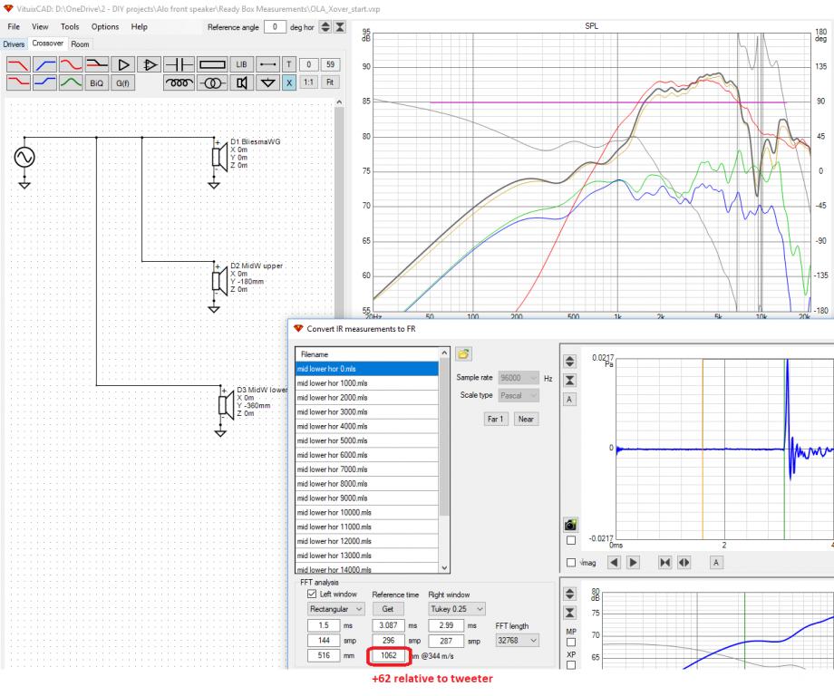

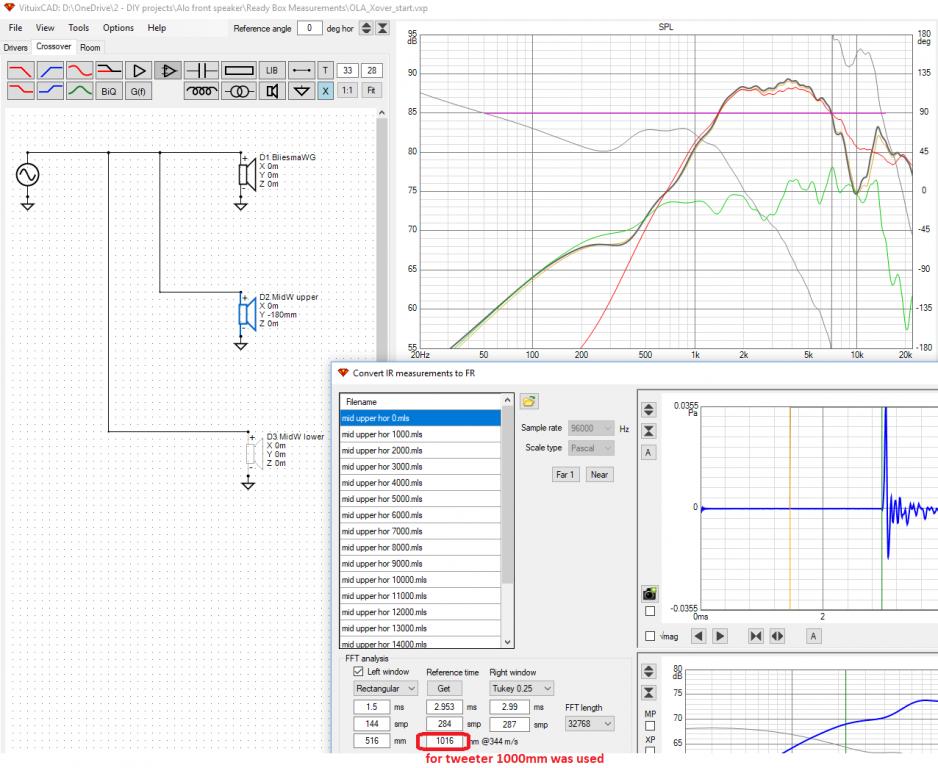

                  Best place to add delay correction for M and W is Reference time in Convert IR to FR. That would eliminate extra data loss because time window is shifted forward before FFT.

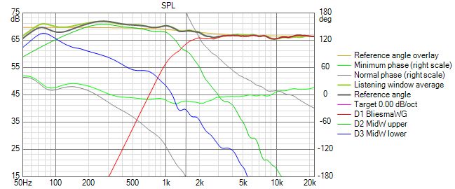

                        • 698

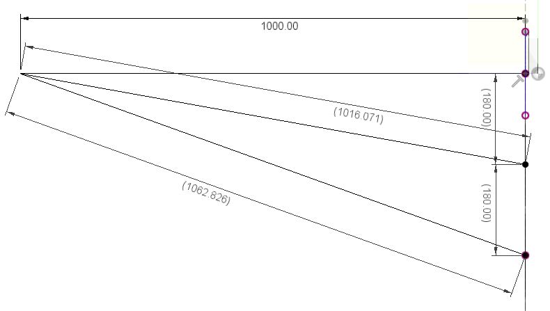

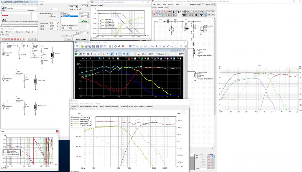

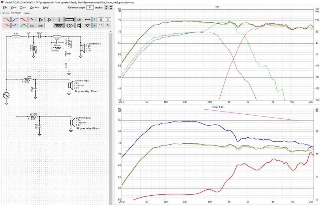

                        First off - the new analysis of prior data
                        * Mic always at tweeter height for all drive units
                        * The layout measurement used as guideline for adding reference delay to the measured IR
                        16mm added for upper midwoofer - orange curve is the reference curve of tweeter and upper midwoofer measured in parallel. There is a good match
                        62mm added to lower midwoofer- orange curve is the reference curve of tweeter , upper midwoofer and lower measured in parallel. There is a again a good matchmidwoofer
                        This is the prior simulation where all drivers had 0,0,0 coordinates
                        And this is the result where Xover values have no been touched, just the FRD data is re-imported with the above extra reference time added and the driver co-ordinates correct in Y axis...
                        There is a clear difference. I need to get the emulation working in LspCAD to verify if this new attempt is closer than the older one.

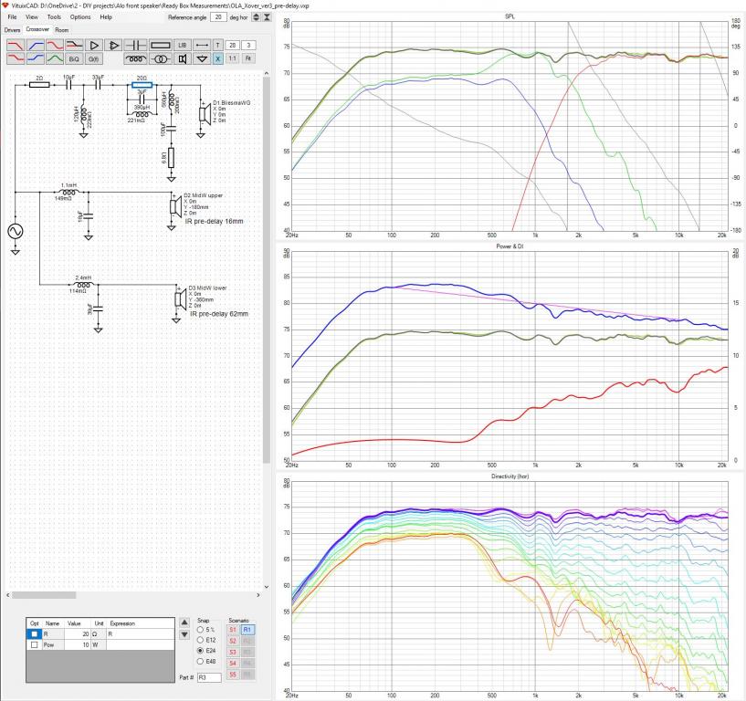

                          • 698
                          With a bit of tweaking of the Xover values the result can look good again

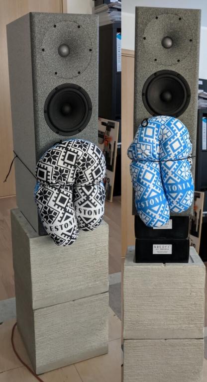

                            Tried to follow Kimmos best practice guidelines and also used a pillow this time to cover the unused midwoofer as well as shorting the leads on the unused woofer
                            The similar procedure of adding a reference time offset goes ok, but I am struggling a bit to get similarly good match with the reference measurement made with the drive units playing in parallel... It's getting late, so seems that I have to leave that part of the fun for a later date.
                                  Pillow trick is for near field only. You (should) have both woofers connected in parallel to amp. to get correct LF response with possible HH-resonator, and mic is measuring single cone; lower or upper. Pillow should block mid-range sound from the other driver so that mid-range is mostly measured from driver close to mic. Pillow should not brake movement of cone to get proper LF result. This assuming that woofers have shared box volume.
                                  Main frequency range of far field measurement is above 300 Hz so there should not be extra reflecting objects close to DUT. Soft pillow is not bad but not mandatory either. Blind flange in place of lower woofer while far field measurement is one option to prevent passive radiator effects and get some - hopefully decent directivity information below merging frequency.

                                    In your case, exit angle from upper woofer to mic at 1 m is atan(180/1000)=10.2 deg ver. You have measurement to hor 10 deg which is selected and mirrored to ver by the program. That small difference is okay for sure. Exit angle of lower woofer is atan(360/1000)=19.8 deg ver. You have measurement to hor 20 deg which is also really okay. But some other cases angle difference could be half of angle step e.g. 5 deg, so difference to parallel measurement will be self evident at frequency range where radiating surface of one (or both) DUT is very directive. But that range is usually irrelevant in practice because XO usually has (~should have) low-pass filter where radiator is so directive that response changes radically within 5 deg off-axis difference to angle <30deg. This is the reason why I would never compare to parallel measurement as long as measurement gear capable to capture sound flying time is available. I've had either dual channel gear or CLIO since 2k so parallel verification is something I have not done for speaker design. I've just tested difference between acoustic centers with some coaxial and noticed that method is totally useless without adequate response overlapping.

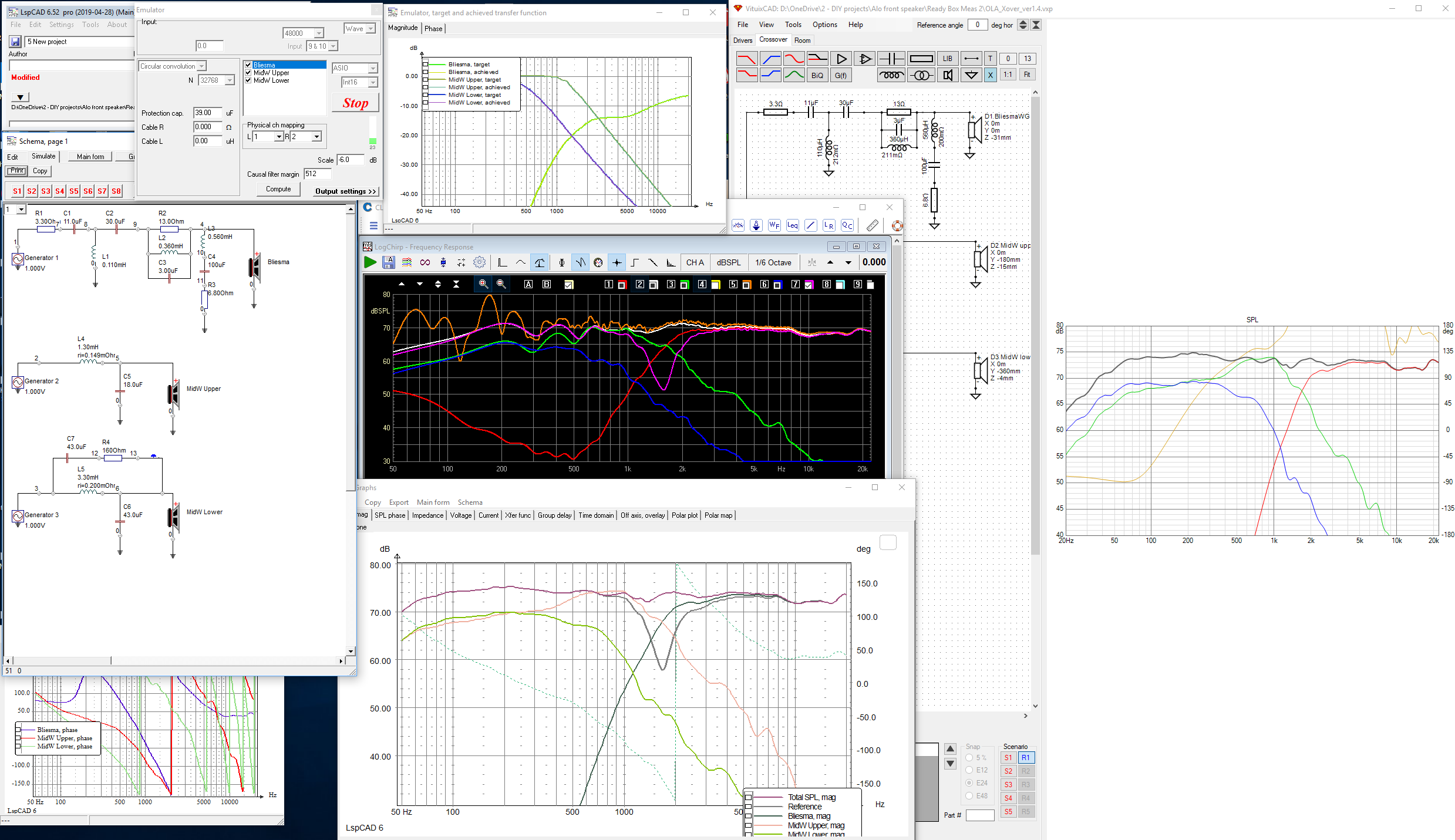

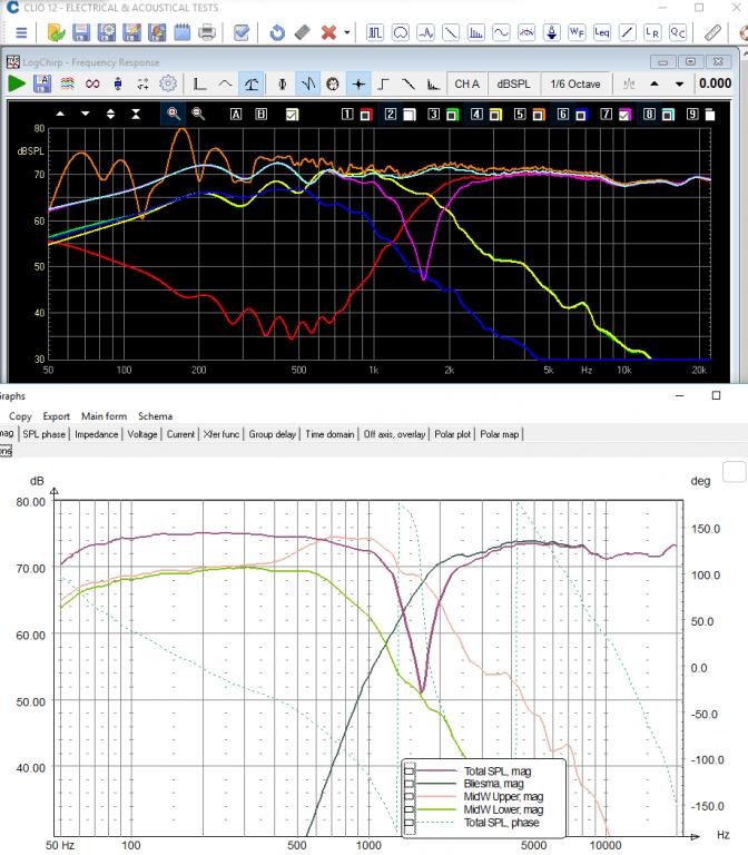

                                                  • 698
ID:	864340 Lets see if this works.
                                                  What I've done is to take the first version of measurements where Mic was always at tweeter height. Then the respective delays were added in VituixCAD IR -> FRD tool and project created (same as the above sample)
                                                  Next I replicated same Xover with same 0deg measurement data in LspCAD and asked it to emulate the crossover.
                                                  The CLIO SPDIF out is then routed to RME UCX soundcard -> LspCAD Xover Emulation --> RME 6 channel analog out --> 6 channel Hypec amp --> Each drive unit in separate channel (only one speaker connected)
                                                  And then the measurements run in normal fashion.... A pretty good correlation of measured versus simulated.
                                                  I'll try the same exercise now for the version where I measured each driver on it's own axis.
                                                  PS. Note that VituixCAD range is 40dB, while other two are 50dB. VituixCAD has only 40 or 60 option but then CLIO does not use 5dB per division and it makes graph harder to read
                                                  Last edited by theSven; 07 April 2023, 15:16 Friday. Reason: Update image location

                                                        • 698
                                                        This is the same exercise but the measurement result files are for each drive unit measured at it's own axis. For purely on axis response tuning both methods give a close match with simulation. But as Kimmo explains the difference could come out in offaxis / power response and directivity.
                                                        I'm afraid the time is running out for today, but having the system working now for emulation I'll attempt to do a comparison on 0..180 deg in 10deg steps and then calculate the power response for each method.
Name:	y4mLabx8bDPG68Rb4t7ufhg6GJq4ArZxYnys0JPY33R3VGgE-cL98enlxhLNIuKqfggKvGYH5mo_oy0AcjjWe-Jkioqd8ig639_MkB0zVIg86uzl_goghkx3YWE6NilKV4I8zoDaMalY-Yo3yWMB0BXRMi63mdwLEyicY77pq0KC0_rp95DJDolgf_ixpmndTYFRfz95ZtwyyWmYpWJ112gHQ?width=2478&amp;height=1431&amp;cropmo

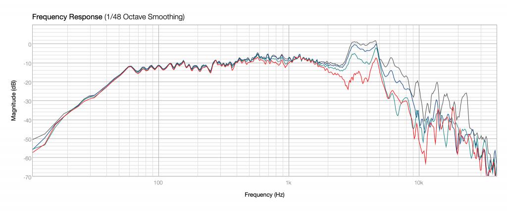

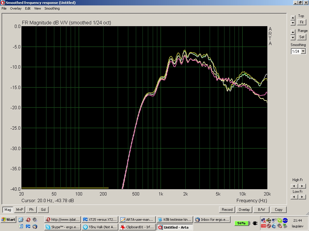

                                                              Ergo, whenever you have time: could you please post the tweeter response without the two EQ notches. Curious to see where and what are you EQ-ing.
                                                              Have a combination tweeter (not Bliesma!) with Visaton WG on a similar width baffle, and the response behaves (wavy peaks and dips) so I have to use two EQ notches (three even...). The rough original prototype baffle was almost 35 cm wide and the FR was very smooth, no dips.peaks, just the expected low-range boost (but looked ugly - the box I mean - so had to redesign). Couldn't believe the difference when the new family council approved slim-front enclosures were built (and finished, painted). Lesson learnt.
                                                                • 698
                                                                With notches
                                                                No notches

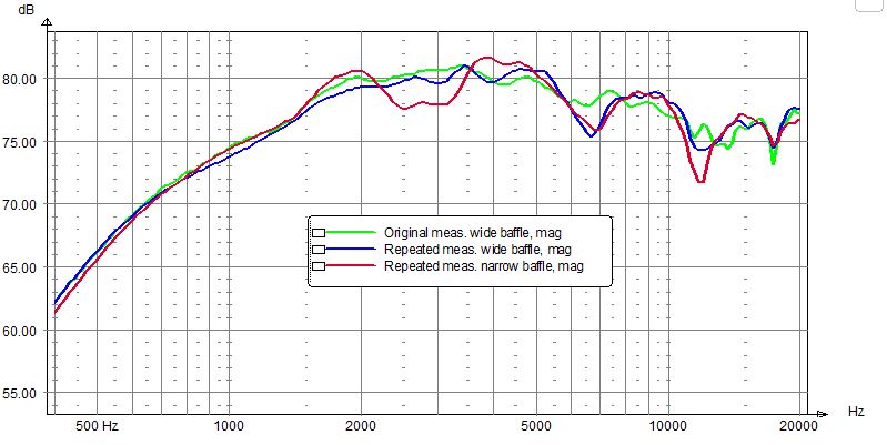

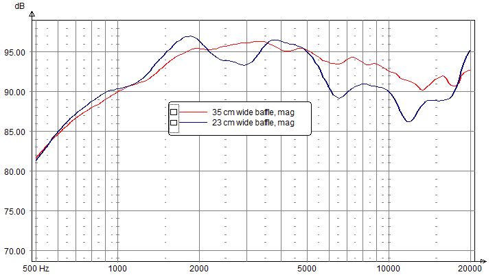

                                                                • draki
                                                                  • Oct 2012
                                                                  • 40

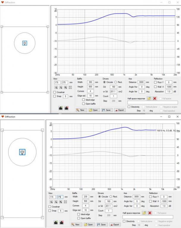

                                                                  Sorry if this is diverging OT, I will stop with this.
                                                                  Here is the same tweeter+WG on a wide (35 cm) and narrow (23 cm) baffle.
                                                                    • 698
                                                                    draki - are you sure you did not have some other measurement issue causing a bad test result?
                                                                    I assume the WG was equal distance from top edge in both tests and the WG was mounted in center horizontally in both cases?
                                                                    It's not quite correct to analyze the WG on baffle with the VituixCAD but it should give general idea what type of difference is to be expected. And the difference does not look nowhere as extreme as you see in your measurement. So that is why I'm asking how sure you are about the source data.
                                                                    • kimmosto
                                                                      • 723
                                                                      It's certain that baffle cannot cause that much difference. Should be quite close to equal. Something is wrong with measurement or driver itself or mechanical connection to WG.
                                                                      • Zvu
                                                                        • Oct 2013
                                                                        • 436
                                                                        Dip at 6,5kHz and at 13kHz. Something happens at much shorter wavelength than baffle width.

                                                                            • 16175
                                                                            I would be reluctant to trust this without a thorough controlled evaluation. Particularly, comparative data makes sense if it's the same exact waveguide and tweeter measured on each baffle, and the driver/waveguide combo is verified not to have any other issues, say, making impedance tests to confirm integrity.
                                                                            I had issues with my first set of BlieSMa tweeters, they had to be returned.
                                                                            OTOH, I've measured a variety of tweeters on Visaton waveguides, and mostly on somewhat narrow baffles (8-12" wide, but with full 3/4" roundover).
                                                                            The issues you're seeing in this measurement above 5kHz have almost always (in my experience) been due to the tweeter design and construction and interface to the WG throat. Little to no impact from external baffle. Below 3 kHz, it's another story. Someday I'd like to do some detailed studies to understand this better. In the meantime, though, we just try to focus on finding combo's that work well.
                                                                            • draki
                                                                              • Oct 2012
                                                                              • 40
                                                                              Ergo and all, sorry for highjacking the thread.

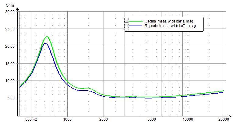

                                                                              I did manage to find the original box on a first try, and have mounted the tweeter+WG and remeasured. The tweeter, btw, is a SEAS NoFerro650 on Visaton R146 WG. The mechanical fit between the two is pretty straightforward and solid, and looks gapless. Similar combo at HeissmanAcoustics.de (but the driver is SEAS NoFerro 950, very similar). The drivers were not tampered with, dropped or otherwise misused.
                                                                              While at it, might as well say that the BM is SB17NRCX-8, just for info. CB of 18 L. No complaints for what it is. The usual peak notched down. XO at 1700 LR4 acoustical. But I digress..
                                                                              Attached FRs are the original measurement in green (more than 2 years ago); the same driver in the same original box measured today (blue); and in the narrow baffle box, today (red). I can't repeat the first original measurement, even though I am using the same hardware and software, and doing it in the same room/spot/distance ... But 2 years have passed so maybe I am not replicating all or I did something that I don't recall. I do remember though that I had measured very carefully, several runs, and was very satisfied since the measurement were as per book.
                                                                              The impedance today (blue) does show a little difference, it measures a little lower in the absolute value that the original measurement (green), but the Fs is pretty much spot-on.
                                                                              I am as puzzled as anybody. Not that this is a problem, rather a puzzle in a need of solving..

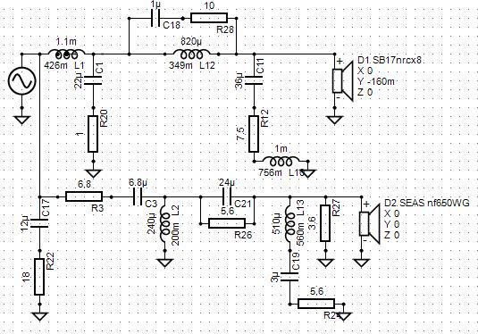

                                                                                  Here is it. Workable, IMO. Design target at 10 deg. No nearfield meas for the BM, only farfield at 90 cm. 4 us gate.
                                                                                  • draki
                                                                                    • Oct 2012
                                                                                    • 40
                                                                                    .... and the x/o schematic

                                                                                      Bit of a progress report. The physical Xover parts should arrive next week for an Xover that we have tuned some more from the last I posted. We've done few listening sessions with the LspCAD emulating the xover. The initial version did not sound quite right balance wise especially. Comparison to Minerva's in my room confirmed that. So I went 'back to drawing board' and redid the Xover. We listened to few slightly different variations and then settled on one that really seemed to 'click' for all aspects.
                                                                                      Now what is interesting is that with this speaker I did not use "Jon's voicing curve" as a design stage target, but when I did decide to put it on the version we settled on it is a very close match... so for me it's a proof again that at least for speakers with good uniform power response this is a good target that I like a lot. So thanks again to Jon for that one
                                                                                      (reference angle overlay is Jon's voicing curve)
Name:	OLA - Ver2 xover - Jons voicing curve.jpg

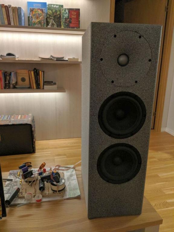

                                                                                        • 698

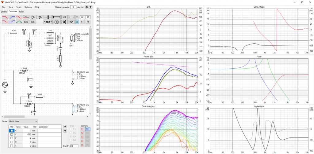

                                                                                        It's been a long time since I updated the progress on this build. There has been a lot going on actually and meanwhile I have measured and re-measured the speaker a number of times. Then we built 3 or 4 variations of the Xover while speakers were at my place. Eventually around October we moved them to their actual home at my friends place and he kept fine tuning the Xover while listening daily. Some two weeks ago he arrived to a "happy place" with the tuning. Xover is still in a 'ratnest' form but it does sound good. We are building the Purifi power amps (one for me and one for him) and then we'll see if the Xover will be made more permanent as it is.... as we do hear differences between the amps and DAC-s now with ease it is a good sign I guess. A good speaker also means there is no mercy on components upstream.
                                                                                        Right speaker in it home
                                                                                        Measurement at 1m ini his room (same position as above pic with mic 1m in front about half way between WG and upper midwoofer)
                                                                                        Xover as is currently

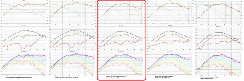

                                                                                            • 698

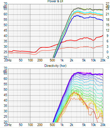

                                                                                            The one we chose in end was the 26mm deep version
                                                                                            With the shown Xover it measure like this
