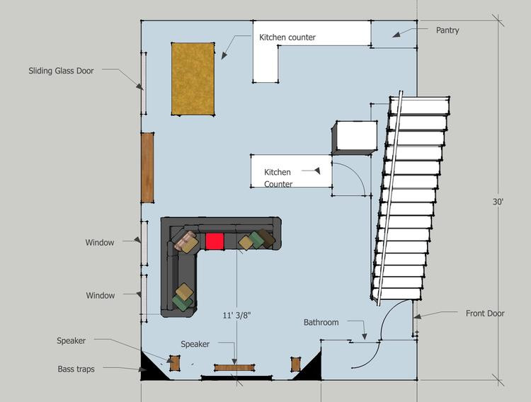

    So originally I was planning on two separate manifolds in the floor (thank goodness for crawl spaces) each loaded with (2) HT18s. But after exploring more options and doing some measures with a sub crawl, I wasn't that impressed with the responses. Additionally, the work of 2 boxes + 2 holes in the floor was exponentially harder than one. So I ended up going with one giant box housing all (4) drivers directly underneath the couch. My measurements showed it being a fairly decent natural room response with a big SPL boost due to proximity. Location in the room below (look for the red box).

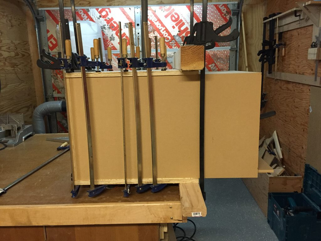

    So nothing crazy about the box design. Inner layer is the width between joists I had to work with. Outer layer is an added layer of 3/4 BB ply. These 18s barely fit that. Will post the CAD drawing soon.
    Quick glue-up shot

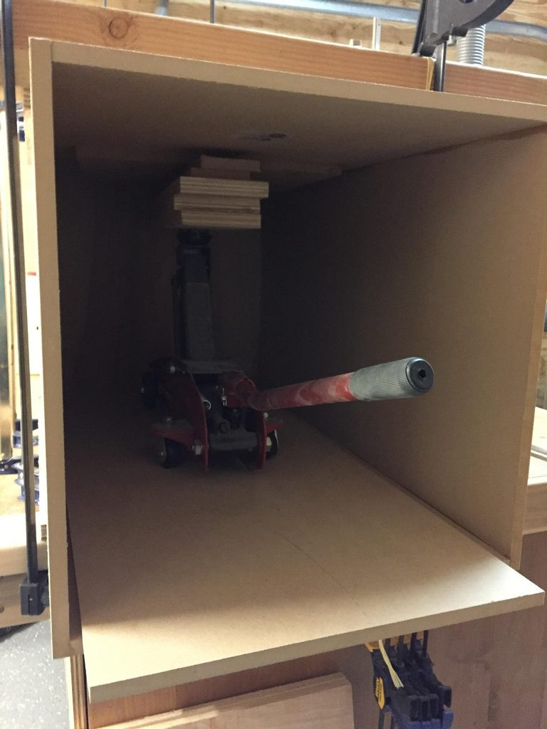

    Added support in the middle of the box during assembly - had to get creative

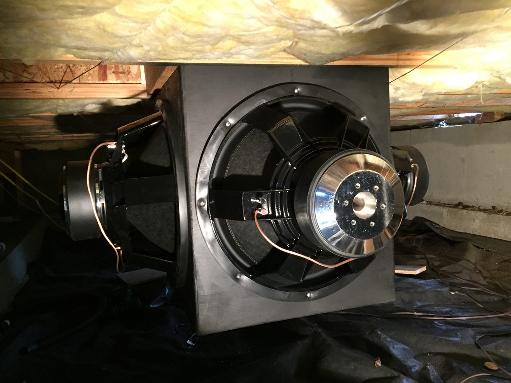

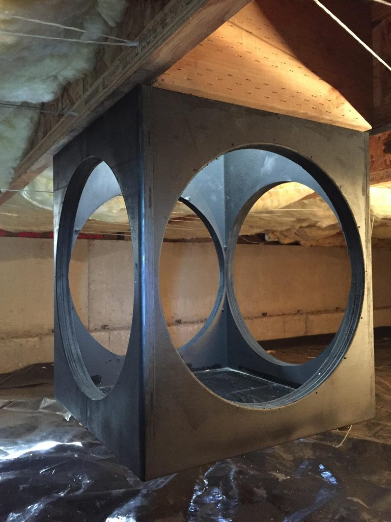

    After I routed out the holes, painted and installed (partial at this point)
    Drivers installed

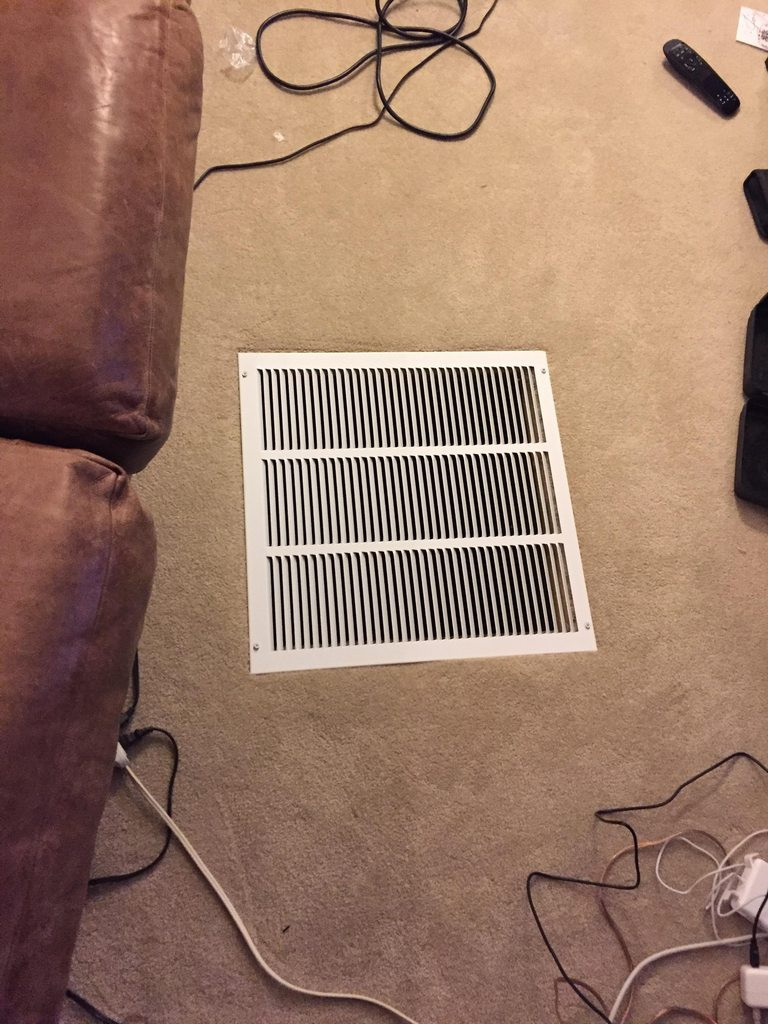

    Only a manifold in the room (directly below the couch)

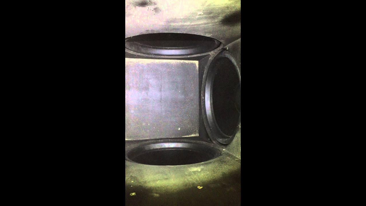

    Quick video of the intro to Edge of Tomorrow (if your PC has subs, I recommend turning them down).

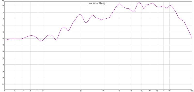

    Early measurements are in. I plan to do a full walkthrough of my EQing adventures, but I am going to post on that below. I'll come back and update accordingly.
    Here were the 3 main listening areas (each part of big couch) averaged (without any EQ).

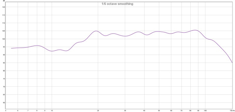

    After applying EQ to the averaged response, I was able to tame it a lot
    I played around with getting it completely flat by really EQing it, but I found this to be a nice balance. The flatter to 5hz I got it, the more I was concerned for my house. This seemed to be the best balance - stuff below 20hz is still absolutely frightening, but it doesn't break anything. At one point, I pushed the system pretty hard and it moved my couch.

        That is hilarious Kevin- your manifold is more air than anything else, and the drivers themselves have to be major structural members!
        Tell me, do you have a good idea of the hanging weight of the manifold plus drivers? (Though I'm sure the drivers must dominate... )
        It's a wonder you haven't blown your ventilation grille in the floor off yet!

            Tell me, do you have a good idea of the hanging weight of the manifold plus drivers? (Though I'm sure the drivers must dominate...)
            Quick and dirty math puts it at around 265 lbs. It's a beast for sure. The really cool part - since the drivers are all opposed, there is no box movement. When you rest your hand against the box at high excursion, it's dead. Awesome!
