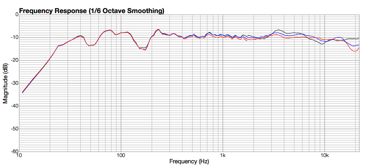

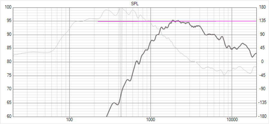

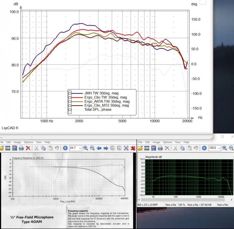

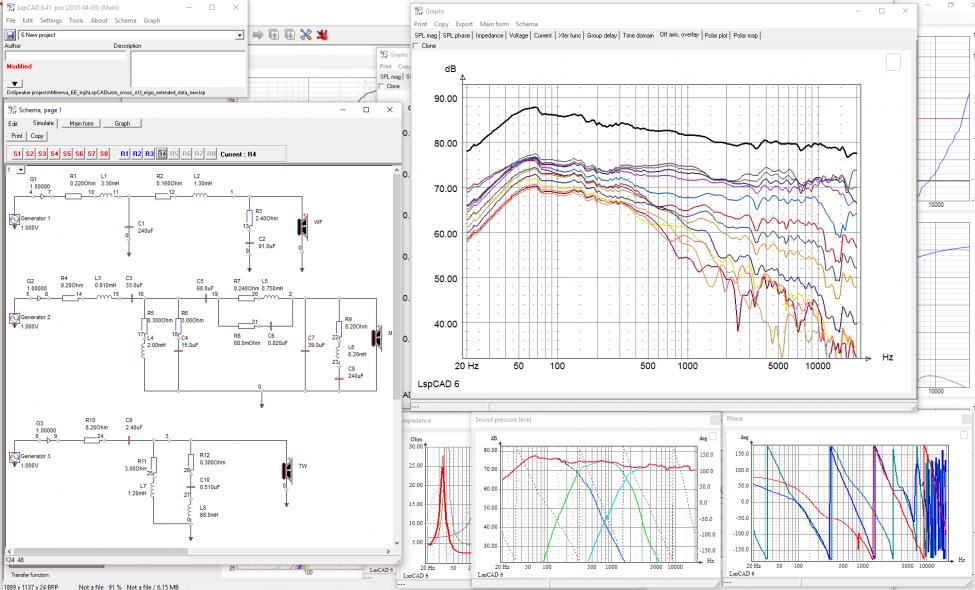

                                  Comparing SW223BD02 measurements

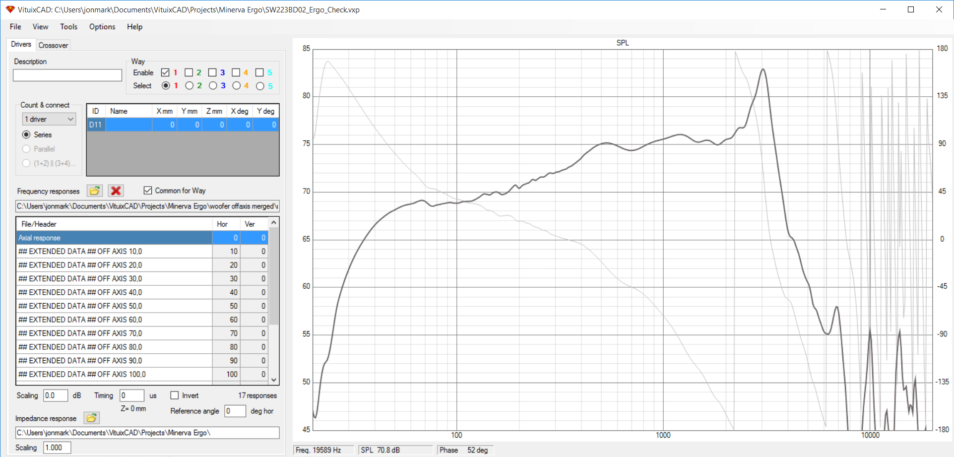

                                  OK, did some data review- I think I know where the issue is, but not knowing more about how Ergo measured and recorded results, I don't know why...
                                  This is the composite data from Ergo on his SW223BD02 measurements- a lot of measurements and data, I'm sure this took a lot of work. The curve looks "right", except that I have to question the levels recorded.
                                  This is showing the half space (i.e., infinite baffle) sensitivity in the 800-1200Hz region to be about 75-76 dB, and I just can't reconcile that number. By T/S analysis, by the Wavecor Data sheet, and by my own measurements, I think that should be in the 83 dB range. If you had a "noisy" measurement with no axis averaging, and 1/6 octave smoothing, should look kind of like this:
                                  This was measured in the test cabinet, with the PR, and you can see it contributes some substantial LF output in the sub 40 Hz area.
                                  That's about a 7-8 dB difference overall- about 10dB difference at 100Hz. OTOH, the measurements for the C18EN001 came in quite similar considering- Ergo's were very plausible in detail, and mine matched closer than usual to the Seas measurements. Same with the tweeter- no issue there.
                                  Do you use an SPL calibrator with your microphone before each measurement run? (I have one for my Acco Pacific mic)
                                  Another thing I do that helps prevent "oopsies" (yes, that's the technical term) is do all the measurements at one sitting, with the mic and test gear undisturbed. I also usually do a combined all drivers at once scan, and use that as a check against the summed drivers to ascertain the acoustic offsets, after I've extracted minimum phase data from the driver measurements.
                                  Otherwise, maybe there's something wrong with your SW223BD02? was this a sealed box measurement? (don't see the effect of PR output- did you stuff the box? Should only line the LF part of the cabinet).

                                    #467
                                    Originally posted by ergo
                                    I used a lab microphone thats good to 40k, so I also wanted to get the SPL right as I do have the calibrator.... Now getting ARTA to get right levels was a bit of hassle. If one does the microphone calibration, then for example the SPLmeter sub module starts to show correct level right away. The 2 channel IR measurements is different though. In end I had to calibrate both left and right input and then also the microphone SPL -> mV before I got all working.
                                    Anyhow. Below are the setup pics + the initial gated measurements entered to VituixCAD. I'll need to follow the process of merging those with the near field measurements and baffle simulation to get it correct in lows also.
                                    Indeed the most strange thing, now that you mention it, is the absence of the PR effect suggesting something is not right. :scratchhead:
                                    About the SPL level, there are so many things that can go wrong that I'm not too surprised. Could it be that the gain on the amplifier was adjusted between the far field and the near field measurements? I actually did it when I took my measurements because after all with all things constant when you put the mic closer for the near field the levels will rise of course, although a better practice would be to adjust the attenuation on ARTA itself and leave all the knobs untouched.
                                    I know that ARTA is a pain in the ass for calibrating the soundcard and the mic, so much that I eventually gave up (also because I don't have a mic calibrator anyway).
                                    But even if this was not very accurate, I guess one should have the same comparative levels for all drivers and this is not happening, so that's why I'm wondering if the gain levels were adjusted, either on the amplifier or the soundcard or even windows settings during the whole process and particularly for the woofer. The mic had to be moved for sure in order to point to the different centre. Was this placed at the same distance from the new centre or (much) further away?
                                    Joaquim
                                    DIY 4 way speakers.
                                    DIY subwoofers.
                                    Zaph ZD3C.

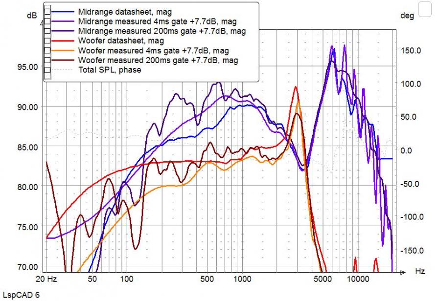

                                      • 698
                                      #468

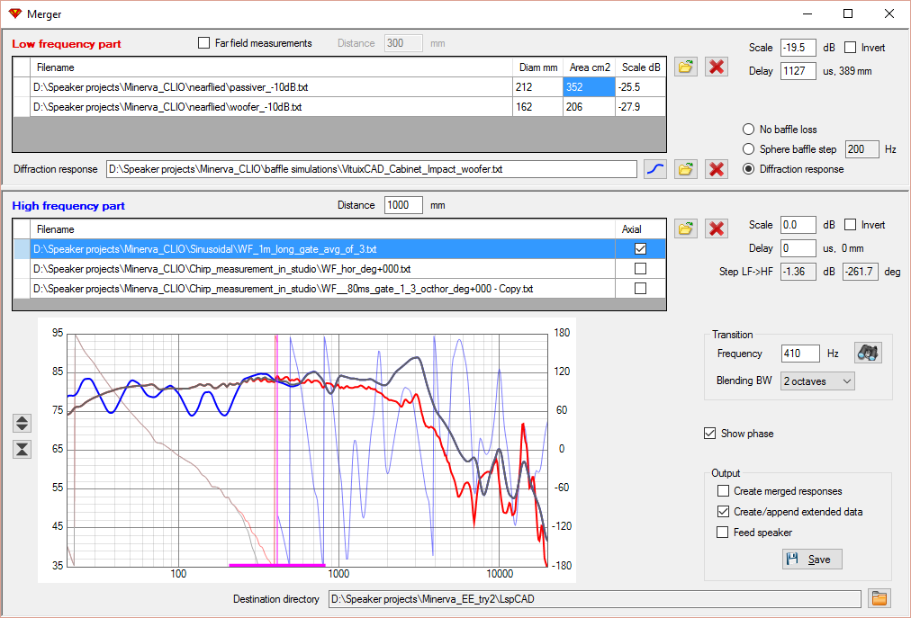

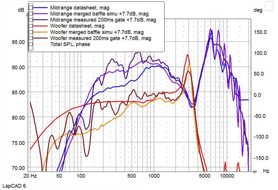

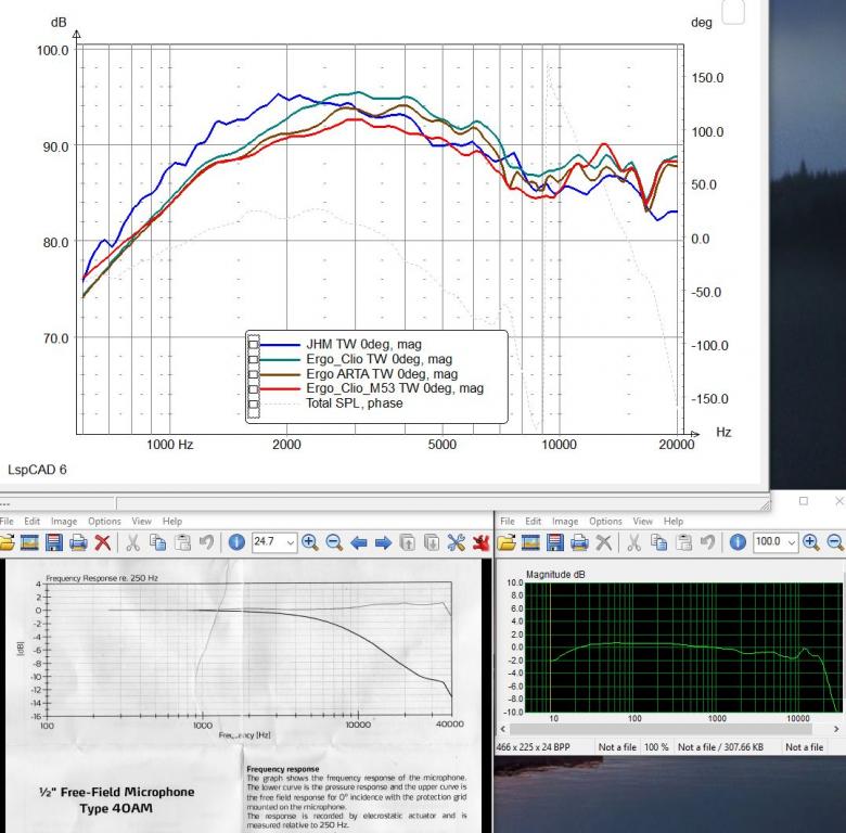

                                      I did calibrate microphone for the correct SPL, but I did not adjust the level to 1W/2.8V. I used a lower playback level, so it is expected that all 3 drivers show less SPL.
                                      I did keep all the settings/gains unchanged for far field test
                                      Microphone was always at 1m distance on the Coax driver center axis. Also for woofer measurement
                                      For near end I decreased the playback signal from ARTA from-3dB to -13dB, so near field plots were later copmensated by 10dB when merging.
                                      Now if I put datasheet plots and my measured one on same graph and adjusted the midrange to match in level in it's upper end I get that I was off from the normal 1W/1m by approx 7.7dB which matches Jons estimation too.
                                      One plot shoe the datasheet vs short gate vs long (200ms) gate. A bit of drop of my woofer levels versus datasheet is expected as I did not have mic at woofer axis but in Coax axis instead.
                                      Other plot shows datasheet vs long gate vs merged response with baffle step effect. From this it seems that midrange baffle simulation holds ok against the long gate plot, but the baffle simulation for woofer seems way off and over estimates the drop a lot. I'll try to work on this and fix the woofer responses.
Name:	datasheet vs short gate vs long gate.jpg
Name:	datasheet vs baffle simu vs long gate.jpg

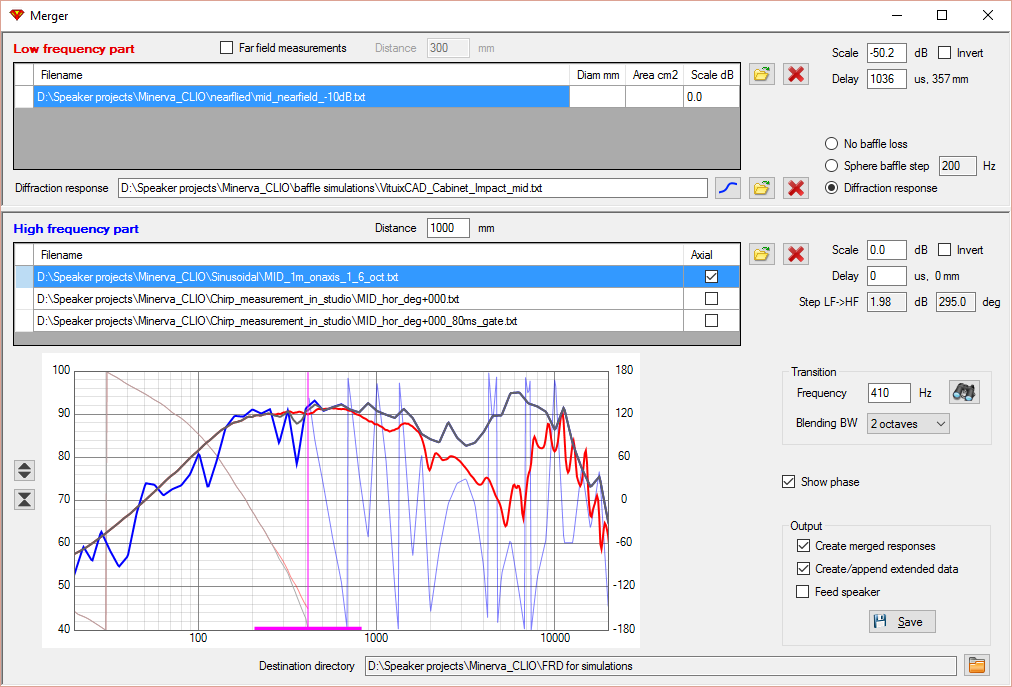

                                        • 698
                                        #469

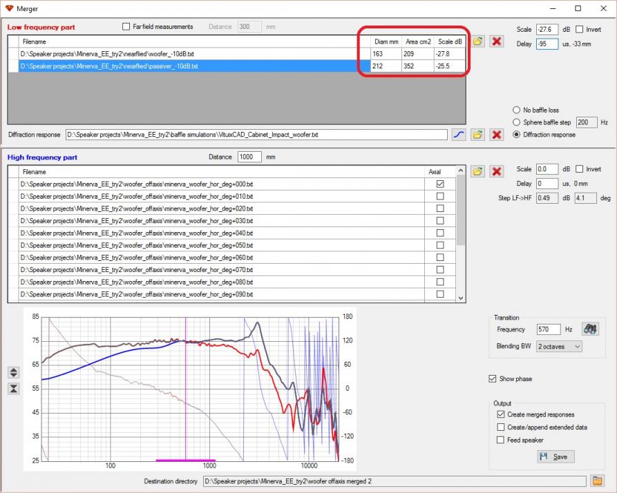

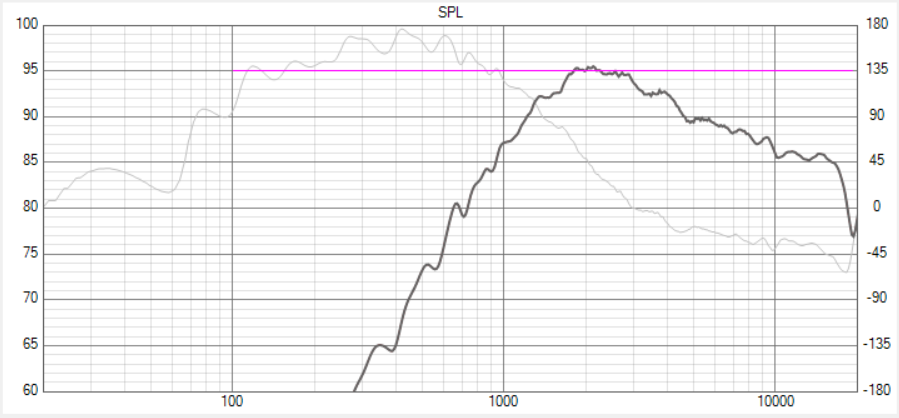

                                        I think I found the main issue... a stupid user error form my part. In Merger one should enter the Sd for both near end sources - ie woofer and PR. I think I might have set the Sd values wrong the first time around.
                                        Now with the new merged woofer plots +7.7dB fix offset for all drivers it starts to look better with Jon's cross version without alterations yet.

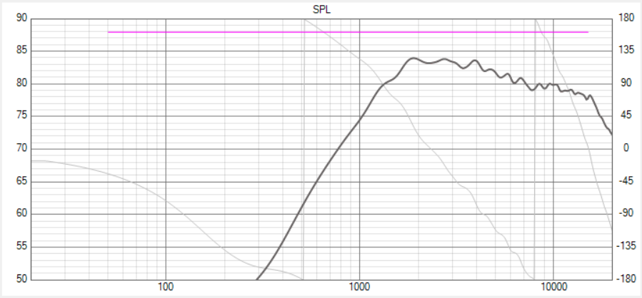

ID:	861630Click image for larger version
                                          • 16202
                                          #470
                                          I'm glad you've been able to get to the bottom of this so quickly, Ergo! The driver measurements with all the hoops you jump through in this process are very high quality, but the number of steps certainly increases the chance for an error compared to a long gate direct measurement! Using the latter as a sanity check is always a good idea.
                                          We'll see what kind of luck I have merging all this and getting it to work with the AP setup as well- that may be biting off a lot in one step! :W

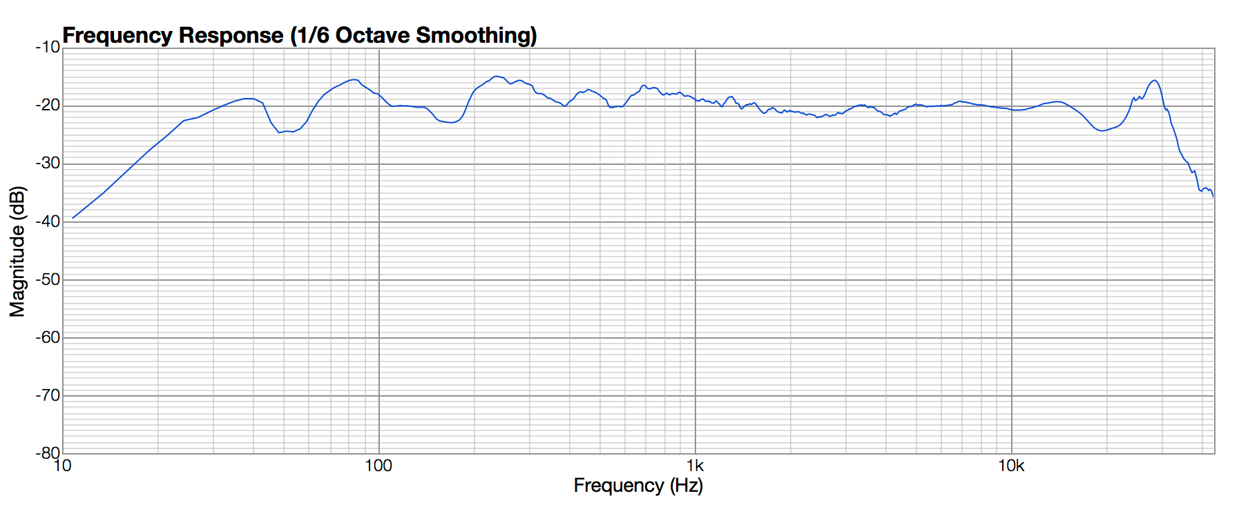

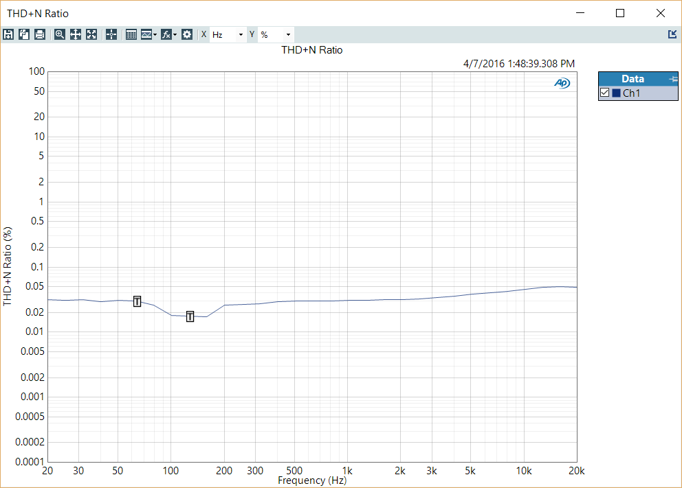

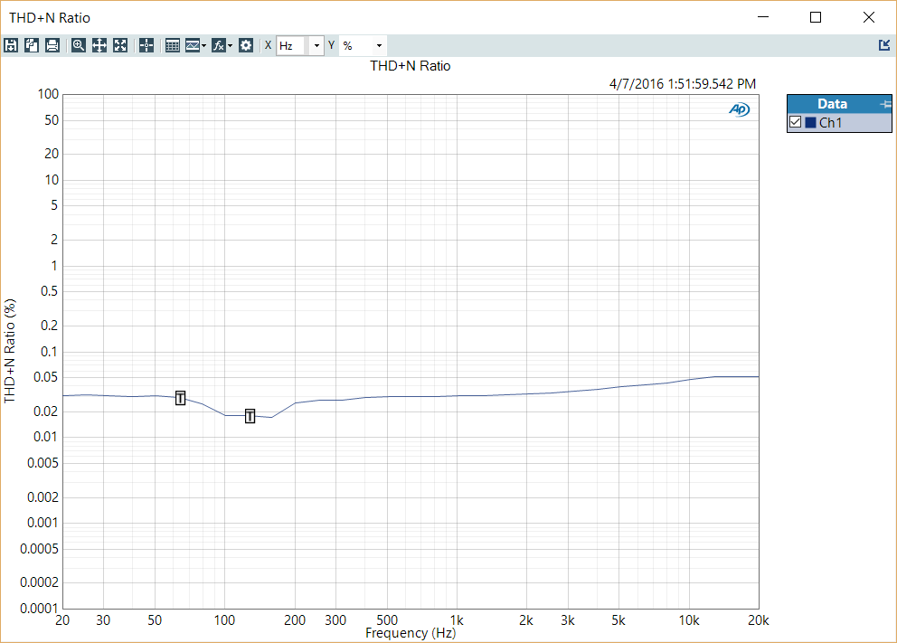

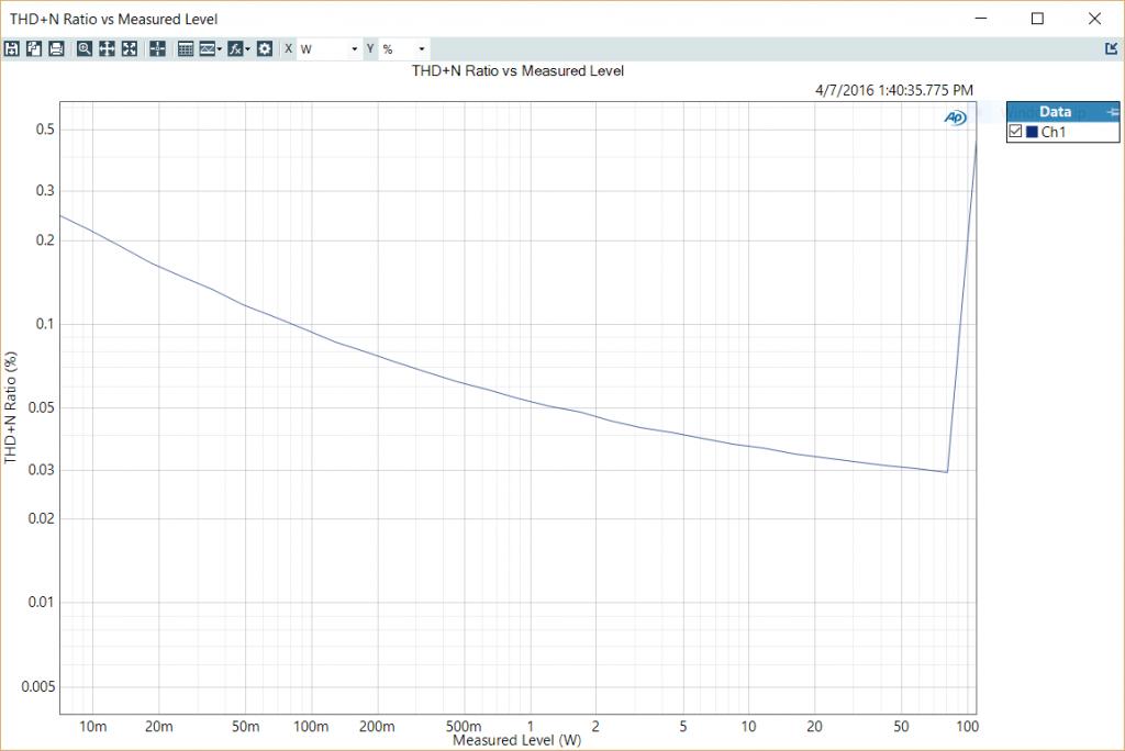

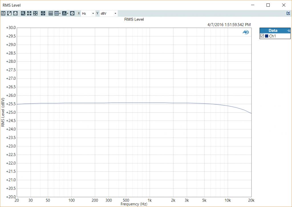

                                            Speaking about measurements, I bought a smaller lighter amplifier to try out for doing speaker measurements- a Behringer A500. I've tested it, and I think it will be convenient and usable, but certainly not the last word for best in class speaker measurements-
                                            Response is down about 0.5 dB at 20kHz, THD versus level isn't anything to write home about; at least, versus frequency it's pretty consistent, not rising a whole bunch at higher frequencies.
Name:	A500 Freq Response.jpg
                                            Measured at 20VRMS, 50W at 8 ohms
Name:	A500 THD+N vs Freq 20VRMS_Out.PNG
                                            THD+N versus level. Let's call this a 75W per channel amp on my local AC line.
Name:	1kHz THD+N Ch2.jpg

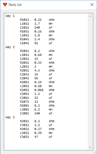

                                                      Store photos and docs online. Access them from any PC, Mac or phone. Create and work together on Word, Excel or PowerPoint documents.
                                                      [ATTACH=CONFIG]25572[/ATTACH][ATTACH=CONFIG]25573[/ATTACH]
                                                      I should take your C18 and my LF data and see how that looks together, and put together a proposed voicing. Can you put up a link with the revised LF data? That would be even better...
                                                        • 698
                                                        #477
                                                        New woofer data is in folder
                                                        Minerva_EE_try2\woofer offaxis merged - NEW fixed\
                                                          • 698

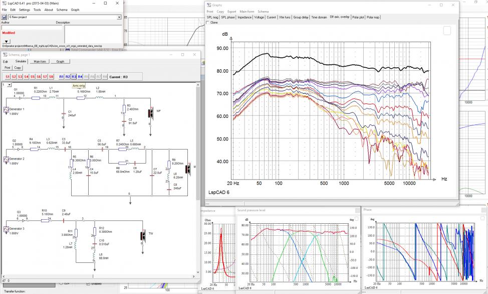

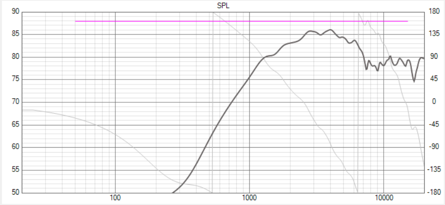

                                                          I got the emulation to work today and listened to single speaker for about 30 minutes with the VituixCAD ver of your crossover and then very slightly modified one trying to get the phases to match with my measured data.
                                                          I do like the sound potential - that is there for sure... the details of voicing - too little listening still. I will be attempting to make some measurements of the speaker in mid room as well as in listening position to see if the balance seen on screen maps to what it is in room.
Name:	LspCAD Jons orig.jpg
Name:	LspCAD Jons orig mod1.jpg
                                                            By the way Jon, when taking measurents if and what value of protection capacitor you use for tweeter? I used 200uF in these. Did not dare to run these tweeters without any cap.
                                                            I'm wondering if this isn't a clue to the differences I'm seeing between the low end of your tweeter measurements and mine- though I think 200uF is so large, it shouldn't have any impact.

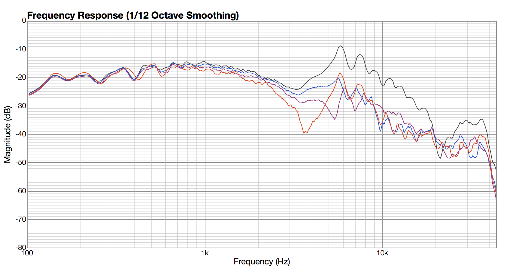

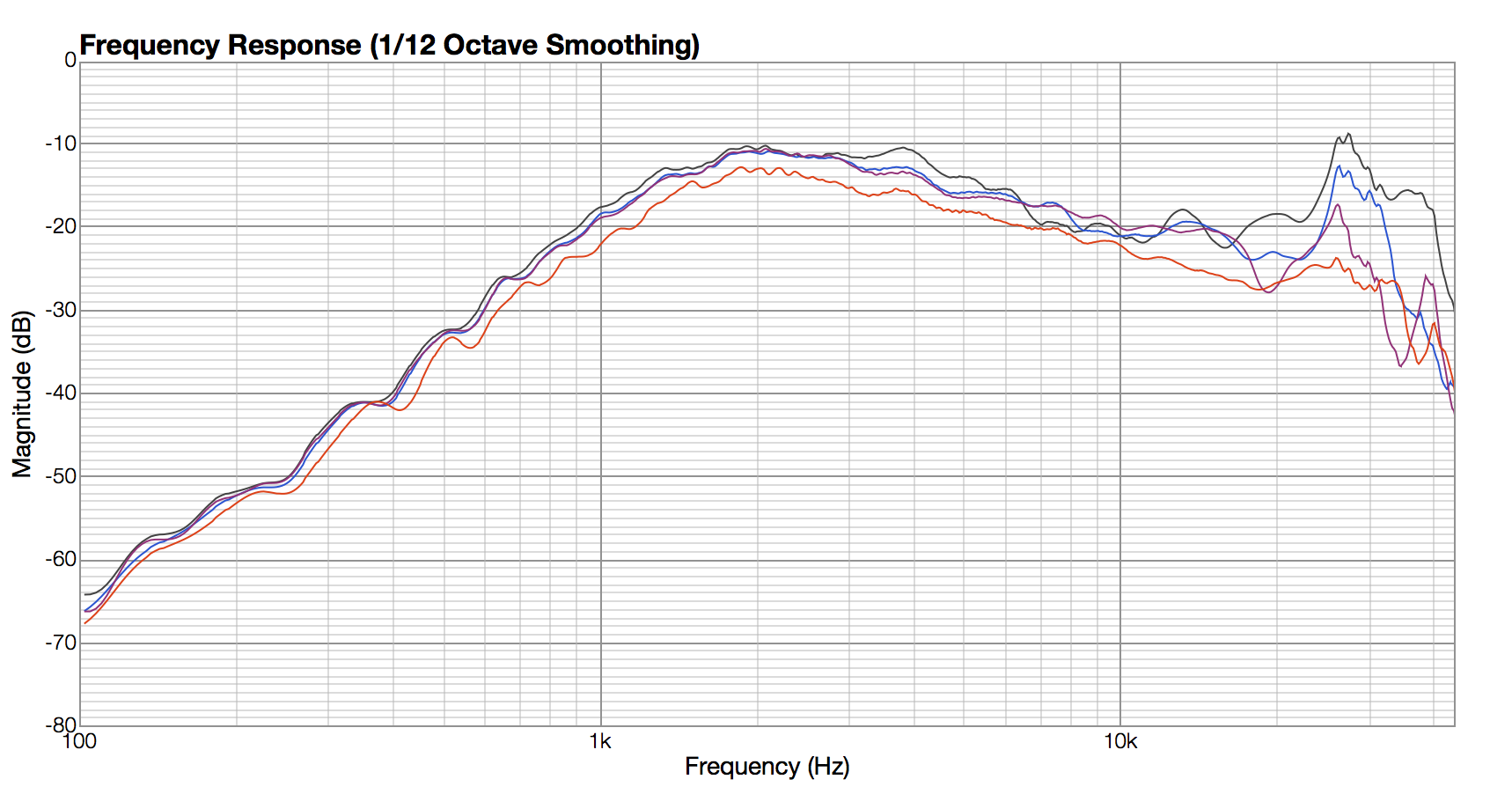

                                                            First, just a quick update, composite plots of my measurements at 0 degrees, 15, 30, and 45.
                                                            C18EN001 Midrange 0-15-30-45 degrees (Black/Blue/Maroon/Red)
                                                            C18EN001 Tweeter 0-15-30-45 degrees
                                                            Comparing graphic plots with multiple axis can be confusing, so I'm also going to prepare and post some plots with Ergo's 0 degree and 30 degrees, and my 0 degrees and 30 degrees, in VituixCAD, as these should be more directly and easily comparable. Maybe that will help. Also, I've been working on the crossover, creating a voicing which is compliant to what Linkwitz and some others believe is "ideal", with a net slope of 4 dB between 100Hz and 10kHz, at 2 dB/decade. that should get a short separate post. More to follow today.

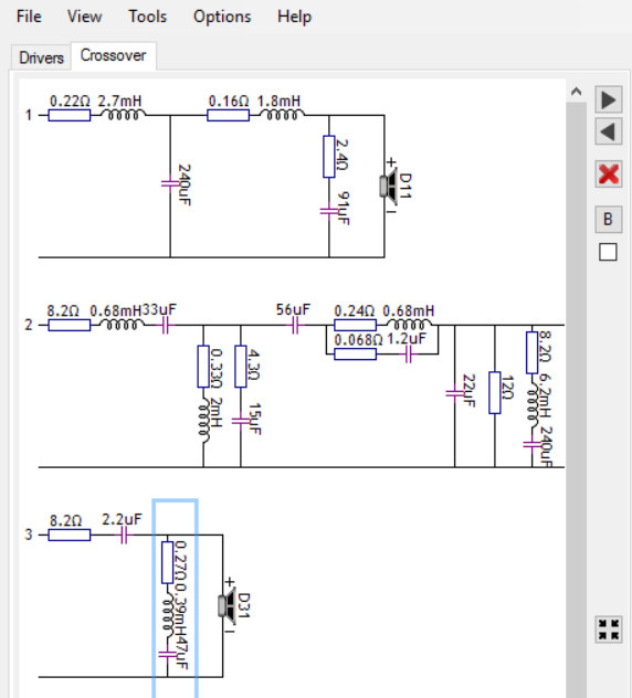

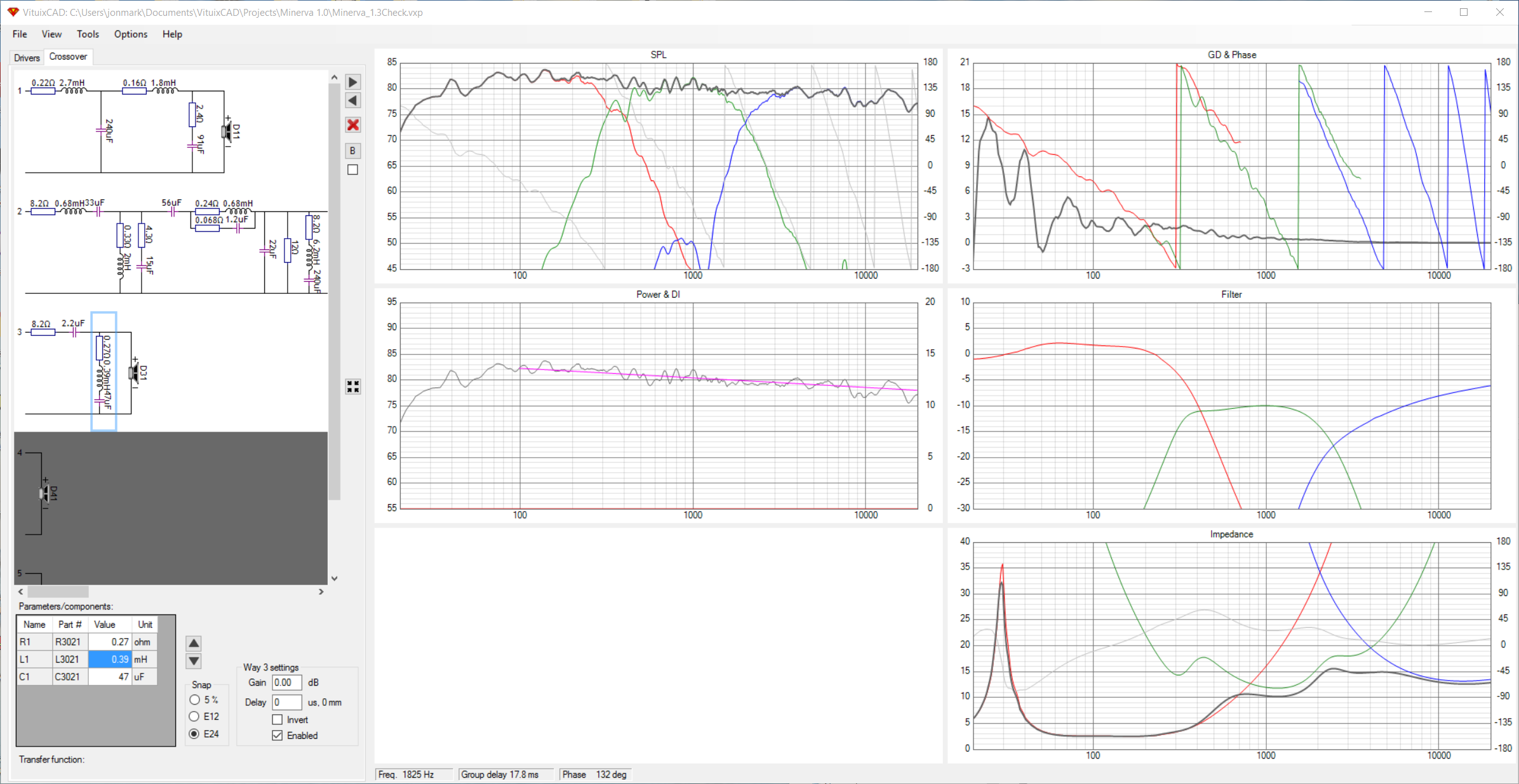

                                                              Here is the updated crossover, STILL using my old measured data- so this is unlikely to be a "production" version, pending measurements with the new cabinets. However, it is just part of the process of moving the design intention along...
                                                              Biggest changes are taking out the original L-R tweeter shunt completely and tweaking the elliptic network slightly; and adding a shunt padding resistor to the midrange, so that as in the case of the Isiris crossover, one can use the series and parallel resistors to alternately tune the passband region and the transition band region.
                                                              Other values have been trimmed to obtain the downslope characteristic, while keeping strong reverse nulls and alignment of the phase characteristics.
                                                              I've started an Eagle PCB schematic which will break out the individual components and part numbers suggested, but it's a bit early to complete that. :W

                                                                        There's a significant difference in the levels, and in the case of the 0 degree file, in the shape of the waveguide curve in the area around 2-3 kHz and again at the higher frequencies. I don't really know what to make of it.
                                                                        I'm still not getting how VituixCAD handles the multiple axis for directivity and power and how that correlates with the main SPL curve; I've just got to spend some more time with the manual.
                                                                        For now, I also have to wonder if the baffle width and diffraction effects at lower frequencies are playing into this.
                                                                        Now, one reason I have some confidence in my measurements, is that after designing a crossover based around it, I got results pretty much as you'd expect when measuring the whole speaker in a single moderate gate length measurement.

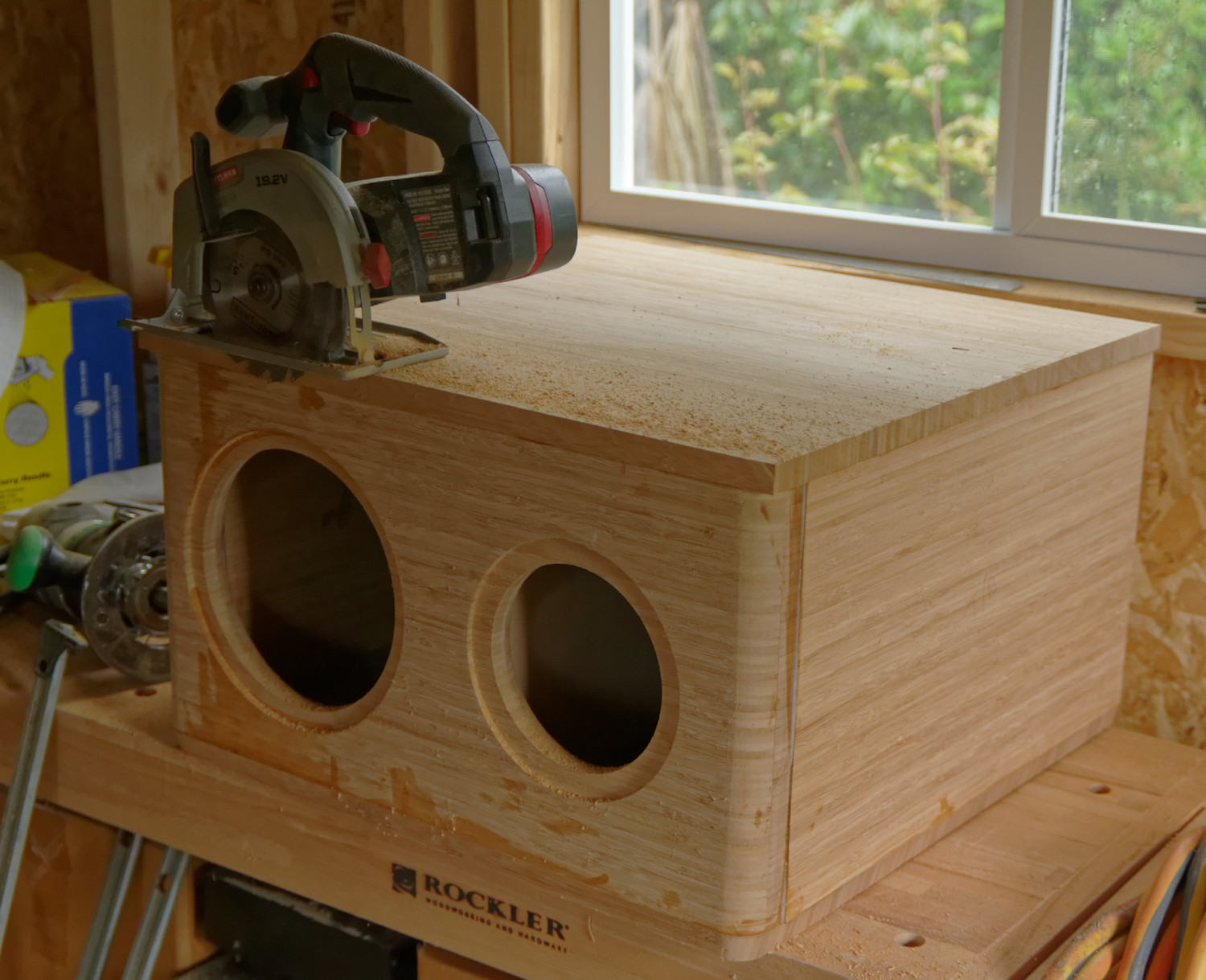

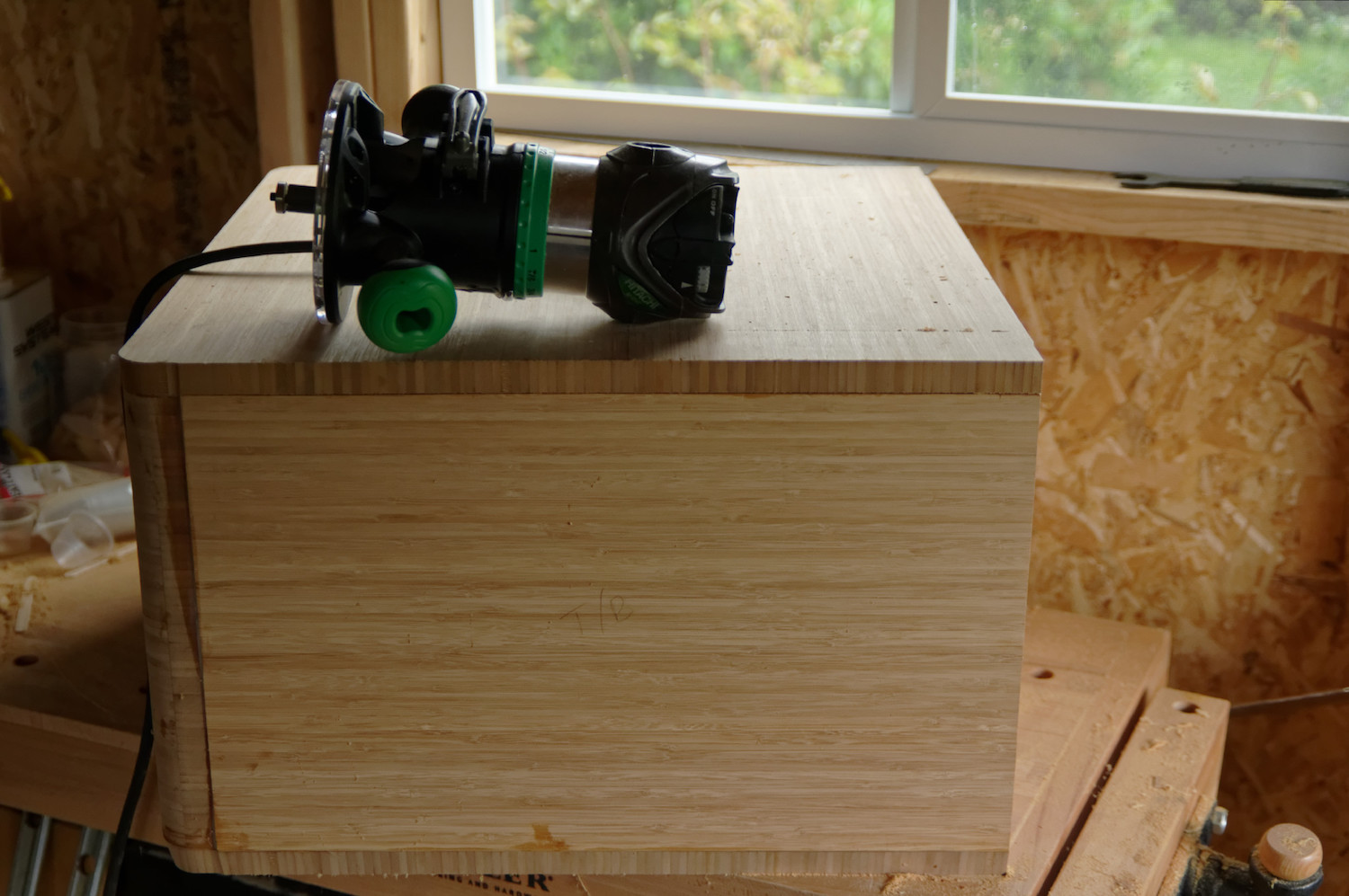

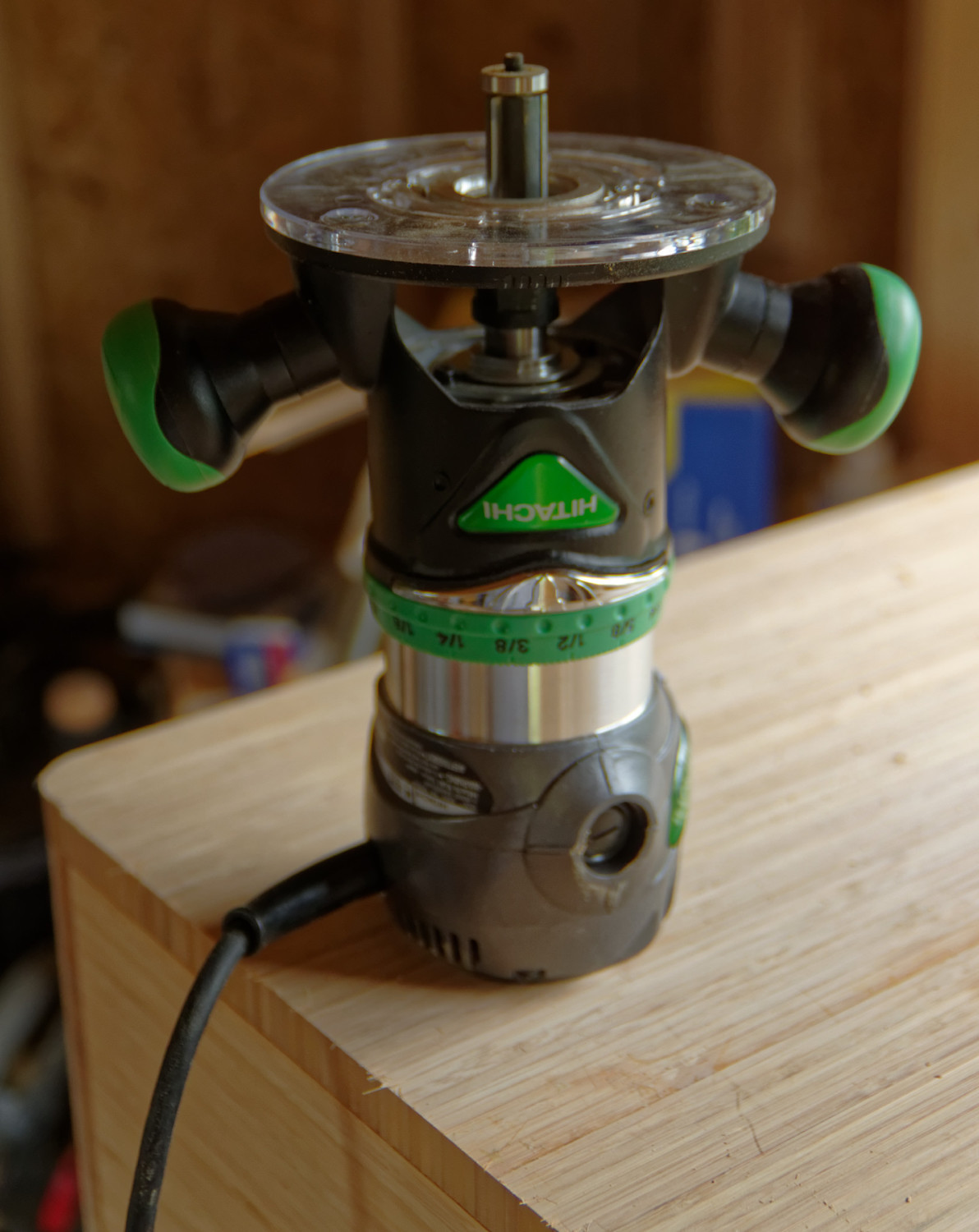

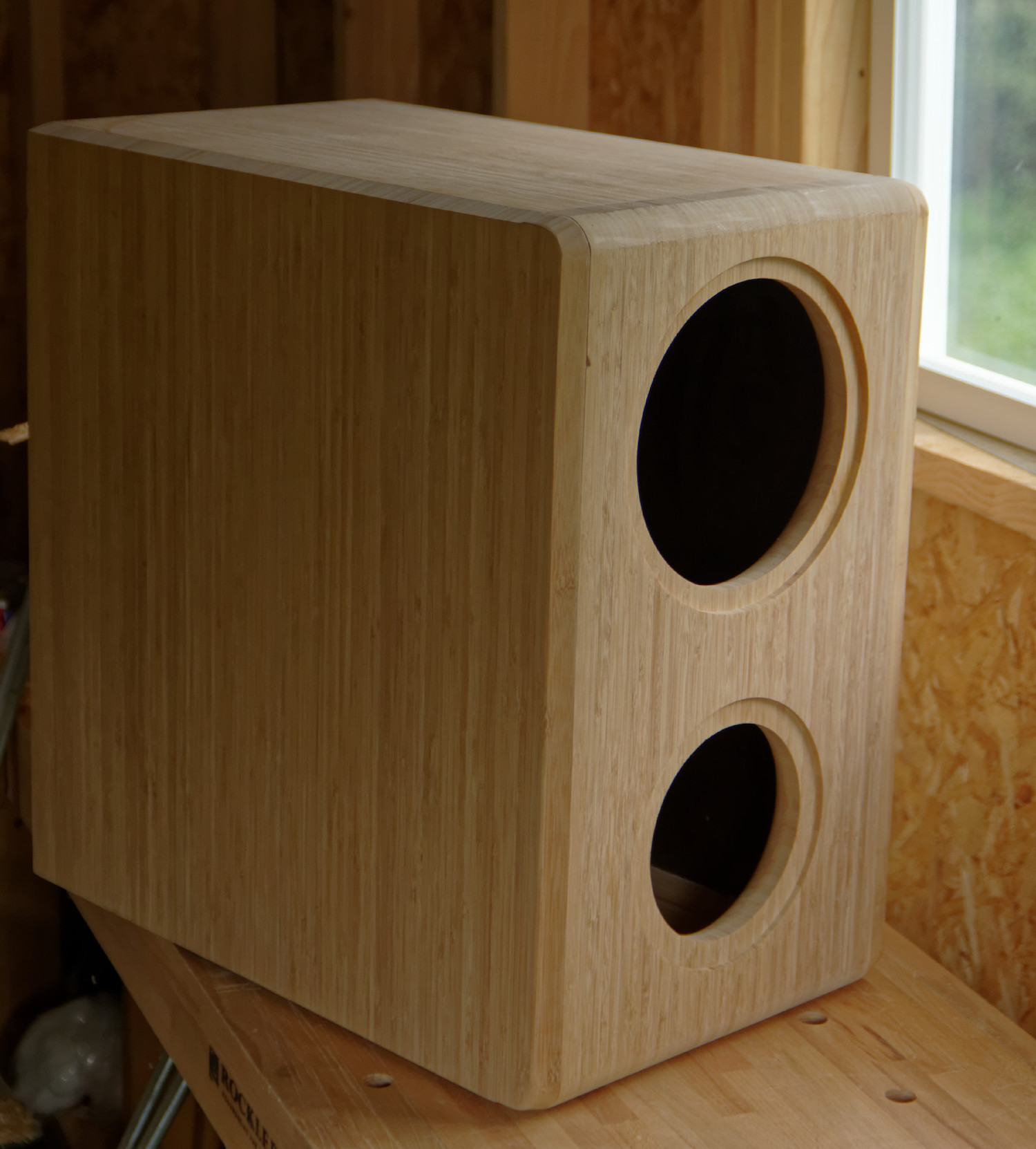

                                                                            #487
                                                                            Making more sawdust... or router dust, as the case may be!
                                                                            Just doing all this computer stuff gets on my nerves after a while... if there isn't some sawdust involved somewhere sometime, something is wrong....
                                                                            Today's task was to trim the second side panel, follower trim it, bevel, and so some overall sanding, just enough to get it ready for handling and test, not for finishing at this time.
                                                                            The little Craftsman 5" battery powered circular saw has been a champ- it came with a very decent thin kerf blade with nice sharp carbide teeth that have stayed sharp, in spite of the material I'm using them on- that's the first step in trimming the side panel, cutting things down to about 1/8" overlap.

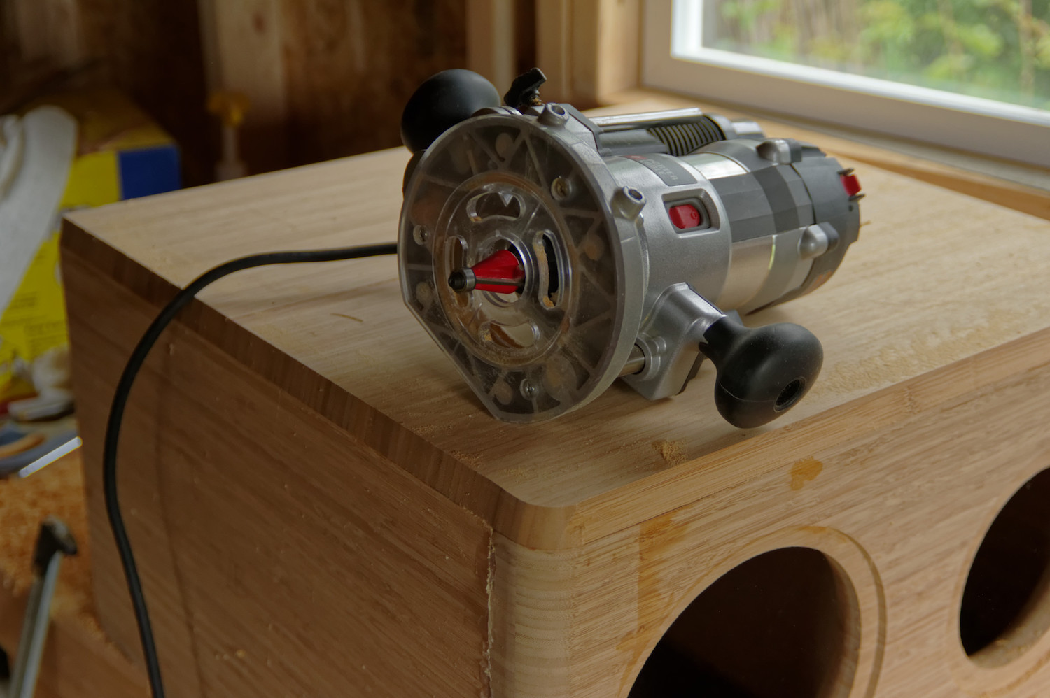

                                                                            Next step is the flush trim, just like laminate, only bigger, using a new Hitachi 2-1/4 HP router I picked up during a binge buying session on power tools after my last medical procedure (we each act out in our own ways...)
                                                                            The Hitachi is a gem; like the M12V's tucked away in storage in Livermore, they are glass smooth- they make a Porter Cable feel like the bearings are getting close to giving out in comparison. Probably some Samurai craftsman in the background lineage of the production designer, or someone in Hitachi Heavy Industries that is just used to over doing everything...
                                                                            Speaking of Porter Cable, next up for the bevel edge cut on the side...
                                                                            You see, this was an immediate A/B comparison, though not a blind comparison- only a fool uses power tools with his eyes covered!
                                                                            Remember, these are just the 2nd generation acoustical prototypes, and will be finished and used in a utility application such recording or possibly taken into the work lab if we ever get back on that Class D project there. But from horseback, they probably don't look too bad. And they are hella stout! (front to back brace of BB Ply, sides are combo of BB ply and LBL, tops and bottom and fronts are double LBL) .
                                                                            For now, I'm leaving the cut out plate for the passive radiator in there; it will have the holes for test leads going through it, since we don't really care about the sub 50 Hz stuff for designing the crossover, and I can finalize the connectors and wiring later on.

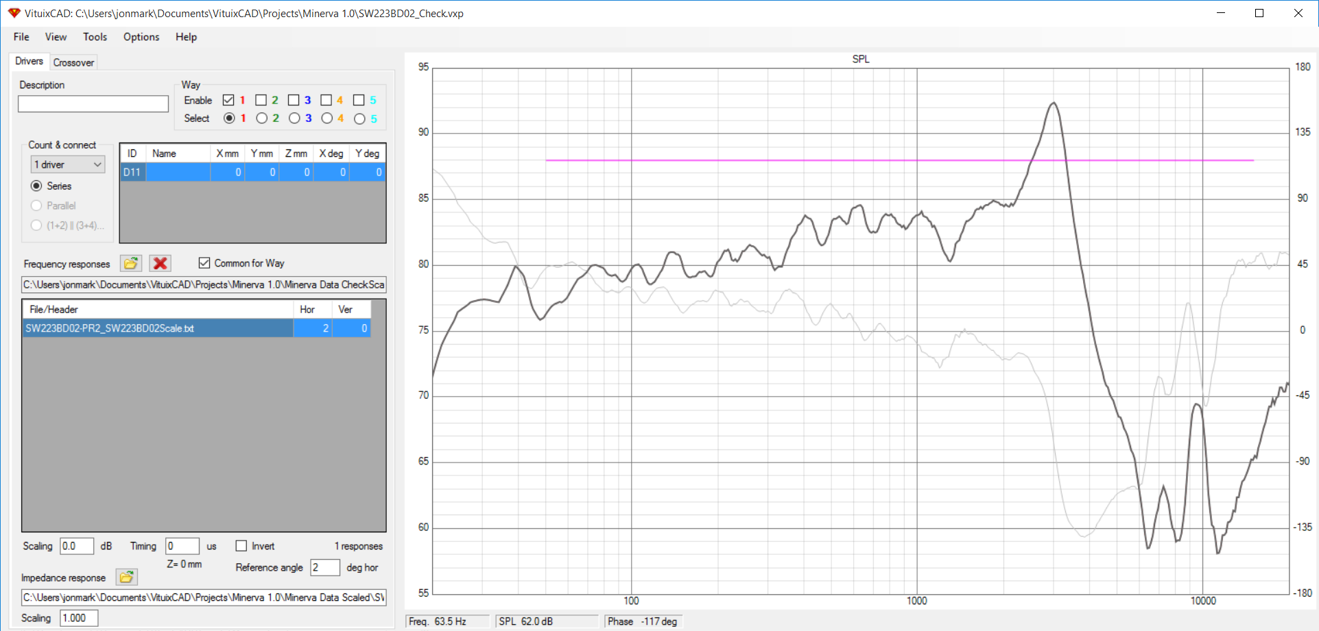

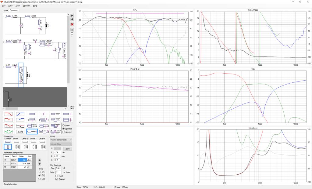

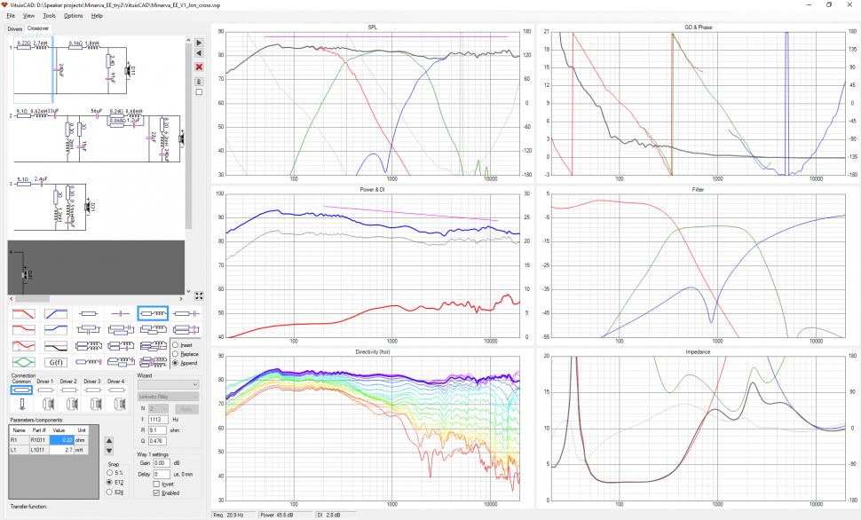

                                                                                      Ok - I've gone to use "bigger guns" - ie replaced ARTA based setup with CLIO 11 FW. The only negative with CLIO is that I can't get it to behave together with my laptop running win 10 and PC-card FW interface.
                                                                                      It does work on my HP desktop PC which also runs win 10..... anyhow, due to this I had to do measurements in my listening room instead of a bigger family room. The gating needed to be 4.1ms due to that
                                                                                      I think levels wise this setup is getting it very close. There is still a discrepancy especially in 500...3k range even though this time I did not use any protection cap.
                                                                                      My measurements are with
                                                                                      ARTA + GRAS 40AM mic
                                                                                      CLIO + GRAS 40AM mic
                                                                                      CLIO + LinearX M53 mic
                                                                                      With M53 I'm pretty confident that CLIO has a bug and never applies the mic cal file. I tried all tricks and copied the MICA.cal file to the Clio.exe folder etc - I never see any change. The plot also indicates that mic cal has not been enabled.
                                                                                      Still my two mics give resonable good match - so the conclusion I guess is that the baffle shape and maybe a bit of unit to unit variance must be the cause here.
ID:	861647Click image for larger version

                                                                                        I also used CLIO-s sinusoidal measurement for low frequency (no gating there)
                                                                                        I measured woofer
                                                                                        1) mid room - mic at 1m
                                                                                        2) left speaker position - mic at 1m
                                                                                        3) right speaker position - mic at 1m
                                                                                        Then averaged these 3 LF measurements and tuned the far field / near field merging level based on this. So hoping it is getting closer to truth now
                                                                                        After all the hassle the match between Jons V1.3 cross + my Clio data looks already very close to Jons simulation
