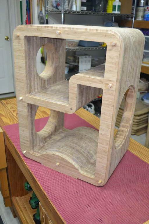

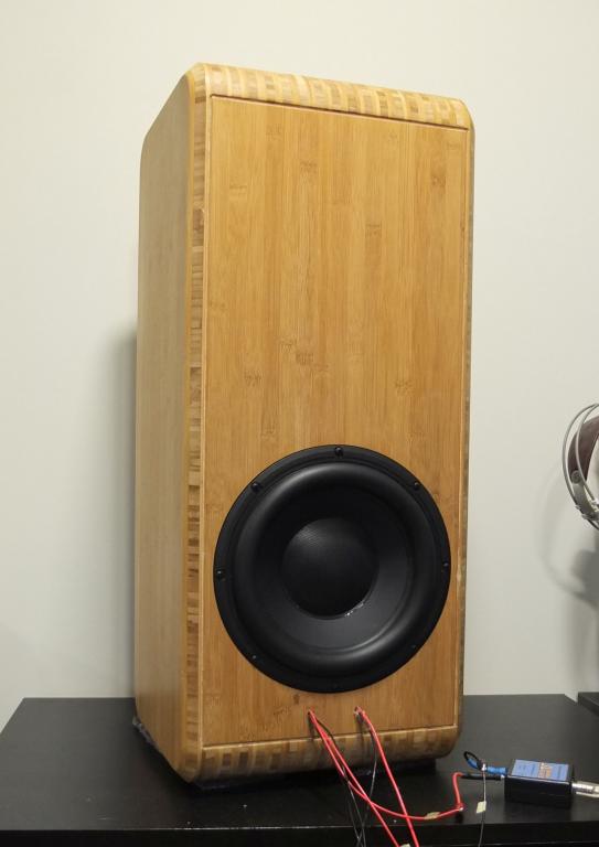

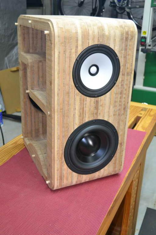

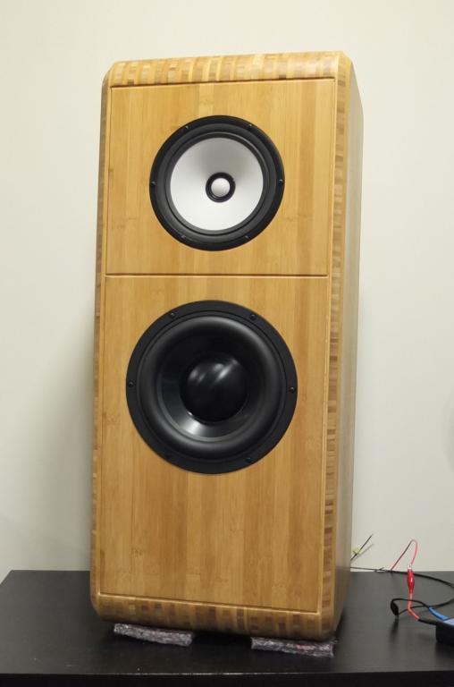

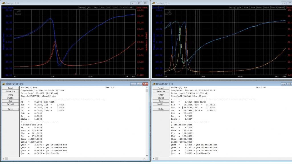

                Slow but sure progress.
                One box assembled. I have 10mm felt on side, back and bottom panel in mid enclosure + 100g of TWARON Angel hair filling. On woofer box I have only the 10mm felt on two side panels. Left the lamb wool meant for additional stuffing out for now to better see the box alignment. Fsb is 29Hz now, but these are fully virgin drivers that have not seen any work yet, so may be it will lower just by working them in.
ID:	861575Click image for larger version
ID:	861576Click image for larger version

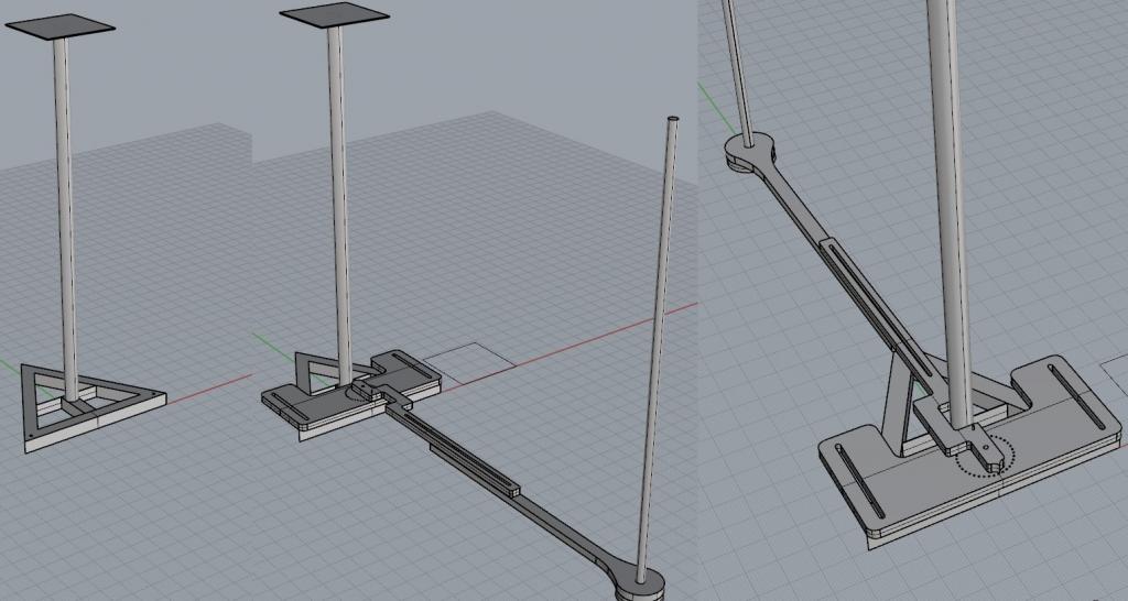

                    The VituixCAD and the ARTA automator from Kimmo really triggered a big want to attempt me to make true 180deg horizontal and 360 vertical polars this time.
                    Now the problem is that the turntable I have would suffice for horizontal polars. But vertical would need something else. My boxes being much taller also make it hard to rotate them to lay on the side and at same time turn them.... so I had an idea for a contraption that moves the mic instead. The current plan allows 10deg steps from 0...180 and if the inner piece of the arm is turned upside down it can go the other way to 180 too. Will think about it tomorrow some more and if I still like the idea I'll try to cut this out from the bamboo scraps I have left.

                                My chain of thought is...
                                * horizontal plot can be done relatively easily with the type of plate I have. The front panel is adjusted in line with the axis going through the center bolt.
                                * vertical would be harder - doing it really in vertical plane would need a different kind of solution - probably also moving the mic not the speaker
                                * I'm planning to tilt the speaker on it's side and do another horizontal sweep of angles, but as the coax is in about 1/4 the lenght of the box it would never be in balance on the stand. Adding a second stand will make it very hard to rotate the box.
                                * so the solution with above is to always rotate mic around the speaker in horizontal plane - this way I can build additional supports to keep the long box tilted on its side in balance.
                                * I will do 0 to 180 in horizontal as it'll be symmetric to other side
                                * I'll do 0..180 towards top vertically and then some angles in other direction and see if it shows any significant difference to justify really doing the 0..180 towards bottom also.
                                I've never done any speaker that thurally - so just interested to try the process and see the data. VituixCAD tools make it tolerable workload to later process all that data too... that used to be a problem with my prior tools (just ARTA or CLIO with LspCAD)

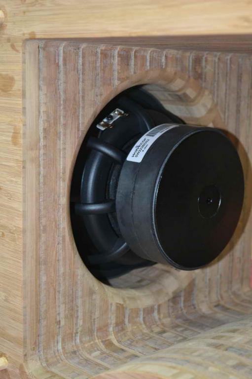

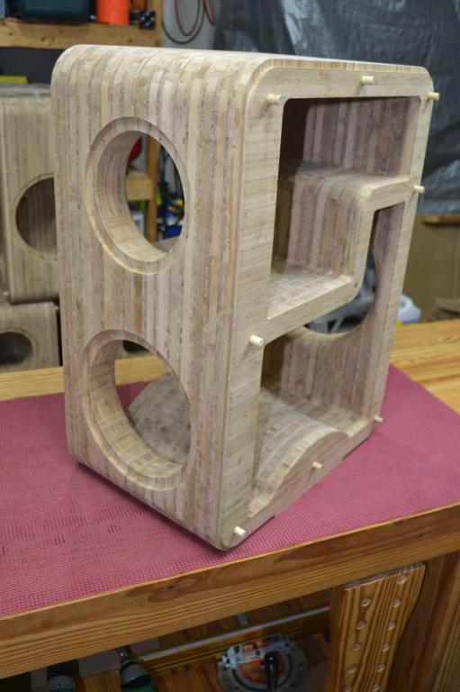

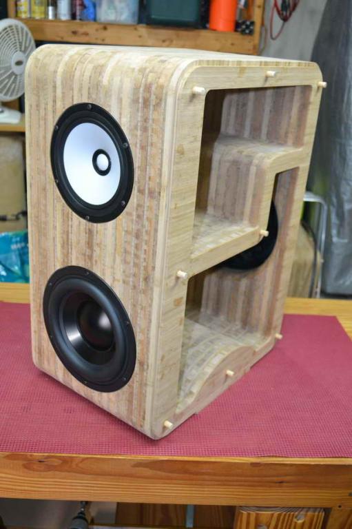

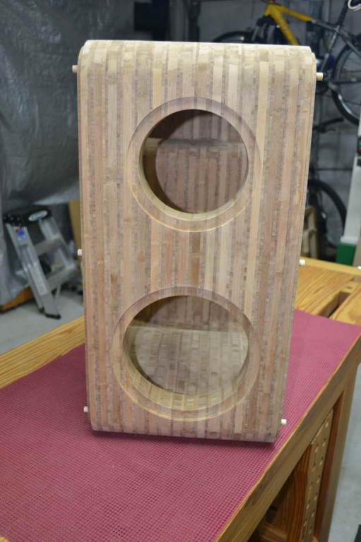

                                  Small update ...... finished with the coax cutouts and started with the woofers. Starting to look a bit like a speaker.

                                    Steve...I bet you are glad that step is out of the way. Good job. :clap:
                                      • 2129
                                      #423
                                      Almost .... that's the first one ...three more woofer cutouts and then I'm done, and yes I will be glad to see that behind me. Yesterday I timed it and it took 25 minutes just to router out the slug of wood. All told just the routing process for the one hole was ~75 minutes. That's a lot of puckering.
                                        • 16104
                                        #424
                                        Indeed it is! Slow work takes time....

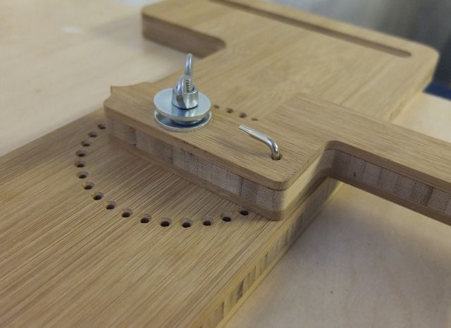

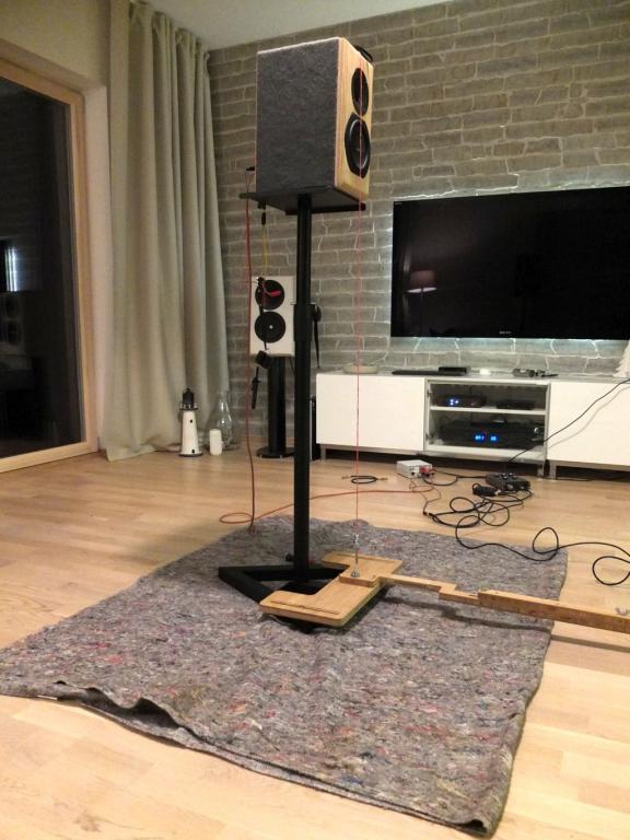

                                          I did finish the 'Mic rotator helper tool' today and did some practice rounds before attacking the Minervas tomorrow.
                                          The result sample is from my ModulaMT mkII EE version (I used the Nextel series woofer). These are just a plot of the gated responses (4.5ms gate) - so not valid below 500Hz or so but still ineteresting from there upwards.
ID:	861593Click image for larger version
ID:	861594Click image for larger version
ID:	861595Click image for larger version

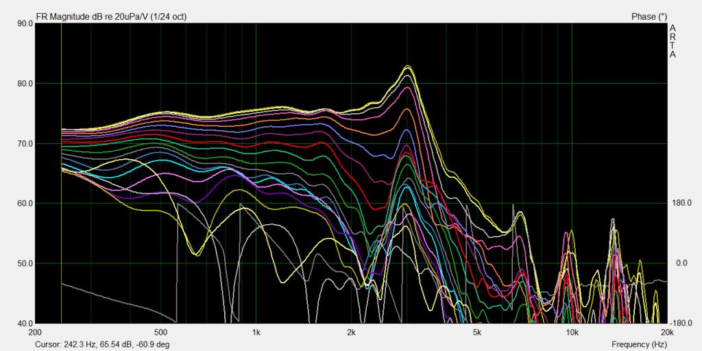

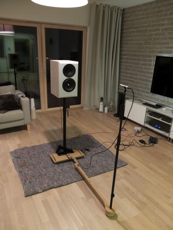

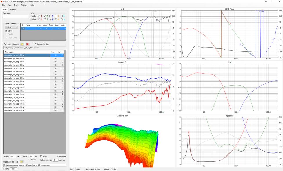

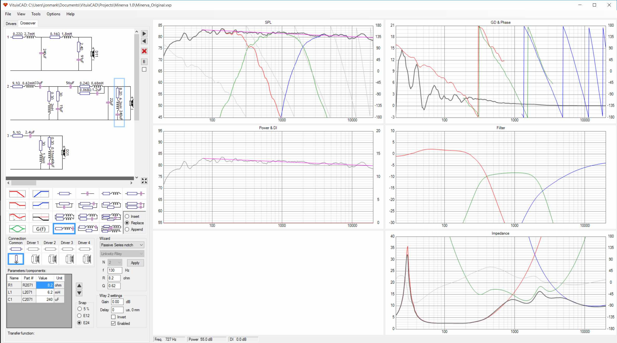

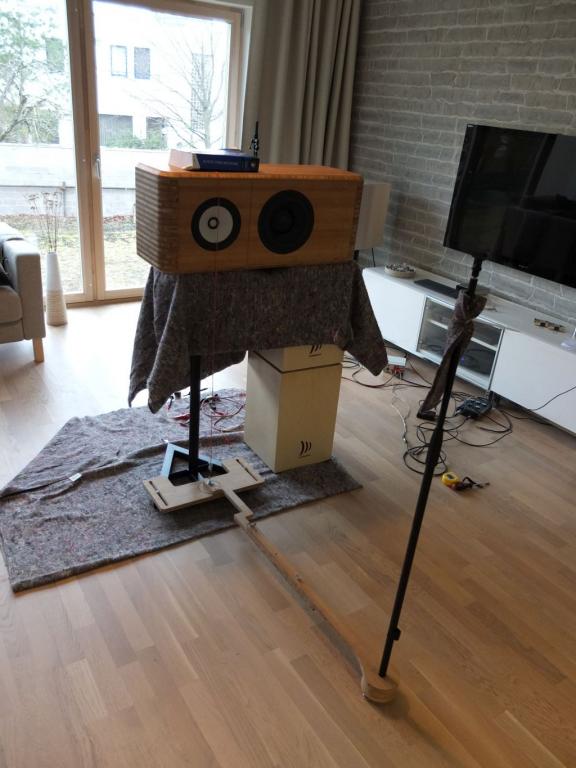

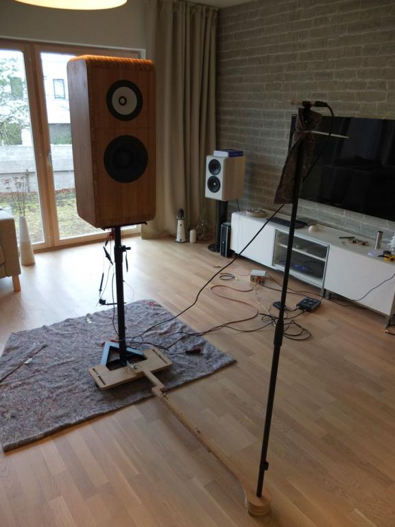

                                                After a full day of effort I did get it all done. Twice actually as at first round the SPL was not right and then the engineer in me would not let it go and I redid all again. the repetition is a good teaching method so I'm sure I'll remember the tricks that much better next time.
                                                I used a lab microphone thats good to 40k, so I also wanted to get the SPL right as I do have the calibrator.... Now getting ARTA to get right levels was a bit of hassle. If one does the microphone calibration, then for example the SPLmeter sub module starts to show correct level right away. The 2 channel IR measurements is different though. In end I had to calibrate both left and right input and then also the microphone SPL -> mV before I got all working.
                                                Did the whole 0..180 deg horizontal polars -80... +170 vertical polars - will try in one of the next days to take some 4..5 angles from each and calculate average for example. Then I get to see if the verticals are needed at all.

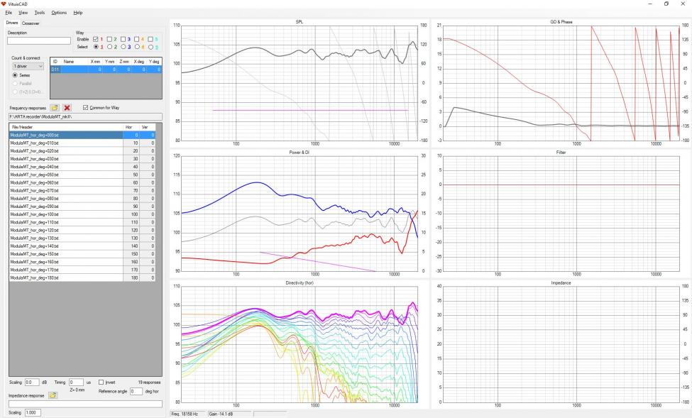

                                                Anyhow. Below are the setup pics + the initial gated measurements entered to VituixCAD. I'll need to follow the process of merging those with the near field measurements and baffle simulation to get it correct in lows also.
                                                Still, not bad and reasonably close to Jon's, but not 100% match. But thats to be expected I guess.
                                                I'll organize the data in clear folders and put it up in Onedrive too in case anyone's interested.
ID:	861599Click image for larger version
ID:	861600Click image for larger version
ID:	861601Click image for larger version

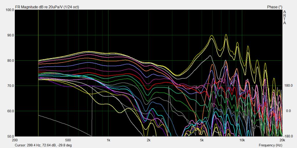

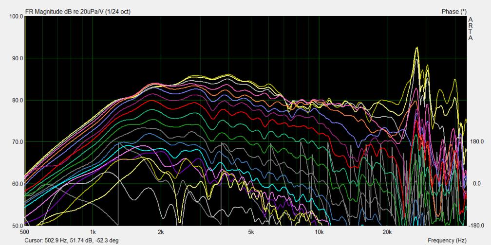

                                                  Mid offaxis
                                                  Woofer offaxis
Name:	woofer hor overlays.jpg

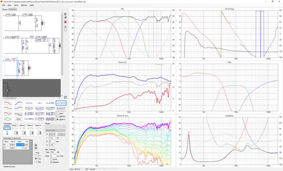

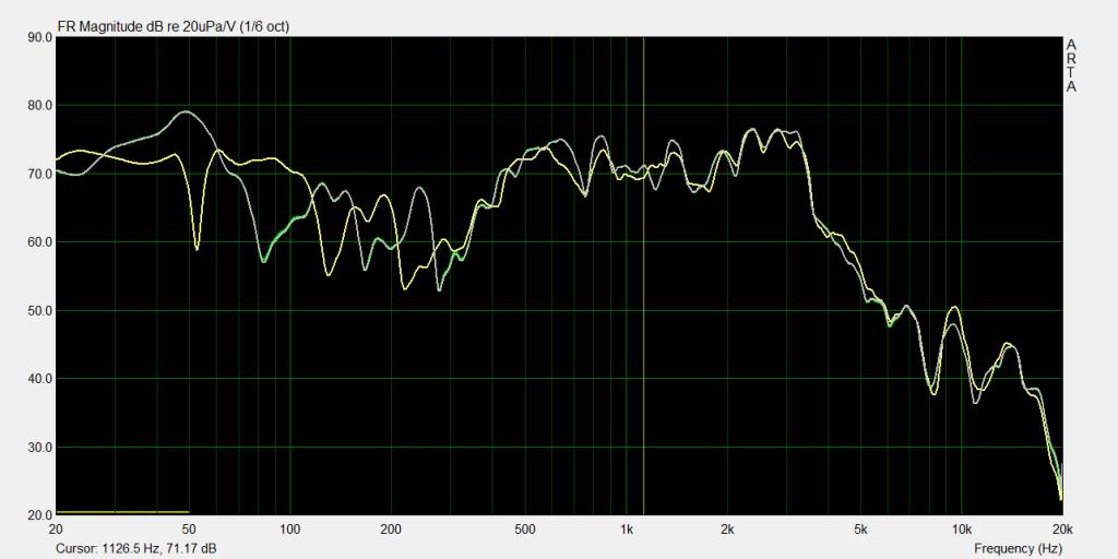

                                                    I might have some luck also with the bass in room. This is a measurement of the unfiltered woofer in my listening room left and right speaker position. Seems the room modes are nicely different in both positions, so hopefully the sum is ok... but I'll need to finish the second box and crossovers before I get to know that.

                                                        This one is now Jon's V1.1 cross with my polar data (horizontal+vertical). Woofer and mid have now been merged with near field measurements and baffle step simulation shape added also.
                                                        I've also uploaded all of the project files here. So in case someone wants some real data to play around with VituixCAD then it's all there.
                                                        Onedrive link

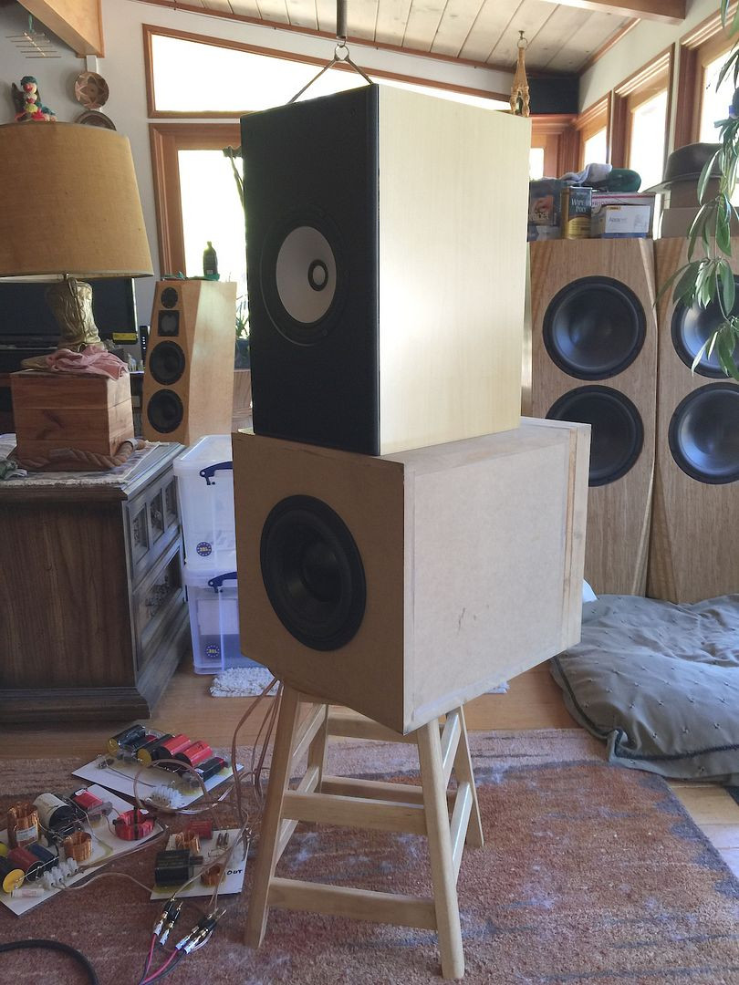

                                                                  Comments-
                                                                  Nice setup and measurement work-
                                                                  Keep in mind, my "first gen proof of concept" was using the PE box and sub woofer cube, so baffle widths aren't right, and I wouldn't expect that data to match yours in a number of areas.
                                                                  It's cool to have someone else doing this measurement work also- I'm wondering if I should measure both in Fuzzmeasure as I usually do, and also with the AP setup- but as the mic and preamp and physical setup will be the same, I wouldn't expect any significant differences.
                                                                  And that's why I have what I call 2nd generation acoustical prototype cabinets in build process, to get something that is dimensionally about the same as the end product:

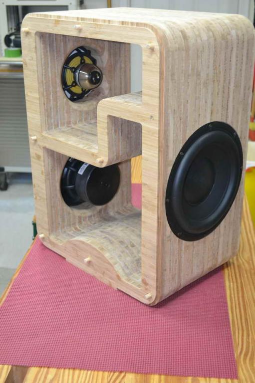

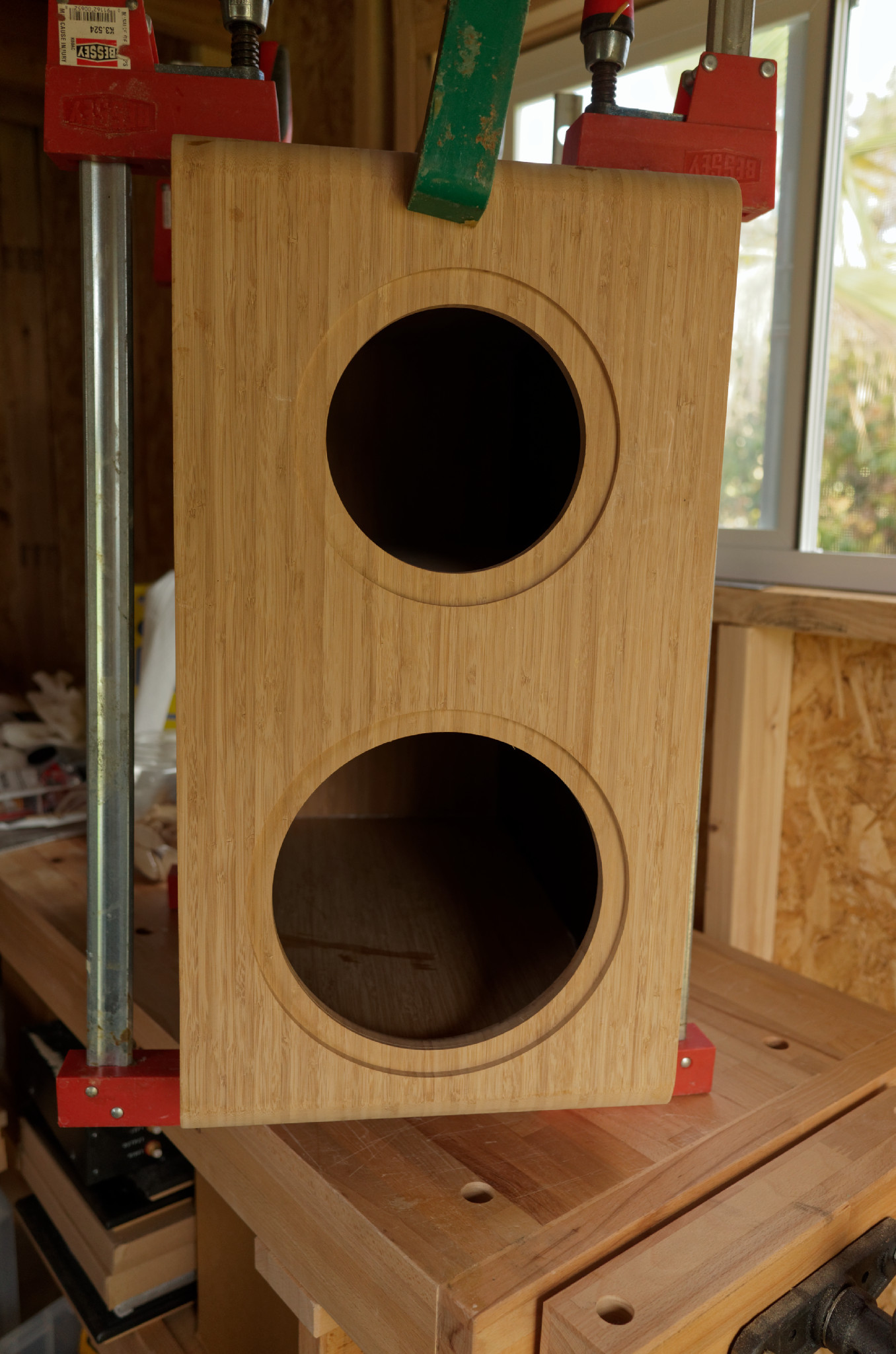

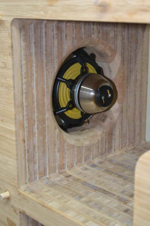

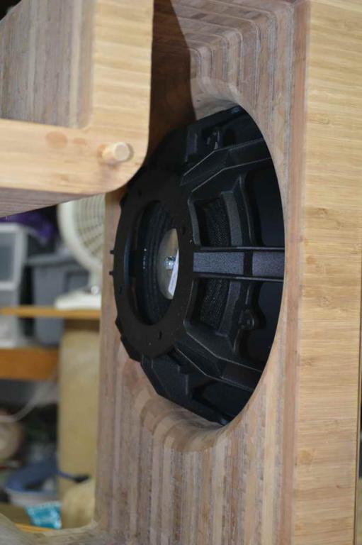

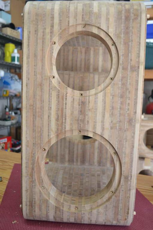

                                                                        Now we can sort of celebrate Scott ...... last of the driver cutouts are done.
                                                                        Started into what others of you perhaps wisely avoided ...... threaded inserts for the drivers. First cabinet is done so I did a fit of the drivers.

                                                                          New custom router bit did a great job of leaving plenty of breathing room around the back of the drivers ......
                                                                            • 16104
                                                                            #442
                                                                            Inserts... In LBL. This guy is a hardcore craftsman!
                                                                            Yeah, the Whiteside bit has done a great job all in all!
                                                                            I'm really enjoying seeing those drivers mounted in a cabinet! :T

                                                                              I tought about threaded inserts too, but seeing how strong and hard the bamboo is I tought that it will probably hold a regular screw also much harder than BB or MDF.
                                                                              The Seas coax is so pretty from backside too that it's almost a pitty to hide it in a box... but then again the sound is what will really matter in the end and the looks comes after. And with this project the looks side is cool too still.
                                                                                • 2129
                                                                                #444
                                                                                Originally posted by ergo
                                                                                Very nice work.
                                                                                Thanks Ergo ...... one could always do acrylic sides if you wanted to see the drivers from the back. At an 1 1/2" thick I don't think it would flex much.

                                                                                  Ladies (where are they?) and Gentlemen, please welcome the Wavecor SW223BD02...
                                                                                  and the skp model...
                                                                                  File no longer available
                                                                                  Last edited by theSven; 30 June 2023, 11:30 Friday. Reason: Remove broken image links

                                                                                        • 571
                                                                                        #448
                                                                                        OK Steve now I can say good job. Inserts too :T...they give you more hardware options.
                                                                                        As far as the rear breathing...that's one thing I really like about the C18en with the small neo motor...along with your nice rounding job of course.
                                                                                          • 2129
                                                                                          #449
                                                                                          I guess now I can say thanks ..... again. Got the inserts finished on the cabinets this afternoon, 80 in all for the cabinets. I did some tests a while back and discovered you need to go over the recommended pilot hole size or the threads shear off on the brass. Once I got that figured out they went in nicely.
                                                                                          I got lucky finding that bit with the ability to get a longer spindle from Whiteside. It mowed right through the lbl no problem and had plenty of reach for the 2 1/2" thick material.
                                                                                          • cochinada
                                                                                            • May 2014
                                                                                            • 661
                                                                                            #450
                                                                                            And voilĂ  the last of the three...
                                                                                            and the model...
