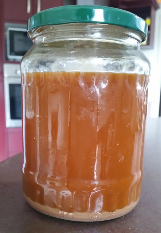

I actually used waxed shellac by mistake, prior to finding out you shouldn't with a topcoat and I've had no issues with my oil based wipe on poly topcoat. The poly I used was thin enough that I applied it with circular motions and it worked out fine. Again I would experiment, but wipe on poly is a whole lot easier than applying shellac as shellac dries so darn fast. If you're happy with the shellac part the last step is easy. Easy that is with a lint free cloth! BTW, they look great! :T

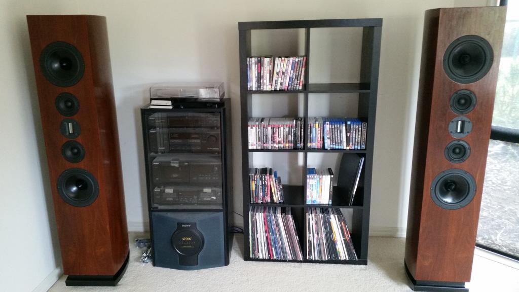

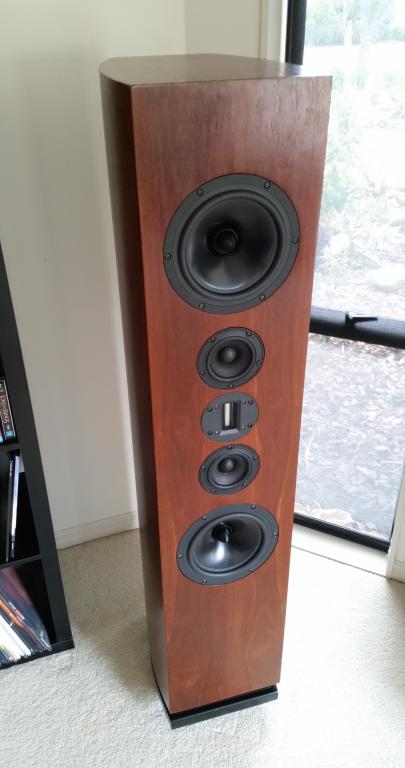

My full sized Statements II build
Spleen21: Great job on your planning and execution - beautiful result. I like your Jarrah choice. My finish of choice has always been hand-rubbed Danish oil. Starting with 400 0r 600 grit Wet-Or-Dry paper and lots of oil, up to 1200 grit, you'll get a finish that is so glossy that many will think you polyurethaned the veneer. But oil, IMO, makes grain pop like nothing else - look what French polish does for grain pop. The caveat with oil of course is that it's the least protective finish. Don't let your mates set their sweating cold cans of beer on top of your speakers.

Hmm the wax free shellac that we've always used has been clear, I guess it's just different stuff.What you screamin' for, every five minutes there's a bomb or something. I'm leavin' Bzzzzzzz!
Now with website. www.5een.co.uk Still under construction.- Bottom
Yeah, like completely clear. I'm assuming that what you dissolved it in was clear?
We always made ours up with really pure ethanol though, so perhaps that's making a difference. Once it evaporates though, what's left behind should be the same. I'm just wondering if the waxed version actually has stuff still in suspension rather than having it all collect at the bottom?
I am assuming that the stuff without wax will stick to the stuff with wax. The problem with putting poly on top, I am assuming again, with the waxed stuff is that the finish just doesn't stick. If you were to put one final layer of dewaxed shellac on before you go at it with the poly, then that might get around it.What you screamin' for, every five minutes there's a bomb or something. I'm leavin' Bzzzzzzz!
I used clear methylated spirits I bought from an automotive paint supply shop. Its what was reccomended by the furniture restorers I bought the shellac flakes from.
I did read that the commercially dewaxed shellac is dewaxed through a chemical process. Since my shellac hasnt been through this process perhaps thats the difference?
Im still really happy with how my DIY dewaxed shellac looks and will do some more tests before applying any poly.
Could potentially put a commercially available dewaxed shellac on last before the poly if need be- Bottom

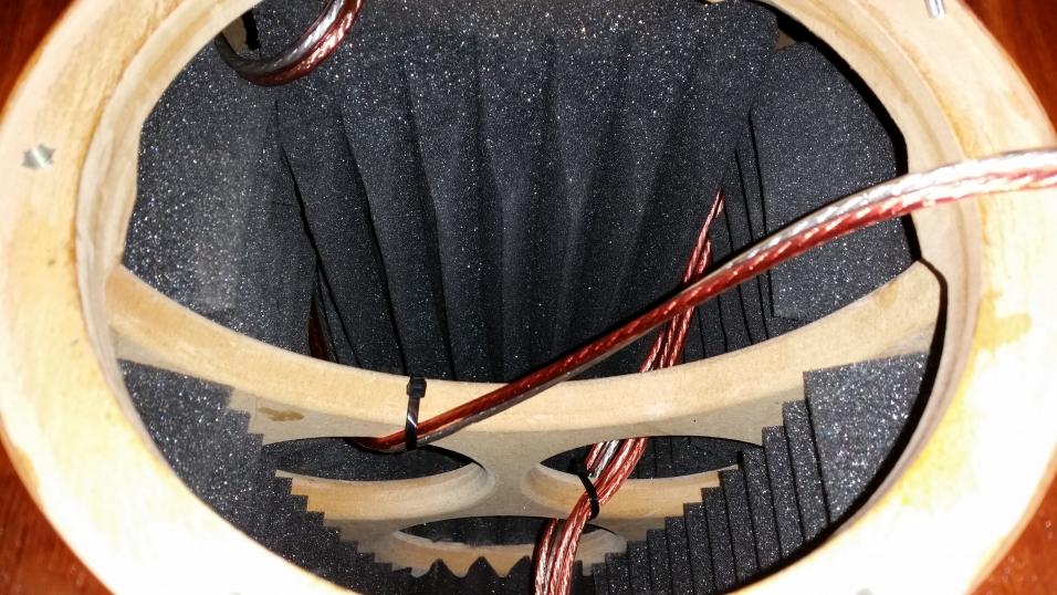

So on to the next part of the build. Foam, and wiring!

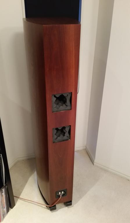

The foam was relatively straight forward. I used 2" wedge foam inside the woofer chambers with a kind of spray on contact cement. You can see how it turned out in some of the photos below.
I then used some 1" "egg crate" foam in the mid tunnels. I wanted to use flat foam but all i could find was designed for filters which was ridiculously expensive. Its not glued in just yet as i want to paint the tunnels black again before gluing it in.

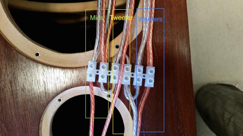

Since i started my build, i haven't found much info on how people have wired their speakers up. I wasn't too concerned about this part but i was still curious how others wired theirs. So i thought i'd post some info and pics of how i've wired mine.
If iv'e made any serious whoopsies with how i've done the wiring or crossovers please speak up! Any suggestions will be gratefully received!

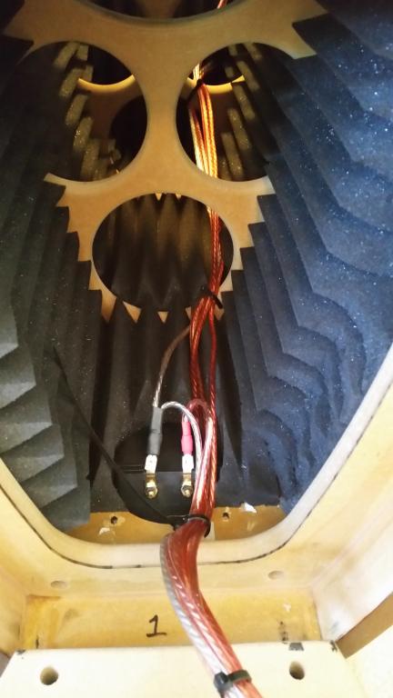

One thing i wasn't sure of was how to wire 5 drivers in to one crossover. After much thought i decided i wanted to use as little wire as possible. For this reason i've used a common ground wire running up the box from the crossover in the base plus one positive wire for the woofers, one for the mids and one for the tweeter. This means only four wires running up inside the box. These all run to a screw terminal mounted behind the tweeter and split into two for the woofers and two for the mids. I figure this will keep the signal path to each driver the same length. I don't know if having different lengths would affect the sound of the speakers but it helps me to sleep at night :lol:
This screw terminal is also where i reversed the polarity to the mids as per Curts crossover design.
The wires are all secured inside the box with cable ties
This photo is looking up through the bottom woofer hole.
All speaker wires are connected with crimp terminals colour coded (+ & -) with red and black heat shrink.
The signal wires come down through the box to the crossover with the ground wire connecting to the negative binding post on its way down to the crossover. There is also one short signal wire from the positive binding post to the input of the crossover.

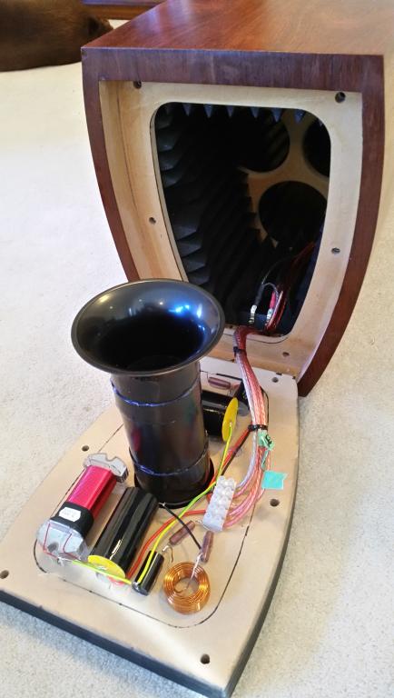

I also re built the crossovers onto the bases and i'm far happier with them now than i was when i originally built them on to hard board. They don't take up too much room but i trimmed the wedge foam around the base just in case the resistors get hot. I also left a bit of room between each resistor for heat dissipation. All components are secured with copious amounts of hot glue and the inductors are all mounted 90 degrees out of phase to each other.
Being mounted to the base also means they are easily removable should i need to do anything with them further down the line.
The only disadvantages i've found so far with doing the wiring like this is firstly, you have to be careful not to pinch the signal wires between the base and its mount as you install the base. Secondly, i'll wrap the wires in some thin foam or something so they don't rattle against the bass port. I'm not sure if they even make contact with the bass port but it can't hurt to do it anyway.
All in all i was really happy with the wiring and crossover layout.

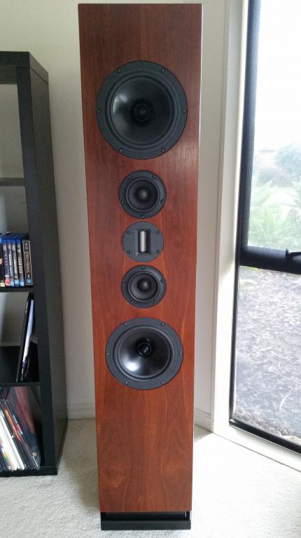

So thats pretty much it. I've had them both up and running all weekend and couldn't be happier with how they sound! I deliberately haven't posted pics of them just yet as i still have to paint one base black as well as painting behind all the drivers black. These are minor finishing touches but I will get this done in the next couple of days and post pics of the completed speakers then.
I think it's finally time to get a good 20 hrs of running-in time into them! I can't wait to test them out properly. I've got a good stash of music, movies and playstation games all just dying for a go on the statements.

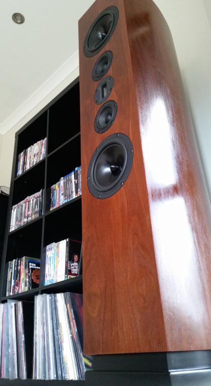

As promised, a final build post with the second base painted and all foam glued in. The speaker positioning is awful but it will have to do while i live at my friends place. Im looking to buy my first house and needless to say, a decent TV/speaker room is pretty high on the requirement list.
[ATTACH=CONFIG]23507[/ATTACH]
[ATTACH=CONFIG]23508[/ATTACH]
[ATTACH=CONFIG]23510[/ATTACH]
[ATTACH=CONFIG]23509[/ATTACH]

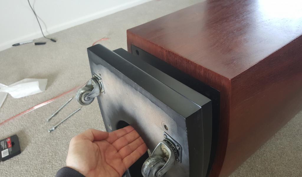

You said somewhere you made some temporary bases. They are no longer of use after the completion of the speakers? And if I'm not mistaken, the bottom plate (the piece with the port attached) is not glued, but screwed to the bottom brace? Isn't that a problem that there are gaps around the bottom piece because it's not glued?
Thanks, and sorry for lots of questions.- Bottom

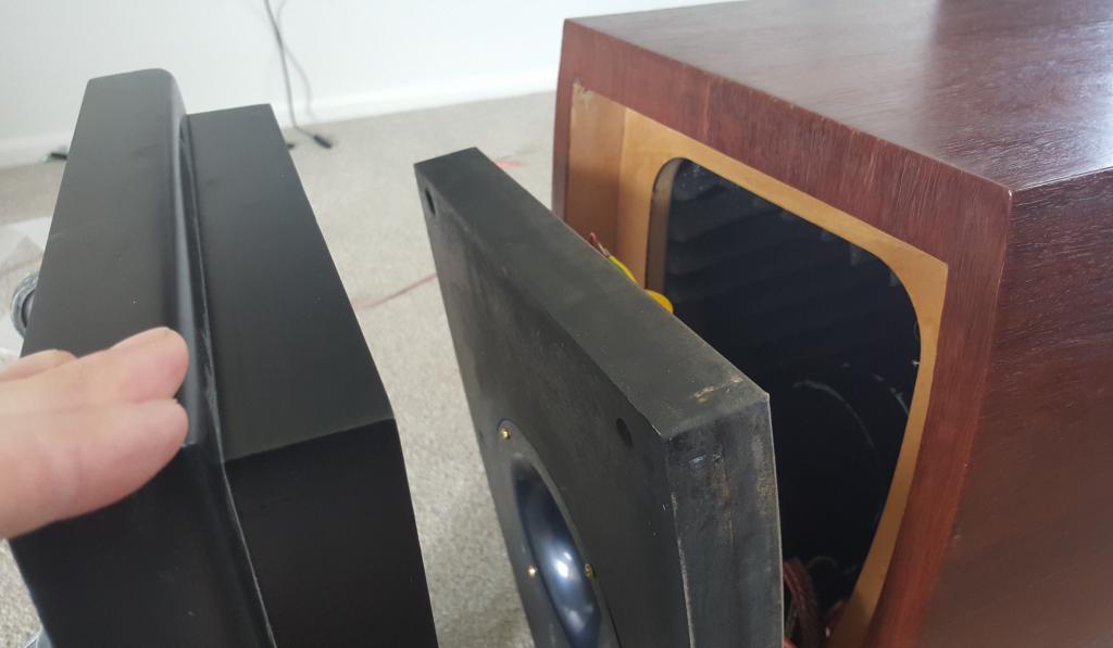

Hi Danwee. No problem at all. I asked lots of questions while building mine as well.
The pictures in post #5 kind of show the bases. If i get a chance ill try and take a couple of better photos for you today. They were meant to be temporary but with a lick of black spray paint, i actually quite like them!
The black parts with the wheels are all one piece and the part with the bass tube and crossovers attached is a seperate piece that slots into the bottom of the speaker. It sits up inside the bottom of the speaker and is flush with the bottom edge. The black wheely parts then attach to the bottom. They do not fit in to anything and essentially just sit there, held in by the 6 bolts. There are no gaps anyway and in fact, it is a very tight fit and they can be difficult to get apart.
I hope this explanation helps. Ill try to get some photos for you.- Bottom

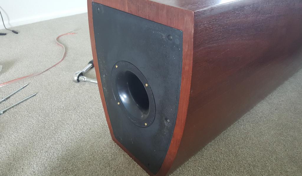

Apologies for the delay Danwee.
The photo in post #60 shows just the piece with the bass port attached. The actual base itself is not in the photo. Hopefully these pics will clear things up a bit.
Below is the order in which the pieces are bolted together.
Next photo is the bass port/crossover piece sitting flush with the bottom of the speaker.
Ive only painted the bottom face of this piece black as it may show once assembled. The top, with the crossover glued on, is still MDF yellow as in post #60.
The base is bolted on last.
I still haven't got around to painting the bottom of this part yet
and the wheels are proving to be very useful :P
I hope this helps
[ATTACH=CONFIG]24537[/ATTACH]
I hope this helps
[ATTACH=CONFIG]24538[/ATTACH]
