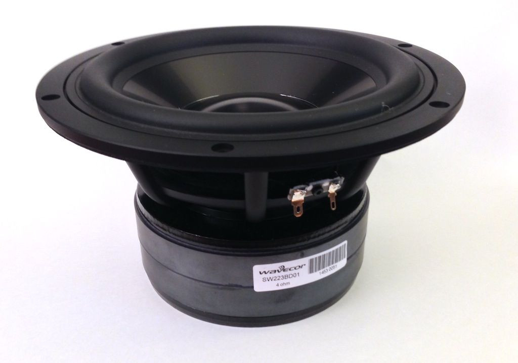

            This new variant, which we call the Wavecor Ardent, is getting a lot of "trickle down" technologies from the Isiris. (Hah! That's how we'd describe it if we were a boutique speaker manufacturer!) Two main items:
            One, that means much improved characteristics for the woofers (IMO), specifically higher Q 4 ohm units (higher being relative, i.e., 0.36 to 0.4 typical Qts), with substantially more Xmax and Sd, and a more linear motor to be used in a sealed enclosure of the same dimensions. (the midrange and tweeter will stay the same, the Accuton C79 for the midrange, and either a SS 6640 Be tweeter or 6600).
            The new woofer is the Wavecor SW223BD01, which is 8-3/4", not a 6-1/2" or near 7".

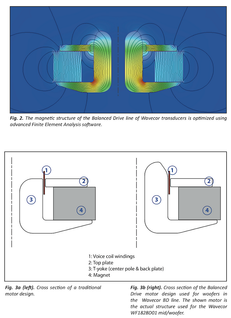

            It uses an improved motor structure from Wavecor, actually quite similar to what Accuton is doing on some new products, with their balanced drive pole piece configuration:
            This results in a more uniform inductivity and more uniform (symmetrical) driving force, which will lower HD2.

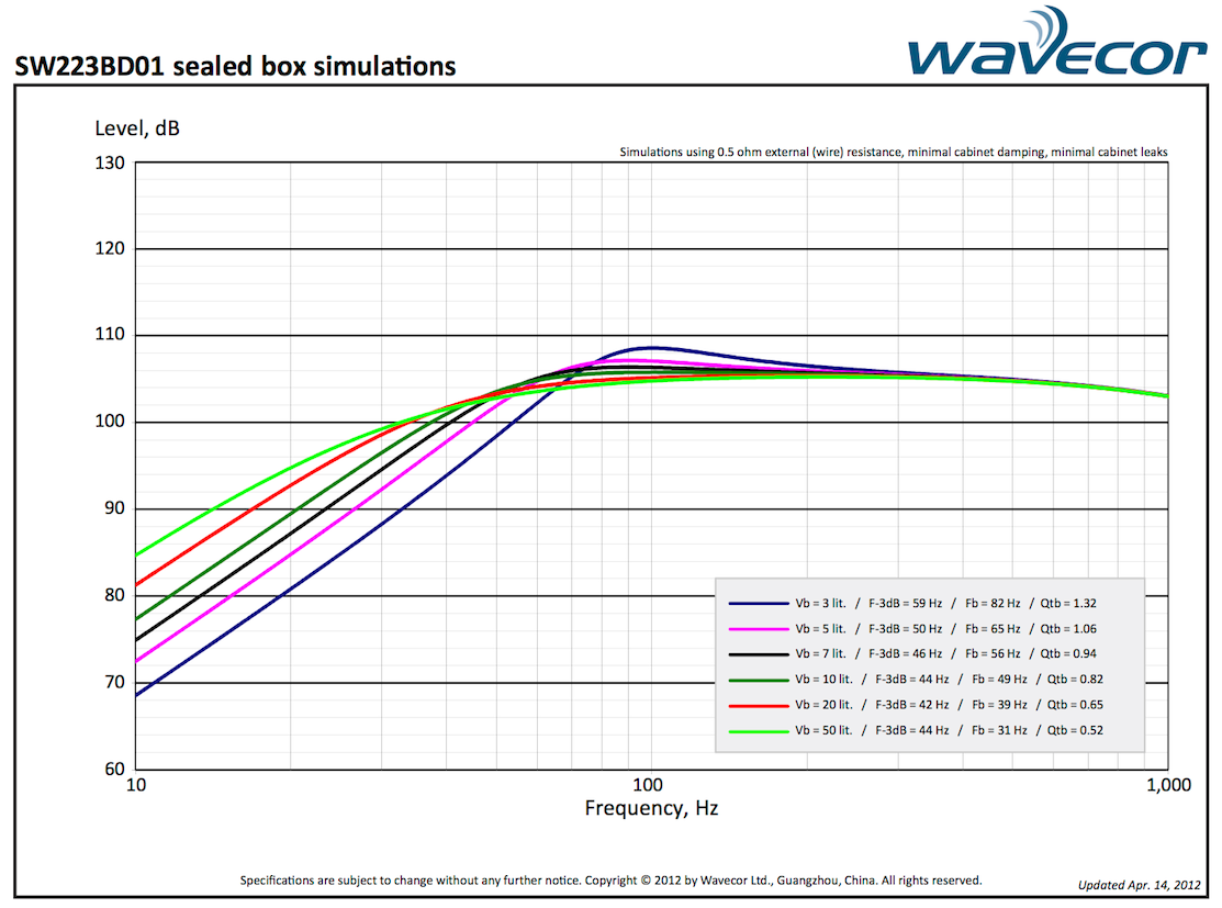

            Here are simulations from Wavecor for sealed operation- we'll be operating on the 20 liter line, the red one, with a total of 40 liters for two drivers.

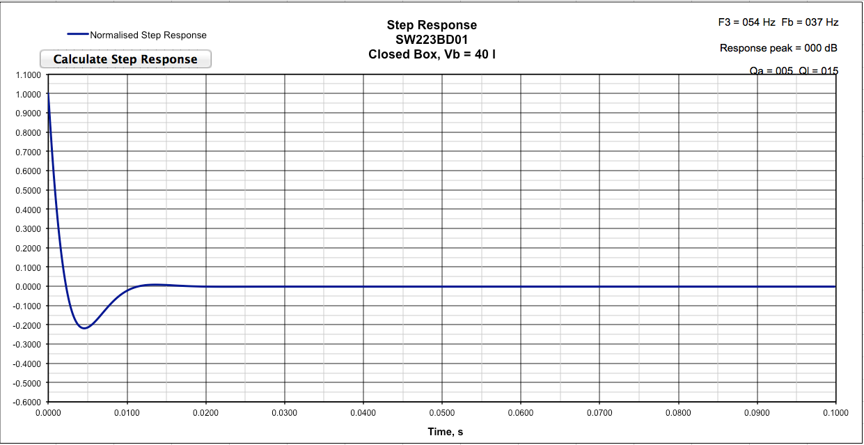

            With any reasonable in room boundary lift, they should be pretty much flat in room to 30 Hz. And will have excellent step response, with no ringing, unlike ported designs.

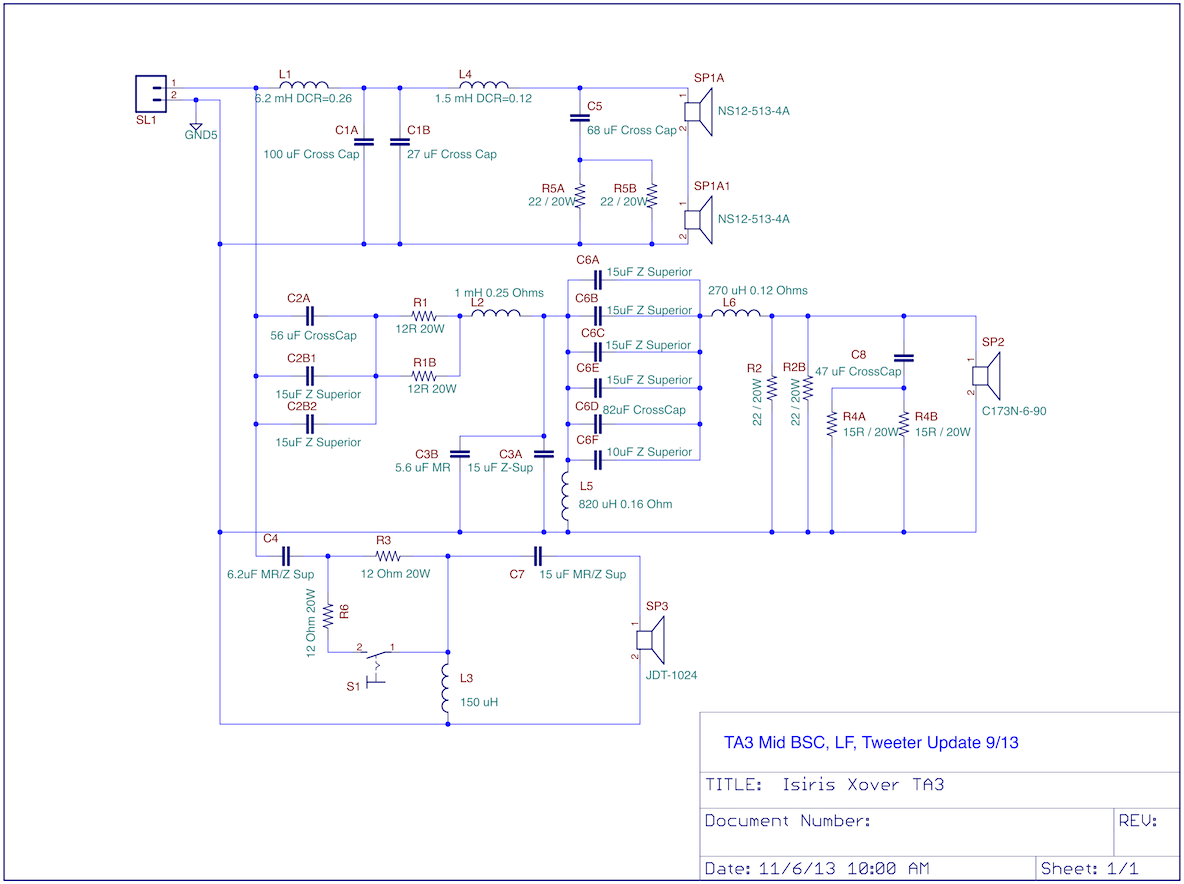

            The other area for significant work is the crossover, which if it tests out the way I expect, will be using concepts from the Isiris as regards the target transfer function- particularly to maintain and improve high performance while reducing component cost, compared with the Duelund network which I'm very fond of, but is difficult to realize with it's slow midrange slopes. The 2nd pass on the Isiris midrange crossover is in final wiring and should be in testing tomorrow. So, the current Isiris will likely be the starting point for the crossover:
            In my mind, this is THE Ardent design, as finally evolved and realized. Unfortunately, some things don't change- slow work takes time! I'm pretty excited though about this has evolved, and really looking forward to having these built.
            This thread will document the design and build process more completely as we go along, and I hope to figure out a way to provide some linked downloads for PDF documentation, including concept presentation.

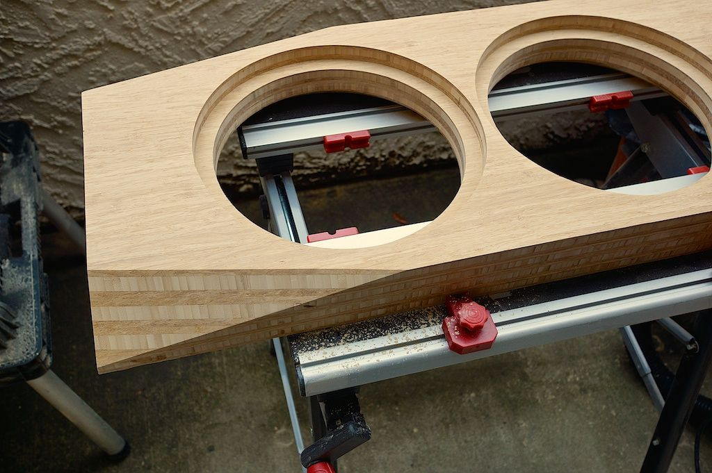

                          #102
                          I've got an NCORE 400 build in process I'll be trying out.
                          You have a build thread for this? Could be a good option to power these wavecor ardents.
                            • 16122
                            #103
                            No, not yet- I've been in the parts and component gathering phase, particularly chassis, which is about finished. One more order... Then I'll document everything when i start working. My best guess is after things get resolved at work regarding my current role (embedded at customer site 100%) versus preferred role by me and management. I.E., we have to hire someone. :W Starting Monday I'm back in the Cupertino grind.
                            • benthe8track
                              • 371
                              #104

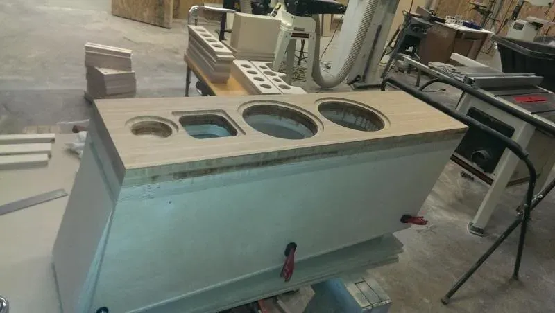

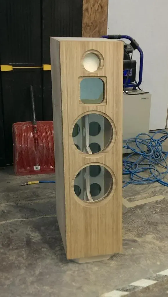

                              I'm looking forward to the updates!

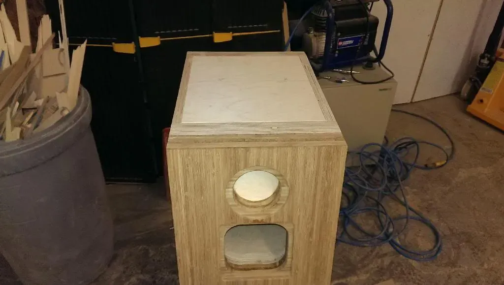

                              We test fit and made some minor tweeks on the table saw to line up one of the boxes today. I think if we did another iteration I could adjust the models so they slap together like lego. Other than a little adjustments they went together really well:
                              Ignore the top because it wasn't seated in this photo but we are pretty happy about how the parts fit together. We are waiting to hear back about the availability of a 14" panel saw to cut the facets on Monday. If that doesn't pan out I'll machine the fixture I made and well be CNCing the facets. The 10 degree cuts are finished on the baffles and were done on a sliding compound miter saw. It took a lot of measuring, adjusting and stop setting but they all turned out great:
                                • 16122
                                #105
                                Looks like everything will go together very smoothly. This is a nice stage in a project to see, where you can see that the planning and effort has paid off and there are some nice "boxes" in the pipeline!
                                Gonna have to go looking at some curly maple veneer soon, I think!
                                Now, a 14" panel saw... that's a serious saw, alright!
                                  #106
                                  Welcome to the new thread! this topic deserves it's own space; it's menthe8track's baby, with my assistance and participation, given that I proposed the idea a while back and have a lot of interest in it myself!
                                  Now, one of the advantages to the stiffer materials is that we don't need to layer up so much stuff to get good strength. I used this to good effect in the Isiris build (Three Way Design study for now, independent thread pending time and completing the last details of construction). In that system, I was able to reduce the front panel thickness from 4" to 3"- i'd propose doing that here also, as it increases the working enclosure volume for a given outside dimension, and reduces the tunnel effects for the mid woofers and midrange.

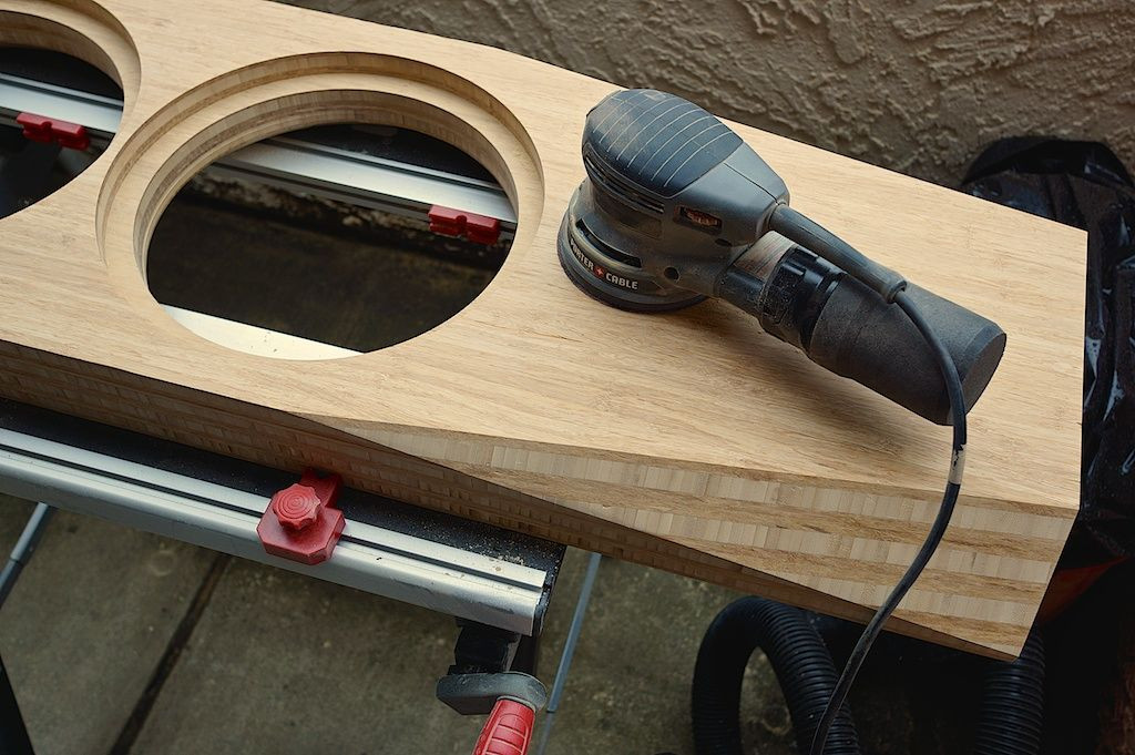

                                  In the original Ardent front panels I actually fabricated up the panels in two sections, as this facilitated the necessary bevel cuts on the front.
                                  Here are the original Ardent front panels after the two sections have been glued up:
                                  The main working section of the front panel was 2-3/4" in depth; this was the part cut with the bevels:
                                  Then it was glued up with the "back/inner" 1-1/2" panel section:
                                  One must be creative and work around the limitations of available tools...
                                  How do you fasten the elements to the baffle?
                                  From the pictures above, it seems like you are fastening the elements to just a couple of layers of wood, and that you have a wider cutout under that.
                                  Is that correct, or do you let the bolts go all the way trough the baffle? (I assume you don't used wooden scruves)
                                  benthe8track: what is your plan? Seems like you will let the bolts go all the way trough?
                                    • 16122
                                    #107
                                    You know what they say, Tek, never assume!
                                    There are many possible ways to skin the cat. You can get threaded inserts for which the holes must be pre-drilled into the baffle, then the insert threaded in, then the driver mounted with machine screw. I did do this with the midrange and tweeter, but largely decided it was a waste of time- more suited to MDF. You see, the bamboo panels are very stiff and dense- like hard rock maple. If you drill the right size pilot hole and use a type of screw such as metal drywall screws that cuts threads well, then the screw goes in very securely and is like tightening a bolt into an aluminum block- when it reaches the end of the possible travel, it stops hard. Because of this characteristic, I don't worry anymore about using high grade wood screws directly in to bamboo. It is very secure, and simpler to install. I buy high tensile strength screws from Rockeler wood working, which use square drive heads. Those were used exclusively in the Isiris.
                                      #108
                                      Ok, so with hard wood like bamboo you get a good result using wooden scruves.
                                      As the mechanic stress has to be highest on the woofers I assume that there is no reson to use anything else on the mid and tweeter. Thats for sure is an easier solution than threded inserts and "those that is self fastening on the backside but that I dont remember the name of" that I uses for my sub.
                                      • benthe8track
                                        • 371
                                        #109
                                        Yeah I was considering threaded inserts as well but for now all of the baffles will get an 1/8" pilot hole which is the correct for a number 10 wood screw. The socket head cap like wood screws from madisound could be a nice touch for the woofers without having to install inserts. Failing that you can still use inserts as the pilot holes will be here.
                                        They primarily engage on the bamboo, it depends how long you want your screws I guess, the will be exposed in the baltic if you wanted to use something crazy like a 2.5" screw.
                                        Hey Jon, what's the game plan for stuffing/carpeting? We picked up some dacron and carpet for the boxes but aren't sure how stuffed they should be.
                                          • 16122
                                          #110
                                          Well, you can fluff the dacron out a little, but not a lot- don't pack it in there to where it's compressing, but a occupying most of the space in the woofer and midrange cavity is appropriate.
                                            #111

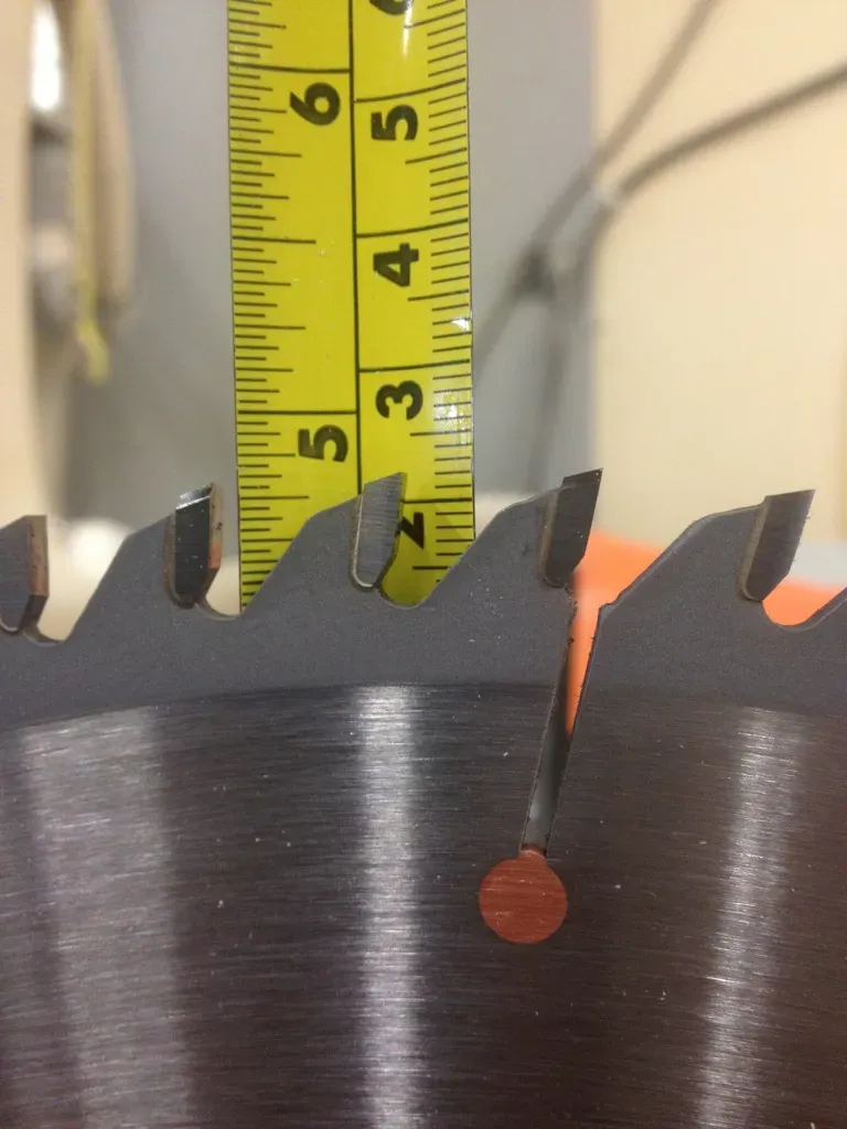

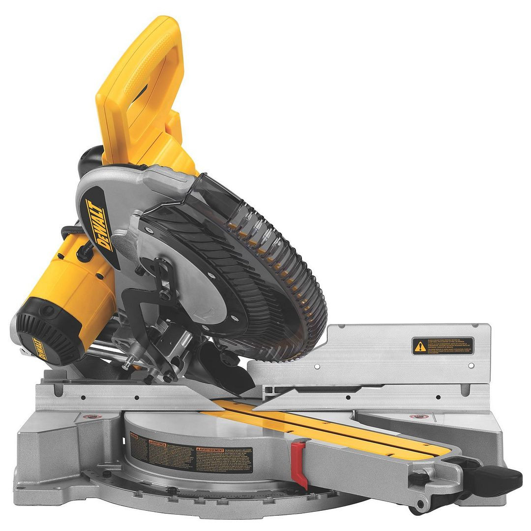

                                            Some thoughts for others using a wood working space not their own. Never assume any of the equipment is set up right. I thought I would do the 10 degree cuts on their little 30" Jet table saw but discovered the table was to narrow for the parts to crosscut with my Excalibur miter gauge. Someone alined the table slot to blade vary well or (factory setting was good) but the fence was badly alined and the distance marking were out by 1/8". I hated seeing young guys ripping with the a vary dull blade on the table and blowing breakers on soft wood. I switched blades when ever we needed the saw and cuts were easy, (not a bad little saw).
                                            We used their 12" Dewalt sliding compound saw to make the 11 1/4" 10 degree cuts. Again badly alined with a dull blade and sitting on a vary cheap shaky non Dewalt stand. I bought them a new 80 tooth blade and set the saw up and moved it to my saw horse table were it was clamped down. It's vary capable when set up stable. If you buy one get the Dewalt stand that is designed for the saw. I think we found it's limit with a 40 degree cut through 3" of bamboo and BB. though. I want to see the 14" panel saw in action!
                                              • 16122
                                              #112
                                              Setup and blades are critical, I fully agree. Though I'm not a skilled woodworker, (just a wires and sparks kind of guy) believe me I understand the importance of tools. Best money I spent on the Isiris project was that 12" DeWalt sliding compound saw I bought in 2012- the DWS780 has been super. First thing I did with it was toss the blade that came with it and bought a top of the line DeWalt blade for it.
                                              yeah, I expect that a 40 degree cut through 3" of bamboo and BB can be tricky- I was able to take care of my cutting goals with the Isiris, but JUST BARELY! And if I recall correctly, I used a few tricks, too...
                                                #113
                                                Not 45?
                                                • benthe8track
                                                  • 371
                                                  #114
                                                  Well 40 or 50 degrees, depending what surface you reference. We wanted a little more extreme looking geometry but now it's a pain in the ass haha.
                                                    • 16122
                                                    #115
                                                    Getting fancy is always a pain in the ass! :W
                                                    • benthe8track
                                                      • 371
                                                      #116

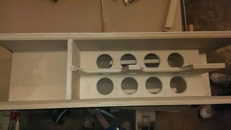

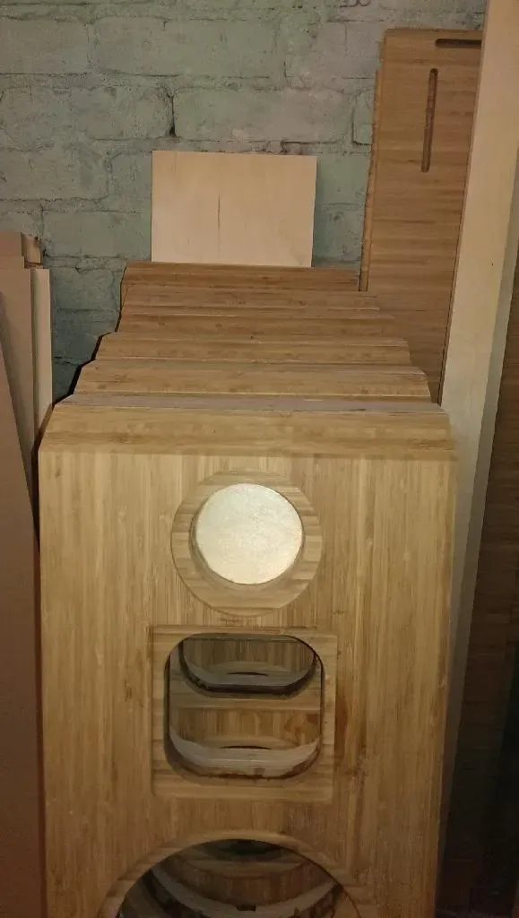

                                                      The past few days we have been assembling our boxes:

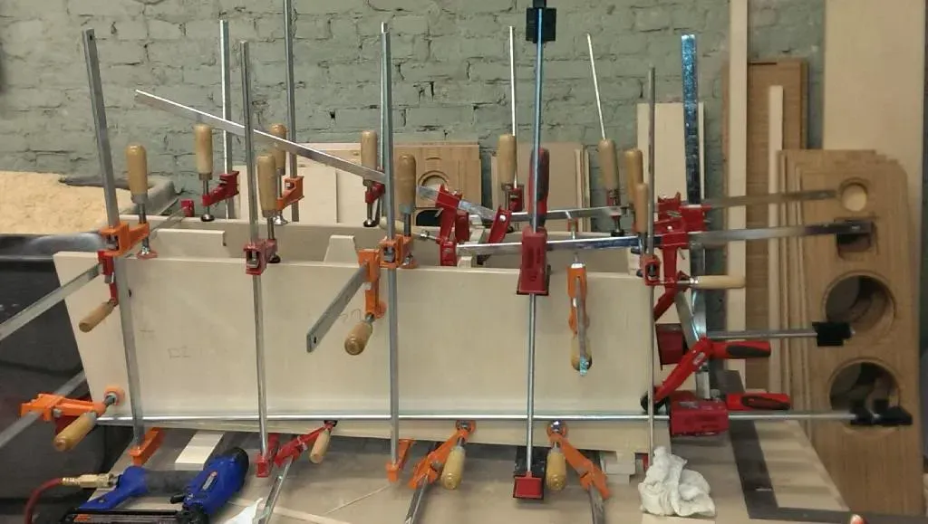

                                                      Lots o clamps:
                                                      They needed a little bit of adjustment the old fashioned way but the fit turned out pretty good:
                                                      We also found out tonight that we could do the 40 (or 50 degree depending who you talk to) cuts on the top just barely on the table saw:
                                                      Hopefully well hear back from the dude with the 14" panel saw before the weekend then we can mail a set to California early next week..and if this cold keeps up I might mail myself there.

                                                          Yeah 8 baffles, 6 full sets of parts and assembling 4 boxes. People in the space we are using keep asking if we are selling these haha.
                                                          Anyone on here vacuum bag an assembled box before? I have a vacuum source and have been toying with the idea of making a bag. Half of the stuff I've read on the subject suggest your box will be instantly crushed and the people who say they have done it don't provide many details. Most references I've found are on flat panels.
                                                              Click image for larger version  Name:	IMAG0158_zpsbixrpabw.webp Views:	22 Size:	39.7 KB ID:	934219
                                                              Lots o clamps:
                                                              Click image for larger version  Name:	IMAG0159_zpsl1tpnky5.webp Views:	21 Size:	53.3 KB ID:	934221
                                                              Click image for larger version  Name:	IMAG0160_zpsicvwfm9e.webp Views:	23 Size:	39.3 KB ID:	934220
                                                              Click image for larger version  Name:	IMAG0161_zpspblbhuqp.webp Views:	22 Size:	34.3 KB ID:	934218
                                                                It's usually done on flat panels- I've heard a couple of times of people using them on bigger items, but you have to be careful about the pressure or you tear the bag apart or crush your working item. 15 lb per square inch with a really hard vacuum. Of course, you don't need that much for veneering. I'm debating methods- I've had good results with the hot iron over cloth method, but also hear this contact cement is quite good, and I'm experienced doing good jobs with contact cement.
                                                                Top-rated Titan DX™ is a water-based contact cement that bonds wood veneer, leather, foam and more. Titan creates an instant and permanent bond to almost any porous material and is water resistant when dry.
                                                                Though ordinary PVA glue works pretty well with the iron on methods, this stuff is good:
                                                                Designed specifically for iron-on veneering - Heat Lock bonds raw and paper-backed veneers to wood, plywood, and more with an ordinary household clothes iron.

                                                                          Not much of an update but it looks like we are in business for the saw. No date set but I got this text yesterday:
                                                                          In anticipation, we cut out the parts for the jig this eve.
