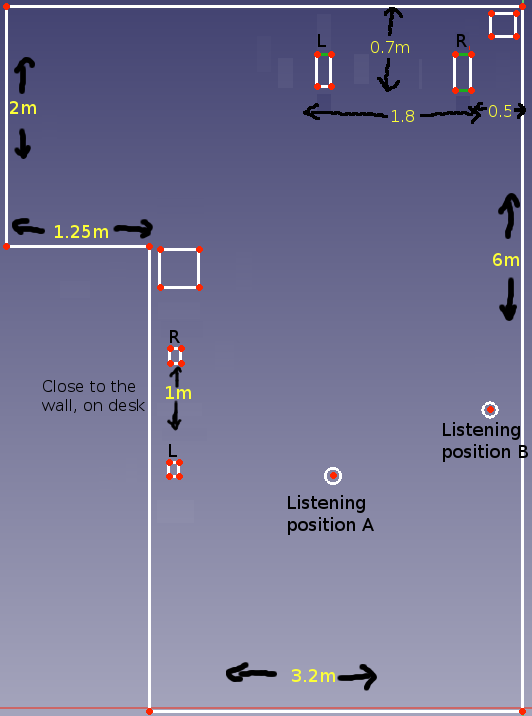

                            Thanks again Jim. Just so it'll be clear, I made a diagram to show the possible positions:
                            Click image for larger versionName:	room.pngViews:	1Size:	28.1 KBID:	858709
                            As you can see space is limited.. Position A looks more fitting acoustically. Unfortunately these are the best arrangements I could do which won't collide with furniture/wife.
                            Will the Finalists be a good choice? Reminder: It's purpose is music, high spl isn't necessary.
                              That helps to clarify what your positioning limitations are. Of the two placements, the one in the corner is far better based on the drawing.
                              The only difference placement wise between The Finalists and any other design is the necessity in open back mode of having breathing room behind the speaker (18"+ preferable) to sound their best. However, a flip of the switch, plug the mid tunnel and they can be positioned under 12" from the wall behind. The problem you're facing is distance between the speakers which applies to all speakers. I think the corner spot would work the best.
                              You might consider setting The Finalists on them stands that could be moved further apart and out into the room when you have some "personal" time and want to really do some serious listening. Regardless, the spot should work.

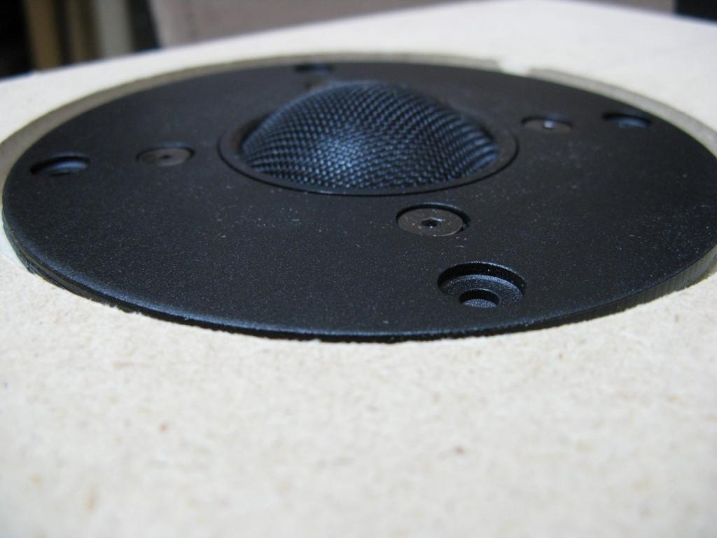

                                  Michael used RS28a tweeters rather than the speced RS28f. RS28a's roll off above 17k and offer a muted top end to my ears. I've never been a fan of the hard dome "A" series. However, the "F" series are a soft dome and have a slightly rising response on the top end that I think sounds much more realistic. I like them a lot. I'd suggest you go with the resistors as speced and see if you like it that way. I think you'll find them very balanced and "airy" with the speced resistor. It's very easy to change if you want more.
                                  • Finleyville
                                    • 350
                                    That is correct. I already owned the RS28a's and the RS225's shielded drivers instead of the specced RS28f's and the unshielded RS225's. The differences were that I needed an additional ~15 liters enclosure space for the woofers and I just figured out a small change in the crossover for MY tweeters. If you do not already own the older drivers like I did then do yourself a favor and purchase the kit as shown by Jim and Curt. My guess is that you will not need to change anything in that crossover. If I didn't already own 4 out of the 6 drivers (sorta) I would have just purchased the kit.

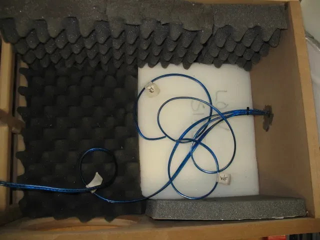

                                                        Another issue: I see it wasn't documented clearly, only that it should be "fine tuned". Should I stuff the entire cabinet with foam or as the kit arrived with only 1" around the mid tunnel and 2" on the walls of the woofer chamber?
                                                          Originally posted by Avalanche
                                                          Thanks Michael.
                                                          Michael's response was right on. :T

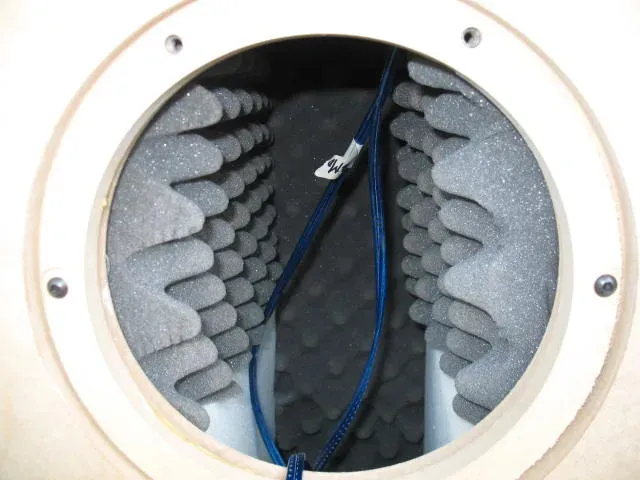

                                                          The mid tunnel gets the 1" foam and the 2" is for the woofer chamber. Hold back from the inside of the front baffle about 1 1/2" - 2" for the foam in the woofer cavity. The mid tunnel can be to taste and room. I found in my room that I preferred to have the foam cut to 6 1/2" and beveled on the driver end with the foam flushed with the back of the cabinet. So, there's only foam in the back 1/2 of the mid tunnel.
                                                          HTH
                                                            Could you please word this sentence in a different way so I can understand better?

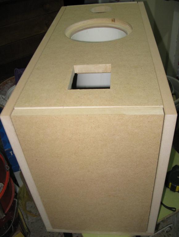

                                                            I ended up foaming the whole lower woofer enclosure, every side. I cut the foam just a little proud on all sides. So when I stuffed the area the foam "smushes" against itself, and I do not need to use glue to have the pieces stay in place.
                                                            This picture is a shot of me test fitting the foam with the enclosure on its one side with the other side still needing to be attached.

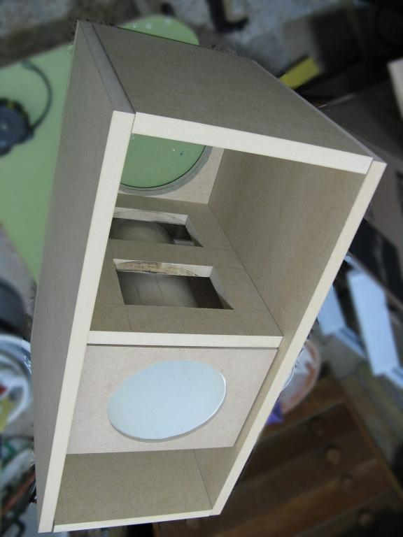

                                                            This is a picture of the glued up enclosure after I stuffed the foam in the woofer cutout hole.

                                                            • Finleyville
                                                              • 350
                                                              That is what makes this hobby so much DIY fun!
                                                              In the current house where my speakers currently reside, they sound best with the mid tunnel 1" foam totally removed and instead stuffed with acousticfil. (1/2 lb I think?) However, when I get to actually bring them home I will play with the foam and fill so they sound best in my area.

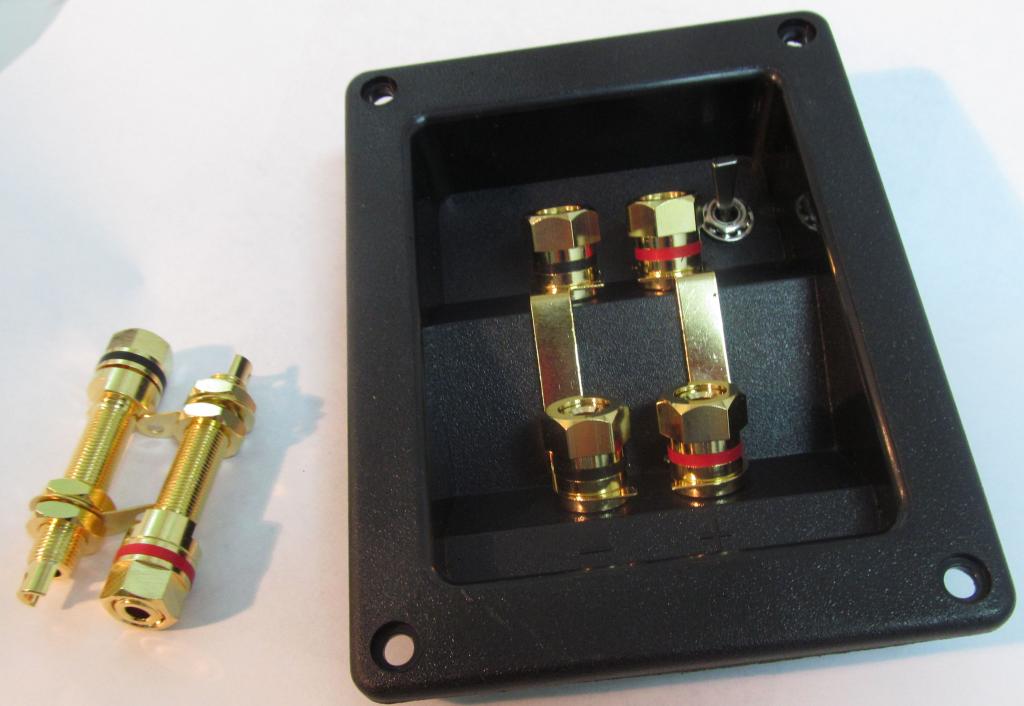

                                                                These connectors came with the kit. Which is the preferable method? You can see in the photo I already punched a hole and screwed the switch...
                                                                Click image for larger versionName:	connectors2.jpgViews:	1Size:	63.5 KBID:	858755

                                                                  Hi Michael,
                                                                  If it was me, I'd trim the foam back a bit from the driver. Too much of any kind of damping material tends to suck the life out of bass, IMHO. I like to keep it away from the driver but still keep sound waves from bouncing back into the driver.
                                                                    You're plate looks very good to me. I have a different plate but did it exactly as you have. It works really well.
                                                                    • Finleyville
                                                                      • 350
                                                                      Plus you have the option of bi-wiring them in the future. In fact, it may make the connections to the x-over a little easier. You can wire the lower posts just to the woofer circuit and the top to the switch topology. If I ever have my amp modified to bi-amp I will do just this.
                                                                        I may have to try that. When I had the foam in the mid tunnel I positioned it with the chamfered side toward the driver and the back end of the foam flush with the rear of the tunnel. The mids still sounded "a bit" restricted. That is why we went with the polyfil solution. When I get these back I will try with the foam again. If it still sounds restricted then I will try trimming the rear part of the foam first.

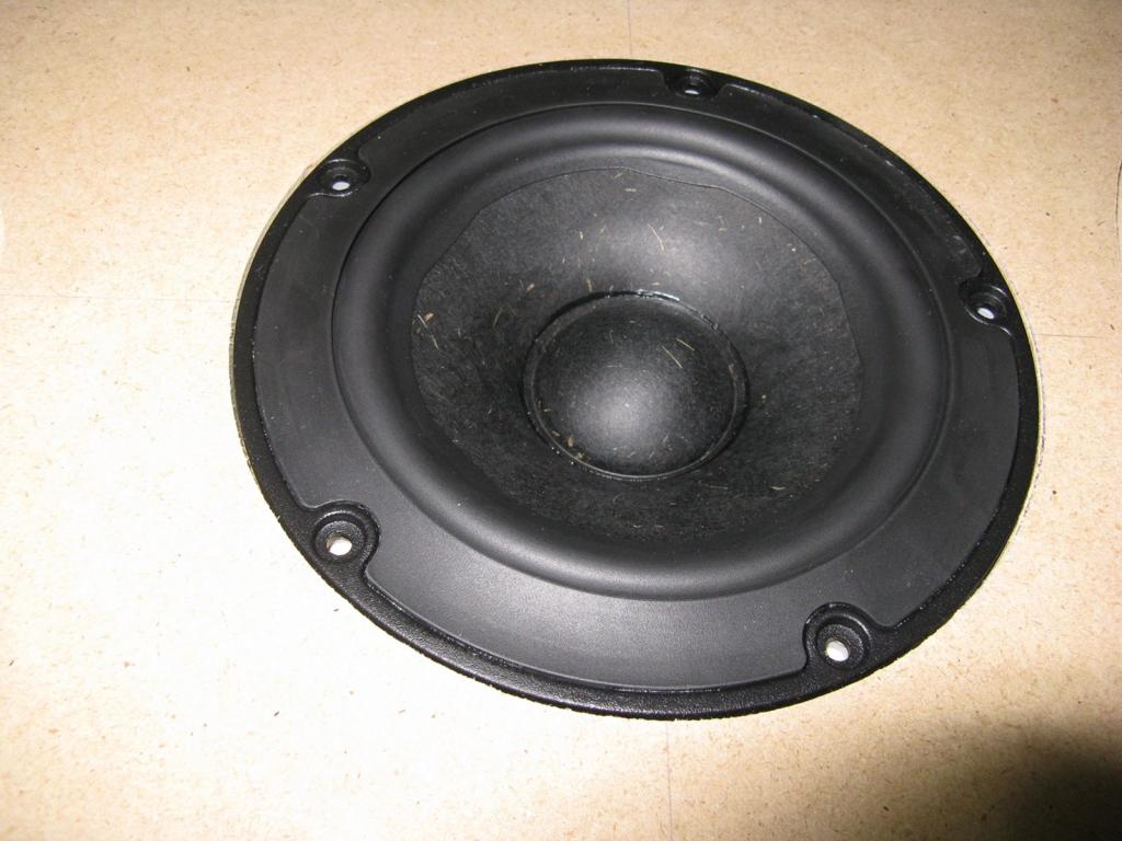

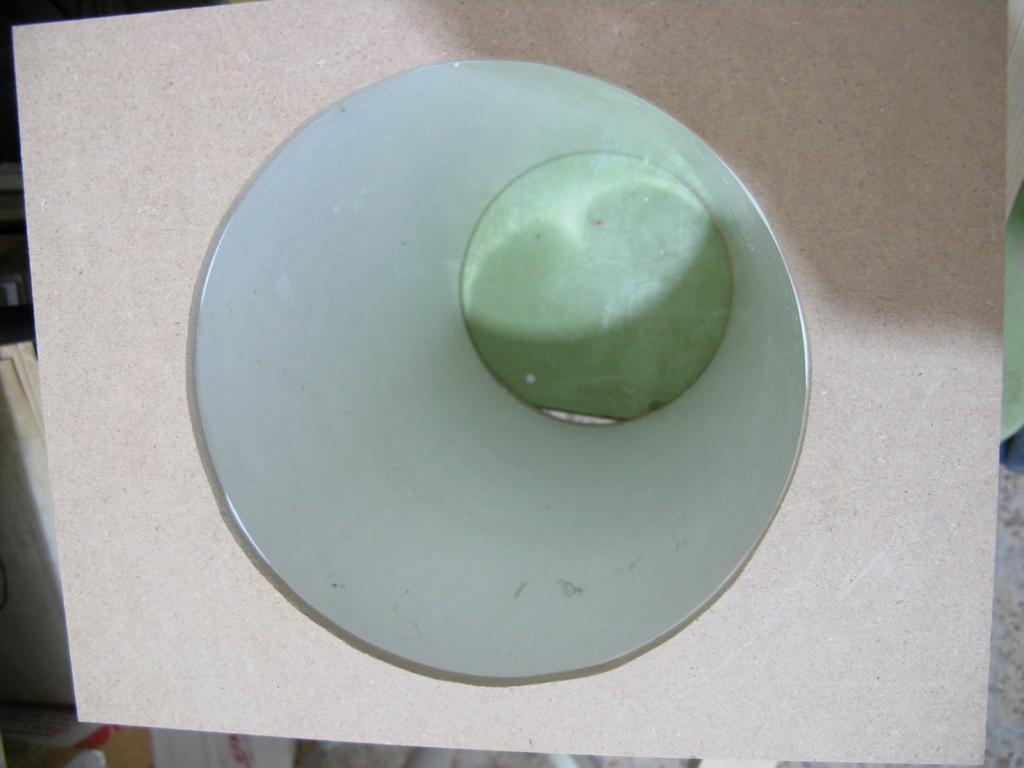

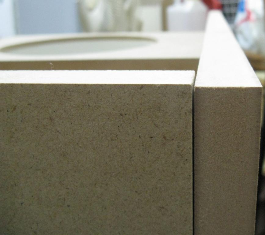

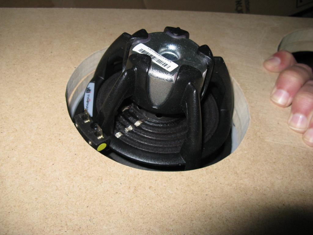

                                                                          I got the boards from the carpenter. Will it be OK to use screw? It sounds easier to drill holes the use screws to fasten the boards after applying glue on the sides.
                                                                          As you can see in the pics the holes inside aren't perfect circles as he used a jigsaw to cut them and rotor only for the holes on the face of the panel. There's still a gap remaining between the driver and the circle as you can see, which leaves little area for the gasket to seal (that's even after I changed the original diagram for tighter...).
                                                                          Does the tweeter hole needs bevel? I used two 3/4" mdf boards for the front. Will it create problems with tunnelling or sharp bevelling will suffice?
                                                                          The boards don't match perfectly so I fear it won't be perfect tight seal when I assemble them... this is harder than I thought.

                                                                            The MDF is pretty soft and crumbles easily. It already has some blemishes just from checking how the drivers fit. Maybe it should be treated around the area where it'll hold the driver?
                                                                            Will 4 X #8 screws will be enough on top and bottom and 8 on front and back?
                                                                            By the way, the back panel also has a recess around the port and I'm not sure why that is needed...

                                                                              OK, here are my opinions. I would not use screws if you can avoid it. A clamped glued joint is much stronger and seals. You can also use latex/silicone caulk inside on the seams if there are gaps. The panels need to be fitted so they match and mate up properly if you want to end up with a cabinet that can have some type of finish applied to it. The mid and woofer cutouts definitely need to be beveled or rounded over on the inside of the baffle to eliminate any chance of tunneling.
                                                                              Honestly, if it were me and I'd paid for the work, I'd take it all back and tell them to either re-cut it properly or make the existing panels fit so you have a cabinet that can be finished when you're done.
                                                                              One other thought. The recesses for the tweeters are too deep. They can be built up with foam window/door insulation available from a home store to bring the drivers level with the cabinet surface. A little bit of recess isn't a big deal but not that much.
                                                                              • Avalanche
                                                                                • Sep 2013
                                                                                • 36
                                                                                OK, I'll glue it together. I see it fits almost 100% when clamped. The only panel which doesn't is 1mm longer is the upper and lower panels which protrude to the back.
                                                                                1. Will it be alright to sand it after the cabinet is done?
                                                                                2. Will it be alright to glue everything but the back panel in one go, including gluing with silicon the mid tube? I see no harm in sealing the edges in silicone as well just to be sure.
                                                                                3. Will 3 clamps to hold together the side panels suffice?
                                                                                4. Now this is something I missed when I took the measurements of the drivers before I ordered the cuts. The gasket in the woofer won't cover more than 2mm when seated against the recess (see photo, woofer on right). Will the recess need treatment for better sealing?
                                                                                Thanks for the feedback Jim.

                                                                                  • 3815
                                                                                  It looks as though the tweeter holes were cut way too big. Jim was referring to the depth of the recess. The actual diameter of the hole also looks way too big. Your red arrow in the tweeter above is the flange which is already accounted for in your measurements (assuming you measured all the way across the speaker, including the flanges. If it's not up to the measurements I'd definitely get them to redo it.
                                                                                  -Chuck
                                                                                    Sure, sanding the edges flush is part of the building process for me anyway. I'm not a cabinet building authority for sure. :-)
                                                                                    I think it'll be very hard to glue the cabinet in one shot and you'd definitely need more than 3 clamps. The silicone isn't for the edges. It's for the seams inside the cabinet after is glued up to seal it if necessary. I think 2mm will be ok if you have enough cabinet to let the screws attach securely.
                                                                                    Good luck!

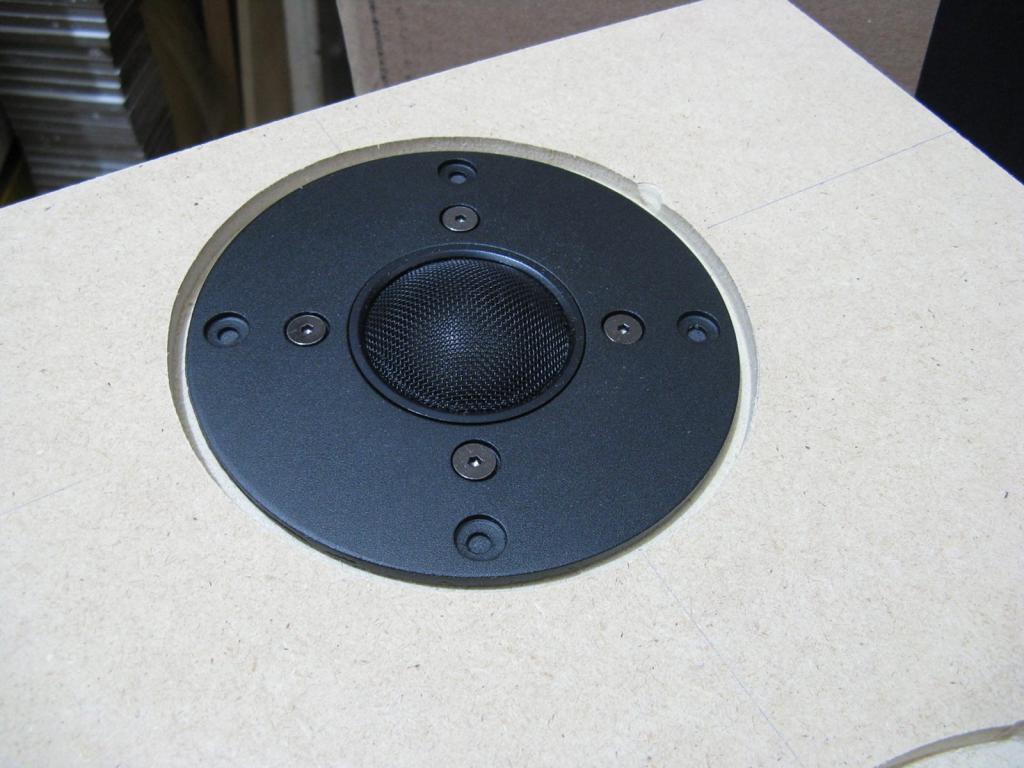

                                                                                    • Avalanche
                                                                                      • Sep 2013
                                                                                      • 36

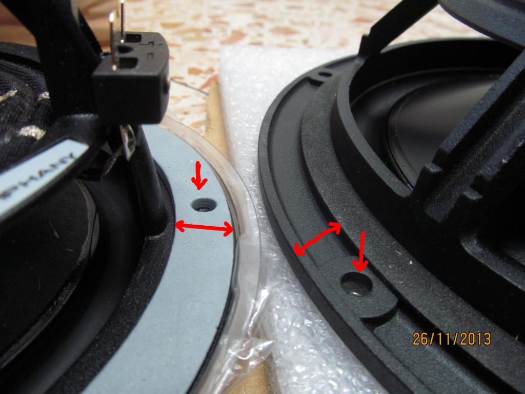

                                                                                      EDIT: I should have taken more careful measurements. Looks like the driver holes are too big and will have to be redone. Should I redo the inner panel of the baffle or can it stay bigger, what will leave a step?
                                                                                      Will it be detrimental acoustically if it's 0.1" wider in diameter?
                                                                                      I changed the original Finalist cabinet diagram to smaller holes after I saw the drivers were smaller... I don't understand why they were that big in the original diagram.
                                                                                      Should I redo the inside panel of the front baffle as well if I'll redo the outside one with the roughly 0.1-0.2" smaller holes?
                                                                                      The driver recess cuts aren't very smooth. Shall I glue or treat them somehow for better seal?
                                                                                        • 3815
                                                                                        I don't believe the gap would affect the sound (Jim please correct me if I'm wrong), but you want to make sure there's still enough width to drill your screw holes to attach the driver.

                                                                                        • Avalanche
                                                                                          • Sep 2013
                                                                                          • 36
                                                                                          I goolged this:
                                                                                          Be sure to flush mount all of the drivers. Not doing so will cause small spikes in the frequency response produced directly in front of the speaker. For that matter, any protrusions on the surface of the speaker box can produce these spikes in frequency response.
                                                                                          Help with constructing your speaker box properly - using the right parts, bracing, sealing...
                                                                                          It looks more or less flush but it doesn't say anything about how tight the circle should be.
                                                                                          EDIT: OK I ordered a new front panel.
