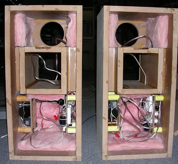

    I messed up when I bought the foam (6 months ago). I only bought enough for two tunnels...duh!!!! So I cut the foam and lined one tunnel on each speaker.
    The local fabric store has the 1" foam in 15" x 17" pieces, which is a perfect size. One sheet per tunnel, with almost no waste material (yeah, I'm one of those eco-friendly guys). The only down-side is having to walk into a fabric store again...I truly feel out of place there!
    Don't forget to bevel the driver end of the foam at 45 degrees and hold the foam back from the front baffle about 1 1/2" - 2".
      Yup. I cut the foam 45 degrees, and gave the mids some room. Before I started on this Statement build, I read the entire Mission Accomplished thread and took notes. That was very helpful.
        Jim, is the 1 1/2 - 2" significant? I have the 45 degree beveled end all the way forward.
          It's easy enough to test, if your ears are sensitive enough (mine probably aren't!). Pull your foam out 2" (that sounds dirty, doesn't it) and see if if makes a difference. At least your foam is too long. It can easily be trimmed.
            What am I listening for? Increased clarity. I'm not sure my ears are good enough either, but with all the time and effort I've put into these, I want the very best possible sound. I started my Statement Center channel build this weekend, so quality home theater here I come.

              I suspect you will find the midrange and lower treble will become more 'alive' when you move the foam back. Find the best compromise for you over several listening sessions and differring souce material. Start out at 2" and tweak from there. The 'extra' foam hanging out the back will have no effect.

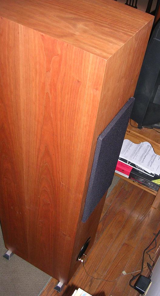

                      Before I built my Statements, I read just about every build thread here. I don't recall seeing any Statements with grills (I think I saw Jim H's Mini Statements with grills), so I thought I'd post pictures of mine. They are nothing fancy, just basic rectangles. I kind of like the look (although I like the look of no grills, too, which is why I used magnets for retaining the front grills).

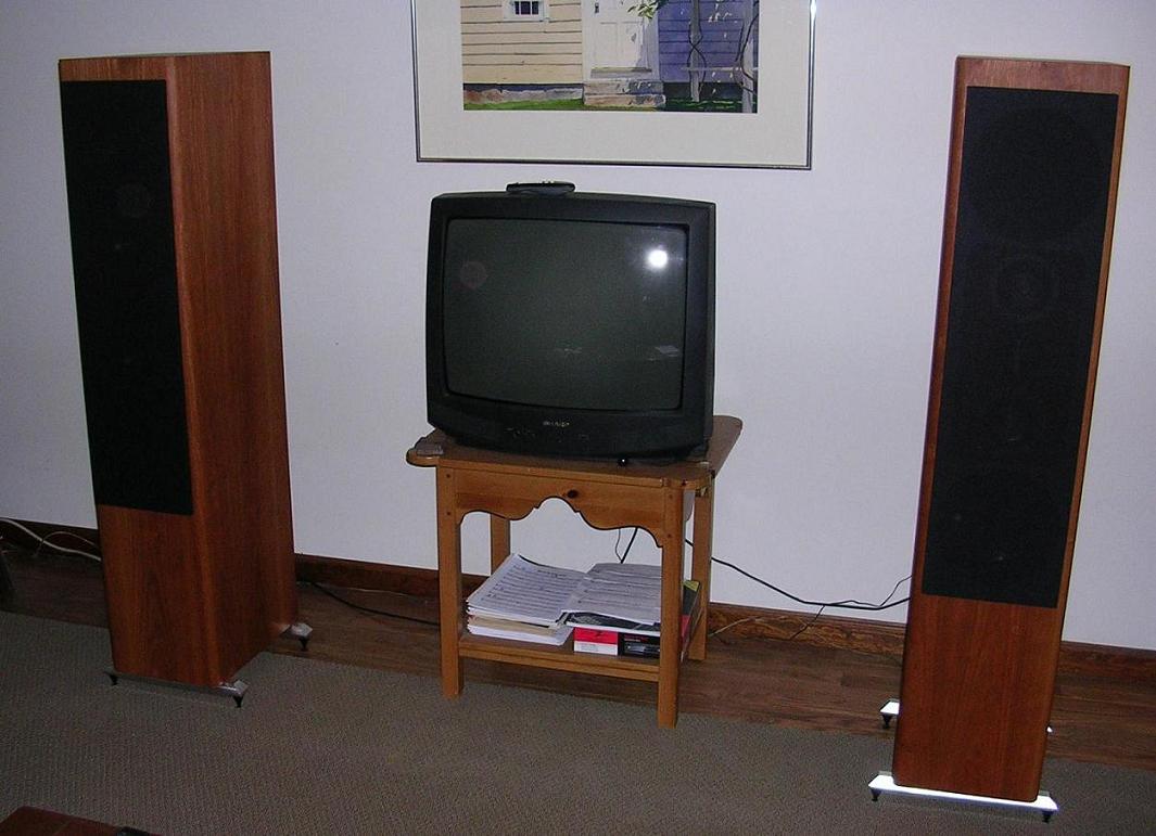

                      It's been about five weeks since the last tung oil coating, and they are finally fully dried!!!!!
Name:	statement rear grill.JPG
Name:	statement front grill (reduced).JPG

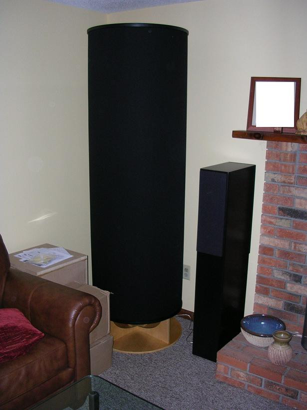

                                            Statements Part II
                                            Well, I'm getting carried away with this hobby. Back in Feb. I started to make some Statement Monitors and a CC using the leftover MDF I had laying around the basement. Progress has been slow, but I've bought almost all of the drivers, the crossovers are built, and it's time to get serious and finish these.
                                            I bought an Onkyo TX-SR707, and I'm also building a huge sonosub (http://techtalk.parts-express.com/sh...d.php?t=217880) to go with this system. I've never even heard/listened to a 5.1 system, but soon I'll have one to try out!
                                            I apologize to anyone who has read my thread and been disappointed by not being able to see the pictures. The site where I had my photos uploaded was hacked, and not functioning for 5 weeks. Everything from 2009 was lost. I've finally updated my build thread with the photos.

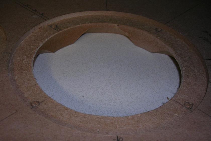

                                              #112

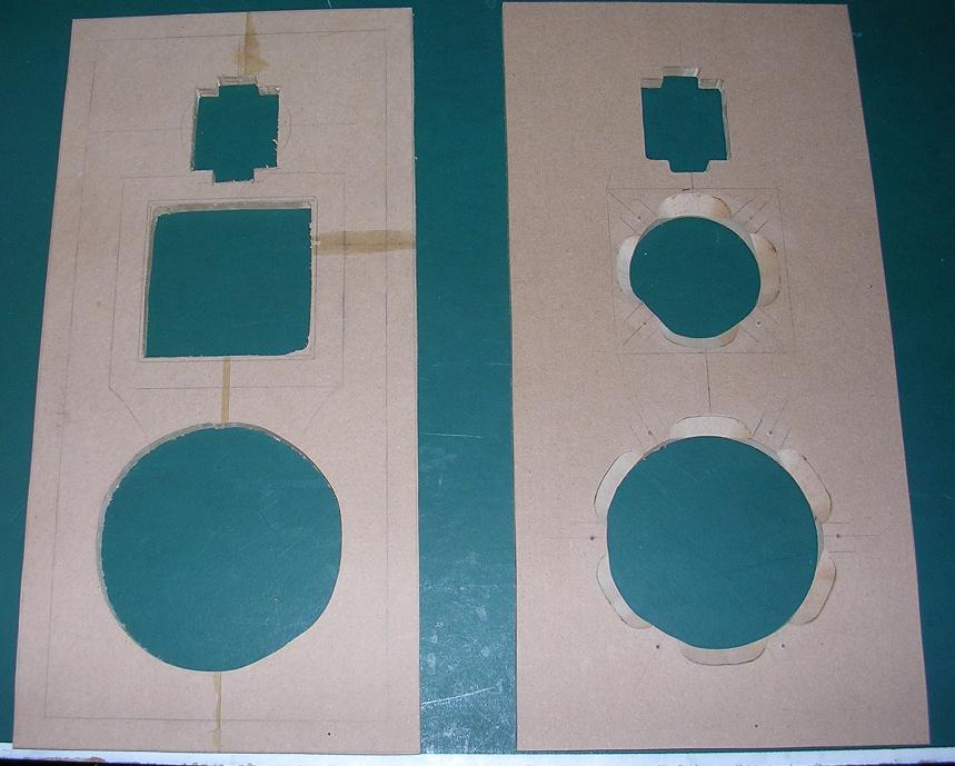

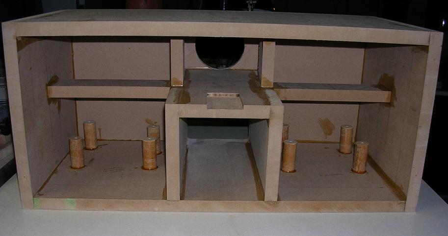

                                              Here are some photos that show how I build the baffles. I keep the 1/2" and 3/4" pieces separate until they are complete and ready to be glued to the rest of the cabinet. I use short sections of bicycle spokes (2 per cabinet) as pins to position the baffle pieces. That way I can very accurately position them on the cabinet for fitting/marking, then remove them and do the necessary cuts. Keeping the 2 baffle pieces separate also allows me to make some pretty large back-cuts on the inside, for good driver air flow.
                                              I first take both baffles pieces and line them up on the cabinet to drill the pin holes. Then from the rear of the tunnel,I reach through the tunnel and mark the 5" square on the back side of the 1/2" baffle with a pencil. On the baffles, I use this 5" square to make all of my relative measurements for cutting all of the holes on the baffle. I drill 1/8" holes in the centers of each driver.
                                              I cut the 3/4" baffle first. Rebates (counterbores), then through holes. Then I cut the chamfers. I go out almost to the 5" square for the mid, and cut the same amount for the woofer. It leaves less than 1/8" near the rebate. I use the chamfers to mark the circular hole on the 1/2" baffle (which is not very circular in this photo...I had to do things in a rush this morning, as it is now raining!).
                                              On the 1/2" baffle, I rough cut the 5" cutout, and flush cut it when it is finally glued to the cabinet.
                                              1/2" baffle on the left.........................3/4" baffle on right

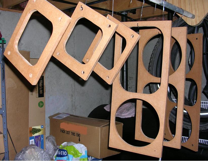

                                                Here is a detailed photo of the midrange chamfer on the 3/4" thick baffle. I don't leave much material near where the driver flange will be.
Name:	Mid chamfer baffle.jpg

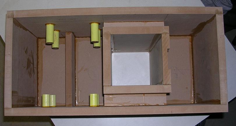

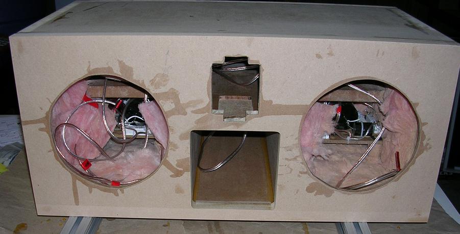

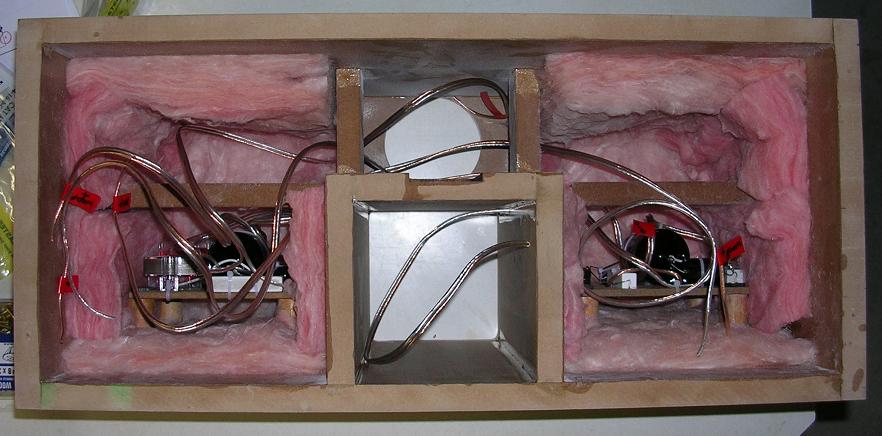

                                                  #114
                                                  Crossover photos are already posted; https://www.htguide.com/forum/showpo...3&postcount=13
                                                  I used broken broom/rake handles for the crossover standoffs. Good hard wood, cheap.
Name:	Monitor cabinet, no baffle.jpg
Name:	CC cabinet, no baffle.jpg

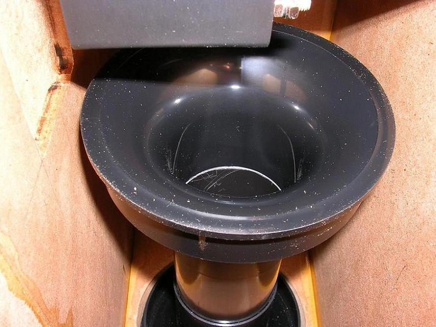

                                                      I've read quite a few Statement Monitor threads, but I've never seen this question:
                                                      Would the port function better if it was offset to the side a few inches in the Statement Monitors?
                                                      The inner flare of the port is only 1.13" from the rear side of the Fountek tweeter (if I did my math correctly), which seems like it would restrict the airflow characteristics of the port. I've heard Beerparty's Monitors, and the bass sounded really nice, so maybe I'm just being a little too analytical. But maybe the low end could improve by moving the port?

                                                        #117
                                                        Thats an interesting question. I haven't put the port in yet on my Monitors so I too am interested in the answer.
                                                        • Curt C
                                                          • 792
                                                          #118
                                                          To the best of my knowledge, while the port proximity to the ribbon has never caused any audible issues, I see no problem with offsetting the port if you'd like.
                                                          In addition, one could add another layer of MDF to the rear baffle around the port flare, and gain another three quarters of an inch of spacing between the port flare and the ribbon.
                                                          Curt's Speaker Design Works

                                                            #119
                                                            Curt, thanks for the quick response.
                                                            Unfortunately, I cut the port holes this past weekend. Then yesterday I thought about the proximity of the port and tweeter (too late!).
                                                            I haven't cut the port tubes yet. When I do, I'll install the ports and see how much the tweeter blocks the port. I haven't glued the baffle on yet, so I'll be able to mock this up and still see inside the upper area of the enclosure. If I can get a good photo, I'll post it.
                                                            I doubt it's worth filling my port holes so I could move them to the side a few inches, but every rule of thumb I've read about porting says to keep the port clear at least the diameter of the port tube (I have to look at the Loudspeaker Cookbook and see if any tests were done). I would think the flare helps flow a bit in the Monitors. At the low sound levels I usually listen, the 'plug' of air oscillating in the port will probably have such a low amplitude that it won't make a difference.
                                                            My plan is to use these for surrounds, and I have a sub, so any improvement down around 35Hz won't matter much for me (unless I use these for a 2-channel arrangement some day, which is a possiblity...that's part of the reason I'm building the switchable crossover). Also, if this could help other builders to improve the porting, that'd be great.
                                                            Again, I've heard Beerparty's Statement Monitors, and the sound is superb. I doubt shifting the port a bit would improve things to where I would even notice.

                                                                #121

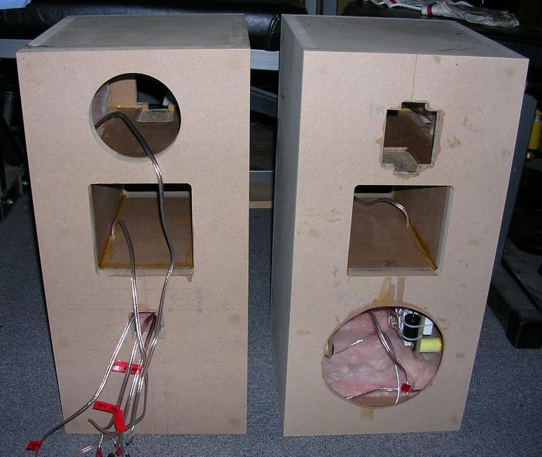

                                                                I cut my port tubes (3" long tube, 8" overall length with the flares attached) and assembled a port. After installing it in a Monitor enclosure (without a baffle attached), I used a bunch of business cards and some thin MDF pieces to position the Fountek tweeter to within 0.010" of where it will be in the final assembly.
                                                                There is PLENTY of room around the port. Just going by the measurement of 1.13" doesn't work. The area/volume around the port is very open. The tweeter isn't very wide (compared to the flare), and it's not lined up directly in the way of the port (it's a little lower in the cabinet...closer to the mid tunnel). I guess it's not optimum, according to what I've read about port clearances, but it's fine for me (because I don't want to fill/move the port hole)
                                                                So...if you're REALLY picky (and I'm not saying this in a bad way...I'm usually very picky), the port can be moved. Based on this quick set up, I'm leaving mine where Jim's dimensions place it. It should be fine. If I hadn't already cut the port hole, I would cut mine a few inches to either side to optimize the port.
                                                                Click image for larger version  Name:	port clearance in Monitor.jpg Views:	2194 Size:	96.4 KB ID:	855093
                                                                Edit: No progress on the build, but just a thought...as a test, when the enclosures are finished, the port can be mounted outside of the cabinet to see if there is any airflow restriction caused by the tweeter (wouldn't that look nice!). There would be a slight increase to the enclosure volume (which would lower the Qtc, so that might offset the extra output of an unrestricted port). The enclosure volume can be kept the same by placing a 'dummy volume' equal to the port volume in the cabinet.

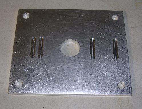

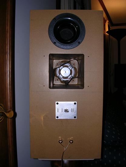

                                                                  A lot has happened in the last few days. I got laid off on Friday due to lack of money and work at my company. Fortunately, I machined my switch plates a few weeks ago. I'd be pretty disappointed if I hadn't made these switch plates. I will no longer have access to a milling machine, which has me really sad (sadder than losing the job...I feel really free right now. Truly enjoying life!).
Name:	switch plate.jpg
                                                                  Get the symbols?...near and far.

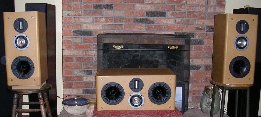

                                                                    The 1/2" baffles are glued to the cabinets and this morning I flush trimmed the outer edges and the tunnel. Later I'll glue the 3/4" baffle, trim it, then chamfer the edges, and sand the chamfer into a roundover.
                                                                    The 1/2" baffles were made from scrap MDF, glued together to make larger boards. I'm amazed at how tough the joint is where 2 boards are glued end to end. All of the joints will be hidden underneath the 3/4" baffle anyway.
                                                                    The stains on the baffles are from Seal Coat, used to seal the inside of the cabinets.

                                                                        Unfortunately, this means I'll still be staring at a tube TV when I get this 5.1 sound system done.
                                                                        I love being outdoors, so being laid off in August is like a gift. Last time I was laid off in Nov...a bit too cold, but I still made the best of it. The hard part is all my friends work, so I have no one to play with during the daytime.

                                                                                Done for now! I hooked these up to an ancient receiver and let 'em rip. No surprises. I've already heard BeerParty's Statement Monitors, so I know they sound just as nice as the full-sized ones. I can hardly wait to hear all 5 Statements plus my Monster Sonosub all together.
Name:	monitors and CC test listening.jpg
                                                                                I just have to finish the grills (no rush), get a DVD player, connect the Monitors, CC and Sonosub up to my AV receiver, and enjoy.
                                                                                I've never seen the rear of a CC, but here's mine with a warning: be careful where you position the binding posts. Mine seemed fine, until it was time to assemble the whole thing. The crossover got in the way of my access to the binding posts inside the cabinet, so I did some last minute plugging of the old holes with 1/4" dowels and drilled some new holes to relocate the binding posts. That was much easier than removing the crossover to get to the binding posts (the horizontal brace really gets in the way...I probably should have planned the crossover position better, but I'll probably never have to remove it anyway).
