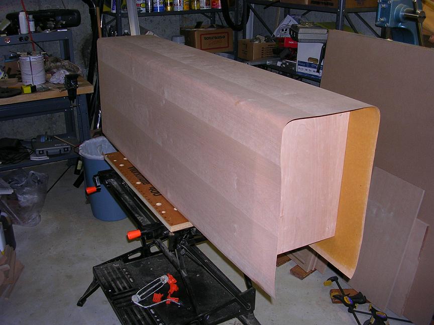

    Today my plan was to cover the front and sides of one of my Statements with a monstrous 4' x 5' sheet of veneer. I really should have tried my first veneer job on some book shelf speakers! I was quite nervous.
    There were a few blemishes on the veneer. I wanted to do a dry fit to align most of the bad spots either off the speaker, or in one of the driver cutouts. When I dry fit the veneer, I could hear some splitting as it curved loosely over the 3/4" radius of the baffle. I thought I was going to have a mess on my hands. I did some web-research on softening the veneer, but decided against it. It's paper-backed, so it shouldn't need it.
    I coated the speaker cabinet and veneer with glue (a pretty thick coating, so my edges wouldn't come loose this time). I figured I might as well go through with it, and hope any splitting would be minimal. The glue on the veneer took 4 hours to fully dry (it was accelerated in the last hour by a halogen lamp warming it). I may have use a little too much glue!
    I ironed the veneer onto the cabinet. No splitting. I waited 2 hours for the glue to cure, then I checked for loose edges. One TINY area. I was within the reactivation time of the glue, so I just gave it a little ironing.
    I felt pretty intimidated by the huge sheet of veneer, and the possibility of splitting, but the process went really smoothly. I think the heat from the iron helped bend the veneer around the roundover without splitting. I'll try the other cabinet tomorrow...hopefully I'll have the same success.

      Congrats John!
      That is a monster chunk of veneer. I'm glad you feel it went well.
      I also found that the heat of the iron & the moisture of the glue helped the laminate bend around the radii.

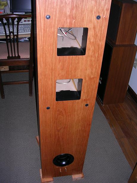

        Here is a picture from last night. Yeah, I forgot to mention that the moisture from the glue did seem to soften the veneer a bit, as well as the heat from the iron. I glued up Forum this morning...hopefully it goes as well as yesterday!
Name:	veneer statement.jpg
        This thing is very awkward to move now that most of the good holes have been covered.

              I positioned my Statements on some large, 3" thick catalogs (Newark and Digikey!), to allow the veneer to clear the edges. Kind of sketchy!
              I'm going to iron my second speaker after lunch today, in about an hour.
              I am using cherry veneer. I've decided to use pure tung oil to finish mine. I've done some samples, and it's really easy to apply, and leaves a nice, waterproof finish. It does take a long time to dry (it actually oxidizes, I guess), but it's pretty much fool-proof, which is perfect for me.

                                          3rd coat of tung oil...still wet in this photo. The outriggers are completed, but I'll keep ya'll waitin' until these Statements are totally finished.

                                                So far I've done two coats of 1:1 tung oil:mineral spirits, followed by three coats of pure (undiluted) tung oil.
                                                I'm going to do two more coats of tung oil, and that should be it. The speakers look better and better with each coat, but I would think seven coats total should be more than enough.
                                                It's now 24 hours from when I coated them last...I'm sitting at work, and I can still smell tung oil. To me it smells similar to peanut butter. It must soak into my system when I'm applying it! I'm not sure if that's the reason I have a headache right now.
                                                I plan on having these assembled by Thanksgiving so I can show them off when everyone arrives for the feast.

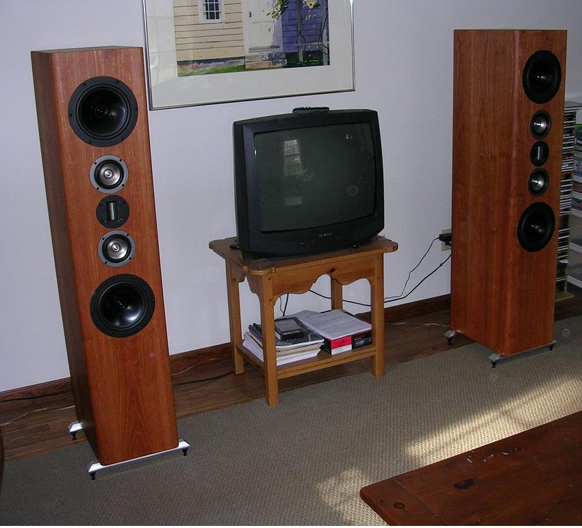

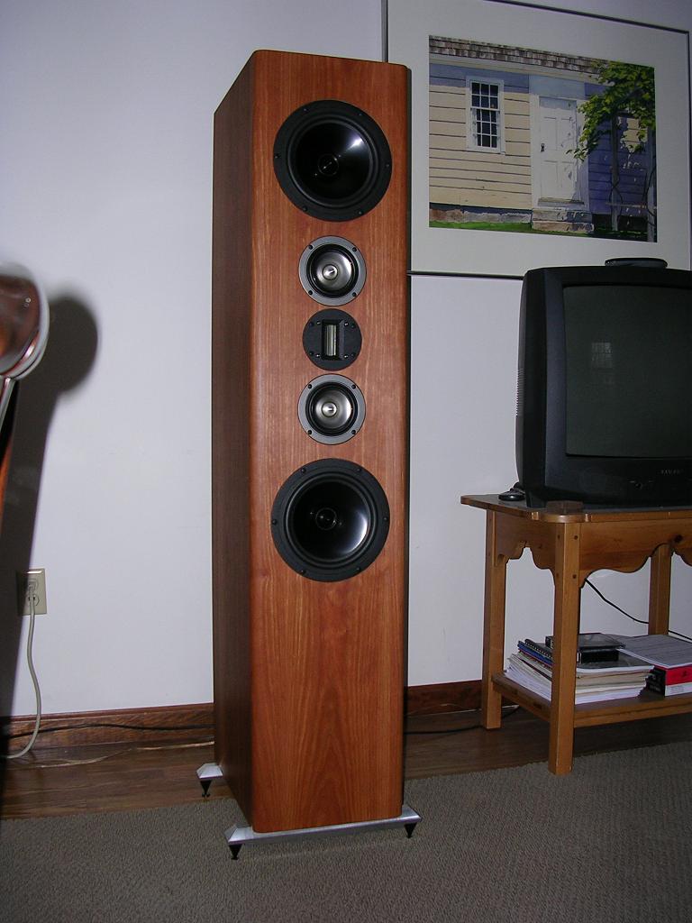

                                                    Update:
                                                    This weekend I applied the last coat of tung oil to the cabinets (it's either coat Special or 7...I lost count). It should be dry by Thanksgiving, so my plan is to finally install the drivers next week some time. I'm really getting addicted to the smell of tung oil. I may have to leave a small jar of it open in my basement!
                                                    It's been raining/cold each weekend for about 7 weeks here in CT. This weekend was no different, except yesterday afternoon, the sun came out and it got to be about 65F. I finally got to use my paint booth. It's made from solid maple, and has a really nice ventilation system.

                                                                              I finished my Statements yesterday. The tung oil was still a little slippery, but it should dry sometime! I had to wash my hands frequently, or I'd risk dropping a driver or something. I managed to complete it without any mishaps...I'm very relieved. I'm a bit sad to be finished, as now I have to find a new project to keep me out of trouble. BUT, I am glad to have them finished, because my JBL MTs were having a hard time trying to reproduce music while my Statements were being completed. I just have to say it one more time: THESE STATEMENTS SOUND SO NICE!!!!!!!!!!!!!!
                                                                              I press fit the ports together. They didn't seem to need adhesive. I captured some grill cloth, to keep out the spiders (Oh no! What's going to happen to the low frequencies now :lol: ). Sealed the ports and drivers with weatherstripping, and screwed it all together.
Name:	statement ports reduced.jpg
                                                                              I don't know why, but I still haven't cut the foam. It's probably one of the easiest parts of the project. I'll do it some rainy day when I'm bored.
Name:	Statement rear photo reduced.jpg
                                                                              Outriggers!
Name:	statement left speaker reduced.jpg
                                                                              Don't you just love my TV...how 70's. Vintage tubes, man! Actually, I don't even have the TV hooked up to the sound system, so the Statements are just for music.
Name:	statement pair reduced.jpg

                                                                              • jyqureshi
                                                                                • 141
                                                                                Looking great!
                                                                                Just wait till you put the foam in the mid tunnels
                                                                                  Beautiful job! :T
                                                                                  I agree that the foam makes a huge difference to the midrange.

                                                                                      John they look great! A long wait, but worth it! Are the outriggers made of wood and painted? How soon will the grills be done and on?
                                                                                      • john trials
                                                                                        • 449
                                                                                        The outriggers are machined from aluminum. They probably add about 15 pounds to each speaker. They are solid hexagonal bars, with cuts at each end for mounting the pointed feet (which I bought from Parts Express). I am very fortunate to have a milling machine where I work, so I could make these outriggers for very little cost. They probably would look better if the aluminum was anodized to match the feet, but then the surface finish would have to match, too, and that would be expensive, so I left them bare aluminum.
