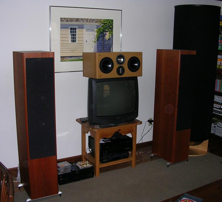

                                              who needs shielded drivers any more??????
                                              I'm glad I bought the RS180S before they were gone. Eventually I'd like to arrange the CC under the TV (actually, eventually I'd like to have a flat screen LCD!), but I still haven't wired up all of the speakers yet. I just thought the photo was funny, with the current elimination of shielded RS drivers.

                                                Looks like a great picture to start a caption contest with.
                                                Or a good children's book. (Which object doesn't belong?)
                                                :B

                                                          I love the picture above! I would carry this picture around and when you get the "what gives you the biggest impact from home theater, audio or video"? Wham, whip out the picture....nuf said.
                                                          It has always made me chuckle when someone is showing me their system that they spent $10k on the video and about $500 on a complete sound system. And then proceed to ask, what do you think? I suppose everyone has their own ideas as to how to spend the money.

                                                              I have four direct neighbors who have huge LCD TVs, and listen through the TV's speakers. I'm the exact opposite. 20 year old CRT with a kick-a** sound system. Once I get an LCD, I can at least invite friends over for a movie. Right now it'd be embarrassing!
                                                                  John,
                                                                  Forget the LCD, move the left speaker to the left and project a 100" image on that white wall in between!
                                                                  • john trials
                                                                    • 449
                                                                    #168
                                                                    Originally posted by sawdust
                                                                    John,
                                                                    http://www.amazon.com/Epson-PowerLit...0546198&sr=8-1
                                                                    Ha! That's about twice my budget (I'm still unemployed, so I'm kind of having a hard time justifying an LCD TV, but I'm calling it a Xmas gift for the family, and everything I've read/heard mention that LCD prices have never been this good). Plus, if I had a projector, I'd have to pull the shades all the time and deal with the smell!!
                                                                    • john trials
                                                                      • 449
                                                                      #169
                                                                      I don't know, I think you might get a better looking image if you finally finish that center channel (hint, hint, nudge, nudge)... :
                                                                      Also, the Monitors are unfinished. :P
                                                                      My full-sized Statements ended up a lot darker than I wanted. I'm thinking of veneering the CC and/or the Monitors in maple (or some other lighter shade wood). I'm not sure if that would look strange having the CC and surrounds veneered in different woods...but probably not as strange as having them unfinished. My plan is to finish them in the summer. Warmer weather for veneering and finishing...and I watch fewer movies when the weather is warm outside, so I won't miss the speakers while they are taken out of the system.
