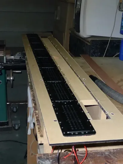

          Here is my Saturday afternoon report.
          This sure is tedious, but worth it! I only have 24 more holes to drill, tap, body drill, and then I should be ready to 'polyurethane caulk' the Neo3's in place.

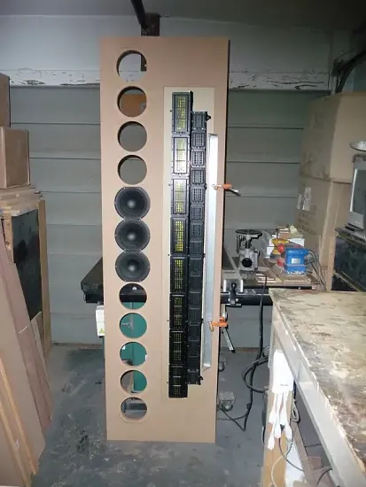

              OK, I am at the point of no return. Here is a shot of the Neo3 array loaded and clamped, ready to be glued, caulked, or what ever. Looks like it will work ok. I will have to take it apart one more time to get rid of the masking that will need to be removed before I commit to the adhering process.
                #322
                Looking good... :T
                You'll be all practiced up so you can build mine when you're out for the RMAF... :B

                    Looks good Chuck! Are you gluing the actual drivers to the plexiglass, or gluing the plexiglass to the MDF baffle? I thought you were gluing the plexiglass to the baffle, and screw mounting the drivers to the plexiglass. I mean what if a driver broke? Just the way you worded that, "point of no return" sounds kind of final.
                    John unk:
                    • chasw98
                      • 1360
                      #325

                      When I'm practiced up? I do have another side to do! Please explain how well you treat your slaves? Or should I just ask Jon?
                      If I go through with using the polyurethane caulk, the drivers wil be glued to the plexi. But apparently the caulk is flexible and can be cut away if a driver needs to be replaced. The Neo8's are screw mounted and the Neo3's will, in all likelihood, be glued. Yep, that's why I said point of no return.
                      Actually I was kind of hoping this post would generate some feedback so I could ascertain if I was following the right path. I still have to go and buy the polyurethane caulk so I am not totally committed yet.

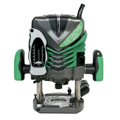

                                                          Yeah, they "Nike'd" it, in a manner of speaking. Originally you could pick them up for about $180 to $200, sometimes better, and they are built like an absolute tank- I have two of the older ones- haven't ever tried the new one.

                                                          New version: M12V2

                                                          Of course, my first reaction is that it's just styled for a younger generation, with the same motor underneath, but it does have dust collection built into the base, and possibly some refinements to the height adjustment... but I DO NOT need to be buying more routers at this time!! :W
                                                          It's a weakness I have- for some men it's gambling, for others, it's loose women; for me, it's routers.
                                                          Probably works just as well, knowing them- the Hitachi sliding compound miter saw I have is very well made and works quite well- sometimes I joke with Thomas that if I could get "Hitachi Car" and "Hitachi Motorcycle" and "Hitachi Girlfriend" I'd go all Hitachi. :W There tools are generally very well made in my experience.

                                                            The new Hitachi looks like it was designed for a new cartoony sci-fi Transformers type movie :lol:
                                                                You took the words right out of my mouth!

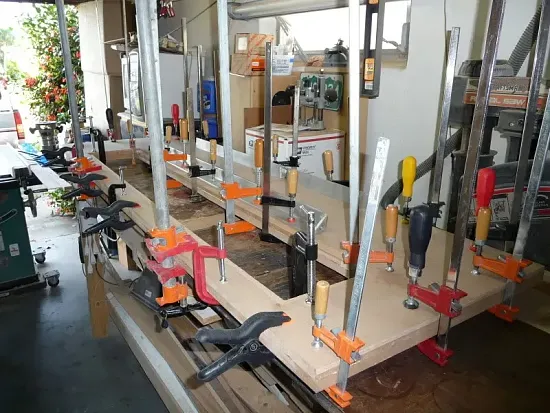

                                                                You know, I've got a few clamps, too.... when this picture was taken, there was another panel similarly clamped up at the same time...
                                                                :B
                                                                Yeah, you know the old saying- he who dies with the most clamps and routers wins...

                                                                    New version: M12V2
                                                                    Click image for larger version  Name:	519CHVMG92L._SS500_.jpg Views:	0 Size:	45.3 KB ID:	936973
                                                                    I didn't know that Alienware made routers! :T

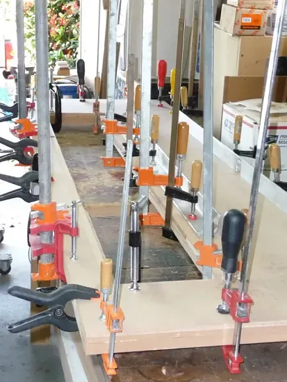

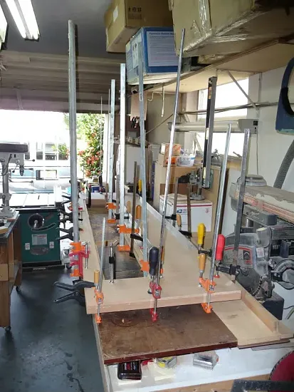

                                                                      Here is the first side getting glued up to form a 1 1/2" thick baffle. Similar to the Battle of Dunkirk every man, women, and clamp was called upon to do their duty.
                                                                      And although not as pretty, or dainty, or classy as that Ardent project under the supervision of the Evil Twin occurring on the western planet of Livermorium, this will do the job. Not bad for a small outpost of rebels in Margatia. I am off to the Venetian Pool for the morning while this all sets up. I understand that Evil Twin wears black and works in the 100 degree weather on the western side of the galaxy. We don't! :T :rofl: :B

                                                                        Very massive and manly, Chuck! :T

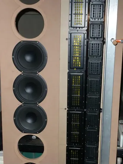

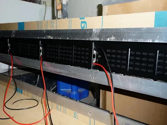

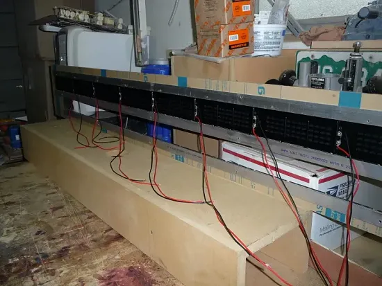

                                                                                  Had to keep this thread on the first page. Got a little work done on the 'framework' of the unit. I need to attach another slab of MDF and router out some holes in it to get one at a closer point of completion. (At least to where I can stand it up and listen to it in stereo).
                                                                                  The clamped aluminum bar is just holding the plexiglass driver assembly in place.
                                                                                    #356
                                                                                    Gees dude that's a lot of drivers..... :B
